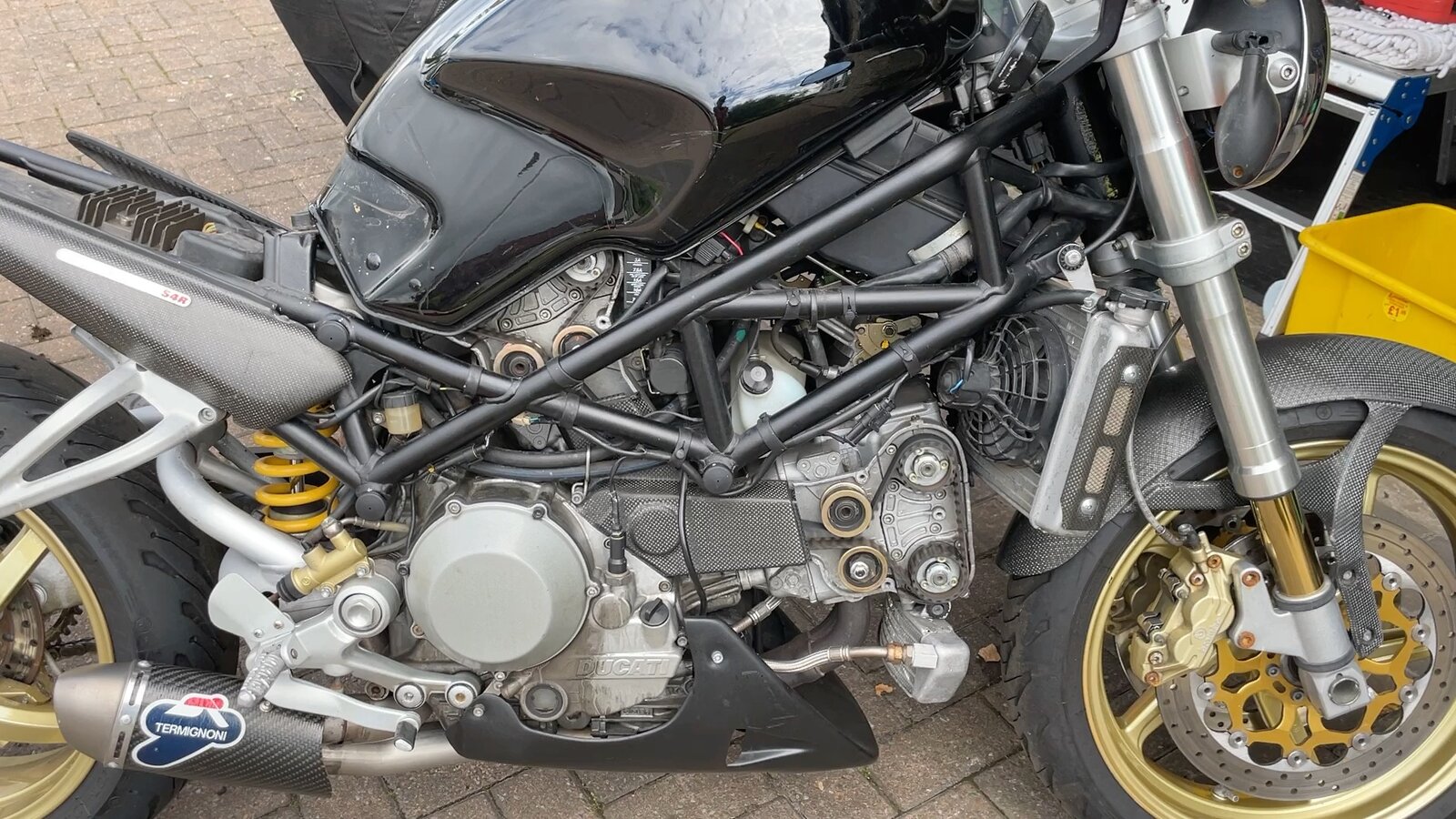

  18. Got the bike running today, big thank you to @chrisw for reprogramming the ECU, and it sounds great. The reason it died is because someone had been in the petrol tank, possibly to replace the fuel filter, and had lost the hose clip for the fuel filter input hose so used a cable tie instead. It didn’t hold. It now has a Jubilee Clip.
    The original water pump on the bike has packed in at some point and an electric pump put in the system. I understand this is because replacing the water pump requires splitting the engine casings. The power for the electric pump runs through a relay that is activated when the ignition is on but it was disconnected from the relay so no power was going to the pump. With the pump supply reconnected the pump runs fine. Does anybody know why the electric pump was disconnected?
    The picture above was actually a video so you could hear how good it sounds, but it pasted as a still image and now I can’t delete it. :rolleyes:
  19. you have to delete it in two locations, there's the one where you edit the actual screen where you may have added text (for example) and then you can scroll down and see "files" in smaller print where you can delete the corresponding "attached file" details associated with that picture.
