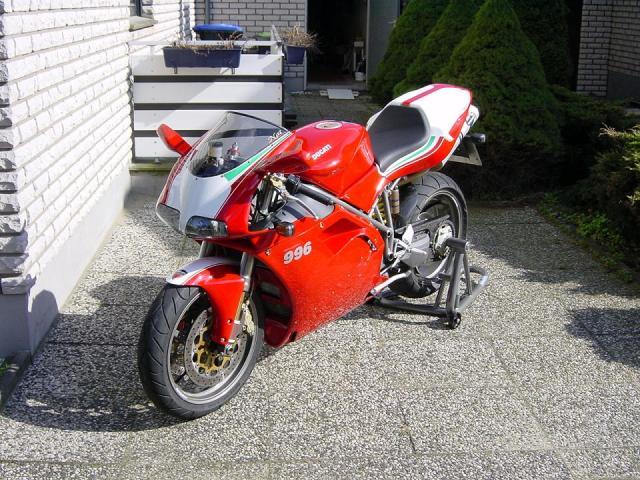

  4. Think mine is stock, at least I've not modded it and it was 3 year old when I got it in 2002, so unlikely to have been modded
  5. the 4 pad calipers were a Ducati performance catalogue upgrade, as i had them on my 996
    from my memory the SPS pista was an internal upgrade to shift the last of the 2000 sps's due to the 996r coming out.
    i bought the Pista kit back in 2001 to rebuild my 996 after a heavy crash, and it also came with Plaque and sticker kit, only the mudguard was separate to the kit
    2013-05-03 22.51.28.jpg .

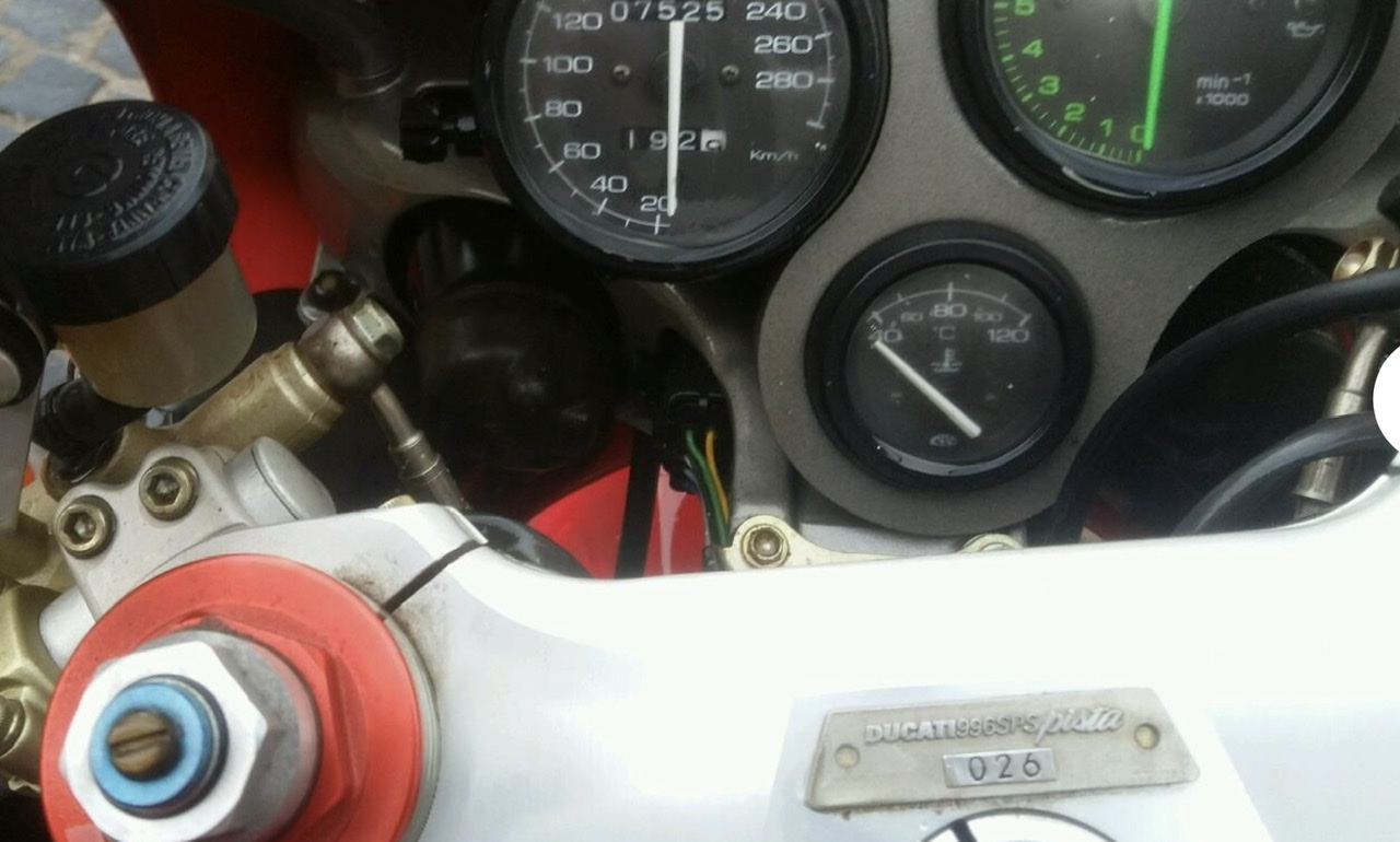

    The fact that a kit including limited edition plaque was available to purchase is totally new info to me. The sticker kit is clearly in the DP catalogue of the time but the Pista ‘kit’ being something that could be retrofitted blows away any theory that they were a limited run.
    It also might explain this odd anomaly I came across - I dismissed it as a bitsa because the spec is such a mismatch to what would be expected on a Pista. But it may have been an SPS II bike that had the Pista plaque and the basic Pista decals retrofitted.
    https://www.ebay-kleinanzeigen.de/s-anzeige/ducati-996-sps-pista-026/2253622198-306-289
    CABF794F-D4C9-4DF0-B99C-41B2B564B8F3.jpeg 99062047-78BF-445C-A229-C53890F0E758.jpeg
    I notice that your bike had the grey frame and wheels - with Showa forks and painted airbox - the same spec as the one in the Anthony Godin advert described as a 1999 SPS II. “Built almost exclusively for the German market”. Does this sound correct to you?
    Was the airbox on the bike you owned not carbon as found on a standard SPS?
    With the one below plus your’s and the Godin bike that’s 3 bikes - all German - with that different ‘SPS II’ spec - which would also have had the homologation cylinder heads if the parts list is accurate.
    Incidentally the mudguard you had on you bike was the one from the SPS/F Can you recall whether the original was carbon or plain red?

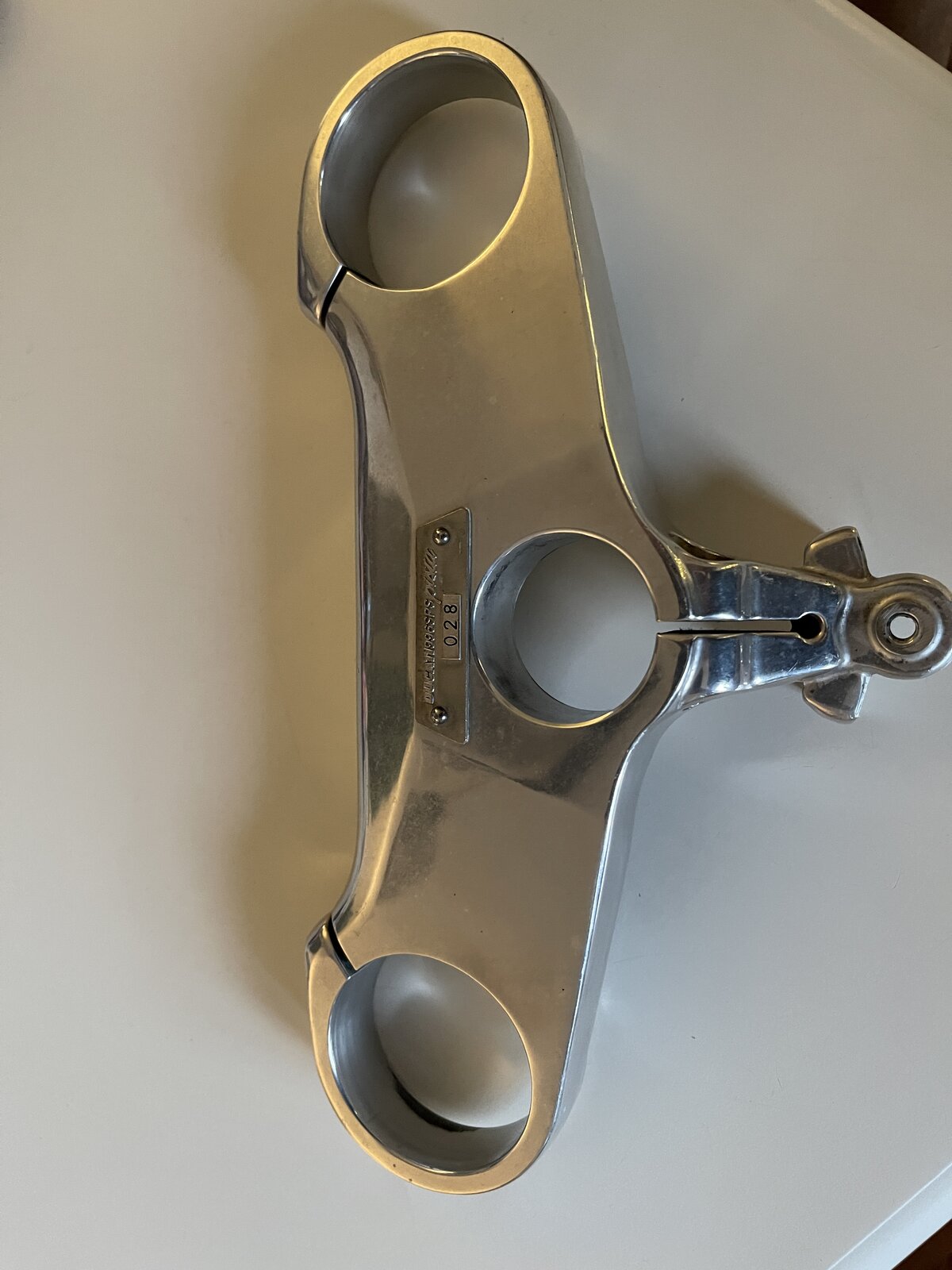

  7. @Nathanhu Was the plaque in the pista kit numbered or blank?
  8. So just to clarify, my old 996 in the picture above was a 2000 996 Biposto with some extra bits and pieces including the Pista kit..
    number plaque below-
    • Useful Useful x 3
  9. Number 028
  10. Just when you think you have a relatively decent idea of homologation models and their corresponding plaques, along comes a thread like this!

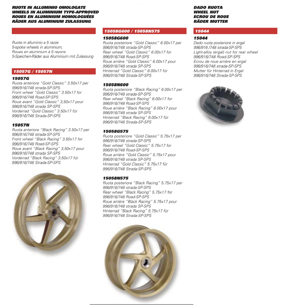

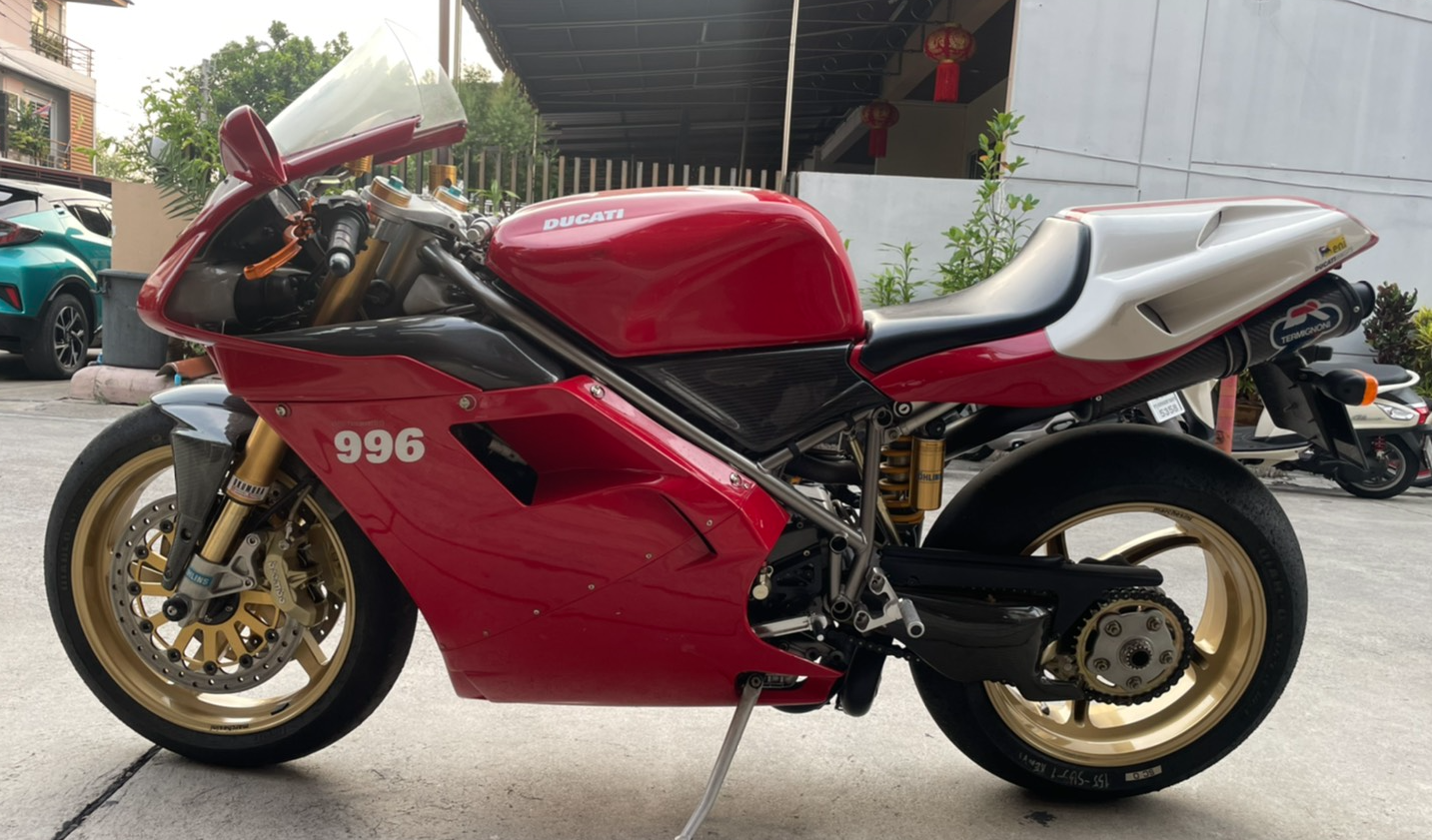

  13. So here’s another question.. :). I thought some later SPS came with Gold wheels? Mine has gold wheels and I assumed they were standard? Mine is 1039 and sold originally in portugal.
  14. Not as standard. But that doesn’t mean the original owner didn’t spec different wheels from the Ducati Performance catalogue from new.
    Gold wheels were available in both Magnesium and Aluminium as extras.
    38082F34-A578-43DF-A74B-2B0AB1B24362.jpeg 35E3C2C6-5C21-41B8-B549-135836F8EEC5.jpeg
  15. Thanks!
    They are definitely marchesini, hollow back with the web strengthening.
