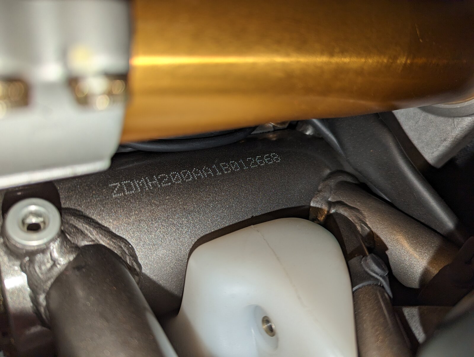

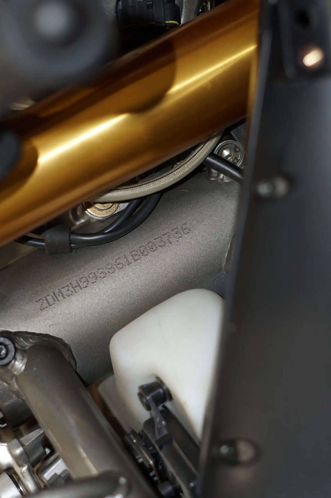

  9. This has got to be a special case to overflow 996 bikes because I know this does not apply to the 996R - which agrees with how Ian is framing it. The R had the VIN stamped over the paint and the assembly stickers say England and GBR all over it. The SPS VIN has been started at one point, finished at another, then painted (see pics), the front end put back on the frame neck (had to be off to do this), then the stickers with the later date applied to the bike along with all the other country destination-specific stickers. It's in the realm of manufacturer discretion to not use all VIN allocations for a certain year and to stamp an earlier made vehicle with a VIN for a later year - so long as the vehicle complies with that same years government requirements as the VIN applied. I've seen this on cars often, and vice versa where a new car is made and a left over VIN from a previous year is used - because the vehicle is built identically to that years motor vehicle regulations. No harm no foul.
    The shipping point was a 3rd party that in 2001 (SIMA in Modena) would either load domestic (meaning EU country) bikes onto stillage racks for lorry delivery to concessionaires or put them into wooden crates for export via sea trains on ship. I literally have a video documentary showing this with a Ducati employee explaining it. So I'm sure Ian means some Ducati production over-flow storage to some staging area where the frame VIN was "finished" and the assembly completed. Then it left for the shipping logistics partner. He's just calling a "shipping point" a finally assembly point. I'm sure I'm being overly OCD and pedantic on this point so I'll shut up now lol.
    Now I say the VIN finished or stamped again because it looks a little sus. Here is the SPS VIN stamp compared to my 996R VIN stamp (I'm going to not blur mine here so you get the unaltered original image). You can see the SPS was painted AFTER stamping where mine was stamped only after paint, and on the SPS you can see this odd "surrounding area" where the paint looks blown in compared to the rest of the frame paint. To MY eyes, it looks like the ZDM3H was stamped, then the bike stored, then the rest of the VIN stamped (notice the SLIGHTLY smaller font) and the paint blown in to match. Just sayin.

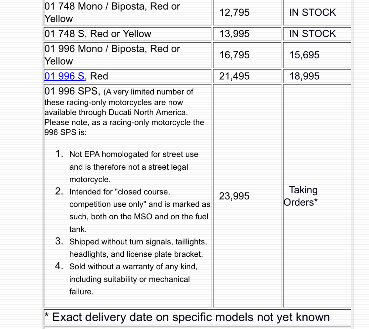

  14. Randomly, I was down an unrelated rabbit hole today and came across this Gem regarding the 2001 SPS. It was an archived page on the ProItalia (dealer) website:

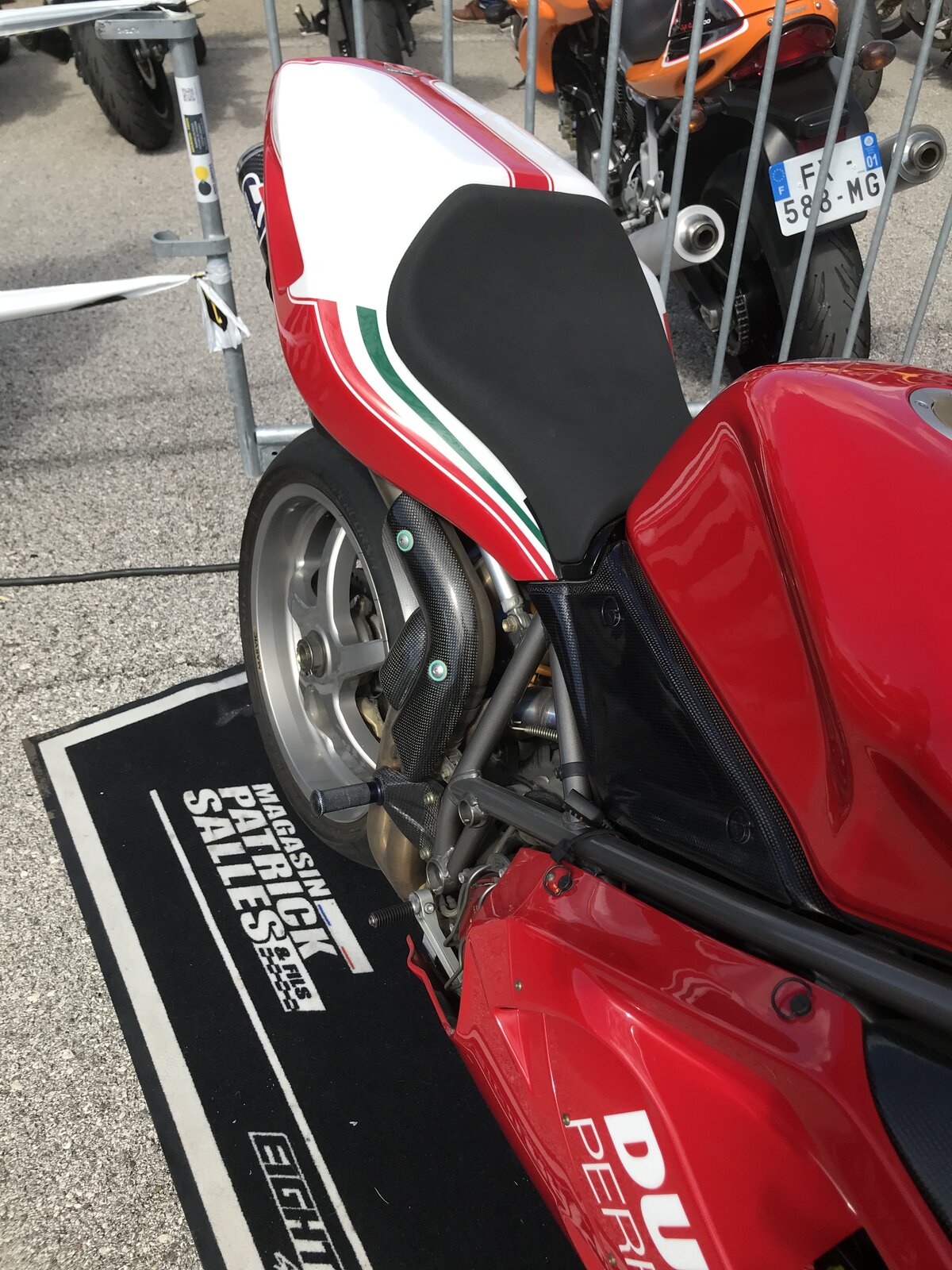

  15. Saw that girl yesterday. D6D5938C-B8BA-4D98-A81D-2308B52BCA53.jpeg 5F33DF0A-BAC7-4F2D-9598-A33502426F3C.jpeg
