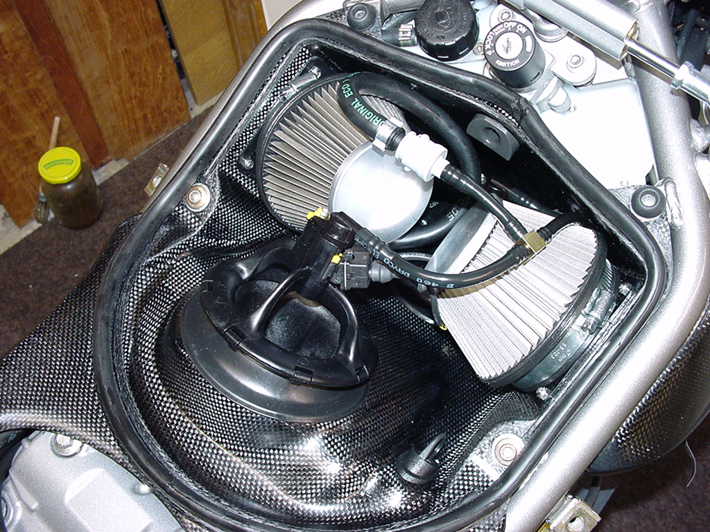

  2. I run these but I'm not sure if they would fit in your airbox. Filter 6.JPG

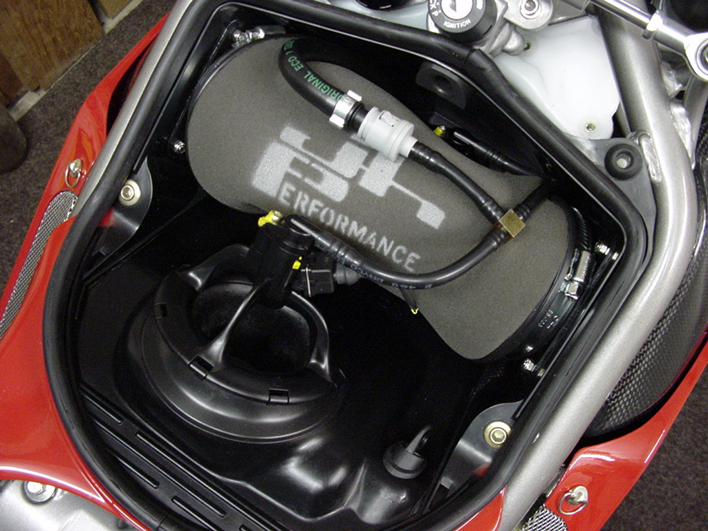

  6. @RickyX they look better in the flesh mate,the centres used to be gold but it looked to blingy, the silver now matches the sub frame. I believe they were in the dp catalogue back in the day.
  7. @RCGBOB44 I've not seen that one mate , I was thinking of the the big square foam one that fitted over the bell mouths .
  8. Cranker just added mesh iirc on the air box entry for big debris as those in-airtubes filters for the same reason.
    But he has blown a few motors in his time...I’d be having the pod filter inside like Bobs
  9. I did. I'm very mechanically minded these days:upyeah:.
  10. What slave you using?
