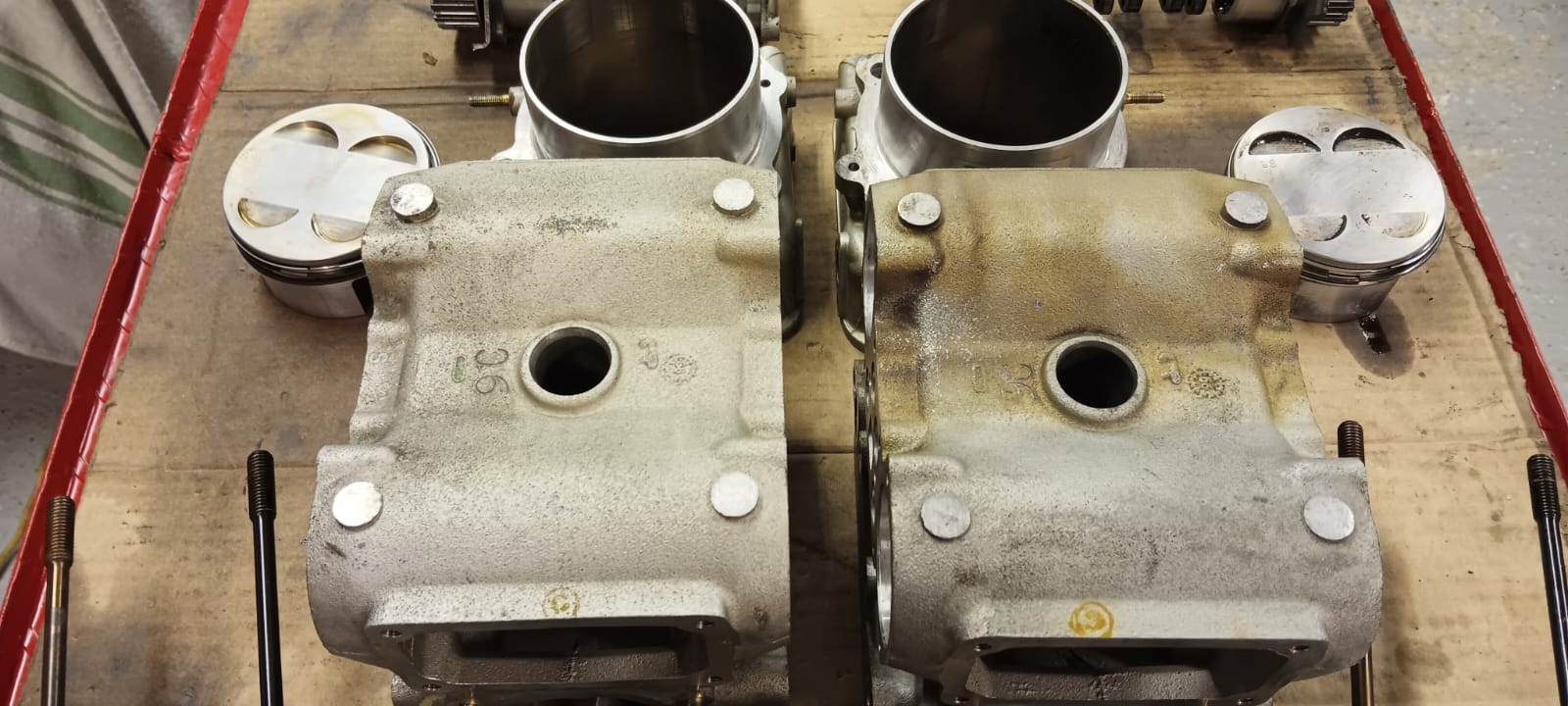

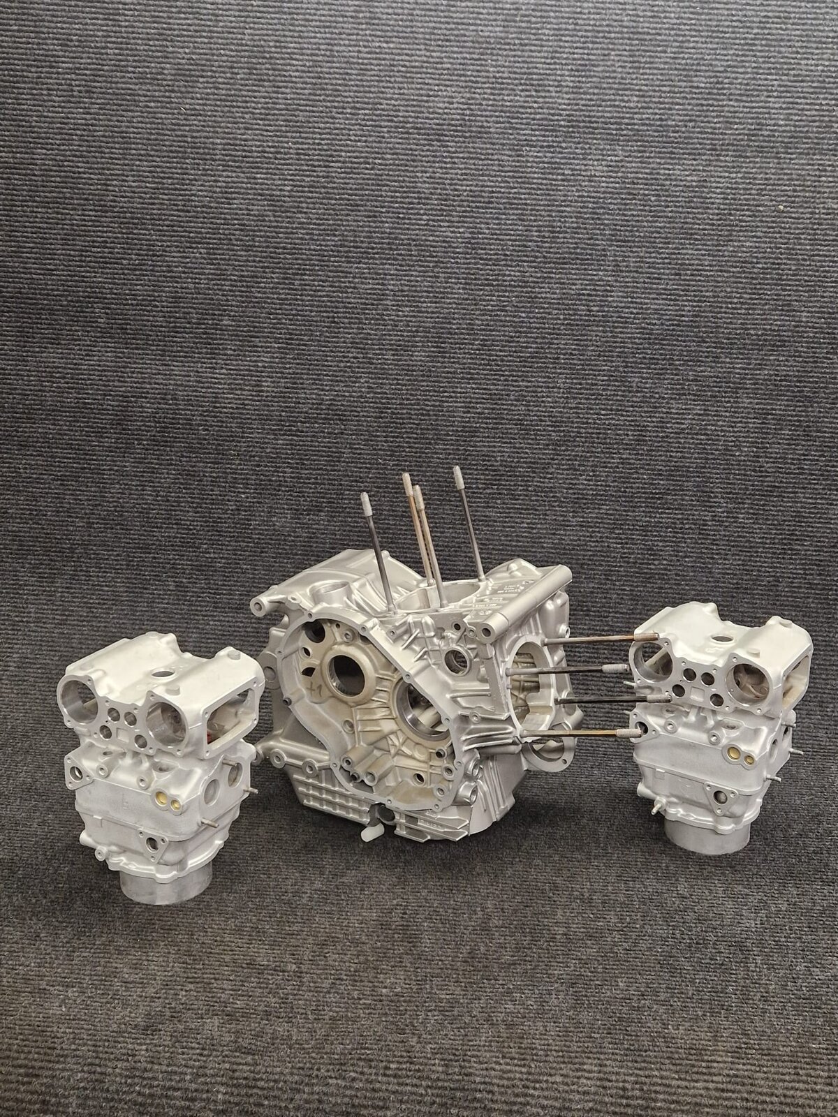

  1. My SPS before and after shots…..

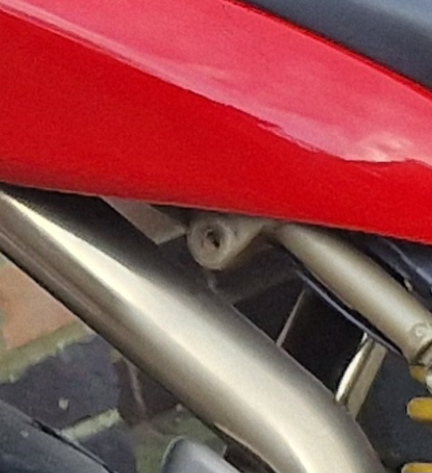

  2. The pillion pegs mounting points are a big giveaway Screenshot_20240128_180445_Gallery.jpg

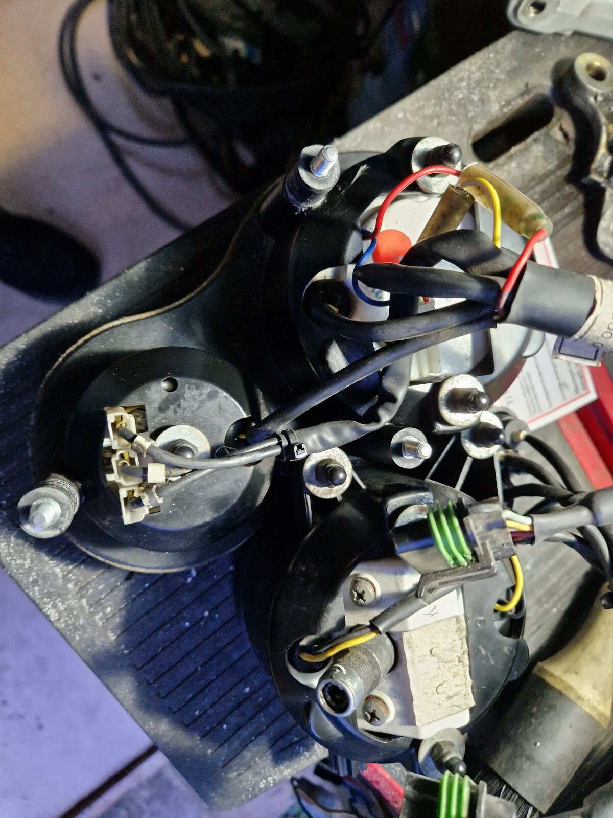

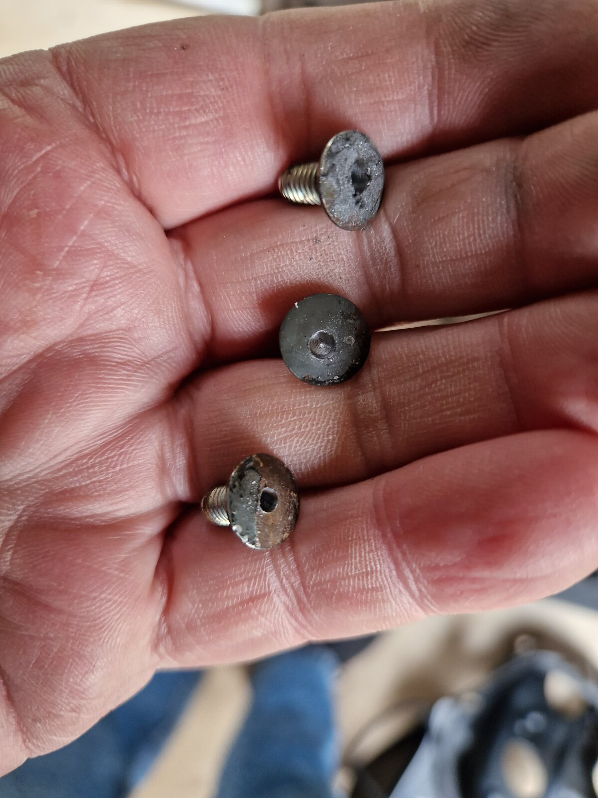

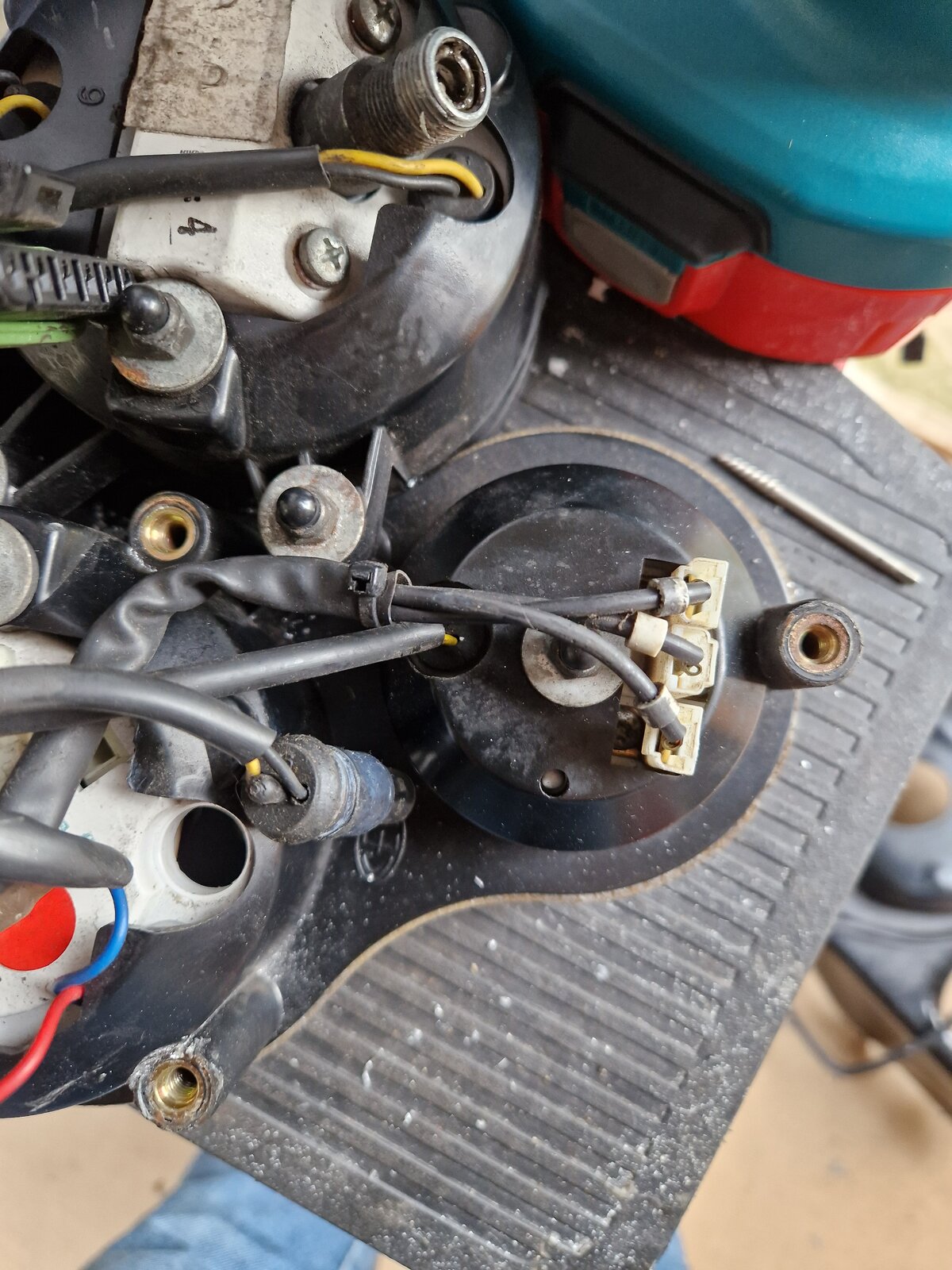

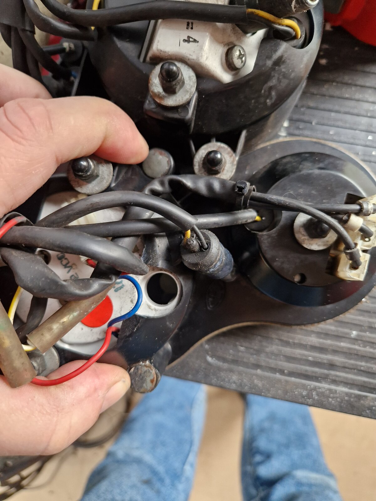

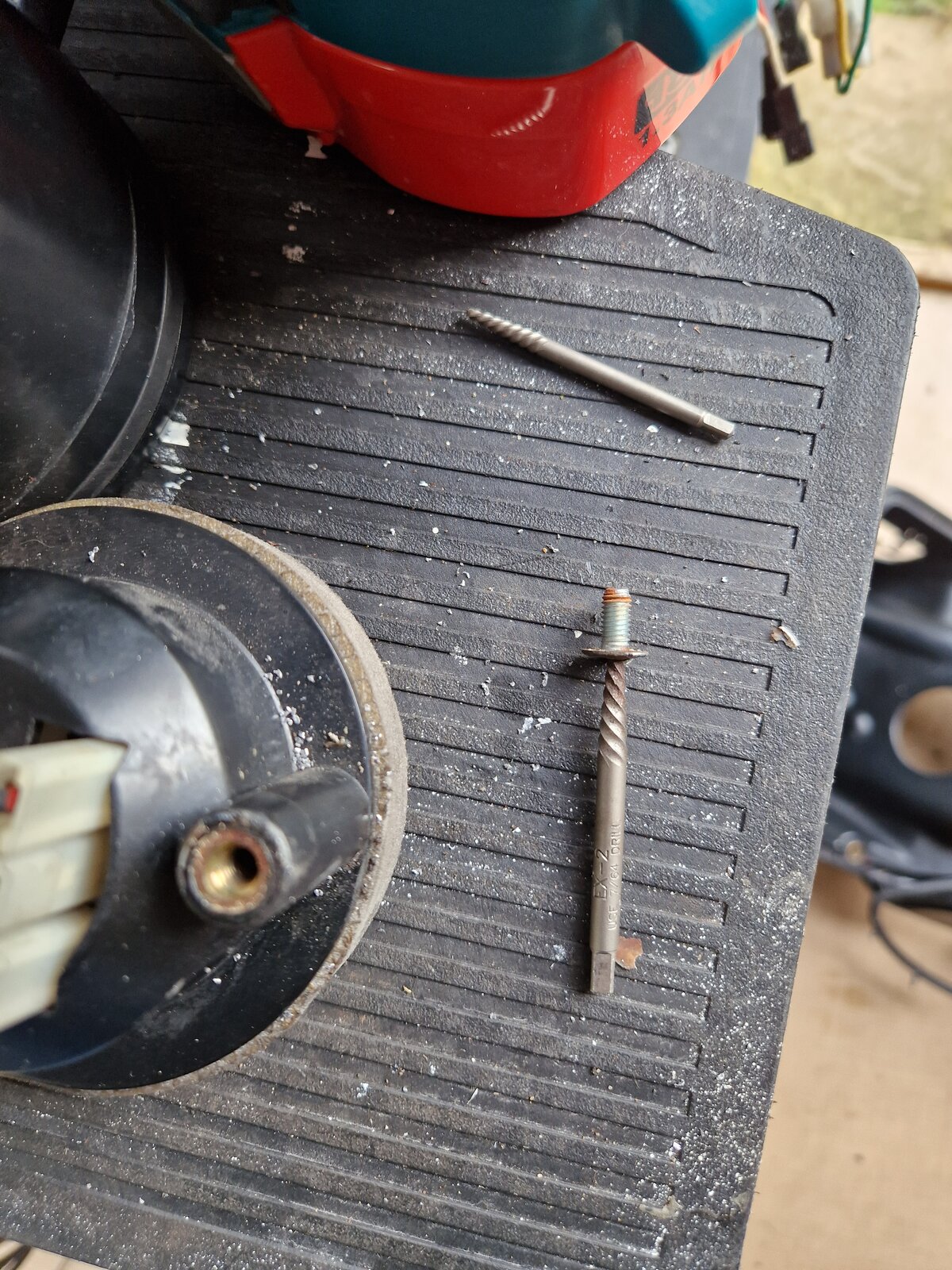

  8. Did a bit more yesterday afternoon, first on the list, remove the broken fixings from the rear of the dashboard assembly
    Tried gripping the edges with pliers and mole grips, not happening, recharge the drill batteries, drill them, and stud extract them, using one of the very few Snap-On tools that I own, an extraction kit (was given, not bought, I'm not that rich :joy: )
    Next job was easy, refit the new fittings, all ready to refit to the bike, once the headlamp bracket has been repainted

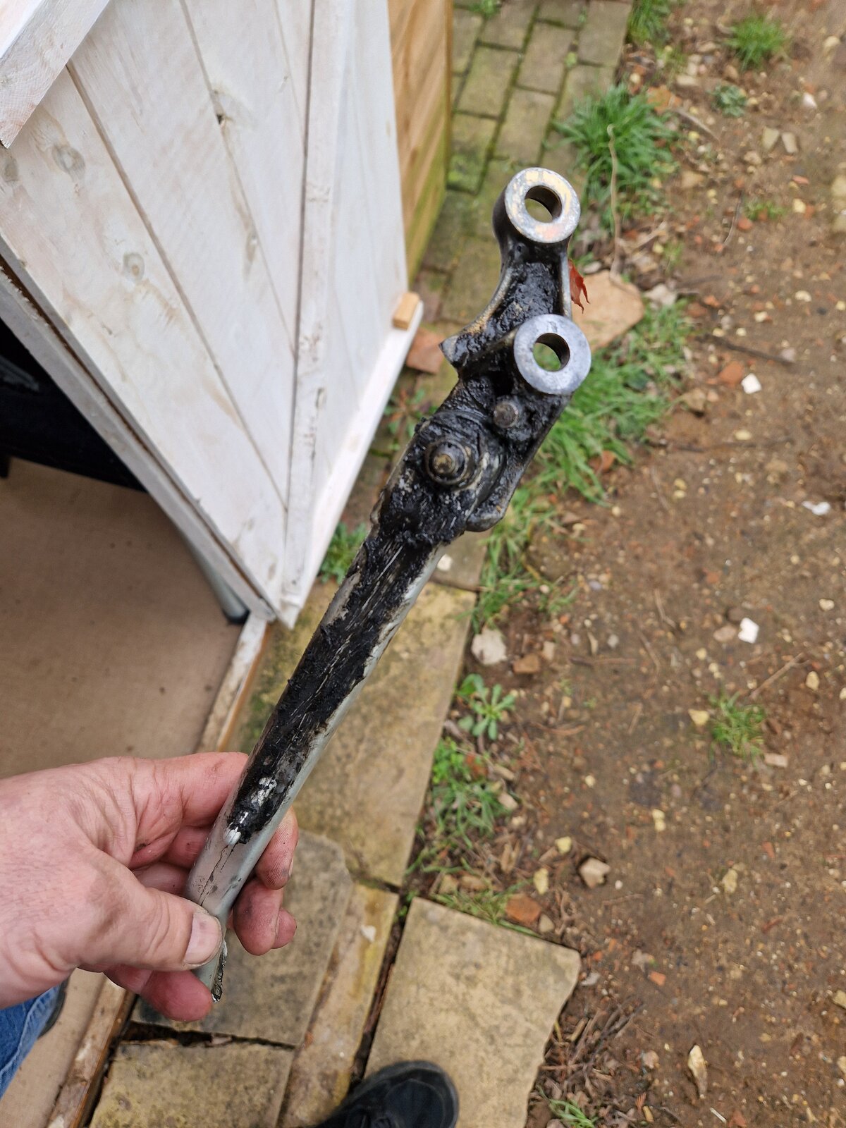

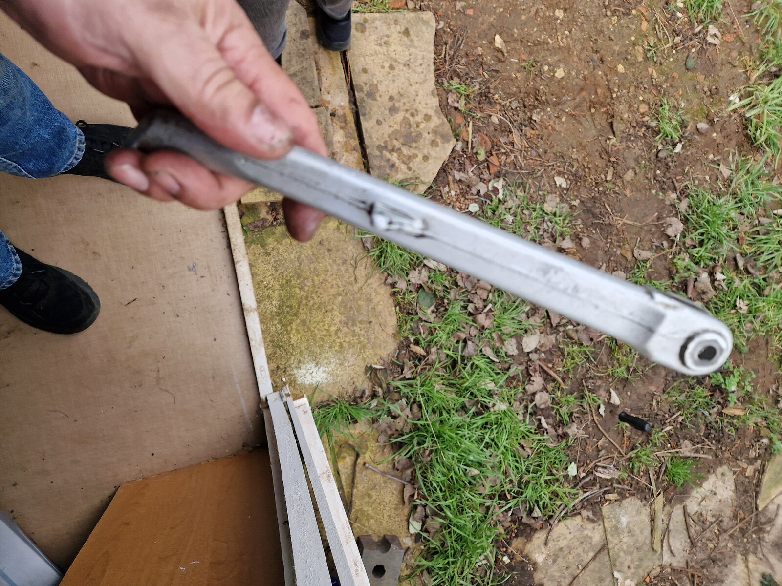

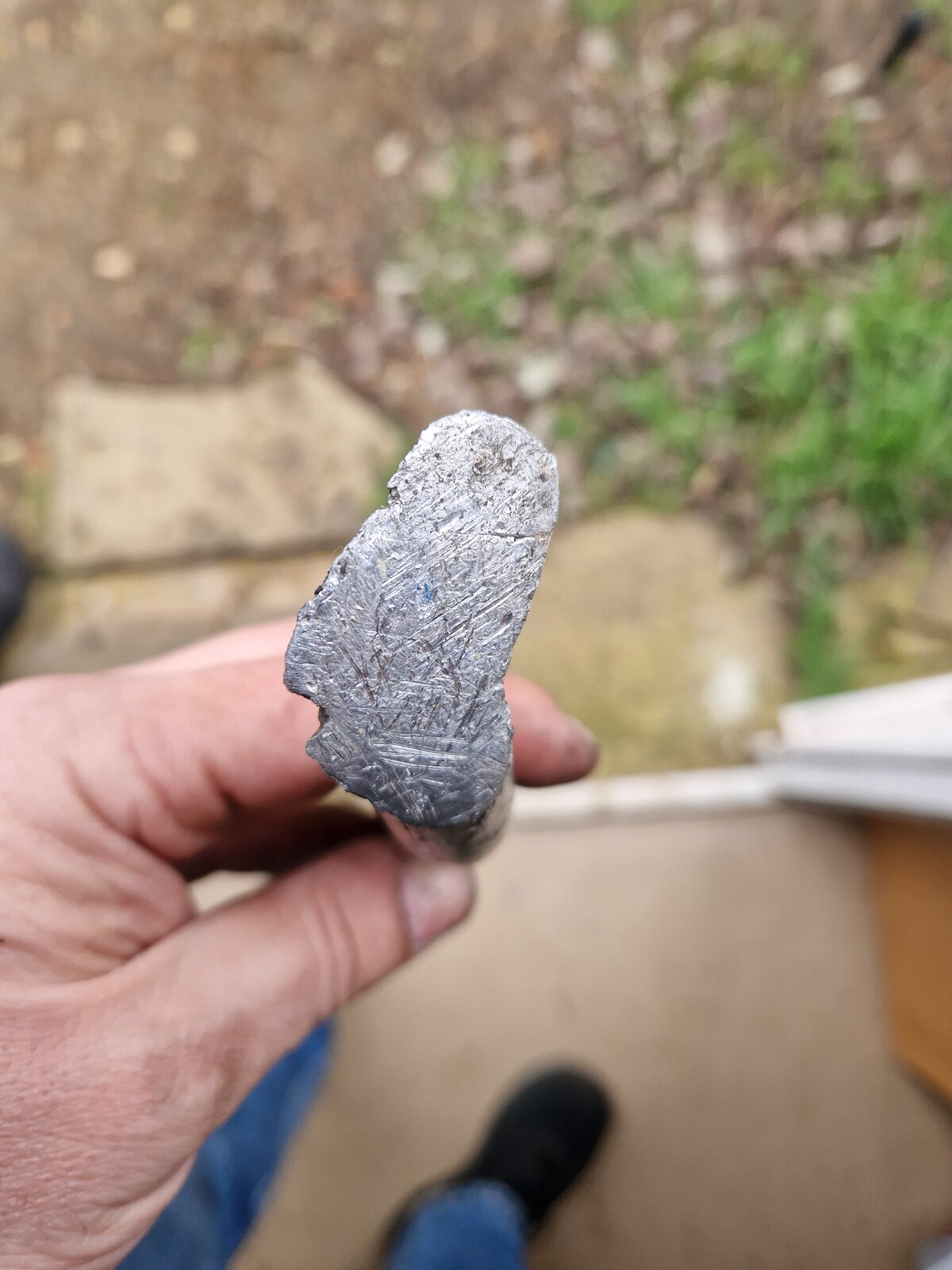

    Now, on to the kickstand, it has had the suicide stand delete modification done, but, the incorrect plate has been used, as such, when the stand is put down, the plate is catching the lower fairing, stand removed, needs a bit of a clean :eek:
    And after....
    Looks like the footplate has seen better days though
    Need to finish cleaning the mounting bracket and springs, then order the correct return plate before refitting
  9. You might want to upgrade to the 1098 side stand - the standard one (especially once worn) gives a nerves inducing degree of lean and wobbliness! Nice project - following with interest!
