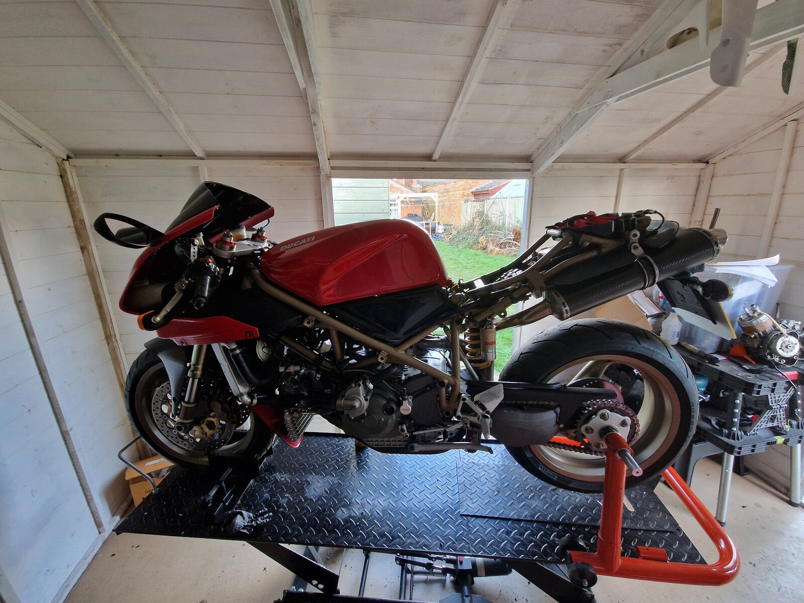

  9. Got a bit more done today, decided that, for now, it is going to be a quick refresh, to see what parts are needed, and what needs some tlc
    First on the agenda today was to finish off fixing the youngest sons aprilia, new parts ordered last week, delivered during the week, fitted today, and fully rebuilt, was a pig to start at first though, but, it eventually fired up :upyeah:
    Once that was done, get it out of the workshop, clean the table, spilled some petrol and some 2 stroke oil, didn't want it getting on the tyres, then get the 996 back on the table

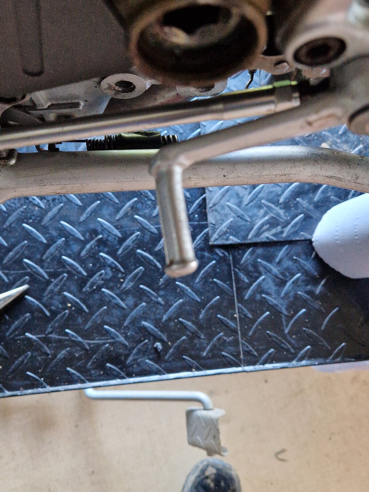

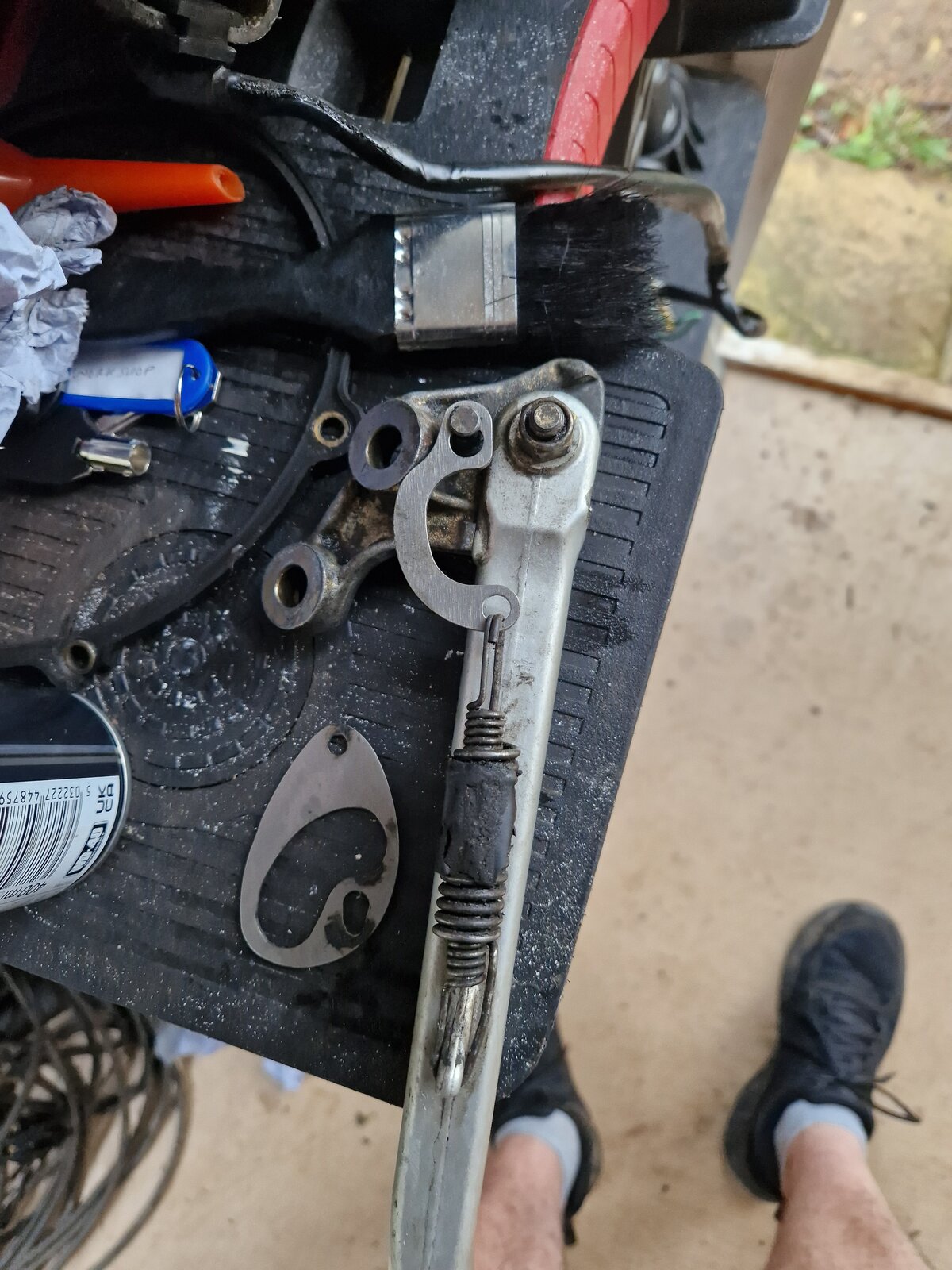

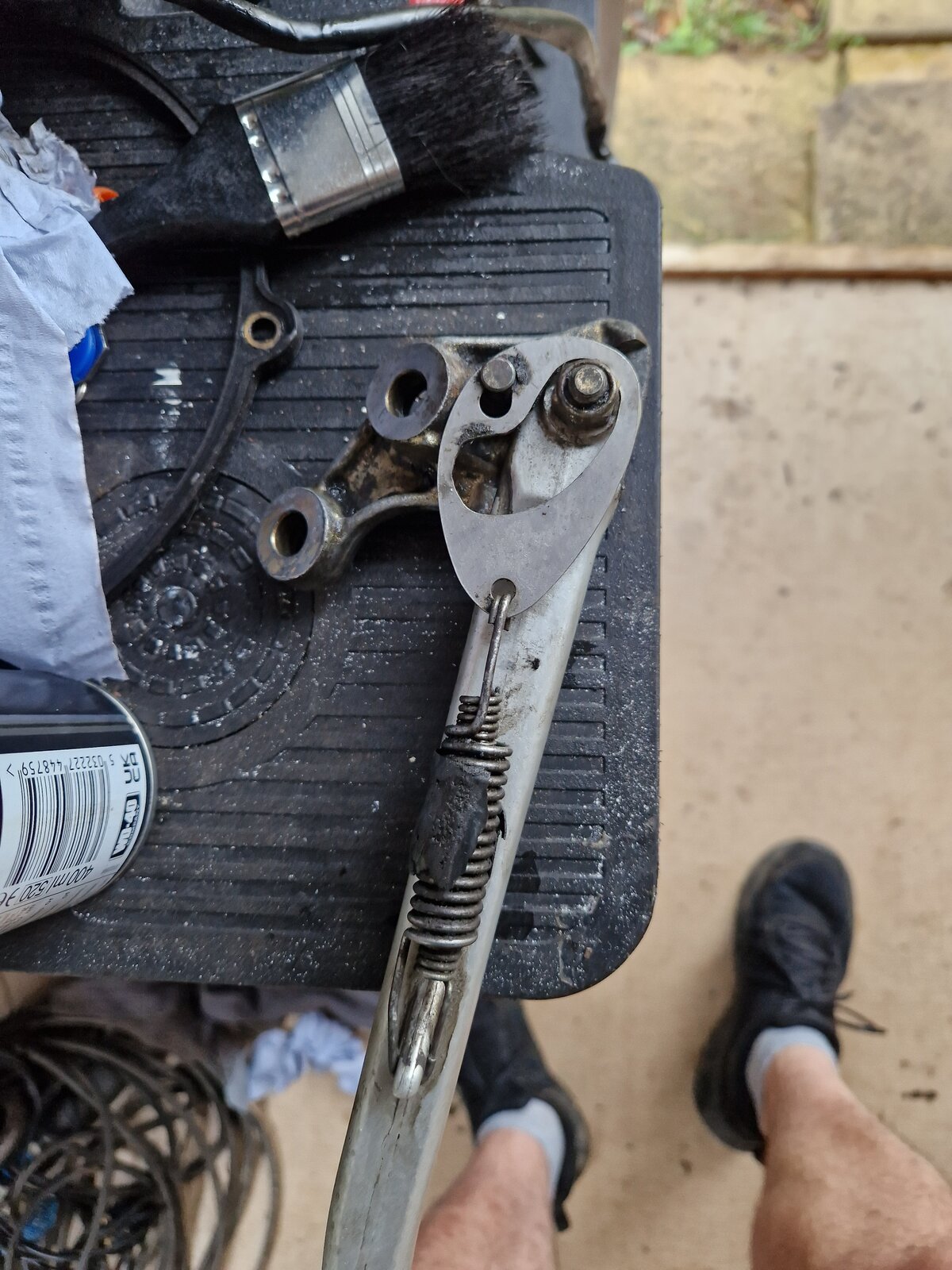

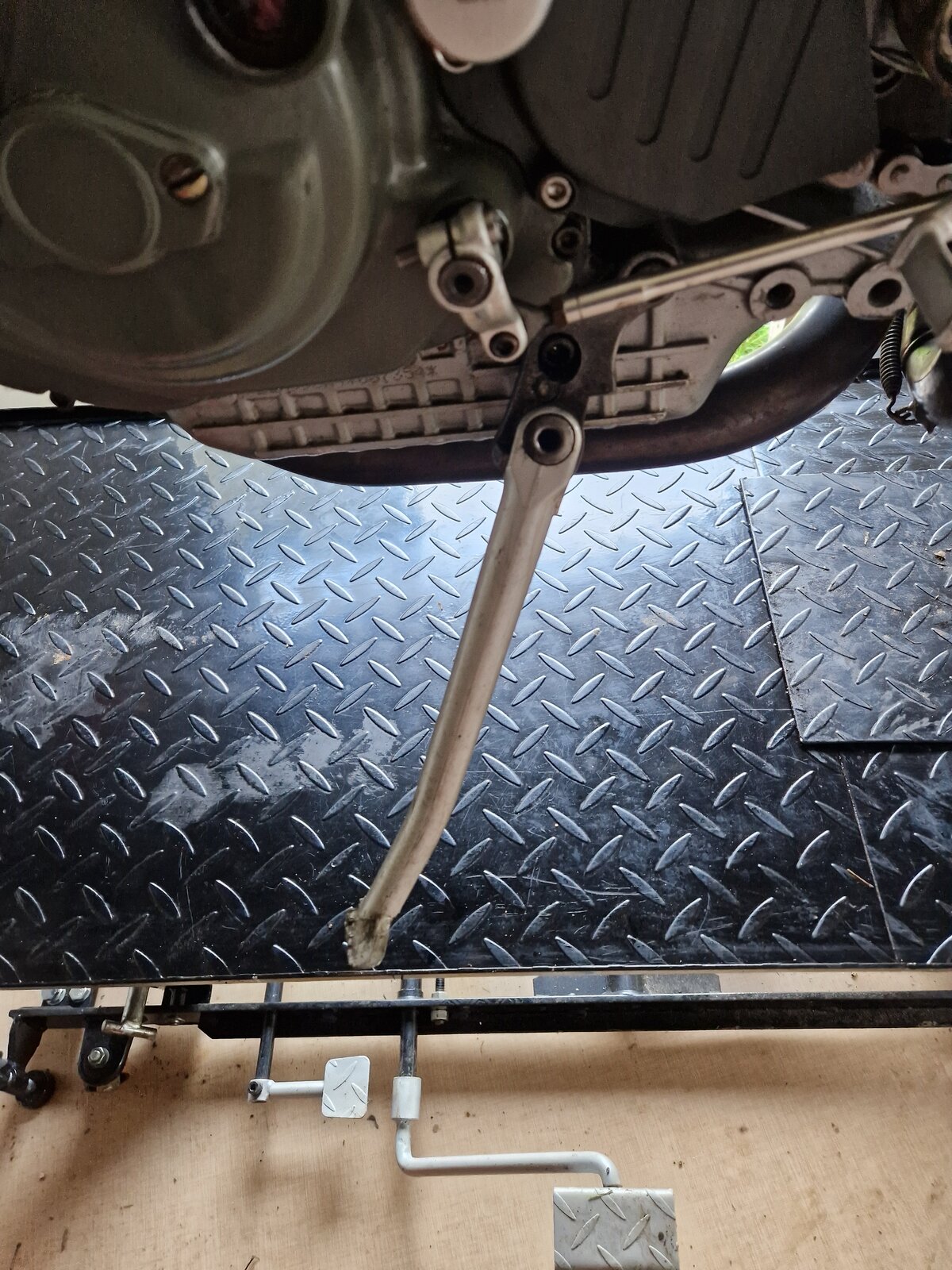

    First job, sort out the kickstand, a previous owner had fitted an anti suicide stand bracket, unfortunately, it was not the correct one for this bike, new, correct piece ordered from the Bay of Fleas, arrived within a couple of days, fitted today
    Old bracket...
    New bracket

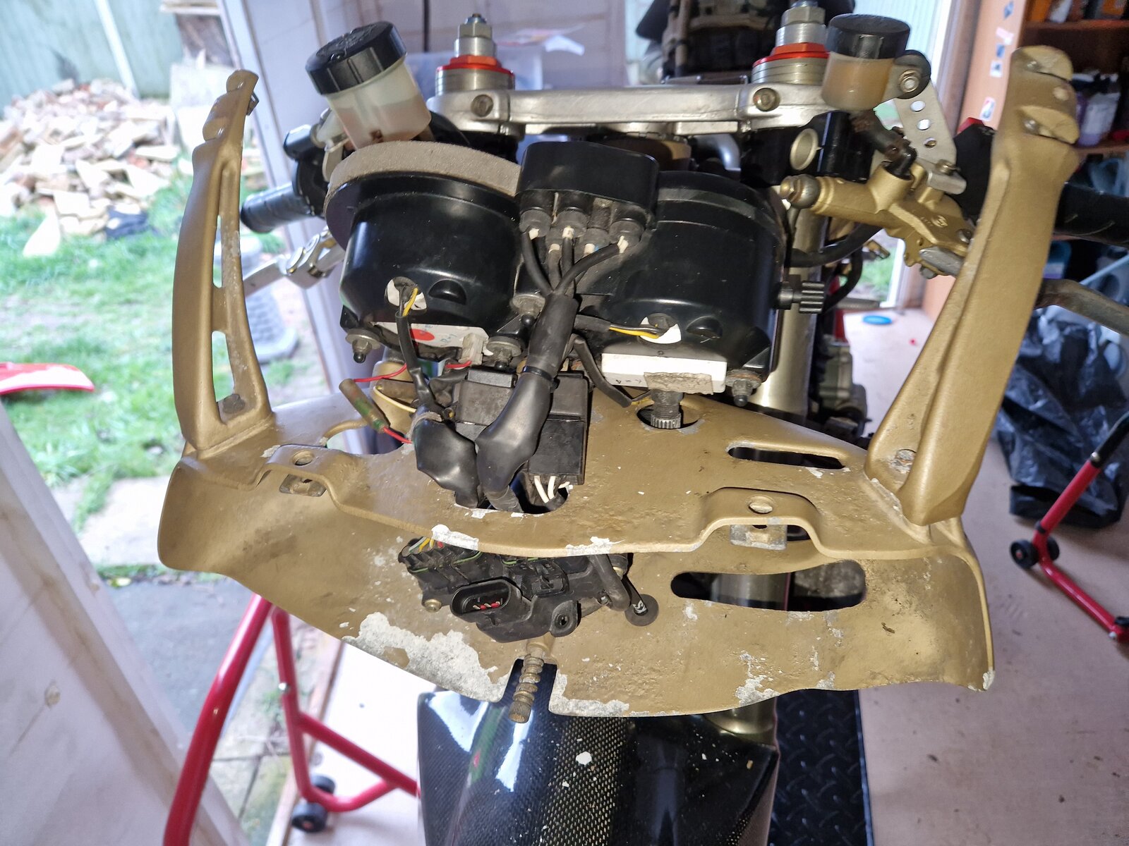

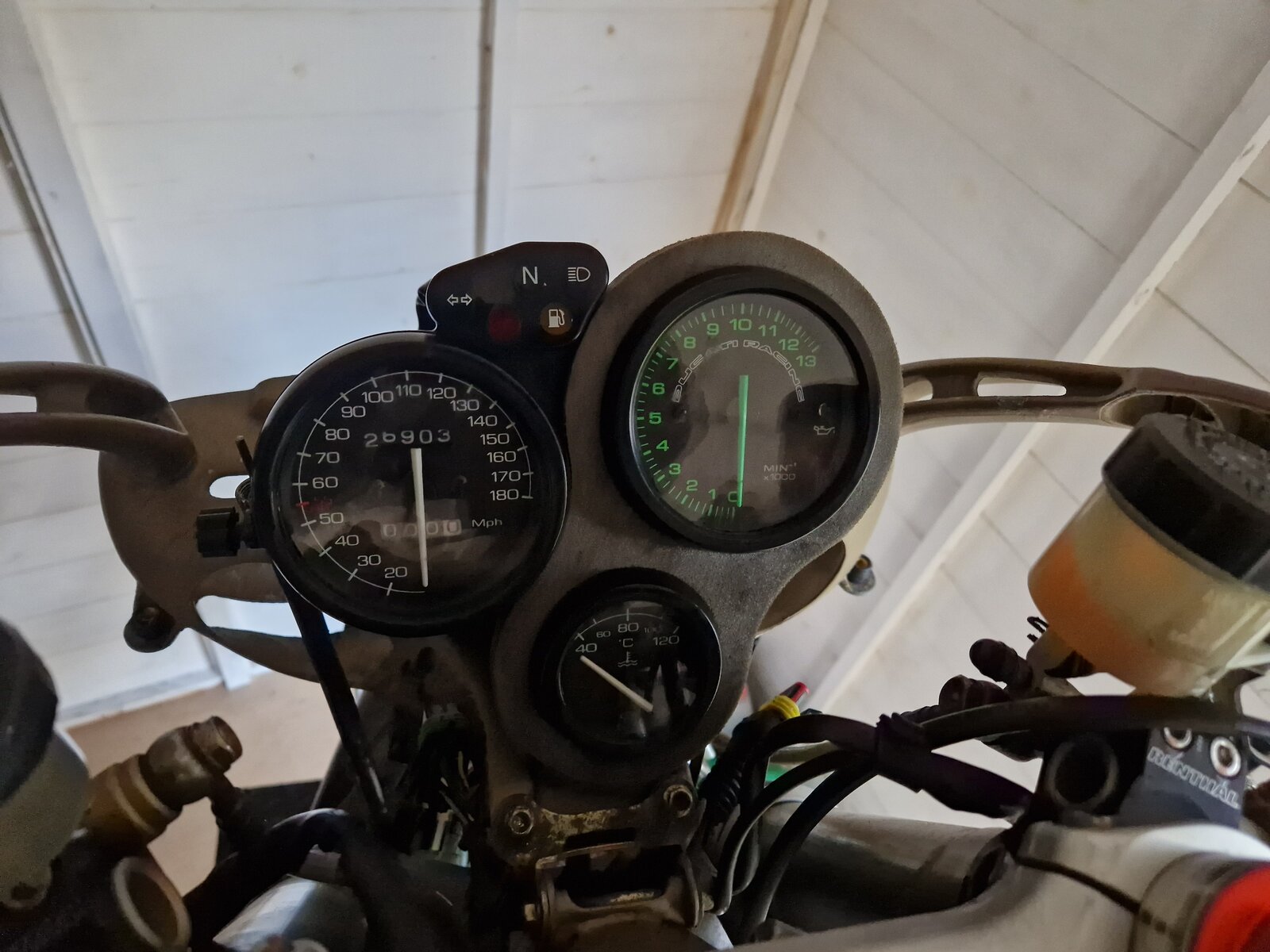

    Next on the list, refit the clocks to the headlamp holder, forgot that the headlight relay bracket fixes to one of the clocks screws
    Got all the wires connected, went to fit the headlamps, need to disconnect the wires, affix the block connectors to the headlamp frame, reroute the cables and reconnect the plugs

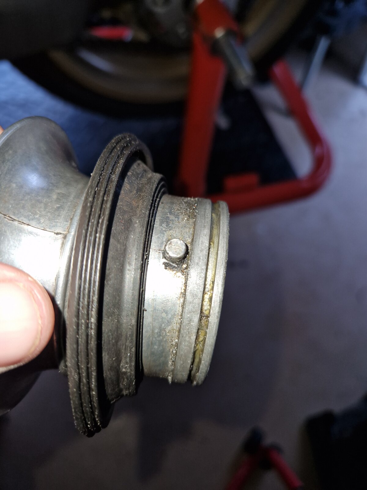

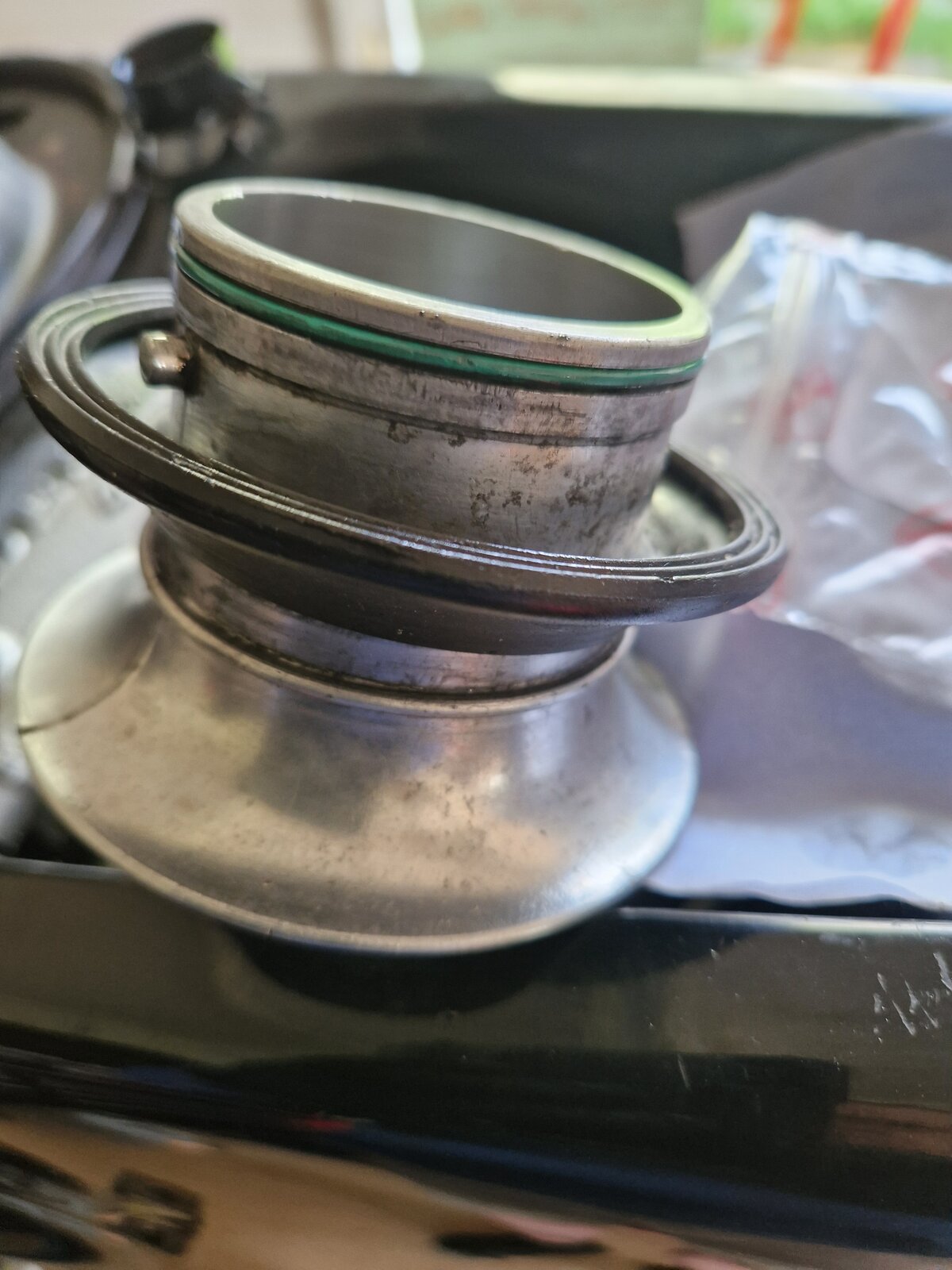

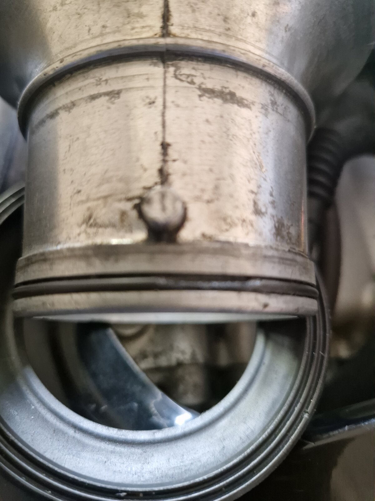

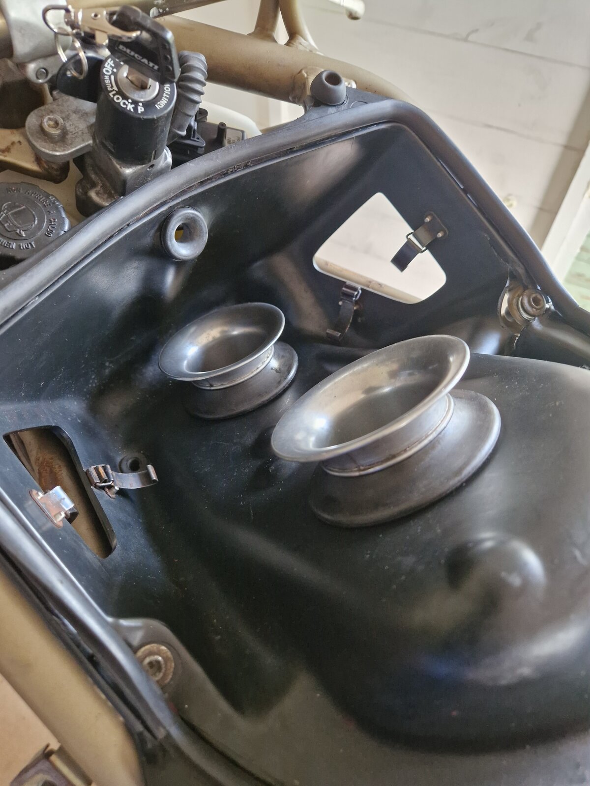

    Refitted the scabby/broken airbox, replacement has been arranged, and the air intake trumpets
    Sure there should be an O ring on there....

  10. Yes, there is suposed to be an O ring on the inlet trumpet to seal it in the throttle body. Use a smear of grease to help it fit in and pull out.
  11. The other trumpets has the o ring, but, there is a cut in it, replacement parts have been ordered, hopefully, will be collecting Saturday

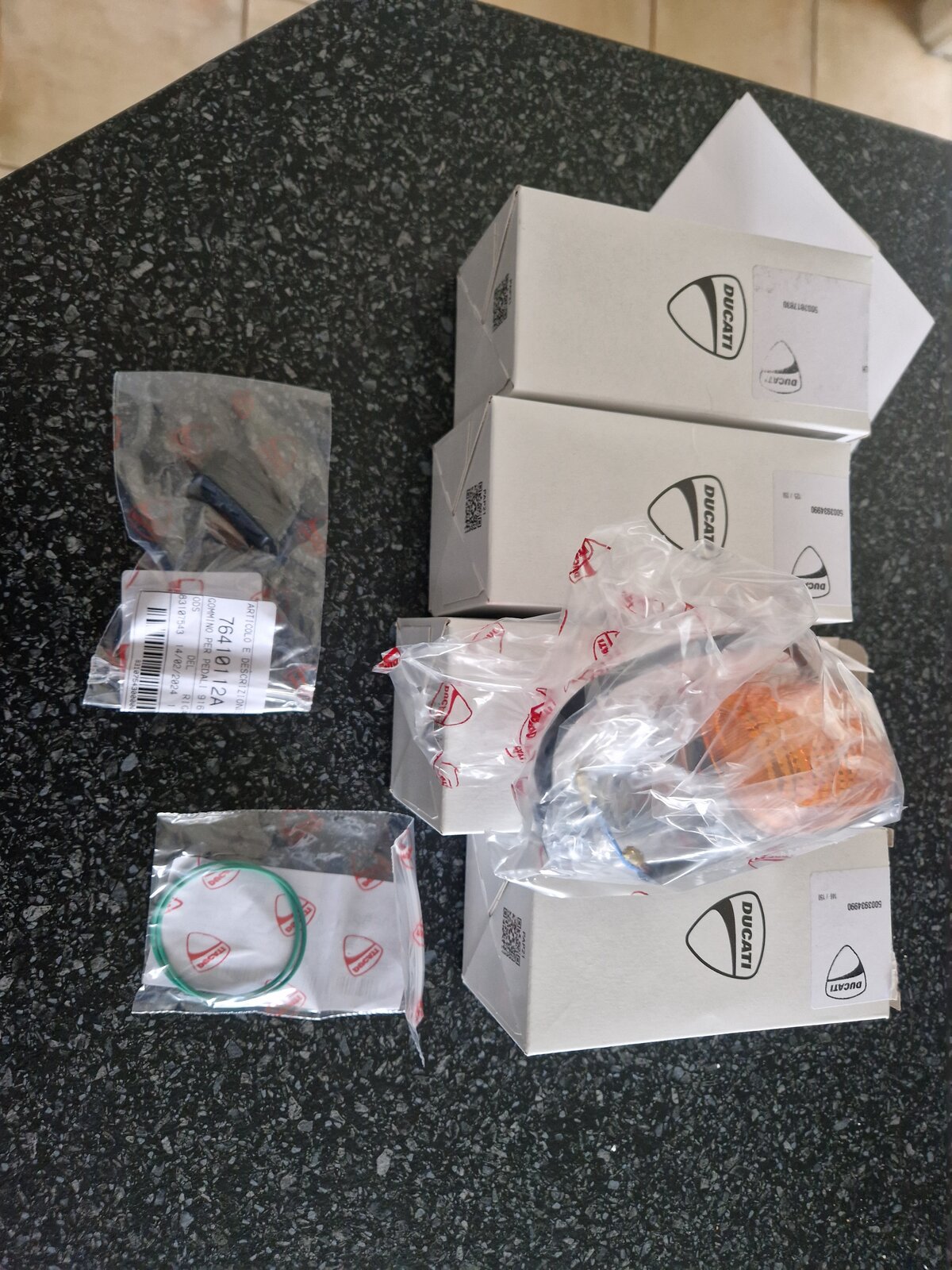

  13. Trip over to Ducati Coventry this morning, new parts collected today, 4 new indicators, 2 new O rings for the air intake trumpets, and a new gear selector lever rubber
    Hopefully, will get around to fitting them tomorrow, and getting the bike looking like a bike again :joy: 20240217_134243.jpg

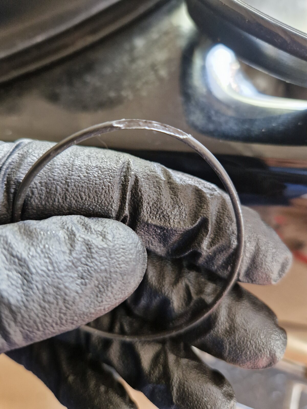

  14. Got a bit more done today, first on the list, clean up the throttle bodies and the trumpets ready to fit the new O Rings, one ring was missing, the other was damaged
    New rings fitted, nice and easy, plus, the new ones are green, so you know they're good :D Rings lubricated to make fitting the trumpets easier

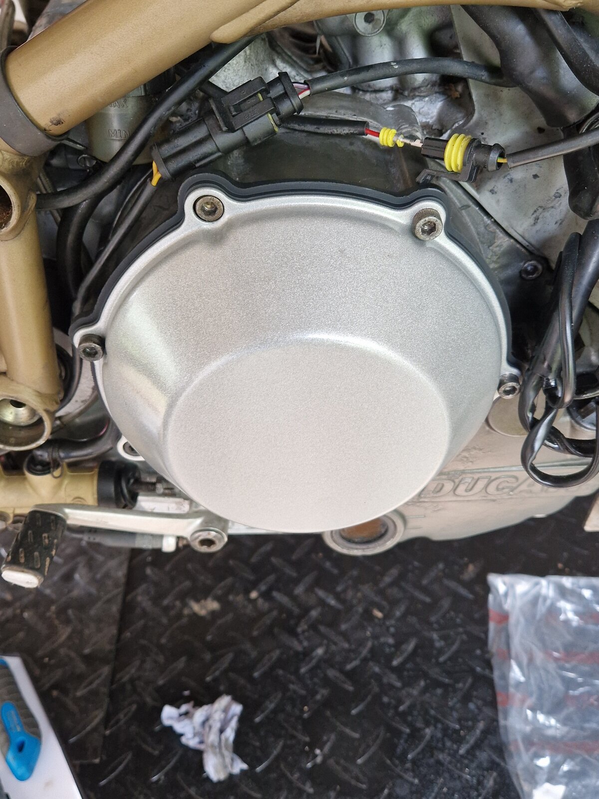

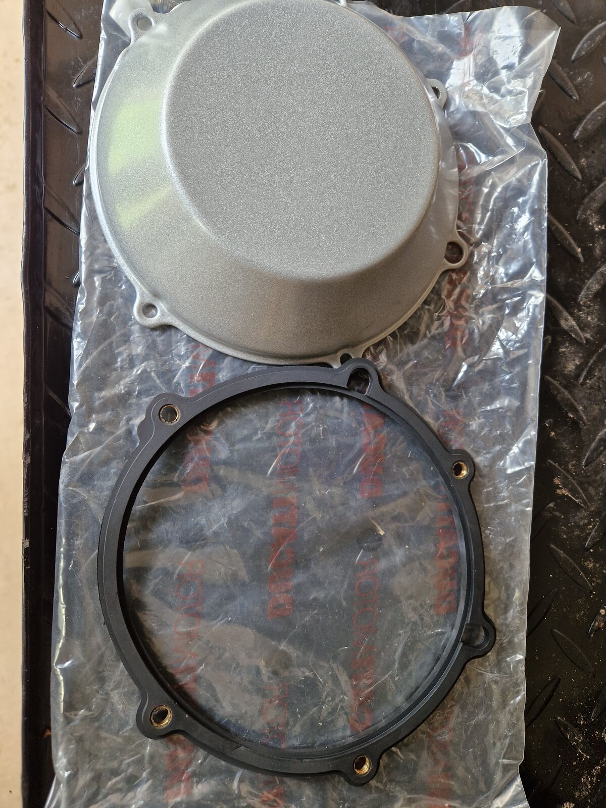

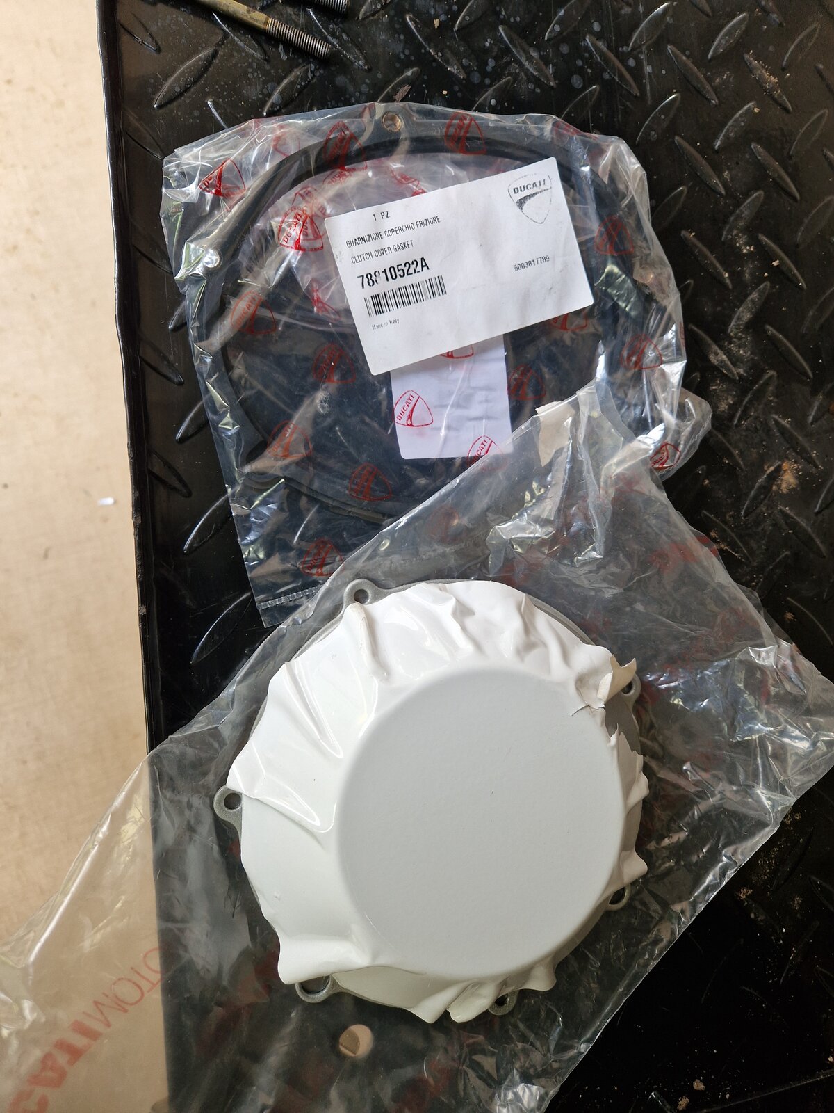

    Next on the list, fit the new (old stock) full clutch cover, complete with new seal, the previous clutch cover was a hideous looking open cover, and the rubber seal was all perished

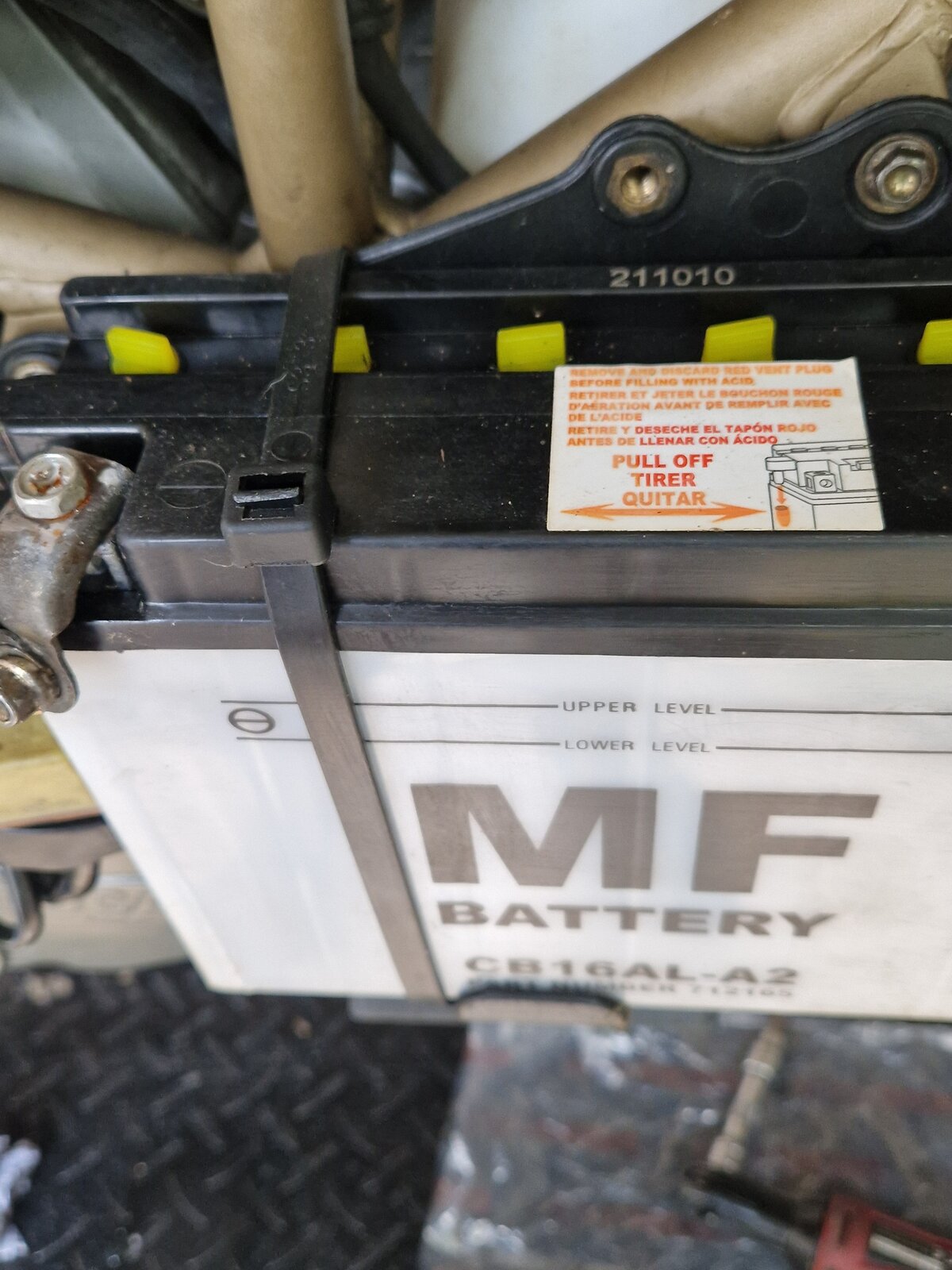

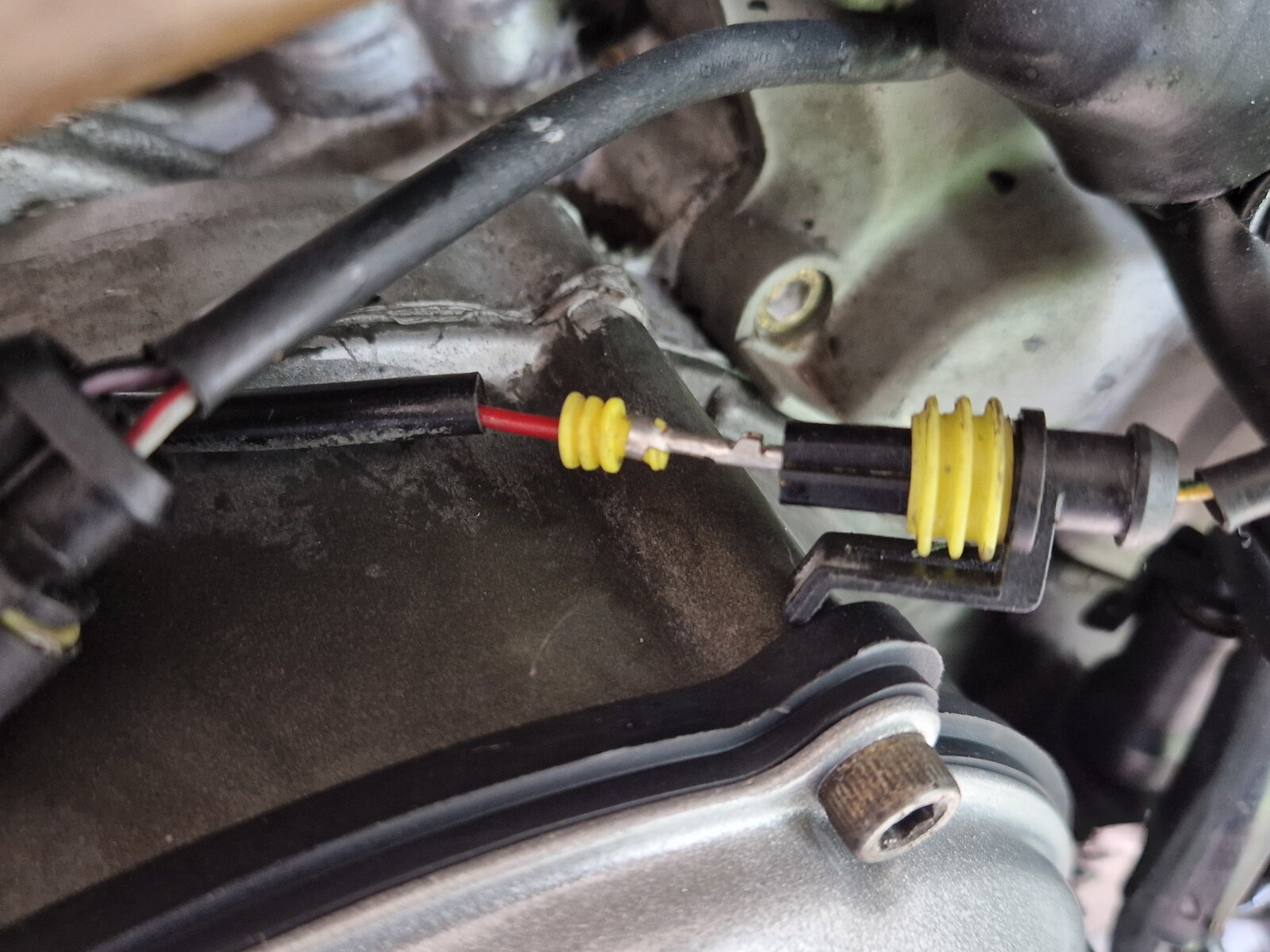

    Whilst in the area, I noticed that the neutral switch (?) Wire, has the plastic plug missing. According the the parts catalogue, the neutral switch has 2 wires, whereas, the one on the bike only has 1 wire
    Looks like the 'bodge-it and scarper' brigade has been here before, it has the battery clamp mod retrofitted :joy:

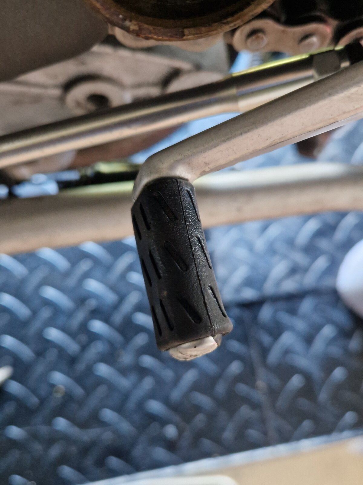

    The next job, fit a new gear selector lever rubber, the old one was missing
    Next was to start refitting the air intake tubes, and the body panels
    Right side air intake, pretty straightforward, left side air intake, not so......
    Someone saw fit to reroute one of the coolant lines, the one that runs between the two expansion tanks, and had run it on the outside of the frame, thus, causing issues refitting the air intake tube, ended up removing the trumpets and the airbox again, to get to the clamp, and remove the pipe to route it the correct way, once all back together, the air intake went on pretty easily
    With those fitted, next was the nose cone and mirrors, took a few minutes to get it lined up, but, all good in the end
    That was enough for today, had to go out and try and teach the youngest son how to ride a geared bike, after he did his CBT on a rev and go shitter :joy:

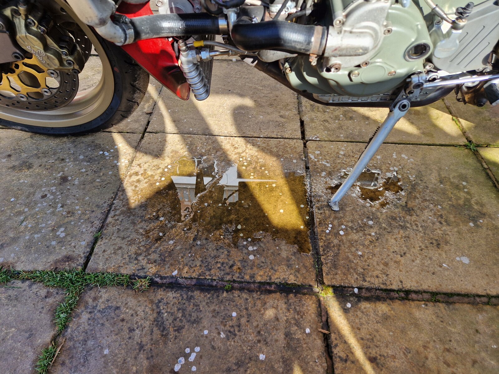

  16. Well, the 996 is almost back together, just the main side fairings to refit, I decided to take advantage of the sub-zero temperature this morning, and get it out of the workshop, over the frosty grass, which has been waterlogged for the last month :upyeah:
    Had it sat on the patio, ticking over nicely, getting it warmed up, for a potential test ride later today, until it decided to take a pee all over the patio :mad:
    Once it had cooled off, I disconnected the cooling fan, and tested it with jumper wires direct to the battery, fan works fine
    Just having a coffee, a sulk, and a rethink for my next check for the issue :sob:
  17. Some of your coolant hoses clamps look rusty and pretty shitty. May be check the rubber underneath for cracks (and replace rusty clamps while you’re at it) ?
  18. Unusual colour for the alternator case - is it magnesium?
    #59 RickyX, Feb 24, 2024
  19. I’m going with the thermostat housing. :thinkingface:
