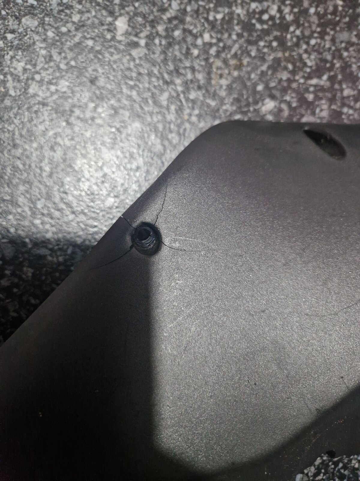

    Eventually got around to fitting the expansion tank, partly due to the fact that I pushed my luck with a local MoT place, asking for an test last Saturday, and he said yes :tired_face:

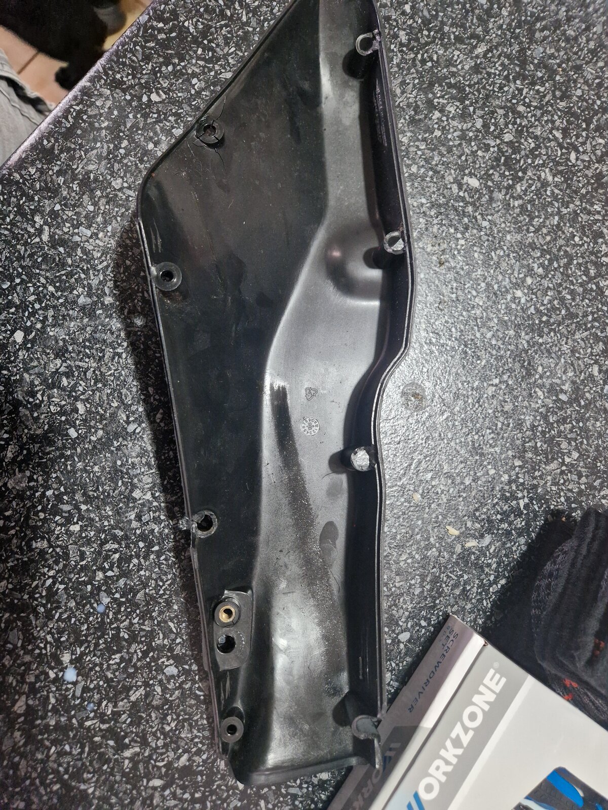

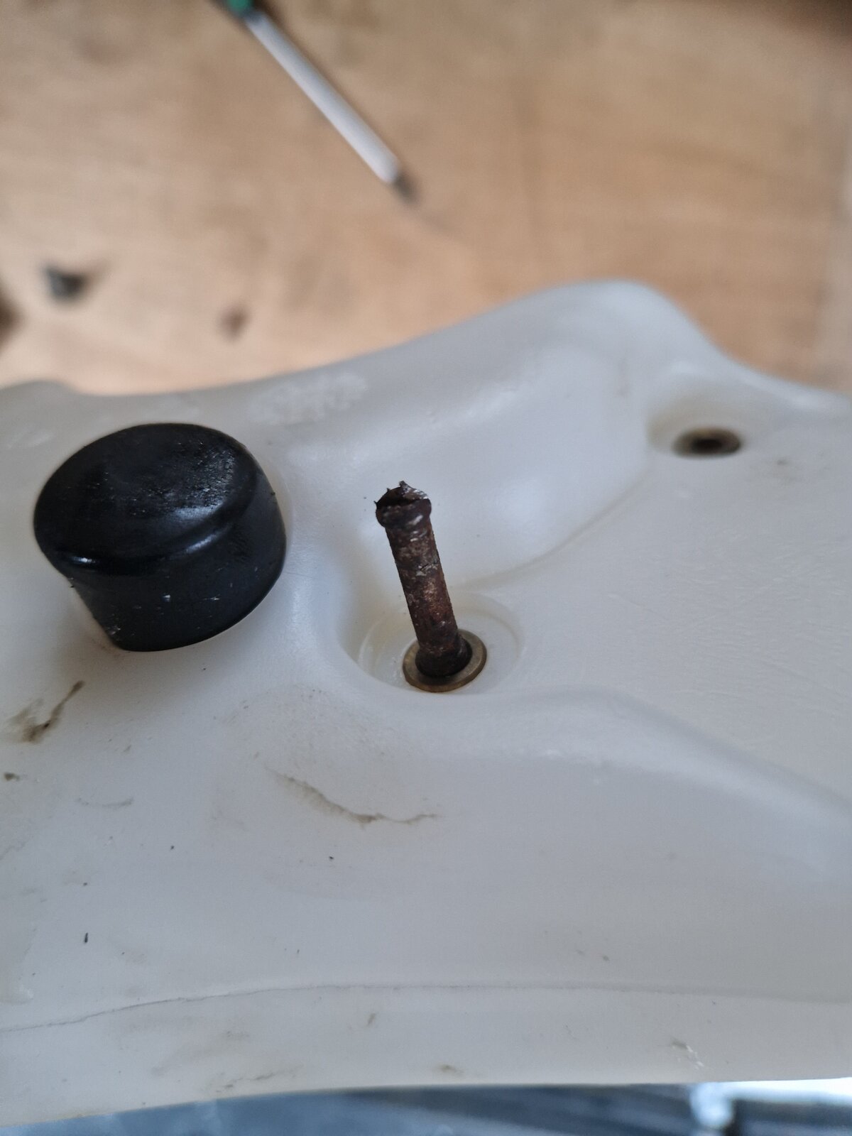

    Stripped the tank out on Thursday evening, only way to get the sir pressure sensor mounting studs out was to heat the plastic, and pull the stud out, complete with the captivated nut, then apply heat to the nut, only snapped one stud, so, not too bad, mind you, at nearly £10 per stud, not too good either :mad:
    Started the reassembly on Friday evening, until the light faded, making it difficult to see
    Whilst the fairings were off, now was a good time to replace the broken intake tube, with a good, unbroken, used part

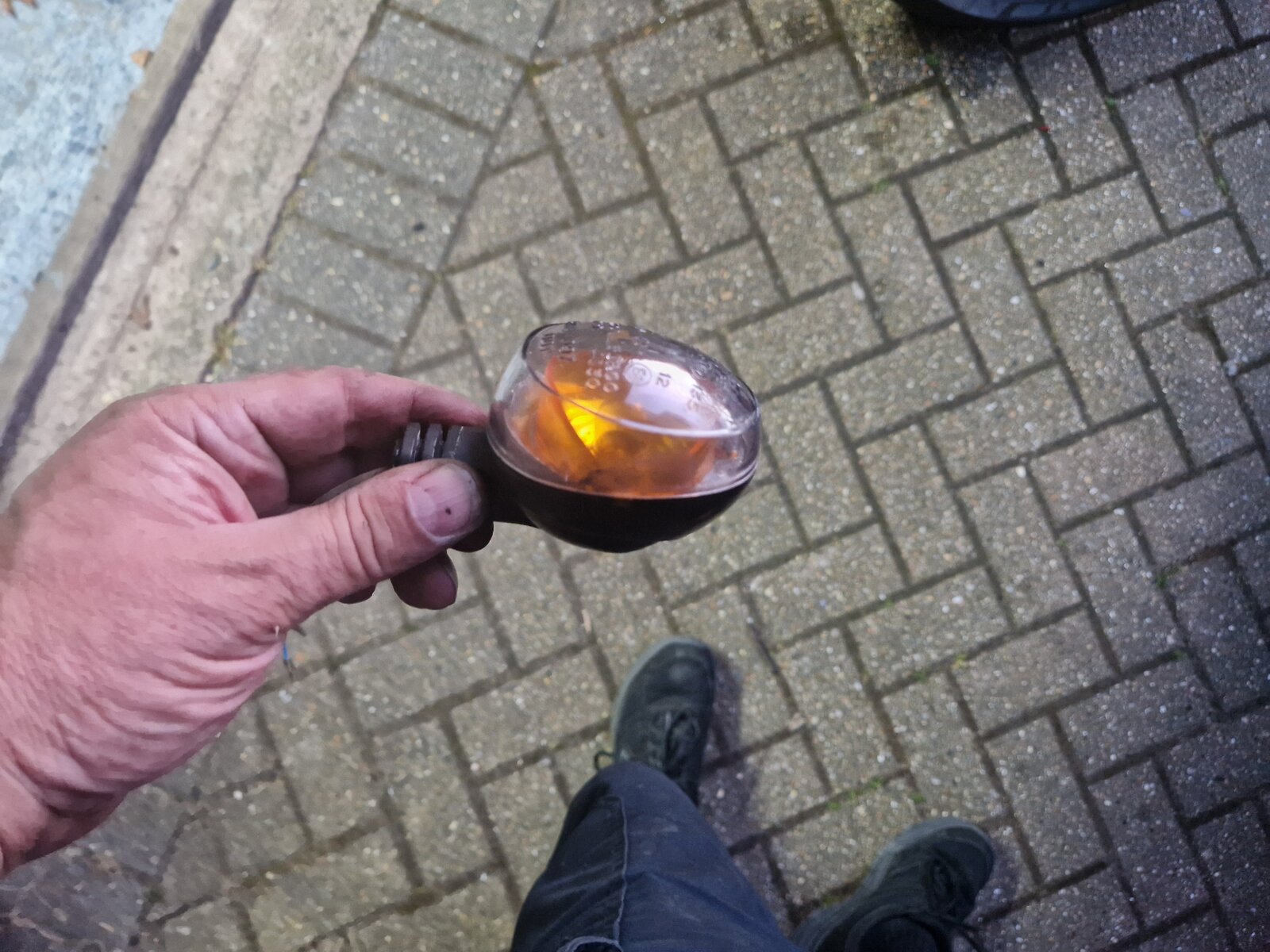

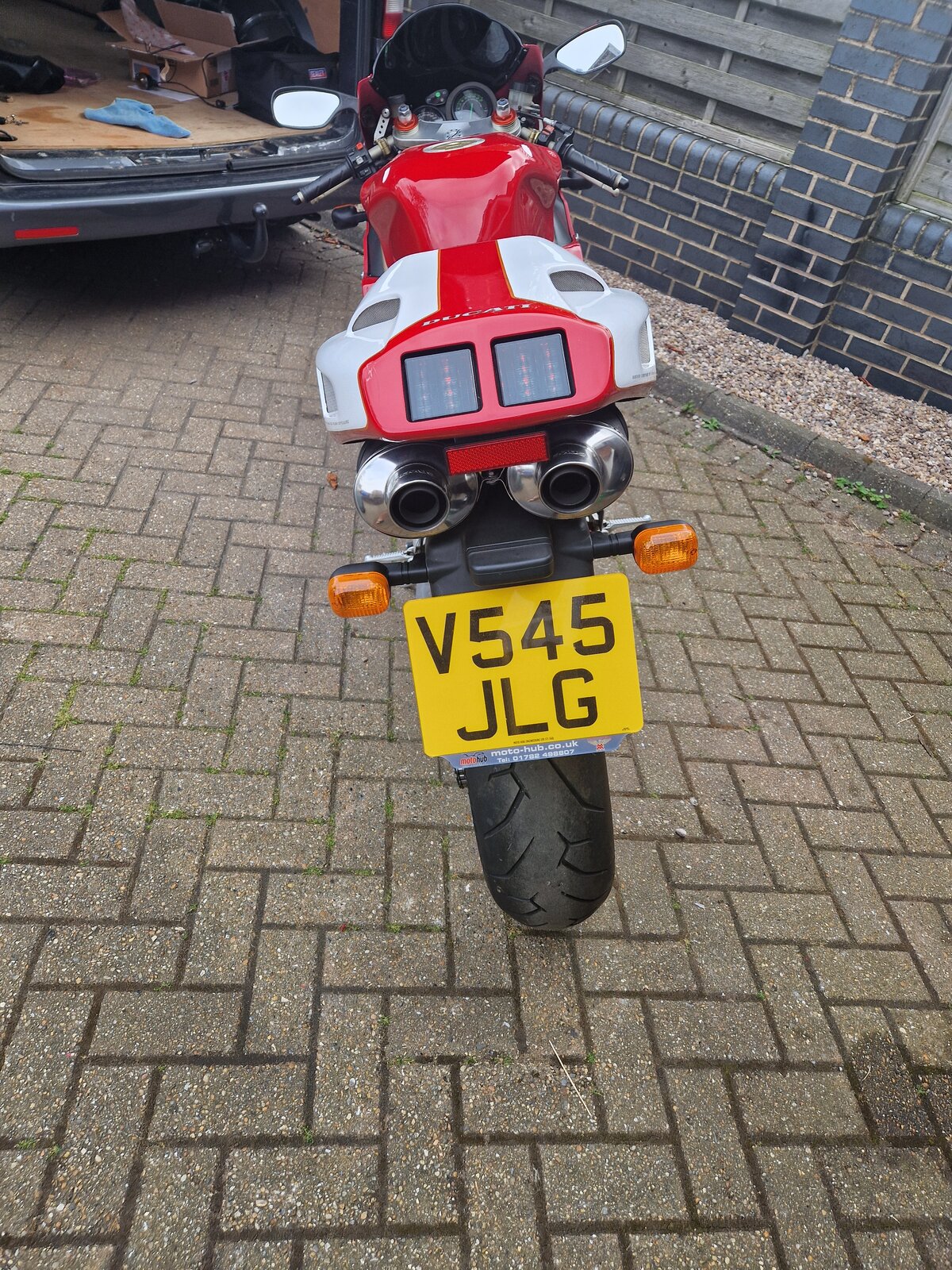

    Next on the list, replace the hideous non standard rear indicators, fixing bolts rusted, and spinning in the rubber housing, a decent set of Angry Pliers quickly saw the rubber housing leave the area, giving access to the nut and bolt
    Much better with the correct indicators, they needed changing for the MoT, as one stalk was broken, once the bike was back together, ran it up to temp on tickover, 20 minutes, no problems :upyeah:

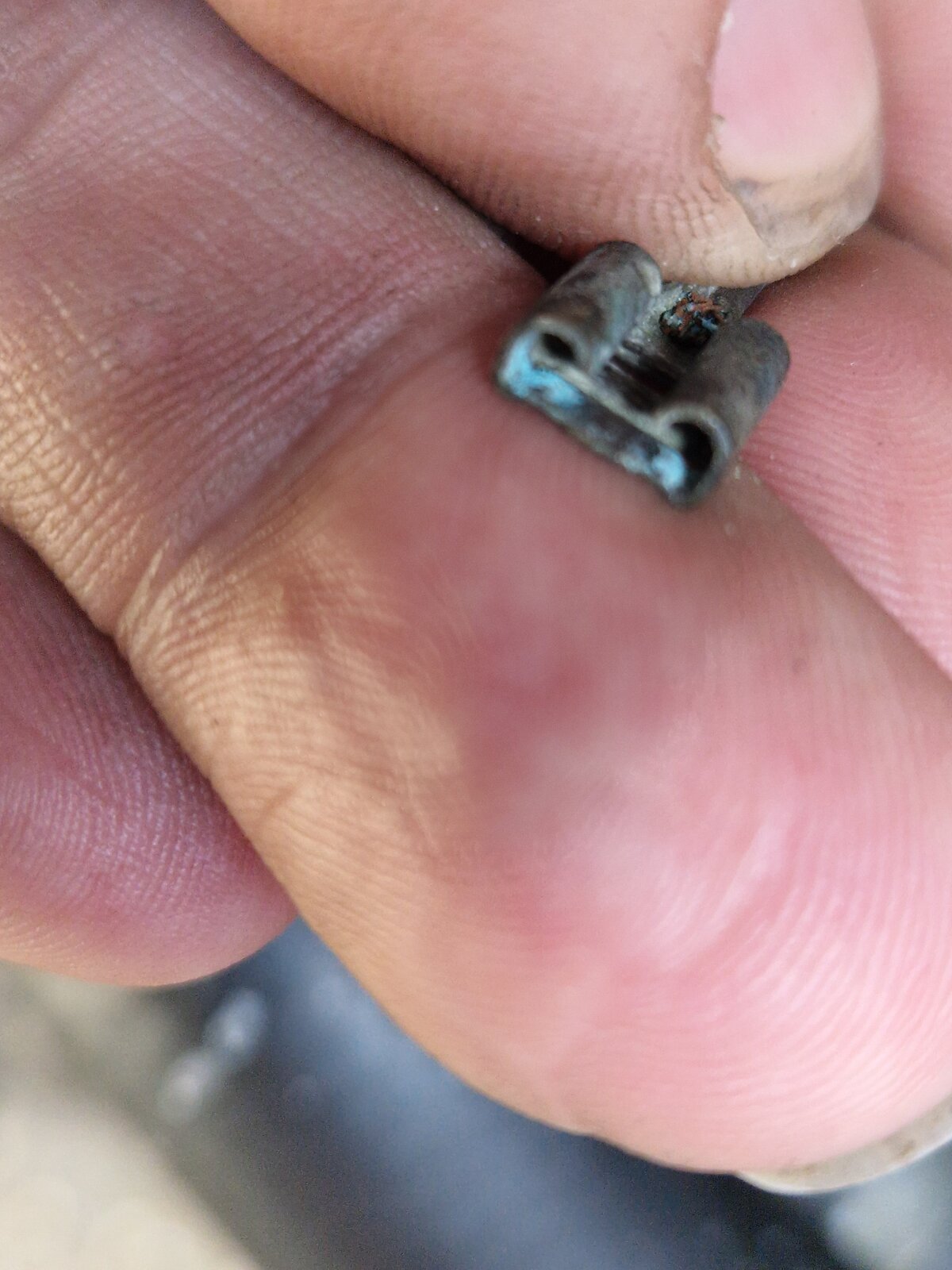

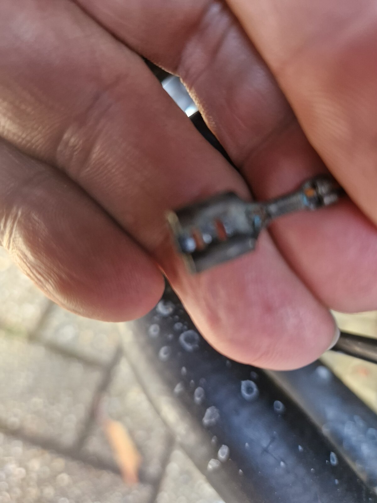

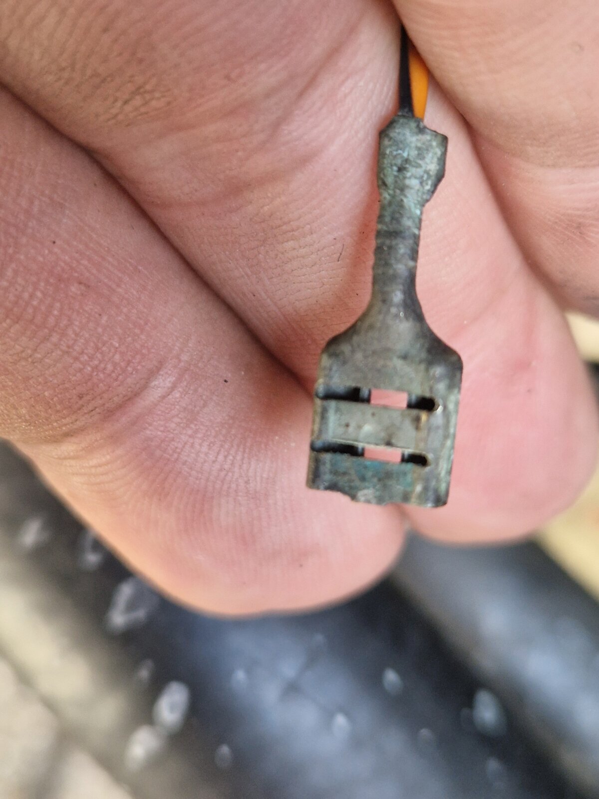

    I have purchased a new thermistor, upon changing it today, I tested the gauge by grounding the wire to the engine casing, it went slowly to max when grounded, I did notice that the connector end has a bit of corrosion on it, so, I have replaced that too

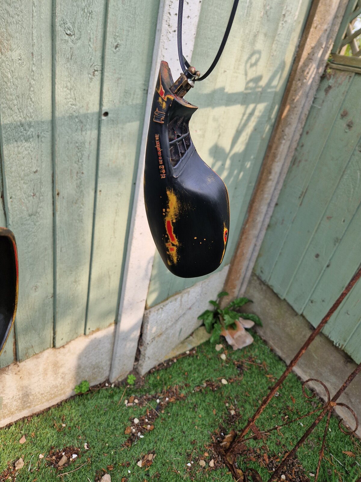

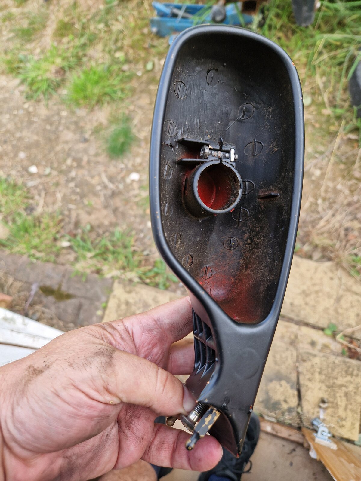

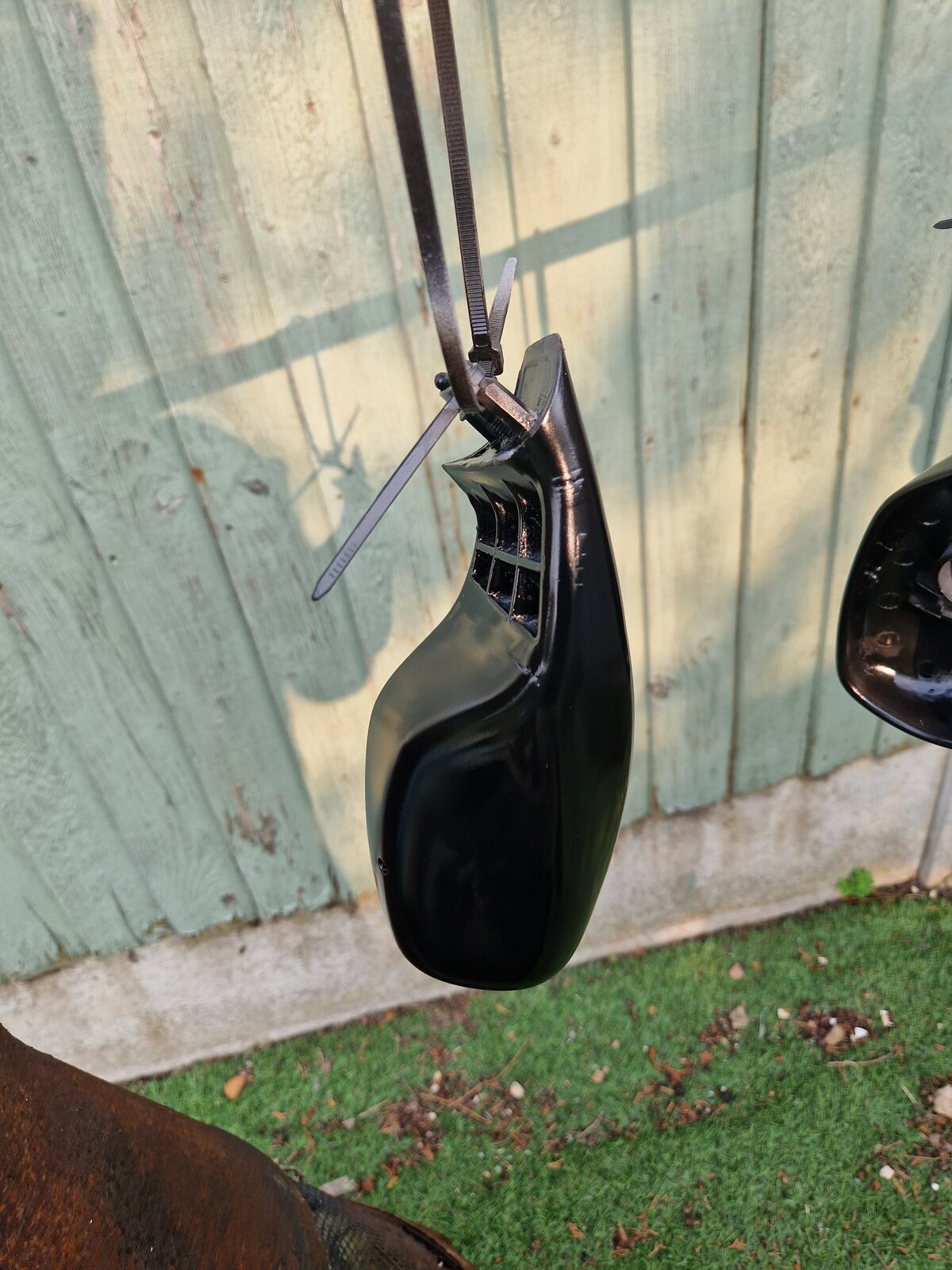

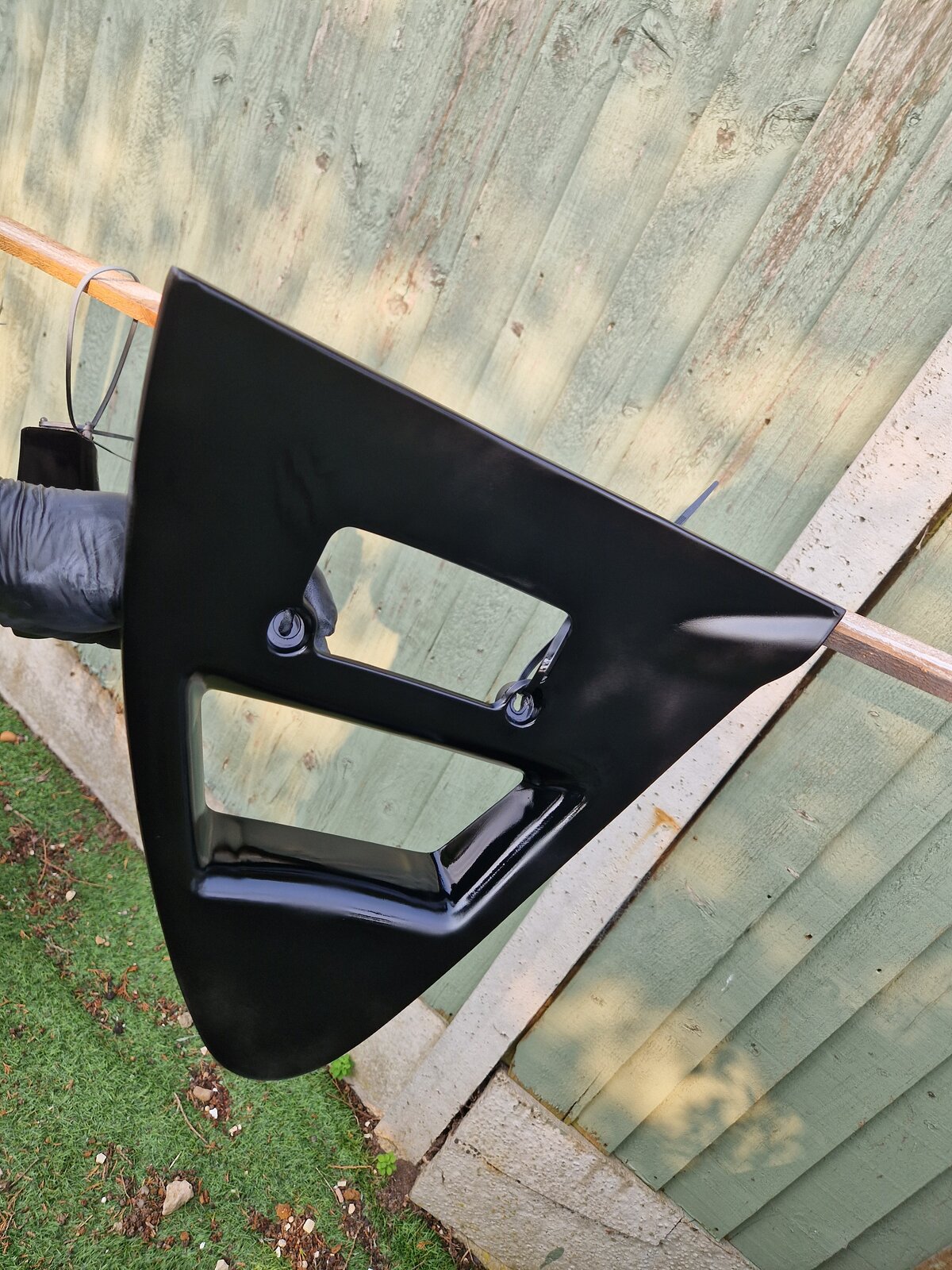

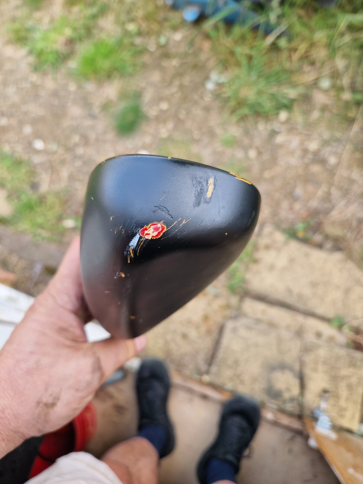

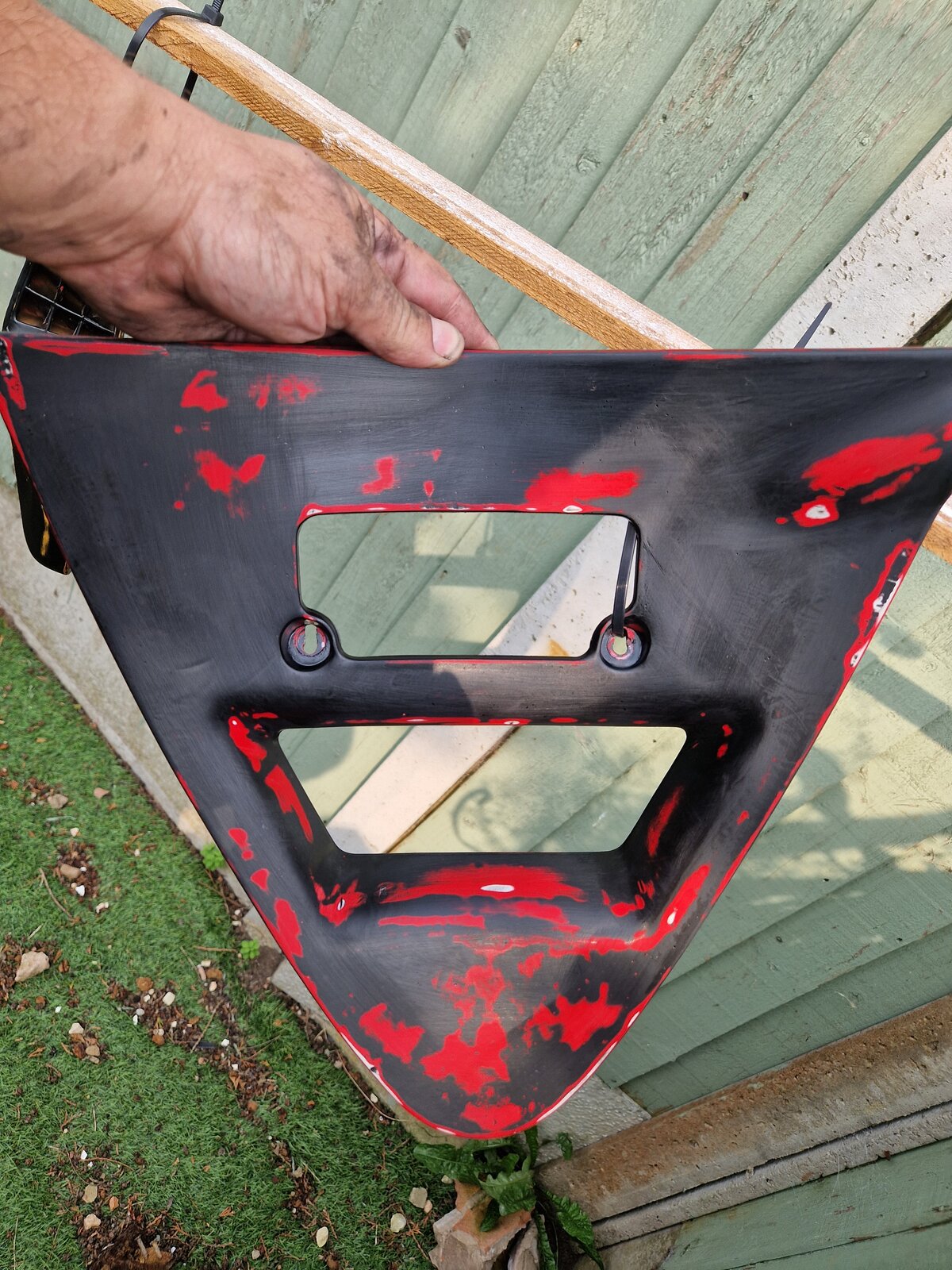

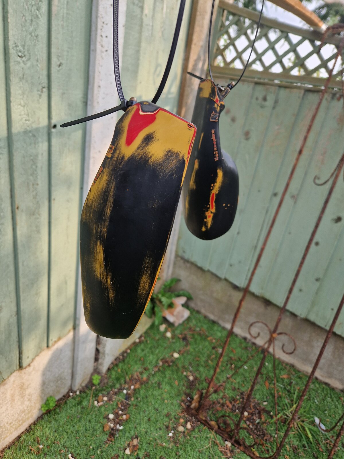

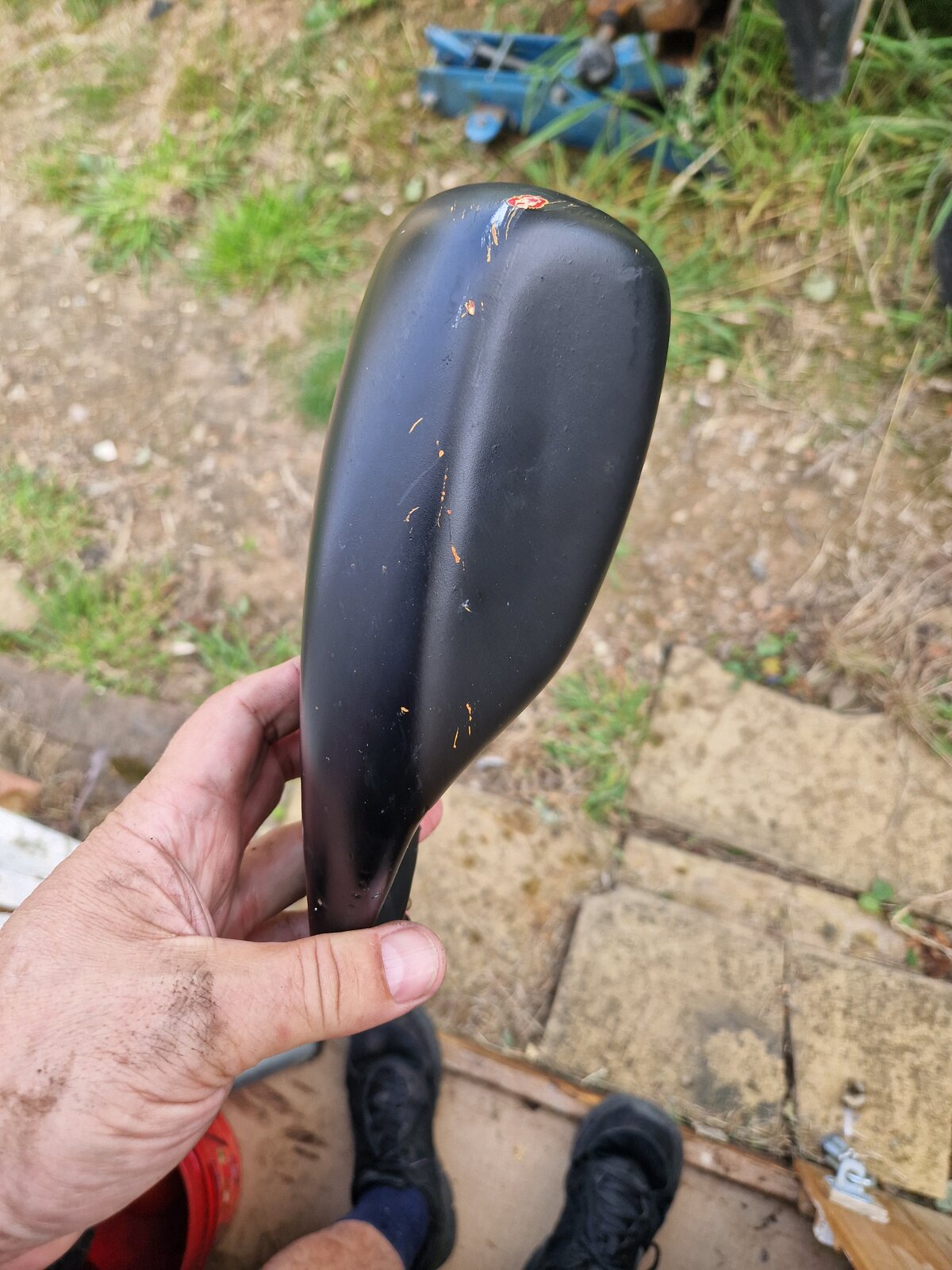

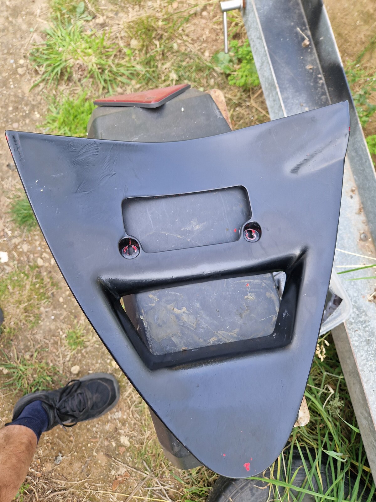

  16. Done a bit more cosmetic work today, the mirrors and V piece have been badly abused in its previous life
    Trip to Halfrauds, other car spares shops are available, to get some more wet & dry, as my previous lot seems to have grown a pair of legs, and walked off, and some more paint
    Before, loads of scuffs, scratches, and chips in the paint
    20240818_162452.jpg 20240818_162455.jpg 20240818_162458.jpg 20240818_163414.jpg

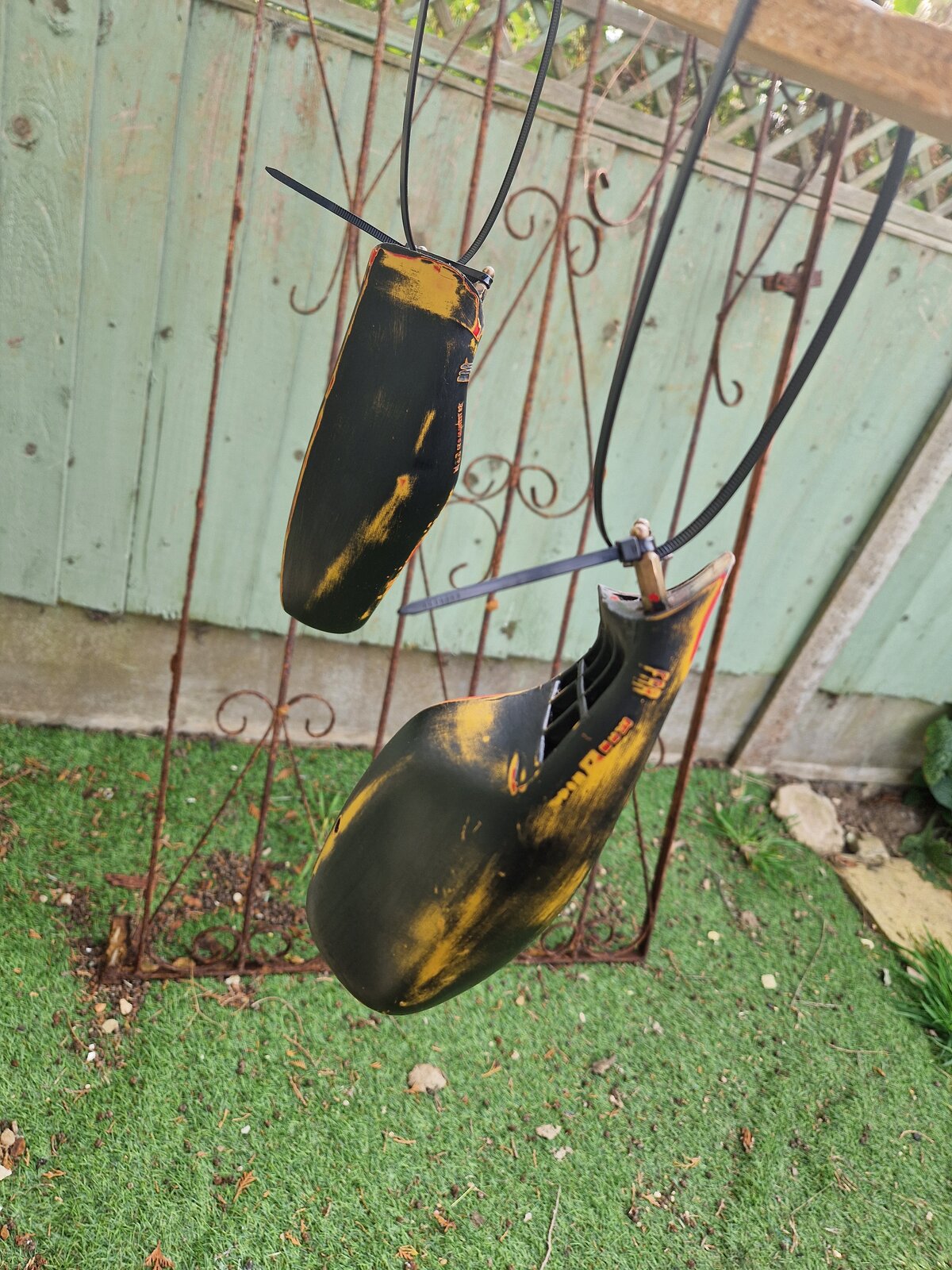

    After a good rubbing over, to smooth out all the edges of the missing paint, it appears that the mirrors were originally red, then, at some point, painted yellow, and at another later point, black
    20240818_163425.jpg 20240818_163427.jpg 20240818_163430.jpg 20240818_164708.jpg

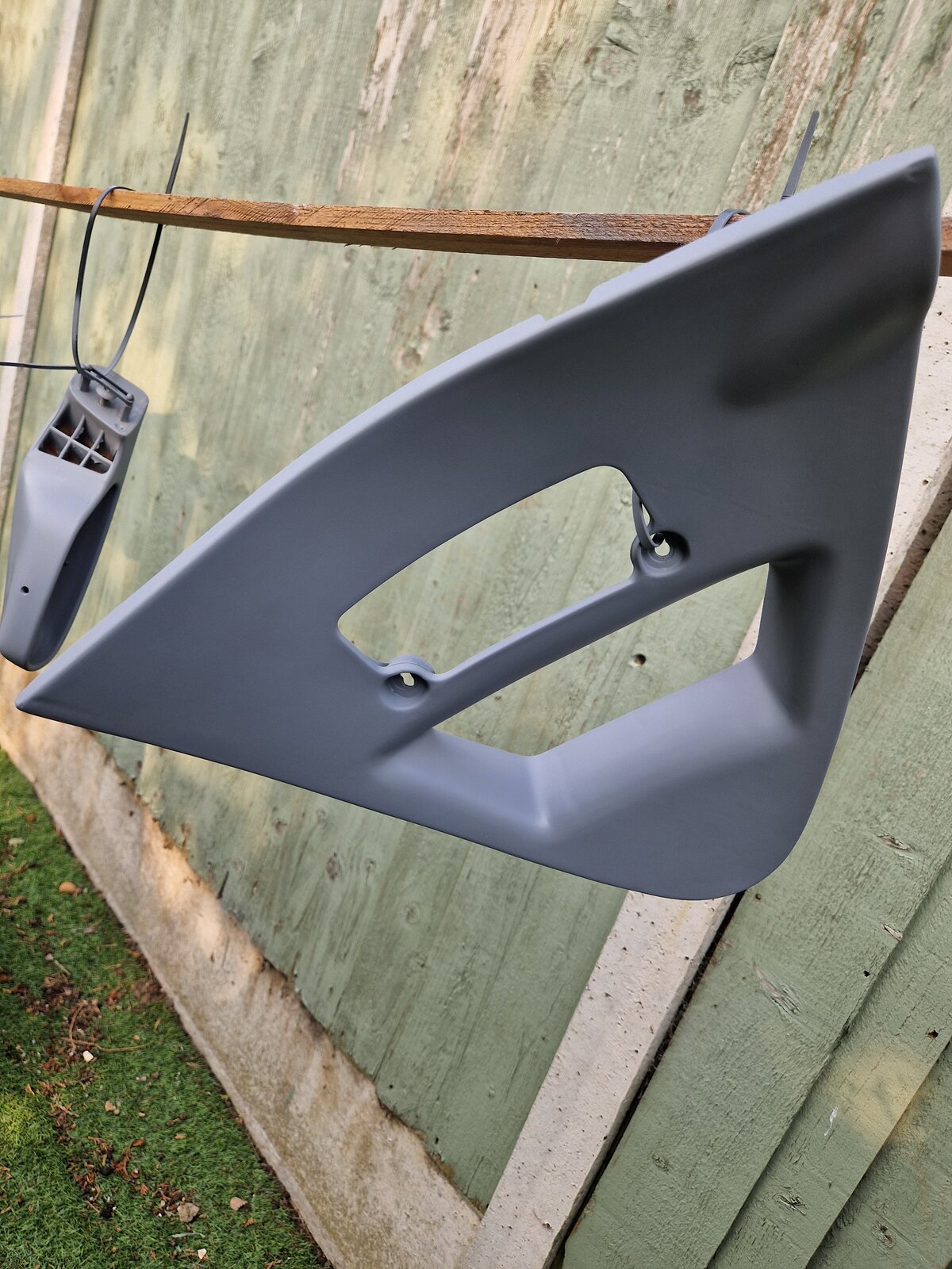

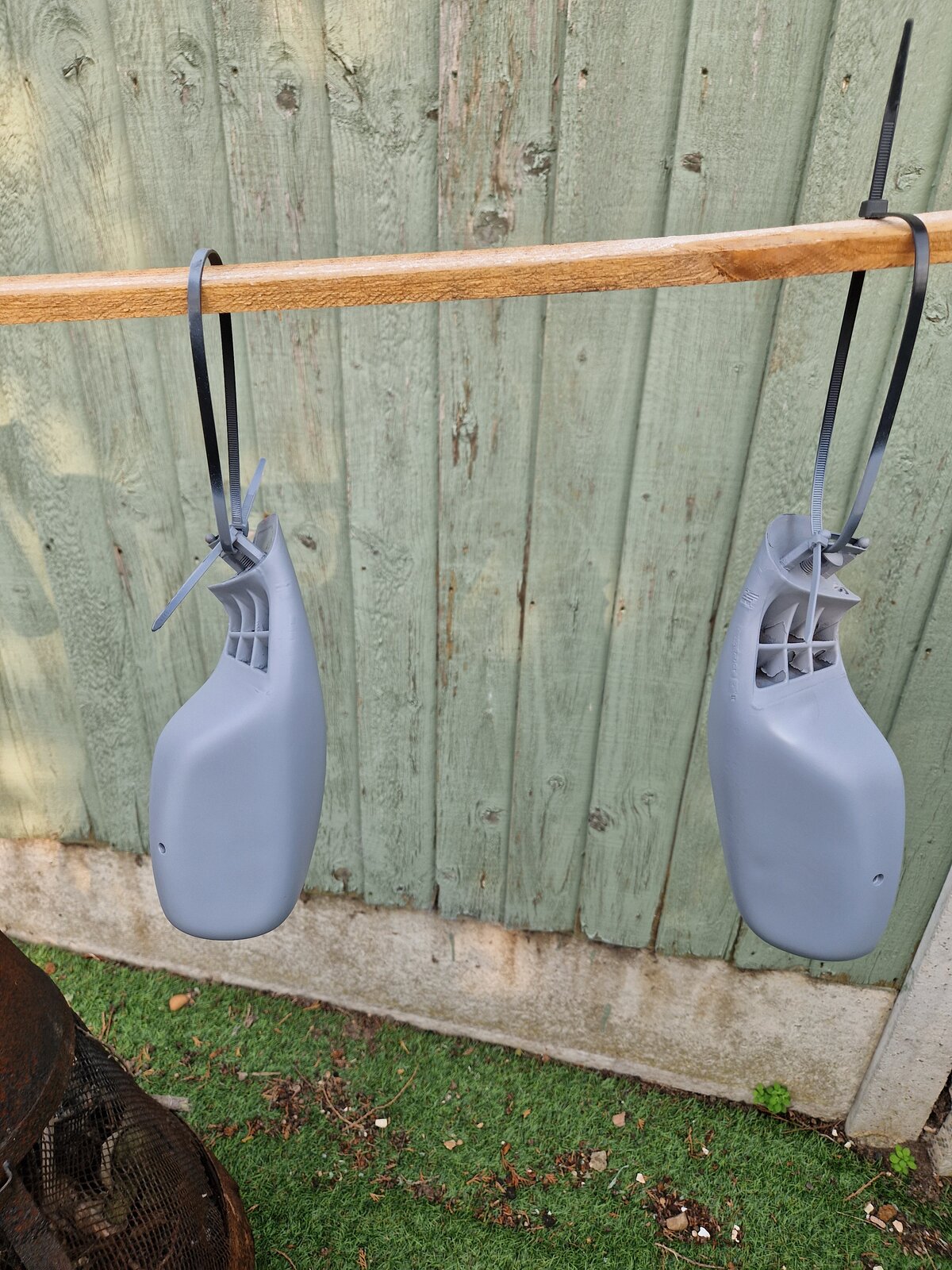

    After a coat of primer, gave them another rubbing down, to flatten the bits I originally missed, then more primer

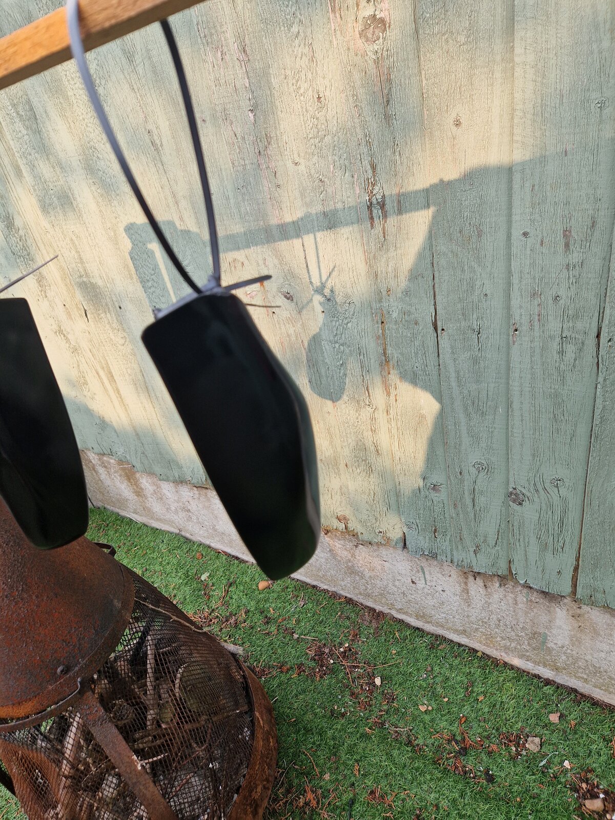

    Quick flattening off with some fine wet&dry, then on to the colour
    A few coats of black, then, hung them up in the workshop to dry fully over the coming week, ready for refitting next weekend
