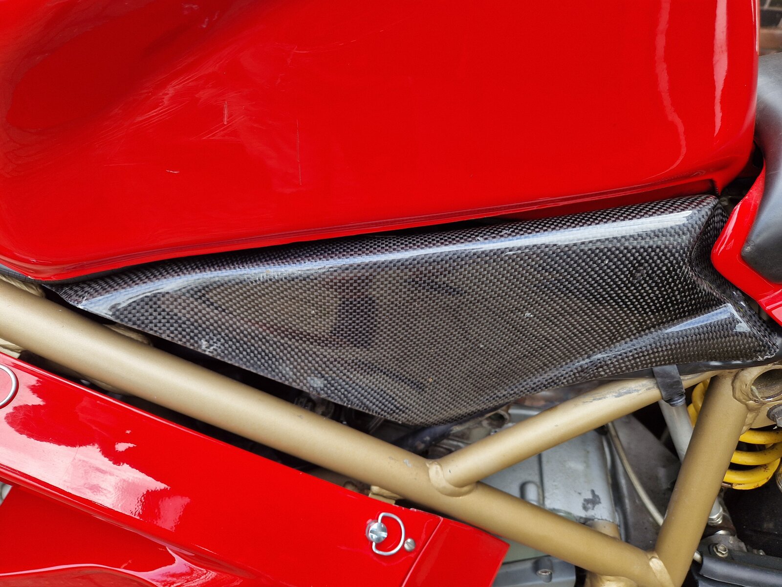

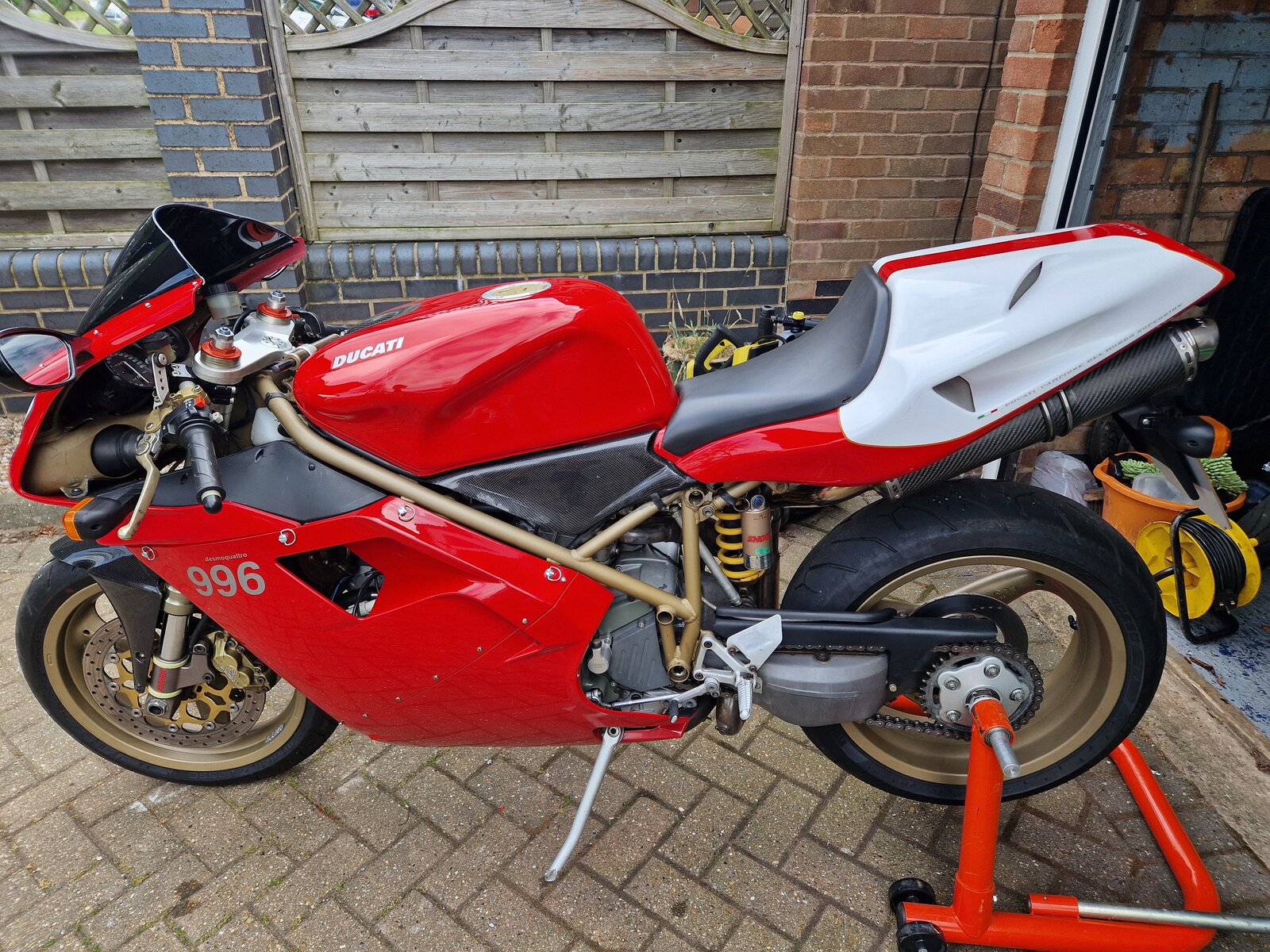

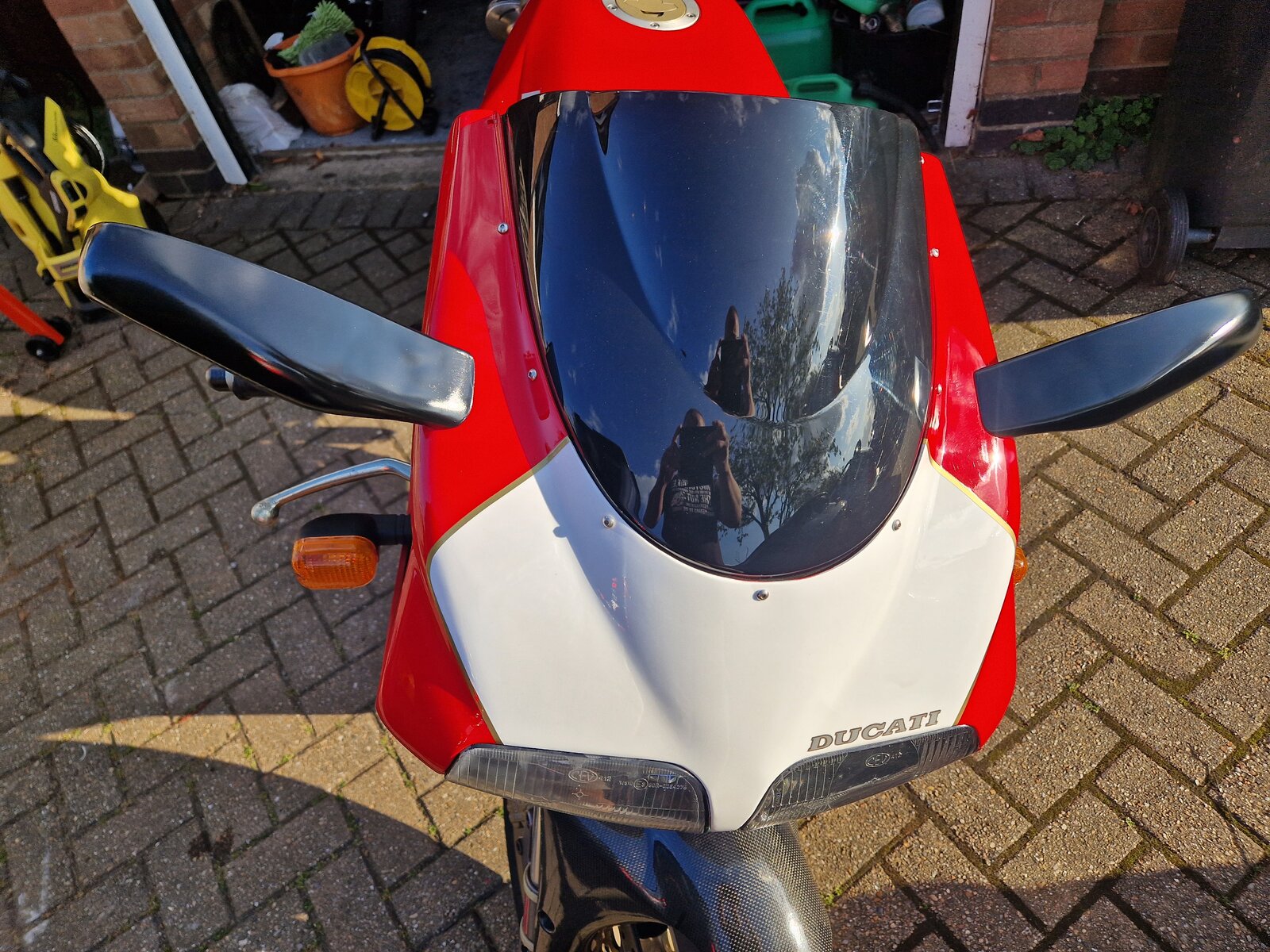

  1. Hopefully, I actually took my time with these, instead of the usual rush job
  2. Quite happy how these have turned out :upyeah:
    They make such a big improvement on how the bike looks now too :D

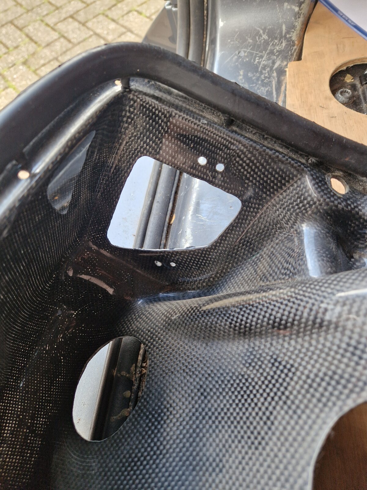

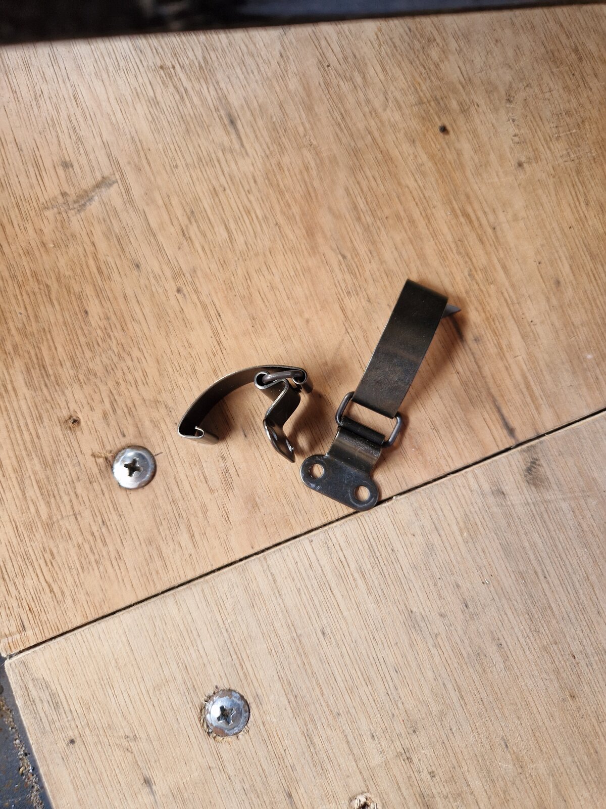

  5. Back at Easter, I bought a carbon airbox from @cookster

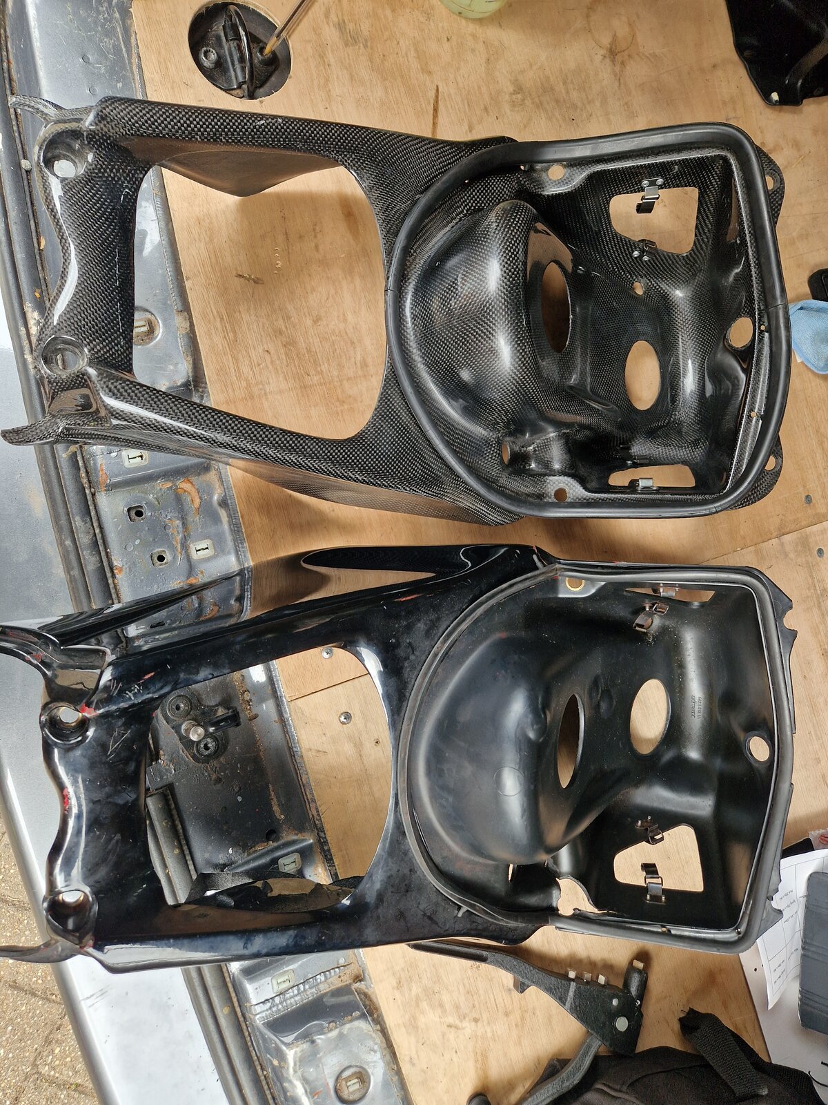

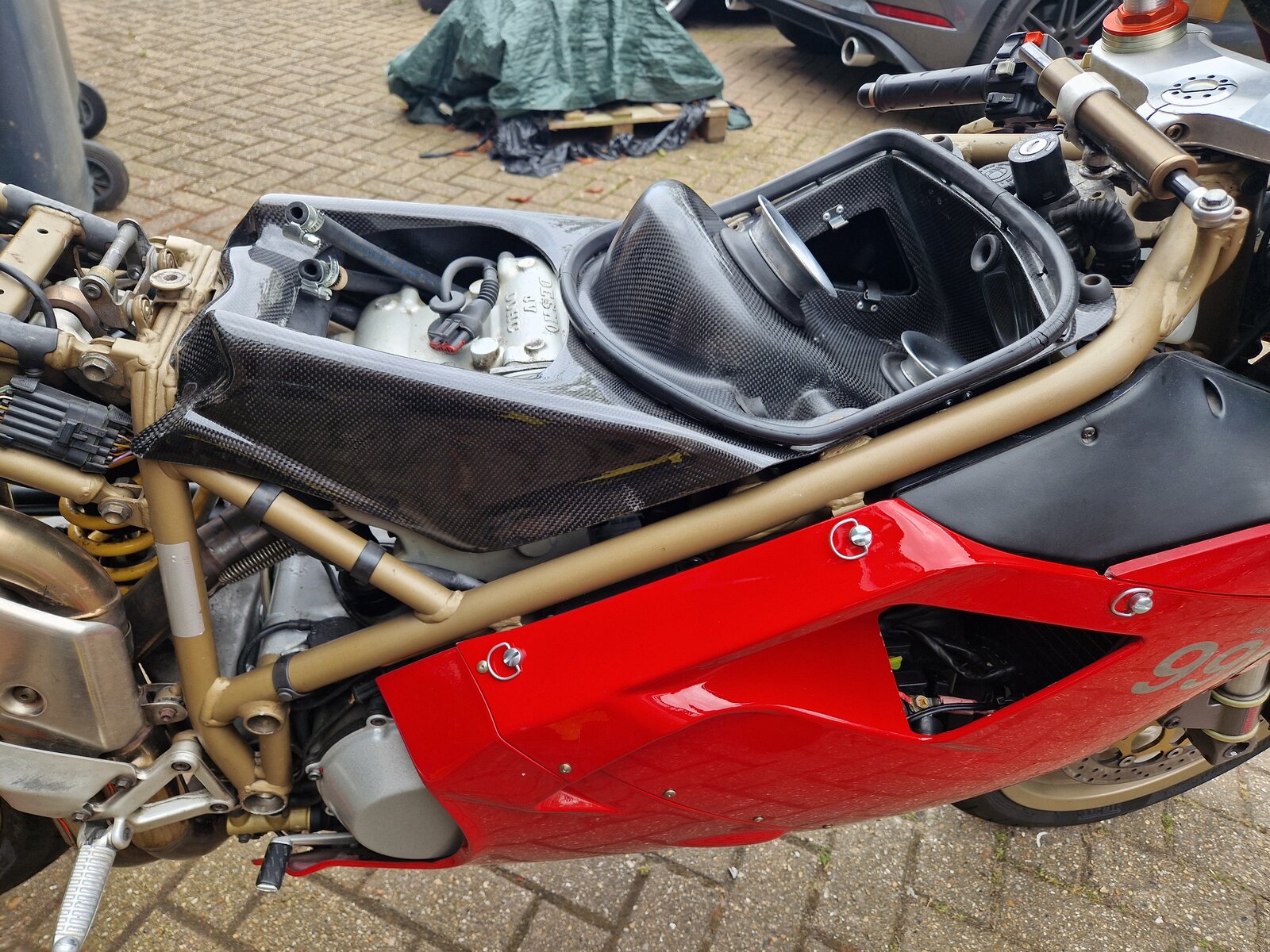

    I eventually got round to fitting the air intake tube clips to the new airbox, the holes on the airbox were slightly oversized, and the rivets were just pulling straight through, flat washers to the rescue :upyeah:
    Old, scabby, broken airbox removed, ready to fit the new (to me) carbon replacement
    Bit fiddly to fit, and get the pipes and wiring loom in the right places, but, got close enough in the end :D
    Looks so much better (although, I'm still not a fan of carbon)
  6. @Robert Colliver
    Two comments looking at this picture: 3F55323D-6CDD-4F7E-9115-BBE71309974E.jpeg
    1/ Your new carbon air box could definitely use a new rubber gasket. Proper sealing with the fuel tank is absolutely essential to the “916” air intake design.
    https://www.ebay.co.uk/itm/274535217770
    2/ You also need quick disconnect fittings for your fuel pipes and must get rid of these garden water hose clamps. The metallic quick disconnects are almost indestructible, once fitted properly. The (OEM) plastic ones not so much…
    https://www.desmo-racing.com/en/kit...748-900-mhe-916-996-998-xml-245_544-1818.html
    And never forget that whatever it is, your Tamburini deserves it!

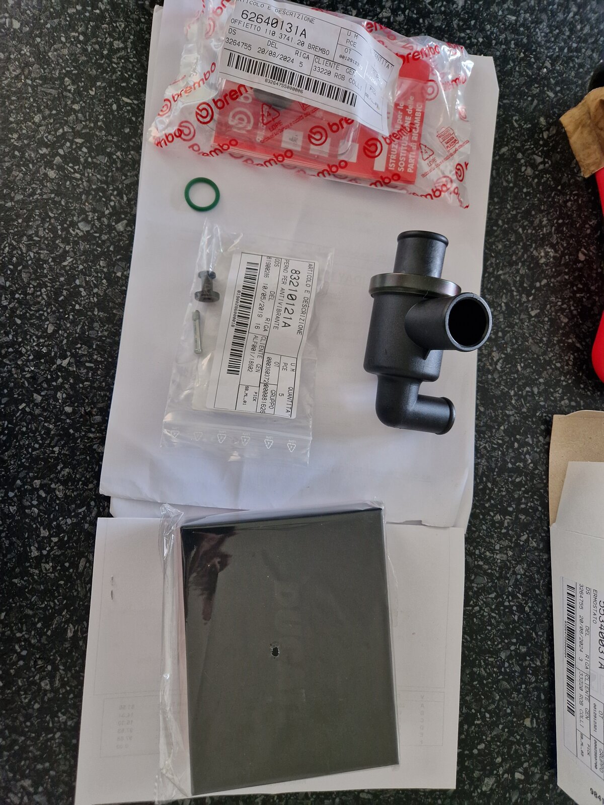

  7. More parts for the pig
    New thermostat, new locating dowel and rubber grommet for the air pressure sensor on the expansion tank, new rubber gaiter for the rear brake master cylinder, new rubber o ring for the filler neck, in case I damaged the other new one when fitting
    Oh, and a present for me, for my birthday, thought I had best buy it myself, sering as nobody else did :D

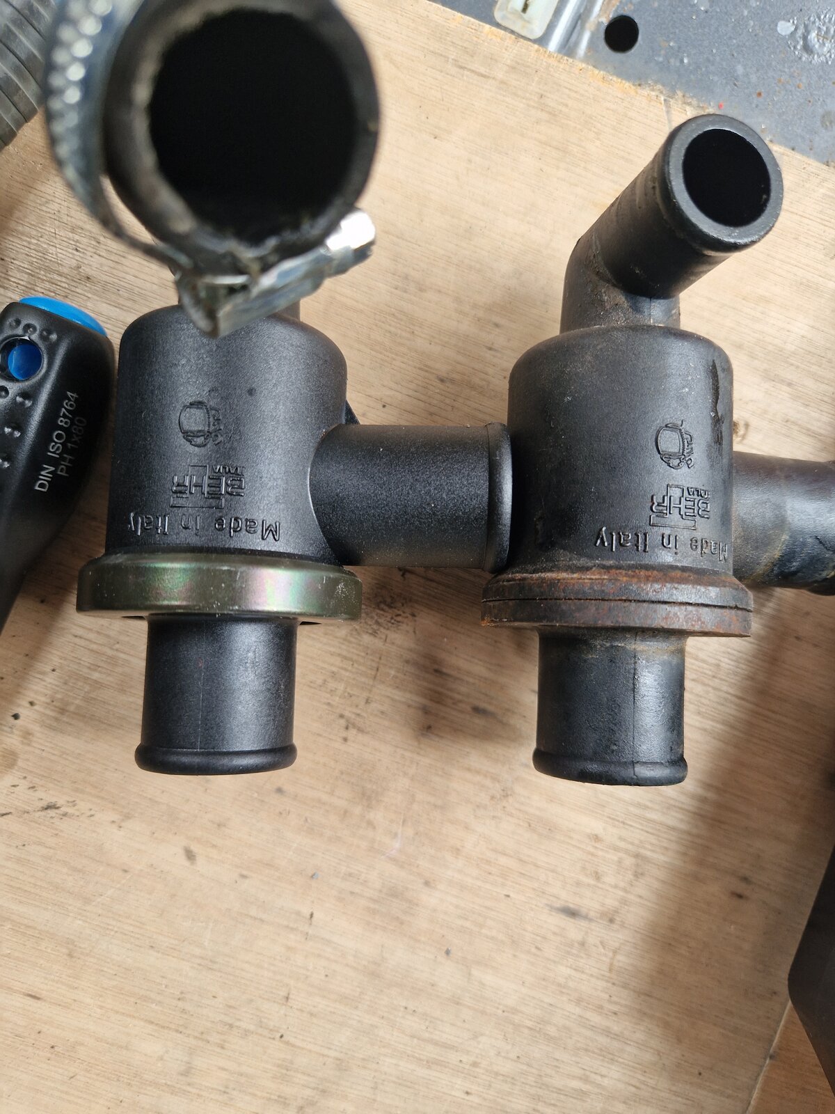

  9. I would presume that the new thermostat doesn't require the locking ring from the old unit? 20240831_133238.jpg 20240831_133245.jpg
    The new part appears to have a pressed metal ring around it, whereas, the old part, when the metal ring is removed, it is clearly two separate parts, if I try and refit the old ring over the new part, the bolt is not long enough

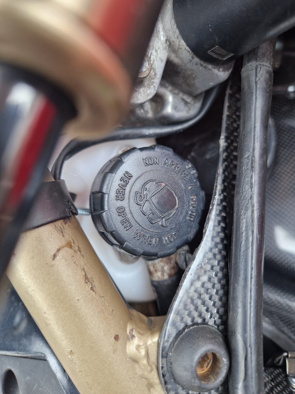

  11. Thermostat removed, system flushed with garden hose to remove all the old green coolant, thermostat refitted
    Whilst I was at DC this morning, I just happen to meet Mr Hackett, the owner, struck up a conversation with him about The Pig, and it's issues, he suggested the thermostat as a starting point, at which point, I waved the new one at him :joy:

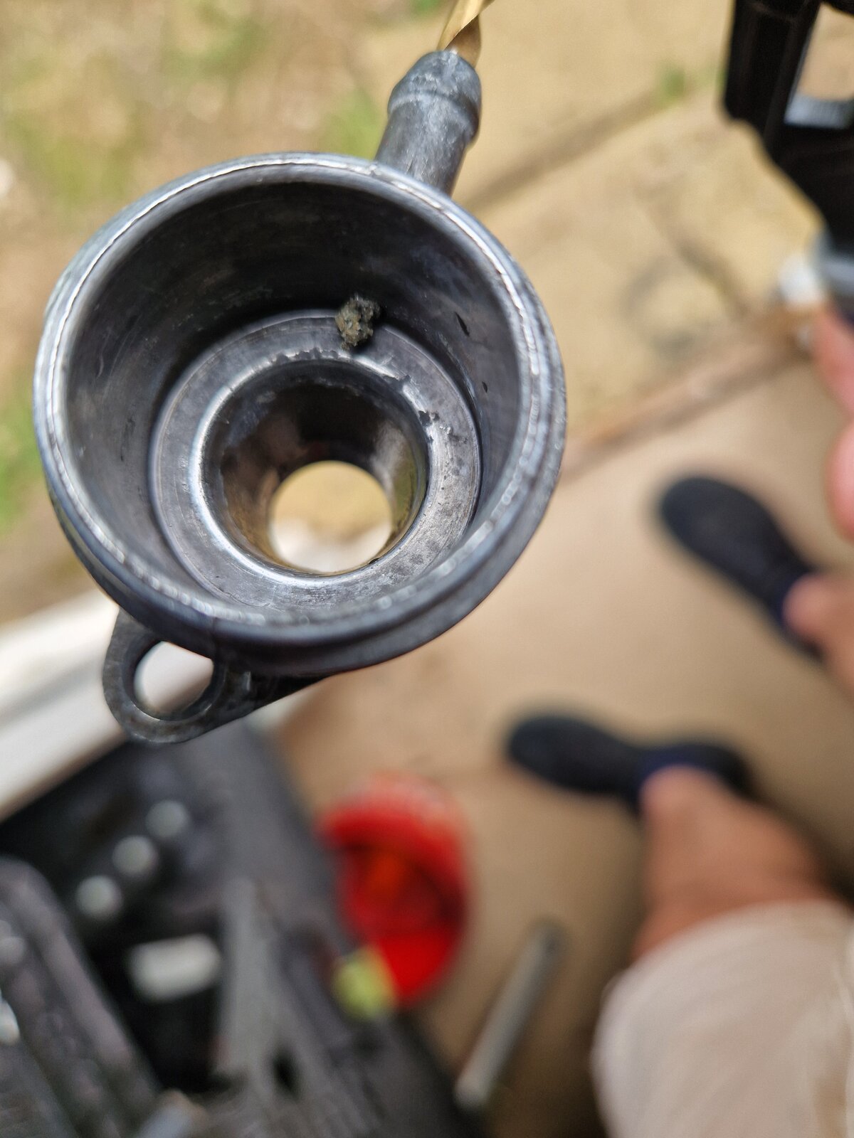

    He also asked if I had checked/changed the radiator, I told him that I had checked it with a laser thermometer, and the temps were all pretty close, I told him what it was doing, and, he then suggested the overflow pipe on the filler neck, remove the rubber hose, and run a 4mm drill bit through the metal piece, as that can get a bit clogged up, it didn't look too bad, but, I did it anyway, by hand, no power tools
    Some crap came out, ran the drill bit through a few times, gave it a good clean, refitted it to the expansion tank, refilled the coolant, fired it up, topped up the coolant after the air came out, had it ticking over nicely for about 45 minutes, no coolant loss, no steam, no bubbles, after turning it off, had a closer look, no signs of coolant spray on the airbox or any hoses in the area, and, more importantly, no wet patch on the floor :D
    I'll call that a win, for now :joy:

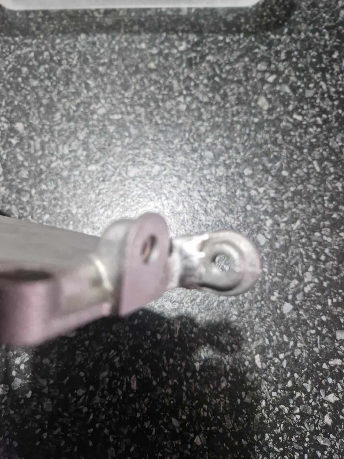

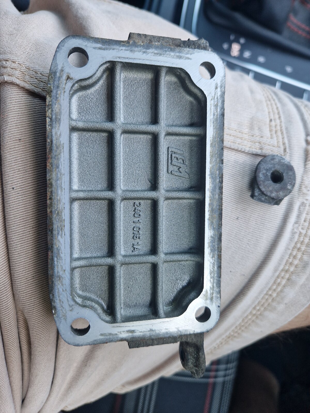

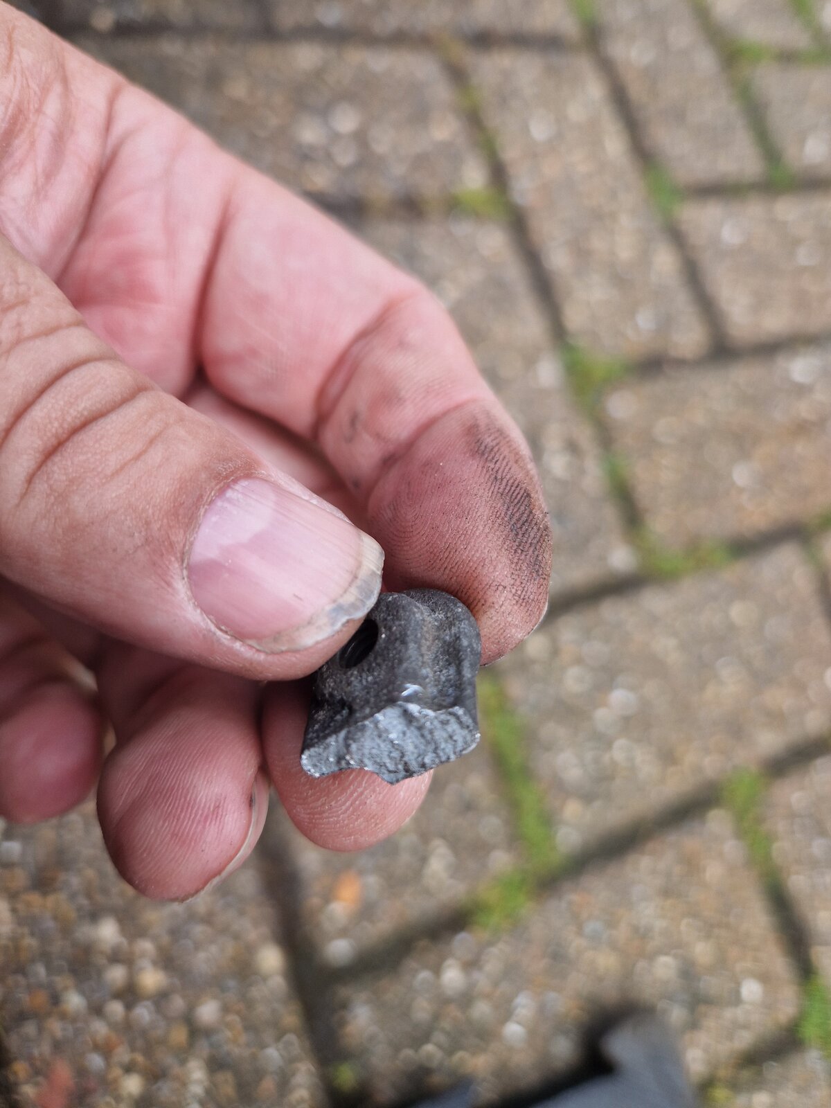

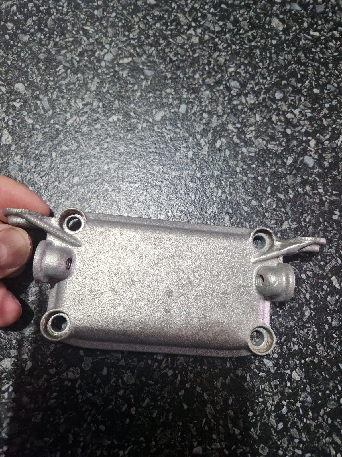

  15. Next on the list.....

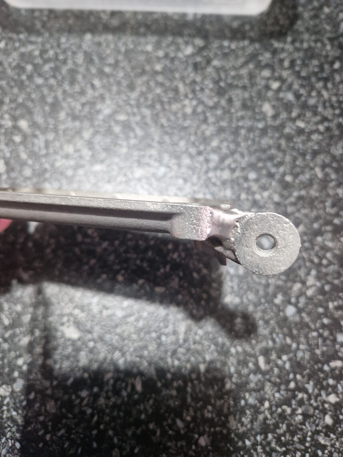

    Some heavy handed neanderthal used a bolt that was too long when refitting the V panel, thus, snapping one of the fixing points on the horizontal valve cover
    Time to get it sorted, two bolts came loose, the other two didn't want to move, the Allen key just rounded out the hole, Torx T40, big hammer, and a 3/8 breaker bar got them out
    Parts off, cleaned, taken to the welder for repair
    Just got to wait for a phonecall now, when it is ready for collection
    At £135 for a new horizontal valve cover, or £10 to get it welded, being the Yorkshireman that I am, it was a no brainer :joy:
  16. If a cowboy has been at the Bike make sure the correct bolts are fitted that secure the cover. Seem to remember if they are too long they damage the cam carriers
  17. Looking back through the thread, I don't think it was a cowboy, it was more like Stevie Wonder :mad::joy:

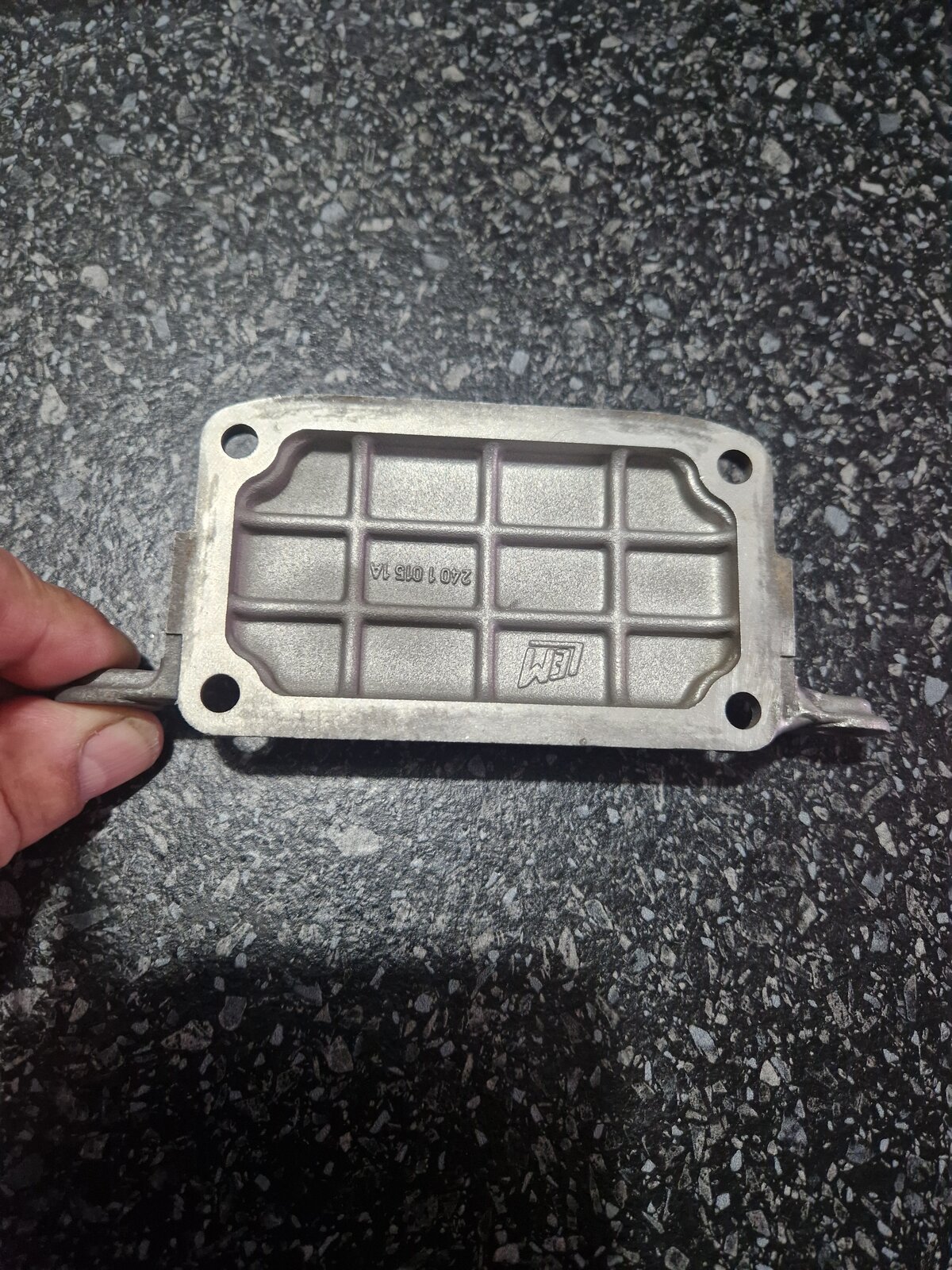

  18. Had a text message this morning, saying my bits had been welded, so, went over to collect them
    £10 well spent :upyeah:
    20240918_094924.jpg 20240918_094927.jpg 20240918_094931.jpg 20240918_094936.jpg
    Now, I just need to take a trip over to Ducati Coventry, to collect a new gasket and a couple of new bolts, then, it can be refitted
    • Like Like x 8
