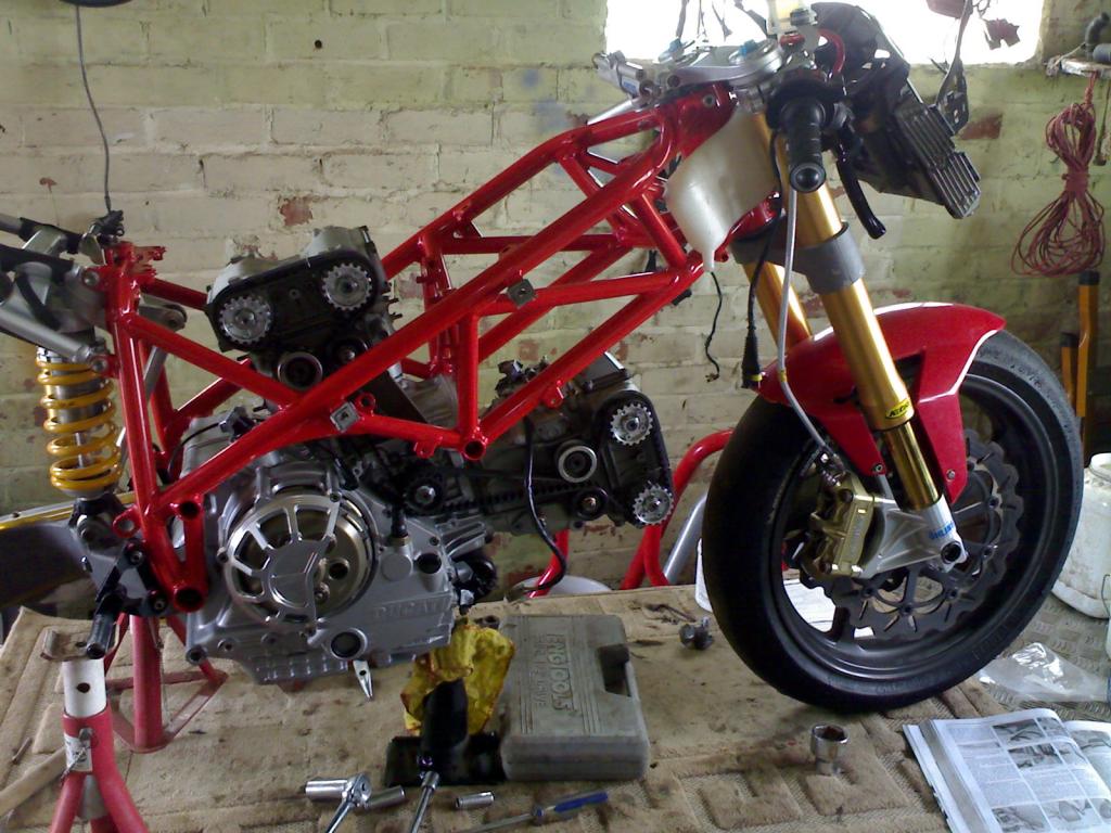

  5. You'll soon be doing some of this!
  6. Or some of this....
  7. Which will get you this :upyeah:
