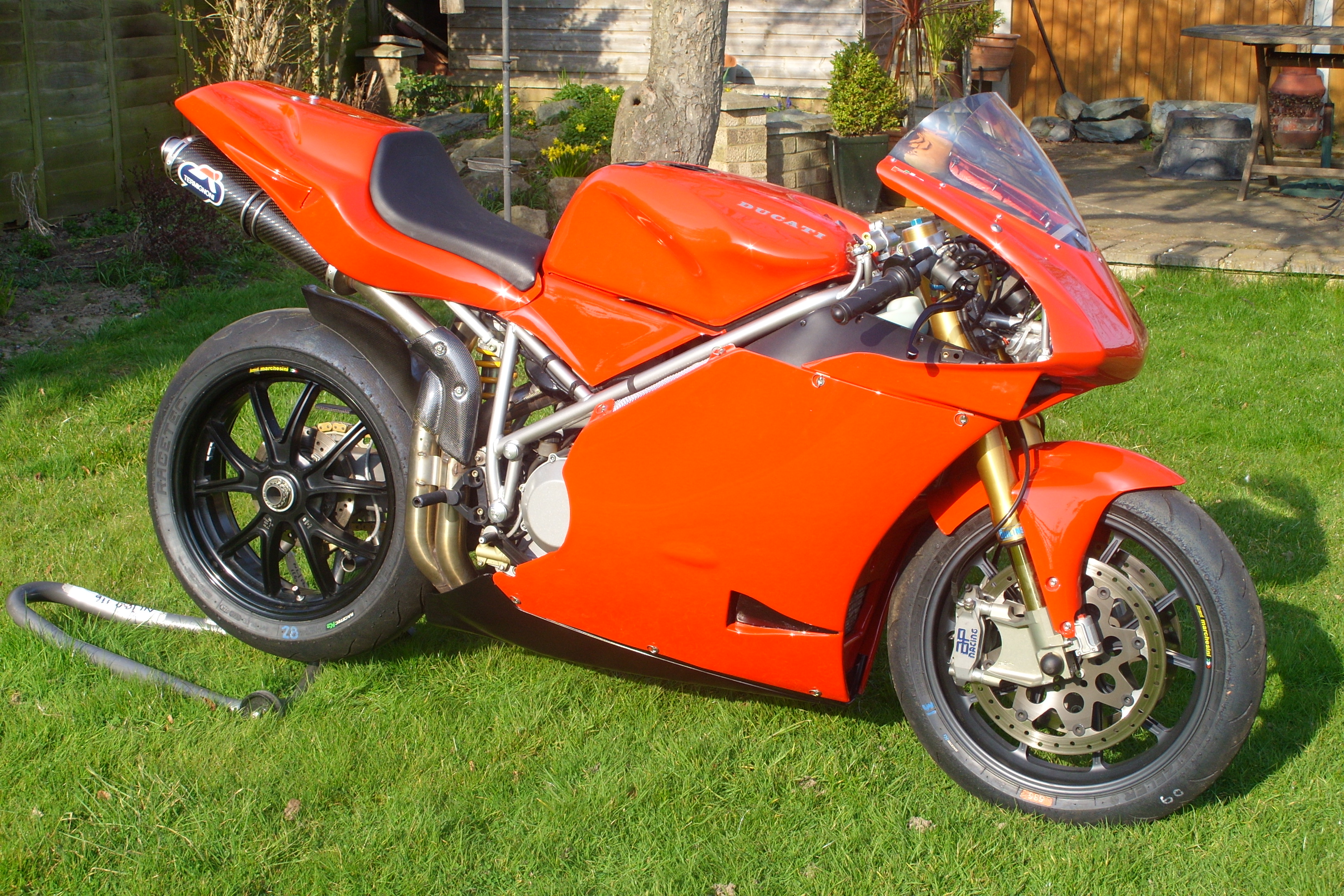

  5. Mine,
  6. That ^ needs a 1098 in it...;)
  7. that need an 1198 in it......:Banghead:

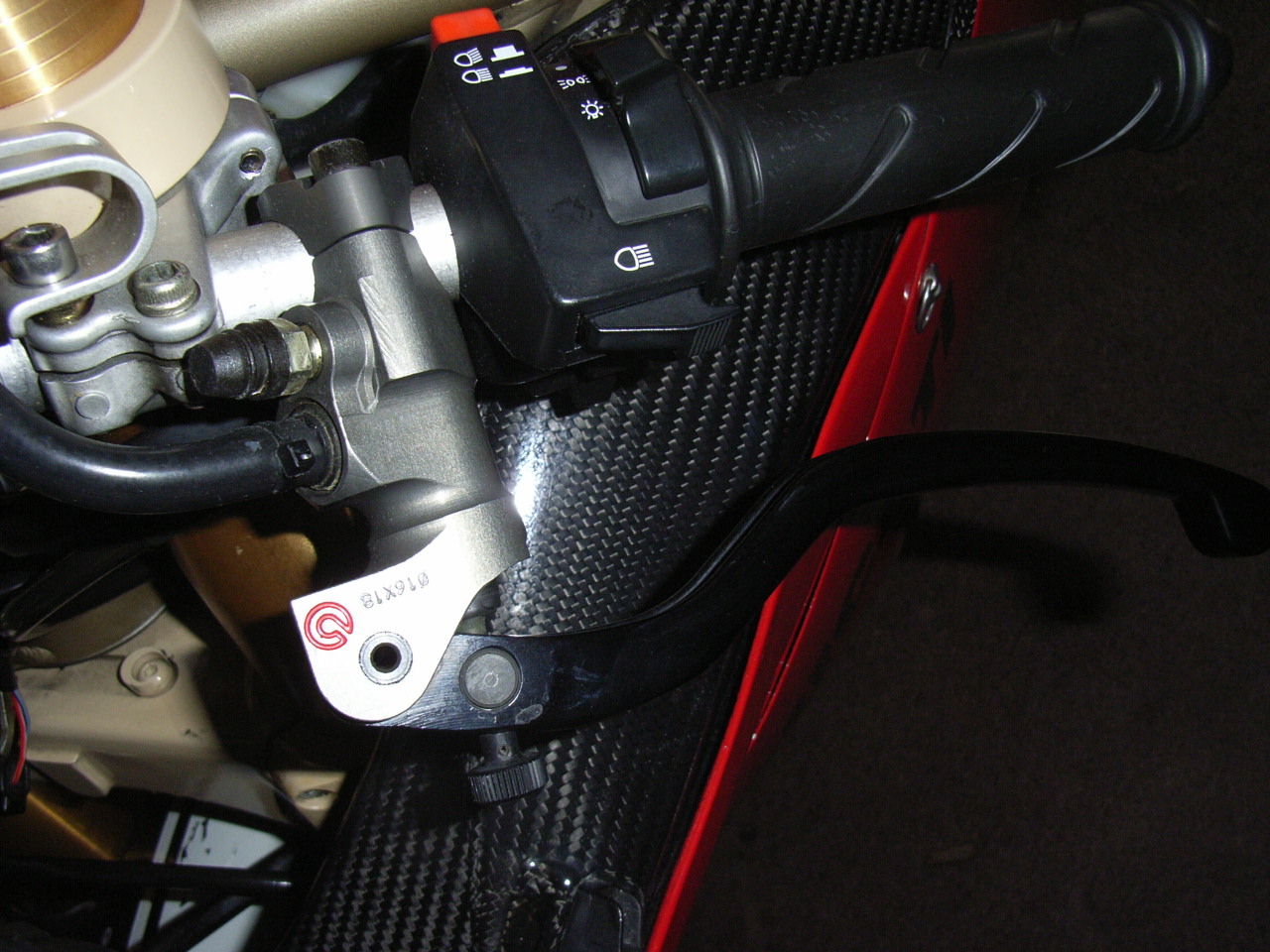

  9. Have you considered fitting a Brembo RCS master cylinder? Its not going to be as good as the expensive but lovely options above but it still offers a worthwhile improvement IMHO.
  10. Some Brembo radial master cylinders don't quite fit if you have stock handlebars as the handlebar switch can get in the way. This has been mentioned on here before, one poster mentioned that he had to file away the bleed nipple to get his to fit and when I tried to fit mine the stock handlebars were too short by a few millimetres.
    You might want to check this out before you buy one

    i ummed and arrhhed about this for front brake upgrade for 11 years! i have a 998s bought new in april 2002 with the 65mm calipers. over the years (and quite a few track days) i tried different pads, no better, then an 18mm radial brembo master cylinder and HEL twin lines........better.....but still a nagging presence that there was still an improvement to be made.
    i could not be bothered with the expense and sourcing hassle of Ohlins forks and caliper carriers, discs etc etc etc. my existing Showas had been internally upgraded at K-Tech..............so..........early this year I bought a set of bolt straight on Beringer Aerotec 6 pots in black with the same radial m/c. now your talking! £900 the pair though and well worth it if you are into serious stopping power.

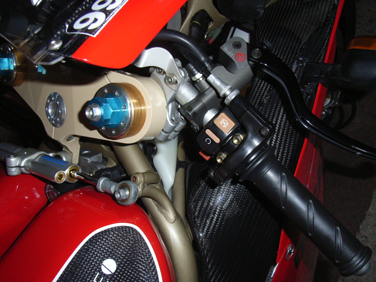

    You can buy some longer bars from SES which help a lot. I also moved the handlebar switches to the other side of the brake m/c. Now works a treat and no one notices that the switch is the 'wrong' side of the brake lever.
  13. I have a Brembo RCS m/c on my SPS with standard bars - fits fine.
  14. Weird had no problems with fitting brembo radial m/c's to standard bars on my 996BP or current bike.Managed to get hold of a new billet brembo radial brake m/c for the second set that went on sps to match the billet clutch one .Only problem is brembo radial clutch mc just nips the corner of standard speedometer on full lock.

  15. ^^^ There are two types of handlebar tubes fitted to Ducat's I found this out when I wanted to a radial cylinder to my bike I found that the switch hole and original master cylinder positions are slightly different if I wanted to fit them and the radial master cylinder in question. Which no doubt explains why some people have no problems fitting radial master cylinders and some do, there could even be a slight difference in length but I didn't have any others to compare them to. I found that I had what I think are the early bars and in that case they either don't fit or require modification, it certainly didn't work for me.
    The answer seems to be longer bars or modify the switches possibly by cutting off the location pegs on the underside of the switches if you have a set of bars where they don't fit.
  16. The location pegs should be cut off and the switches positioned for individual riders. Buy bike, cut pegs . get position right.
  17. The blled nipple is in a different position on a RCS to your m/c, Matt. Its right on the top and fouls the throttle cable routing IIRC.
  18. As I said earlier: I have Brembo RCS Brake M/Cyl on my 916SPS and it fits with no probs. It doesn't foul the throttle cable.
    The only fiddling I recall needing to do was to make sure the angle of the m/cyl was adjusted so that the banjo bolt (on the underside) did not bash into the fork leg. I have two individual lines to the calipers so it runs a duble banjo bolt set up.
