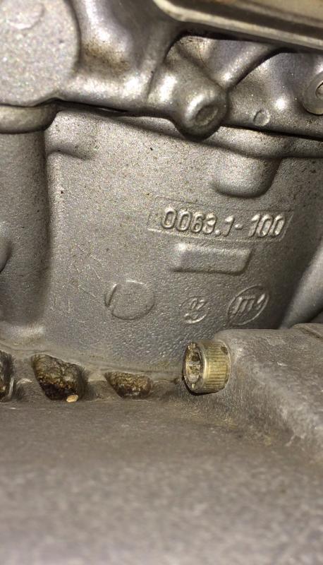

  11. Go these scribings on the left of the cylinder mean anything?...or do they come out of the factory like it?
  12. Casting number?
  13. Could be, same number and place on both cylinders.
  14. 100mm bore.= 998cc……or 998 bp or S
    104mm bore.= 999cc….or 998R

  16. I paid around what it ended at, so did very well IMO. Most probs a 998s although look like sand cast cases (what are the tell tail signs?) if so would make it a 996r/999r lump.

  20. 2002/03 998s had sandcast cases too. Don't think any 999s did
    If your lump has no numbers it could be the cases were replaced or they could also be from a race bike. You could look for and hand engraving saying eg FE02 or similar which is tell tale for race stuff.
    Those castings indicate 100mm barrels (so 998cc afaik) but doesn't mean they weren't rebored.
    In which case dyno or strip and measure would be the only way to get an idea.
    If it came from someone who worked at a dealership and had access to race or refurb parts then it could be anything tbh.
