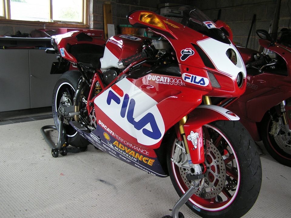

  7. My 999R Fila has the 54mm system (£2500 when new) and is very quiet, my other 999 now gone had the std size system but de catted and was much louder.
    Reason explained to me was great, blow down a pea shooter and listen then blow down a drain pipe and listen, it was true.

  9. That's a great way of explaining like it
    What's your R like to ride ?
  10. One more thing would the head from a 1098 fit on to the deep sump engine I ve been looking but not seen anything thanks
  11. It's a lot comfier as thinner and all manner of things differ, more refined to but still has character.
    Always wanted a 996r but couldn't afford one at the time then in 2003 this baby was born.

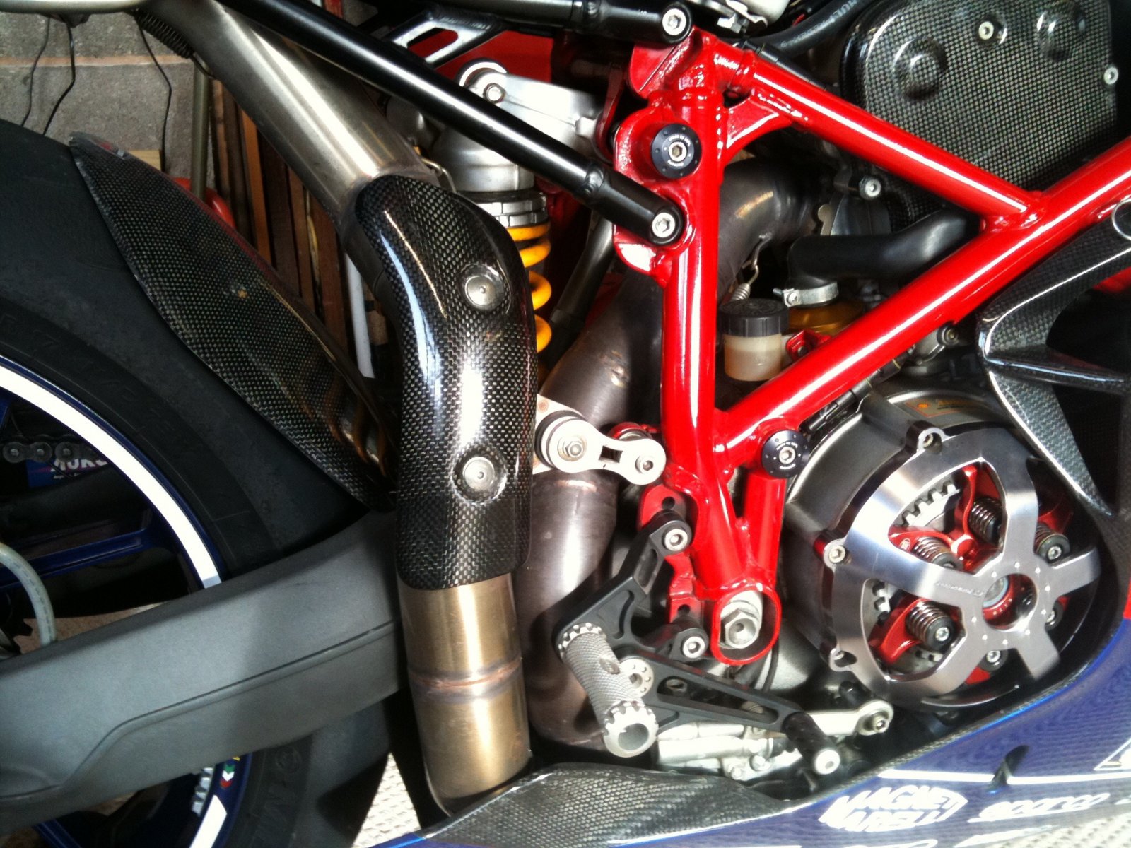

    Is doing all this worth the expense lol not really suppose I just got carried away after changing the front end to ohlins (which meant changing everything ) no regrets over doing that ,I was just looking for some more power , I wanted about 140bhp , the engine was just a fluke I suppose I m trying to make the bike Ducati should have made really Ohlins front end with a deep sump like the S

  16. Let's see some Ohlins pics and what did you have to do ?
