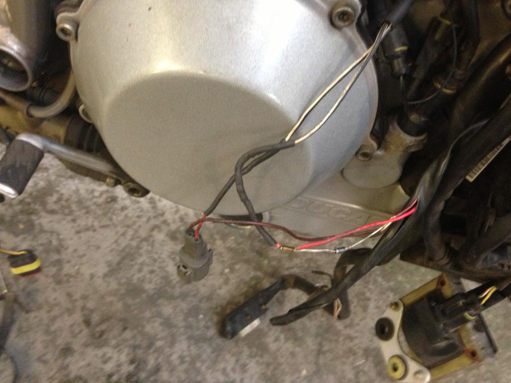

  18. Well just having a break from the alarm all looks pretty easy so far mos of it is plug in, seems like only one wire on coil been cut into
    I have found something strange a little diode across the two coil wires, ive got a feeling this is from the factory like this but not sure
    Im thinking all should be ok if left in probablysomething to do with when coil de energises my guess
