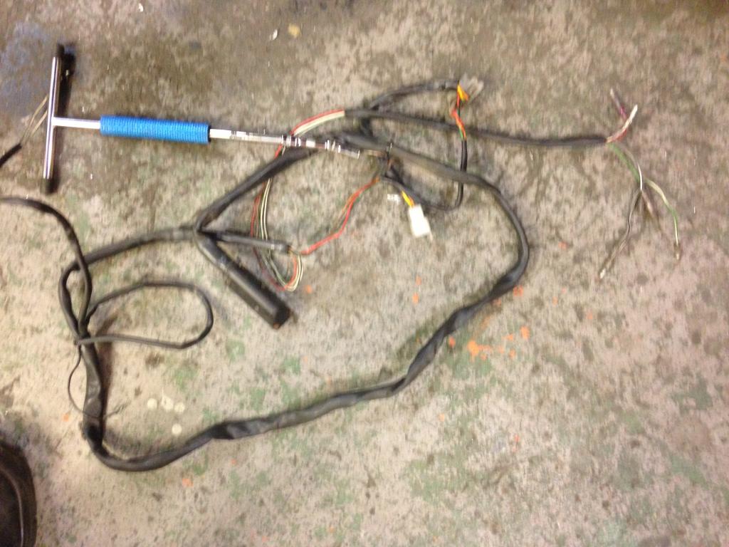

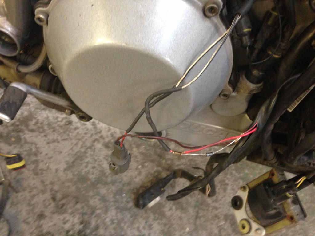

  1. Ok the alarm loom is now off the bike just checked she is very turn of and onable so all good there

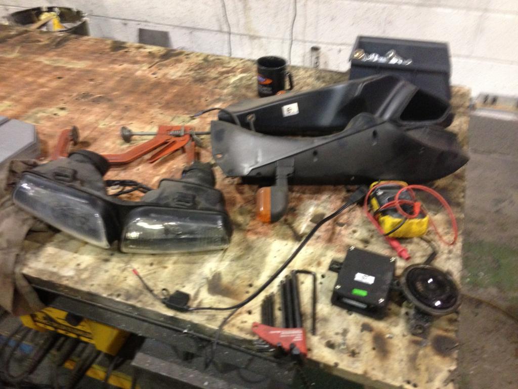

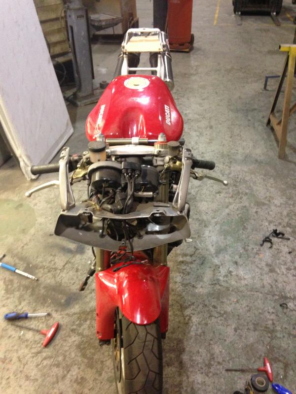

    Ive got the ignition switch off, had to loosen the airbox to get it out, pluged it in just to check all running ok before I tackle the mass of plug at the front behind the light, which i must say ducati make it much easyer than most the jap bikes i've worked on IMG_0105.jpg

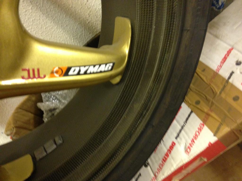

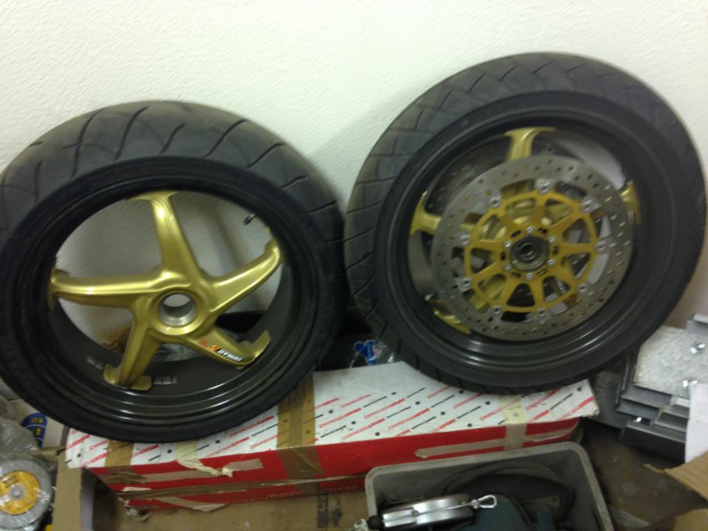

    IMG_0107.jpg The mass of alarm loom IMG_0102.jpg IMG_0103.jpg The wheels thats going on this bike Magnesium centers with carbon fiber rims

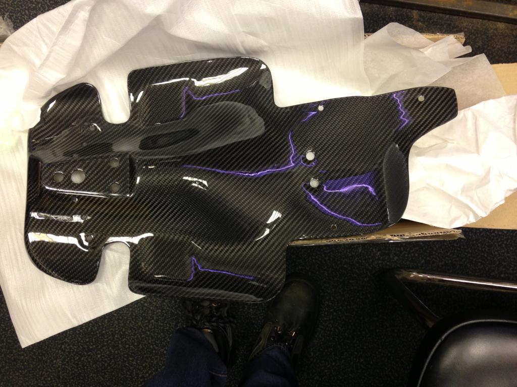

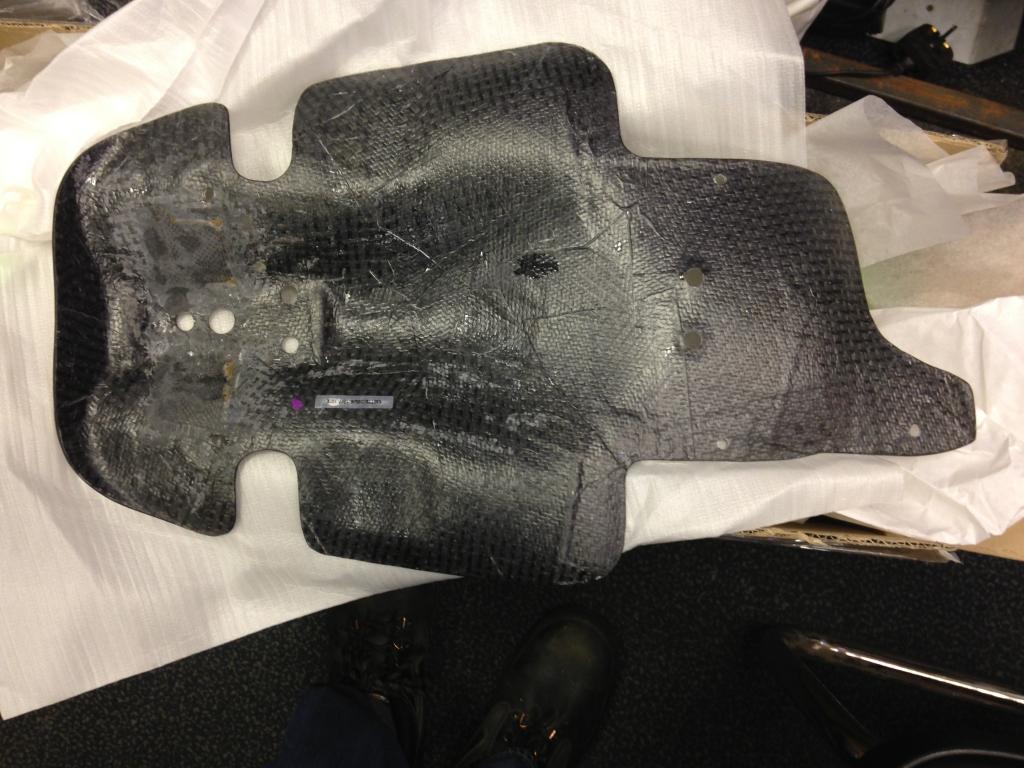

  4. Got my carbon undertray it's wrong one :mad:, looks really nice but wrong, does everyone have these problems or just me.
    Had a little more of a look at the bikes wiring last night and i've worked out what wires will allow the bike to start, ordered a multi plug that looks the same so hopefully be ably to have a switch that just plugs in, if its wrong i can uses a section of the alarm loom to do the same thing, not sure if i need to power any other circuits, will have to look and make sure all the gauges and warning lights work.

  15. the ignition switch is just strip the wiring back to the white block connector and all you then need is a toggle switch two wires and two spade connectors.....

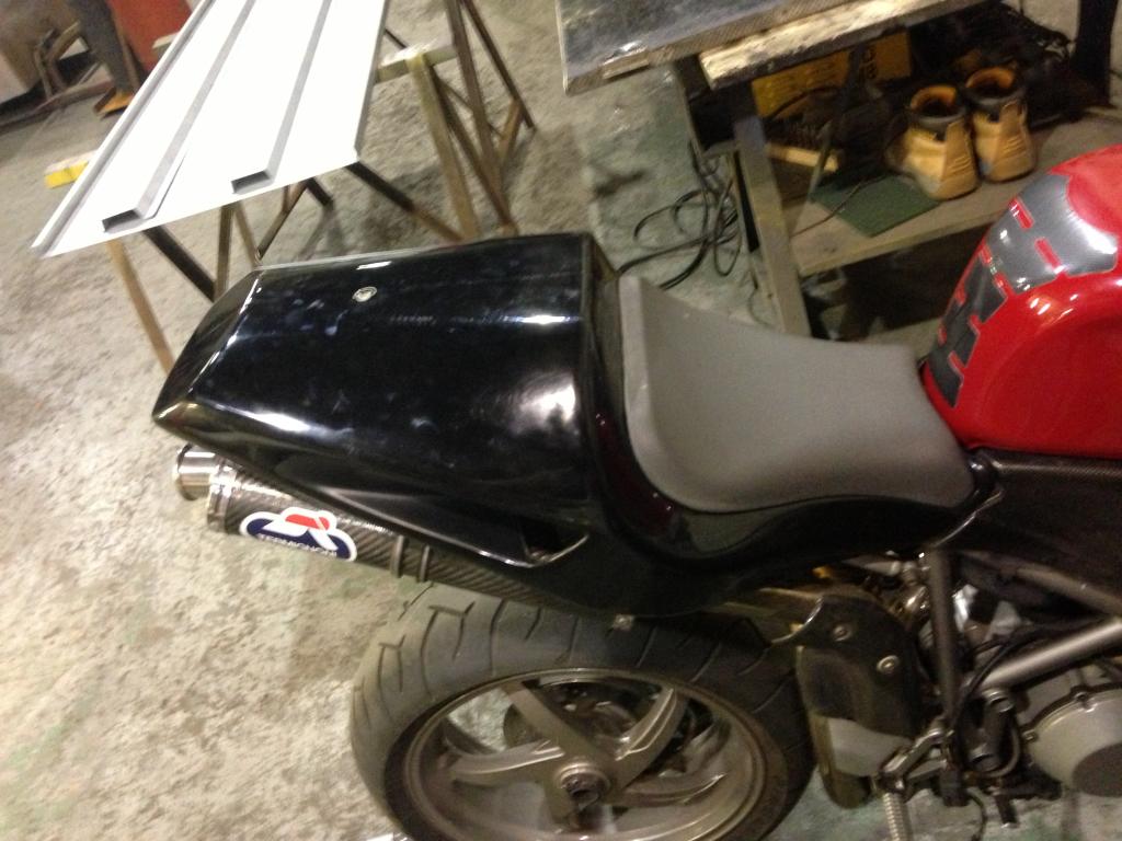

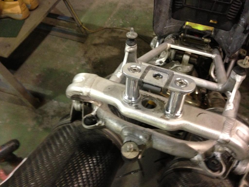

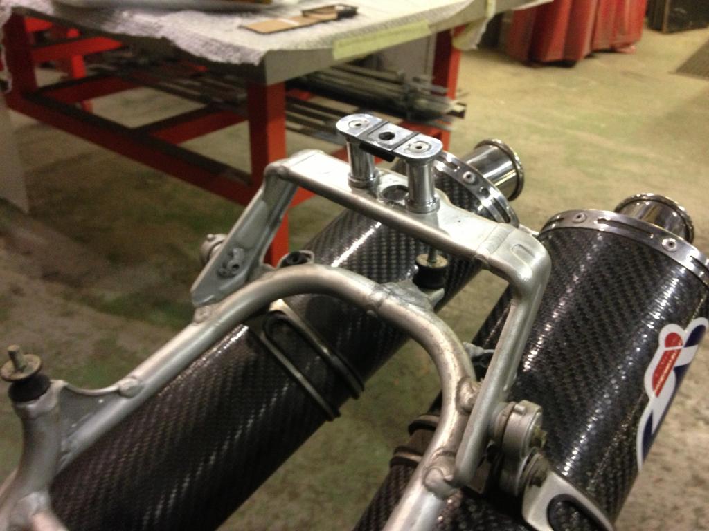

  16. Well had a look at the single seat unit lock thing, heres what i come up with its solid as rock which is nice:wink:

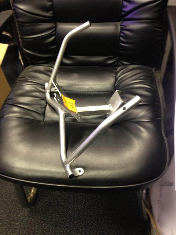

    Just had the fairing bracket turn up, thought id be waiting ages for that ordered it i think on bank holiday monday and its here thursday morning, that was an ebay item from Germany so good there
    I've heard from the guy i bought the undertray of, seems theres a mix up because he's on holiday, ive got to send this one back recorded delivery and he will get another sent out P.I.T.A but these things happen I guess, The quality looks good came from Carbon Moto IMG_0113.jpg IMG_0114.jpg
    But going back, so i think next post will be fitting the fairing bracket, Only thing im thinking here is what fixings to use to hold the fairing to it with, i like the dzus fixings but not sure how suitable they will be
  19. ^^ SRS race fairing stays come with flats on them to do just that and having used one in the past I can say it works just as well as any other fixing method.
