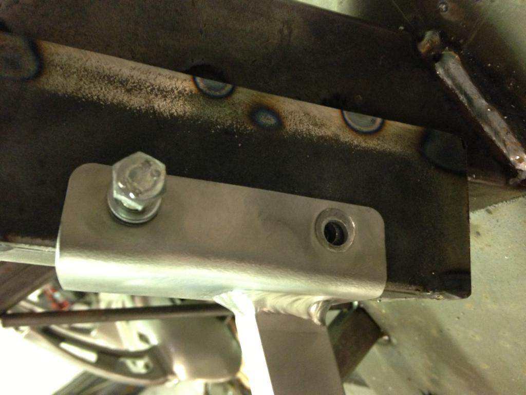

  3. The stock 998 biposto subframe is the same as a 996 it even has the mountings for the 996 ECU despite the 998 ECU being mounted by the battery, a 748 R\SPS subframe would definitely fit in exactly the same way and a 748R chassis is the same as a 998 frame apart from where the coil brackets are mounted on the frame.
    If follows that a 748R\SPS carbon undertray would have the correct attachment points but you would have to cut it down to fit a biposto subframe. I have never come across any subframe that attaches on the outside of the mounts, it doesn't sound like a Ducati item.

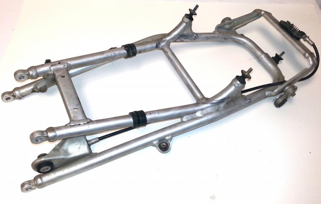

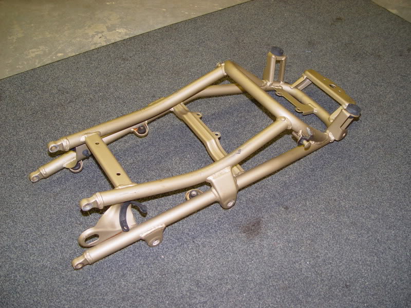

  5. Just seen this on ebay this is same as mine 916 mono posto subframe see the lugs sticking out at the front, the tray i bought the material is cut away as it was meant for biposto Ducati subframe.jpg

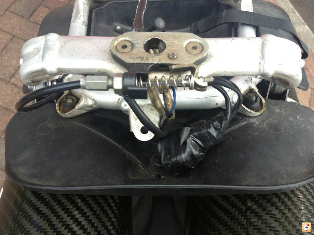

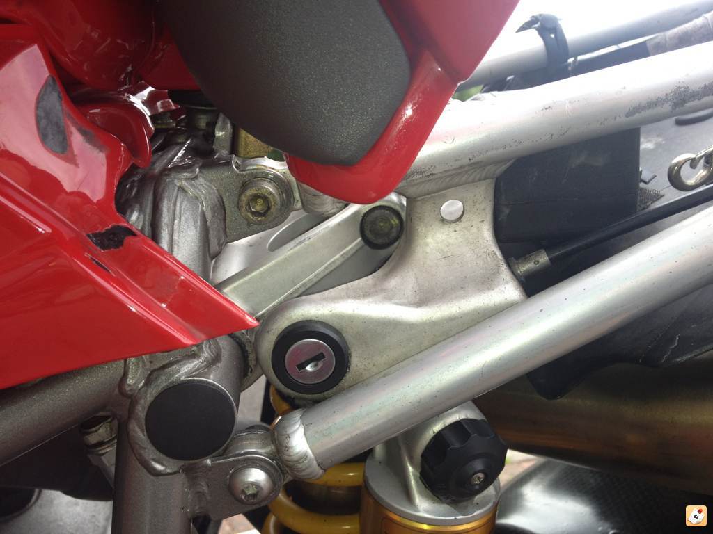

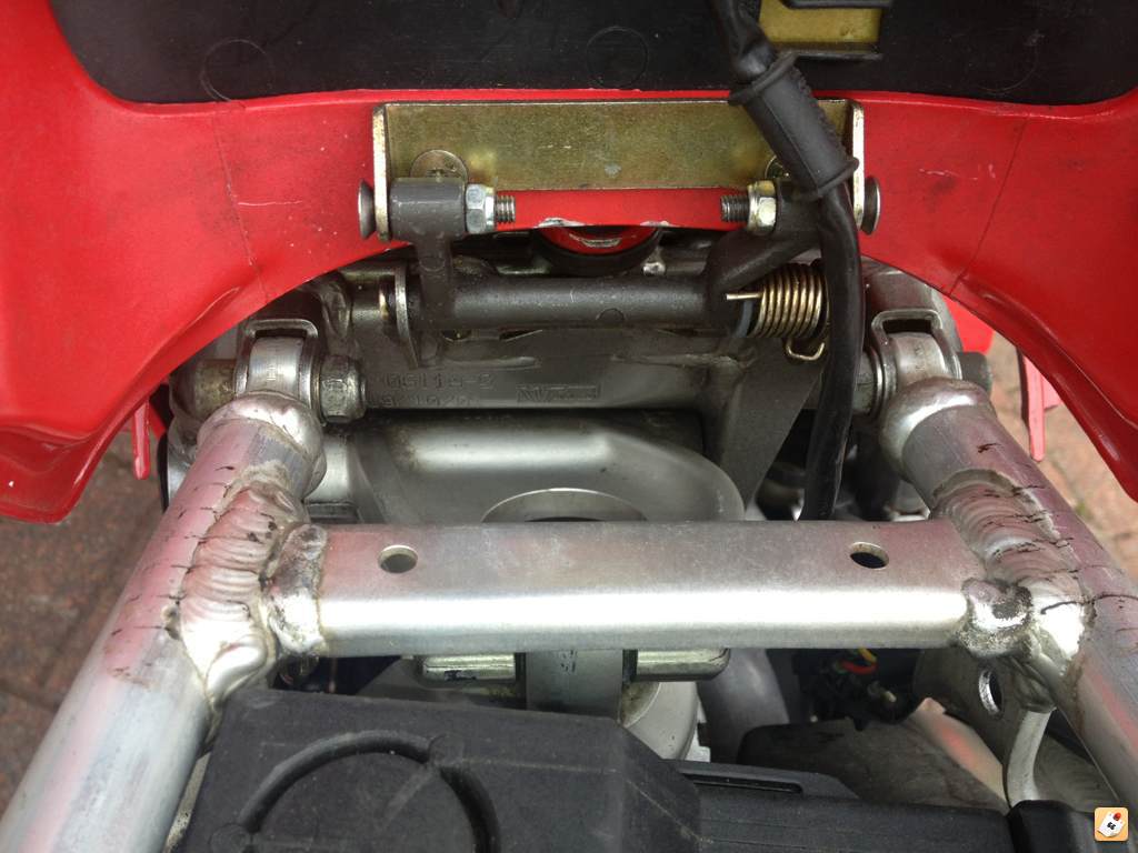

  6. Here goes with a few pics. [​IMG]
    Hope these help.
    Pete
  7. I can confirm that's the way the subframe should fit and that's what I had in my mind, no doubt the subframe shown was from a P8 ECU'd bike originally and equally the carbon undertray should fit as well regardless of whether it is monoposto or not as far as mounting holes go, it's only that shape of the undertray that's different.

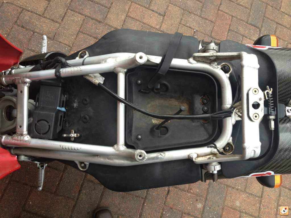

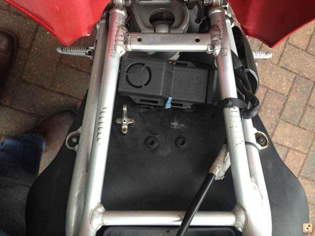

  8. Yes my subframe is the same as efcbluepete above, just to clarify there is no problem with the subframe fitting the main frame
    The problem is the undertray that was sent out to me is wrong one it is meant for a Biposto which have its fixing points for the undertray in a different place to the monoposto, so although you can make a monposto undertray fit a biposto subframe by removing carbon an drilling new holes you can not fit a biposto undertray fit to a monoposto sub frame without adding brackets as they remove an area of the undertray to clear rear footpegs and this area is where the front mounts are on the monoposto subframe
    In on the Biposto
    Out on the Monoposto
    So when I get sent what I asked for and what they say is different all should be good, if not I will butcher something.....or someone:eek:
  9. OK got it now, yes you are right, although my mono undertray had the same mounting points as a biposto, I just had to trim a few bits off, so it looks like you have a messed up undertray. Maybe they took the mould of something different.
  10. I get what you are saying, too. I have the full Bip setup in the garage, so didn't have to butcher anything, just swap them out (pissing about with the alarm is the most annoying bit).
    good luck getting the proper under tray.
  11. Biposto subframe Note front undertray fixing go inwards as example below
    It sort of shows how ducati must develop the bike as a race/single seated bike and then make changes to turn it into road bike
    There no other reason to have these lugs in different places other than they was moved when they realised that was where foot pegs would need to be

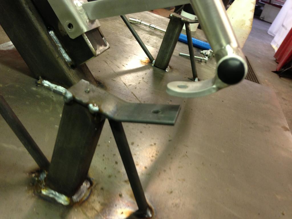

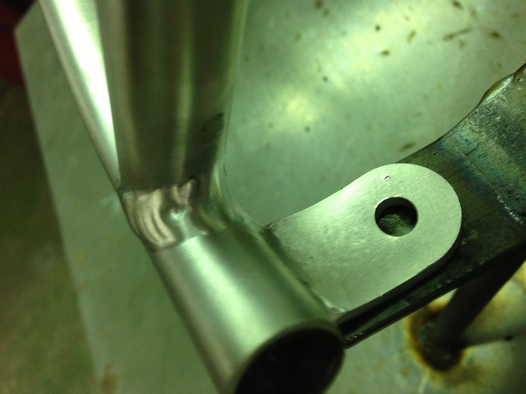

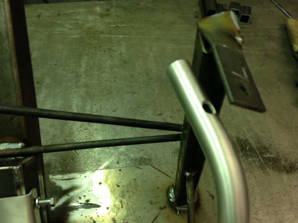

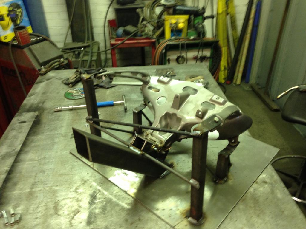

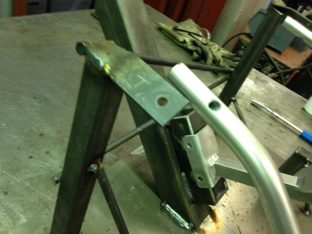

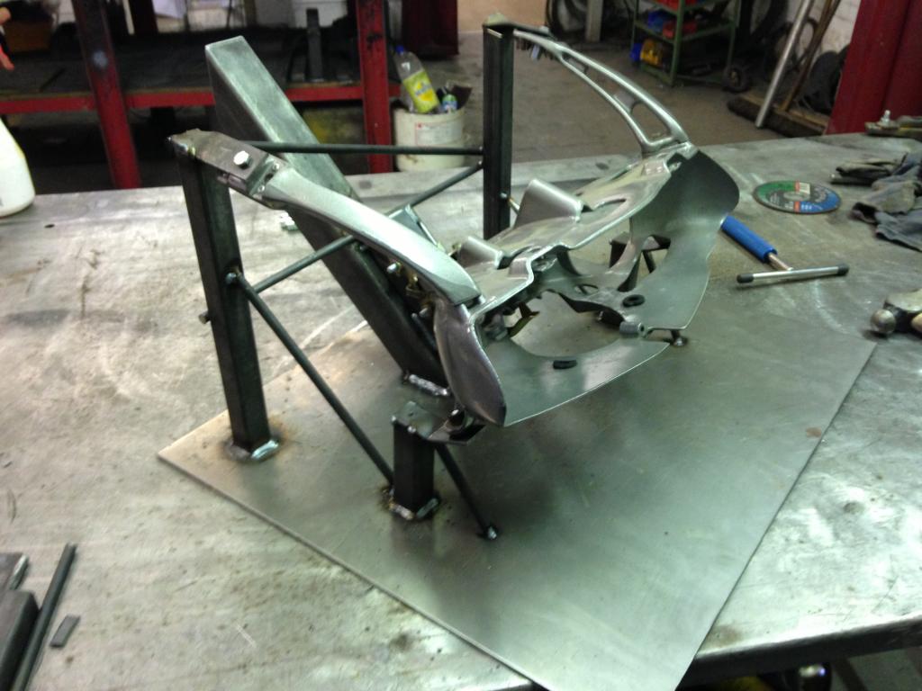

    Well just made a jig up to get the cruical dimension from the ducati light housing
    You can see just how bad the fairing bracket is, the jig is ruff but picks up all important holes, I like the idea of using dzus fasteners so i will straighten it all out and make the altereations
    Very poor quality assurance by whoever made the fairing bracket, its just been welded and distorted all over the place or someone very fat has sat on it
    Anyway another day tomorrow ill see if i can get it sorted then
    Be interested in what you know about using the 999 loom how different is it IMG_0130.jpg IMG_0131.jpg IMG_0132.jpg IMG_0133.jpg IMG_0134.jpg IMG_0137.jpg IMG_0138.jpg
