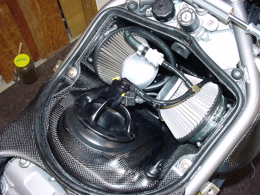

  1. I notice you have DP air tubes. I have these fitted to my old crate and removed the air filter runners from each tube and now run JHP under tank filters.
  2. its a scratch on the mount
  3. Notice any difference with JHP filters?

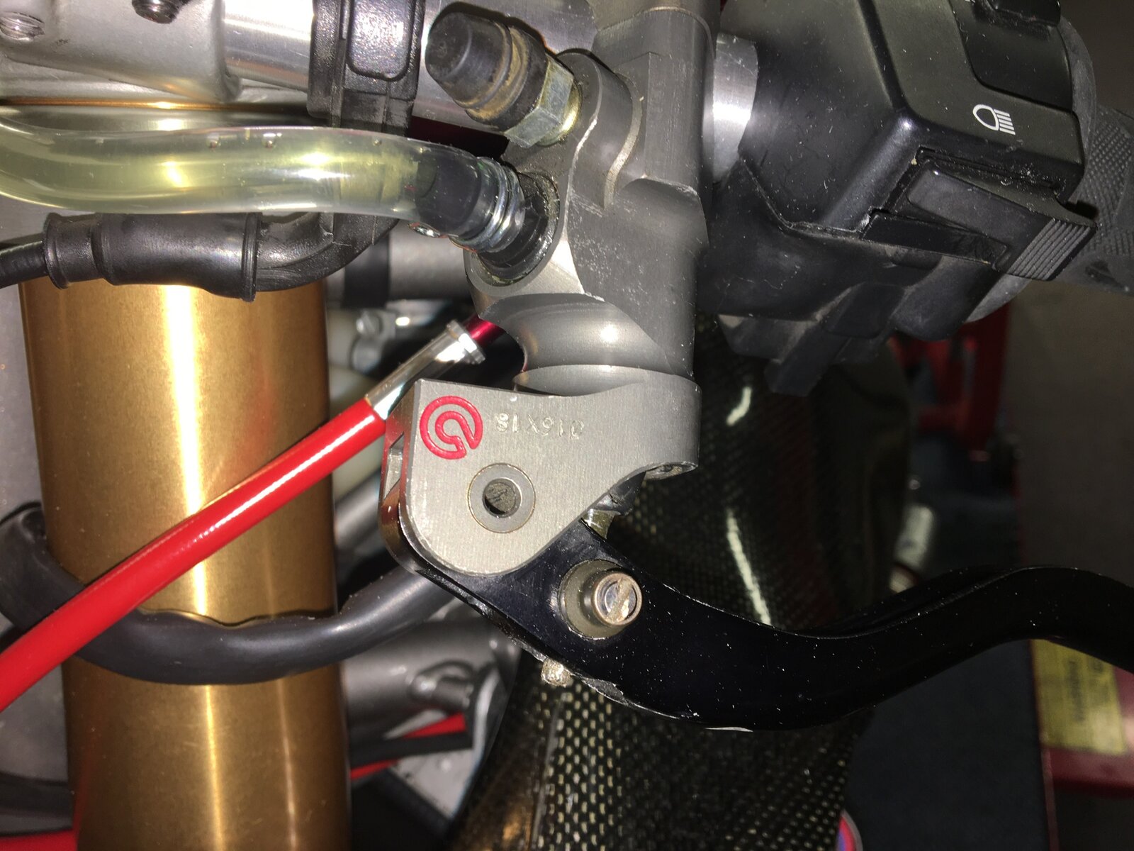

  12. So got out a ride on the bike yesterday. The first time I stopped I noticed hissing. The coolant tank has a split in it. I have a spare from my track bike so will need to get it swapped over. The one thing that stood out on the bike was how worn the clutch basket is. So I'm going to have to get that swapped out to. My issue is I'm not sure whether to go for a standard clutch pack and basket or change to a slipper clutch while I'm at it. I don't run a slipper clutch on my 748 track bike and never had issues with the rear when downshifting. Just thought I'd ask to see what other peoples opinions and experiences on what to go for?
  13. The split in the header tank is normal and will happen again with a new one within a short time. A few people have opted for an aluminium replacement which solves the problem for good.
  14. I put an STM 48T slipper in mine. Also changed the master cylinder and fitted an STM clutch slave. The gear changes were silky smooth but changing the gear shift to race shift made an even bigger difference. Highly recommended.
