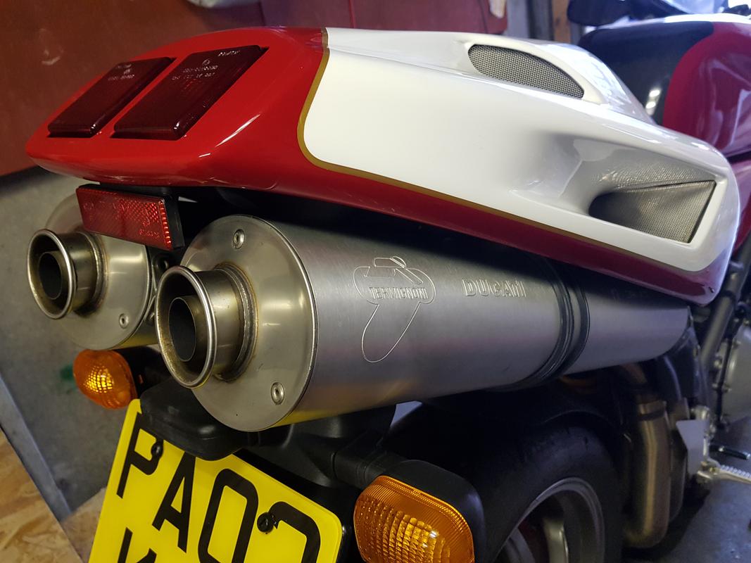

    The other thing i have been thinking about is the exhaust thats on the bike:
    I fancy changing for something that makes a bit nicer sound. Am i right in thinking that these bikes have a larger 50mm exhaust on them? If i change the exhaust would i need to make changes to the fueling on the bike?

    The 998S had the 50mm system on it. Try to get a 54mm system as they reckon this is the optimum size for road use. It’ll need remapping though to get the most out of it.

  4. Thanks, I will have a look for a 54mm system. I take it if I were just to change the cans and keep it 50mm it would run ok?

  10. Keep the 50mm system for road use. You'll only get an increase with the 54mm system if you have some headwork done then a re map. if you just fit the 54 system you will loose some low down response.

  14. Ok, I'm not really looking to up the power of the bike just yet. I know from experience that that's a slipper slope. I just want a nicer sound out of the bike. So maybe some 50mm cans will do for now.
  15. 54mm system with the remap will give you a big gain. Or even the half system. This was a common mod.
