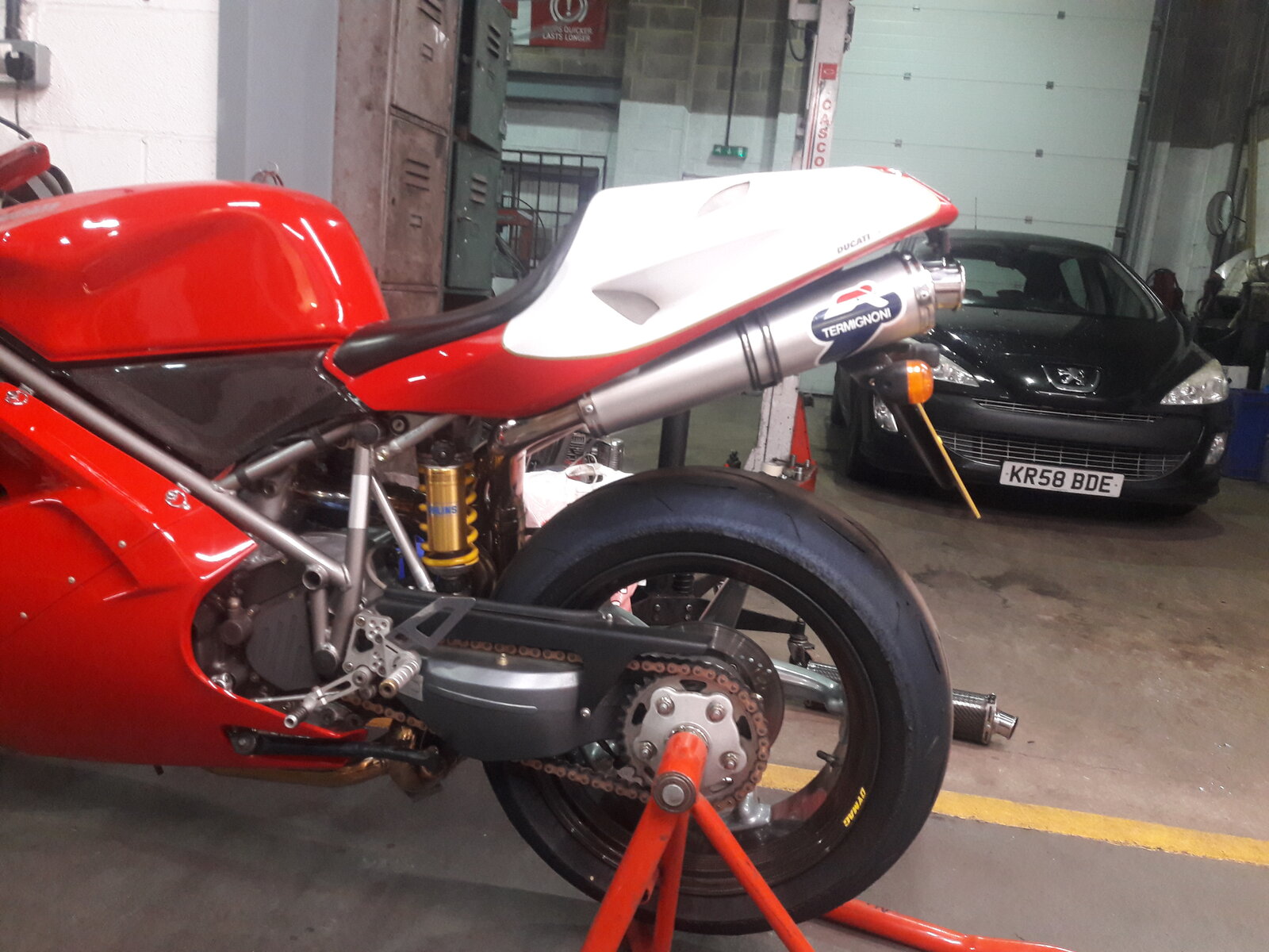

    I am still looking for a set of rear silencers. I like the look of the carbon Termignoni silencers but i have seen a couple of bikes with the titanium silencers and i like them to. I'm in no rush so will just wait until something comes up for sale.

  13. I got alloy ones on mine mate
    • Like Like x 7
  14. They look good! :cool:
  15. I have the ti on mine and I must say I love them. Took a while to find them - eBay as I recall - but they do have a lovely hue.
