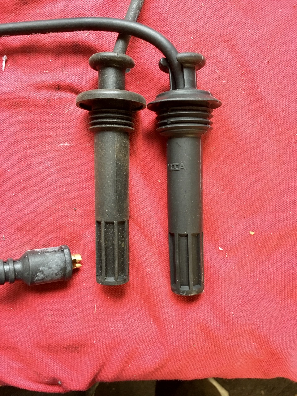

  7. Fitted the VERY EXPENSIVE HT lead and it fits and reaches the spark plug (as it bloody well should). As you can see from the photo it is noticeably longer than the £8 Lancia one that was on there but I have to say and extra £90 for 5-6mm is a bit extortionate :(.

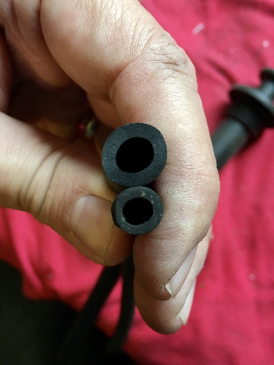

    I then fitted the new breather pipe, as the old one a) kept falling off and b) had a big split in it as well:(. As you can see the correct part (£15) is significantly thicker and sturdier than the part that was on there which I’m assuming is another cheap part from something completely unrelated :confused: - top one below.

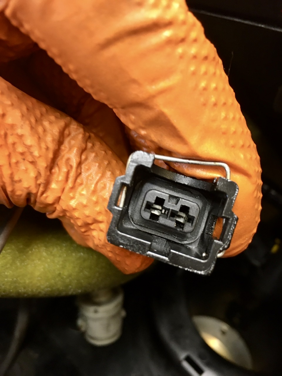

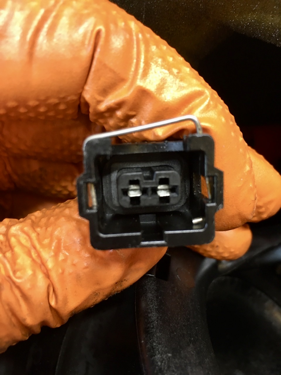

    After doing a few checks the problem now seems to be the injectors aren’t firing consistently :(. Sometimes neither fire - hence the no start, then only the vertical cylinder one is firing and the horizontal cylinder one isn’t, apart from sporadically. All suggestions as to what the fault may be gratefully received :upyeah:.

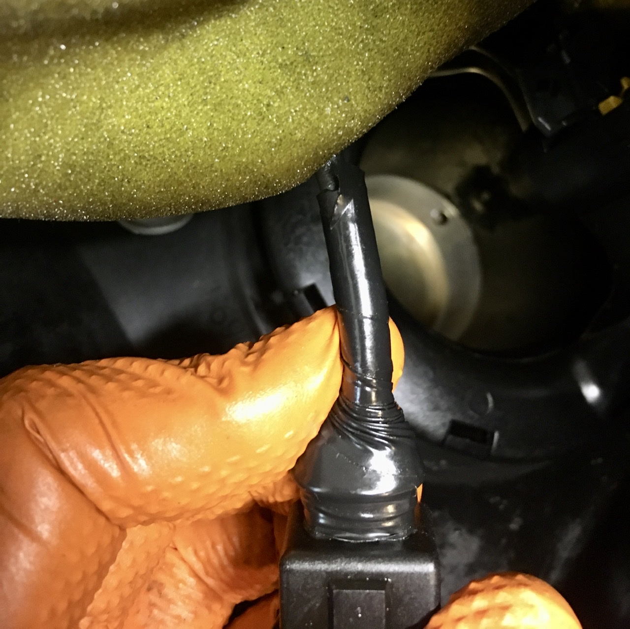

  8. Started stripping the injector circuit apart at 12.30 today to see if I could find the reason for the intermittent injector fire. By 13.15 it was cured, back together and running on both cylinders :):upyeah:.
    Cause? Someone in the past has pulled the wire rather than the connector block on the horizontal injector. Thus the 2 connectors were not making full contact with the blades in the injector as they’d been pulled back too far into the block. Reseated them, made sure they made contact, job jobbed:upyeah:.

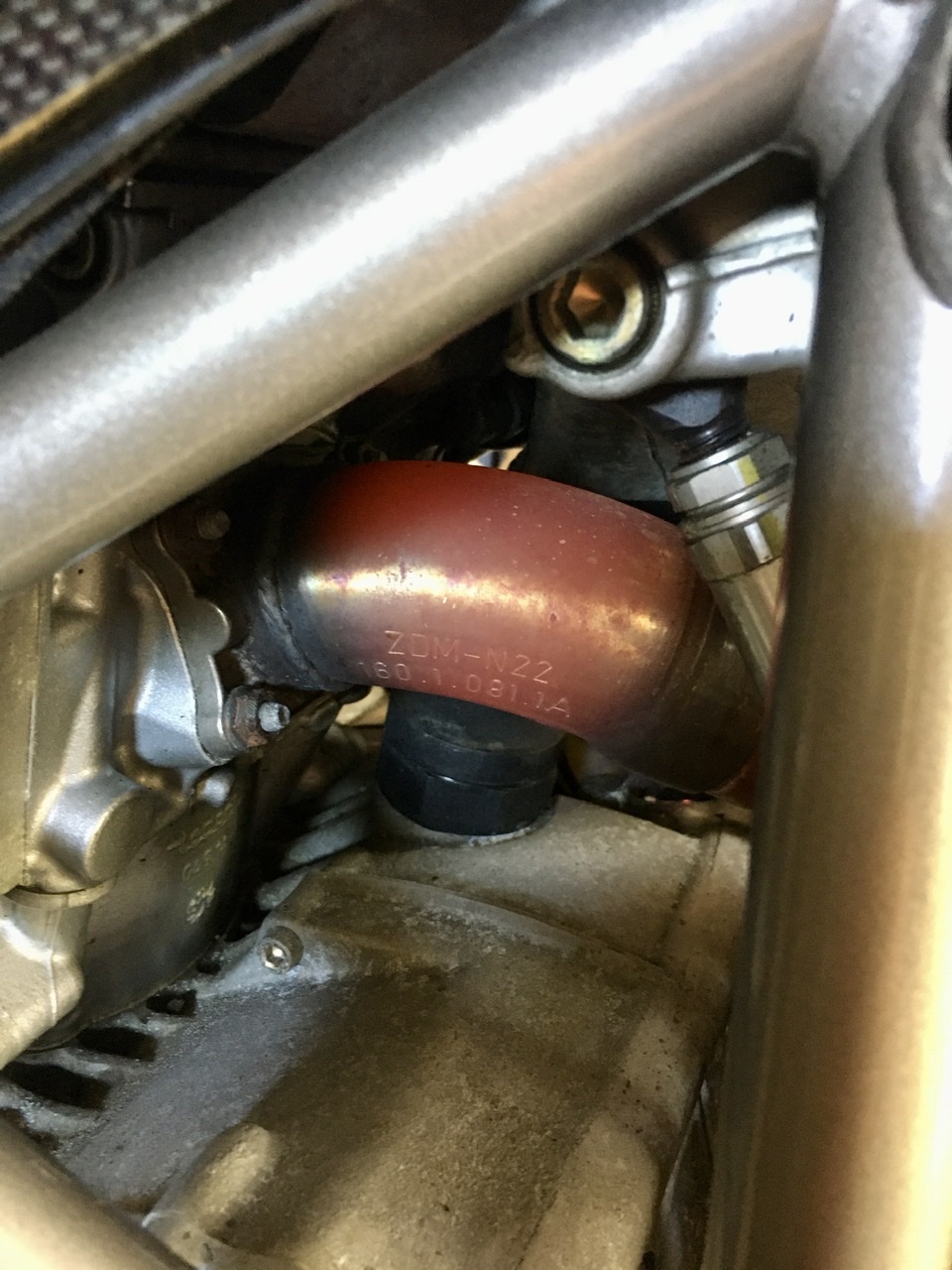

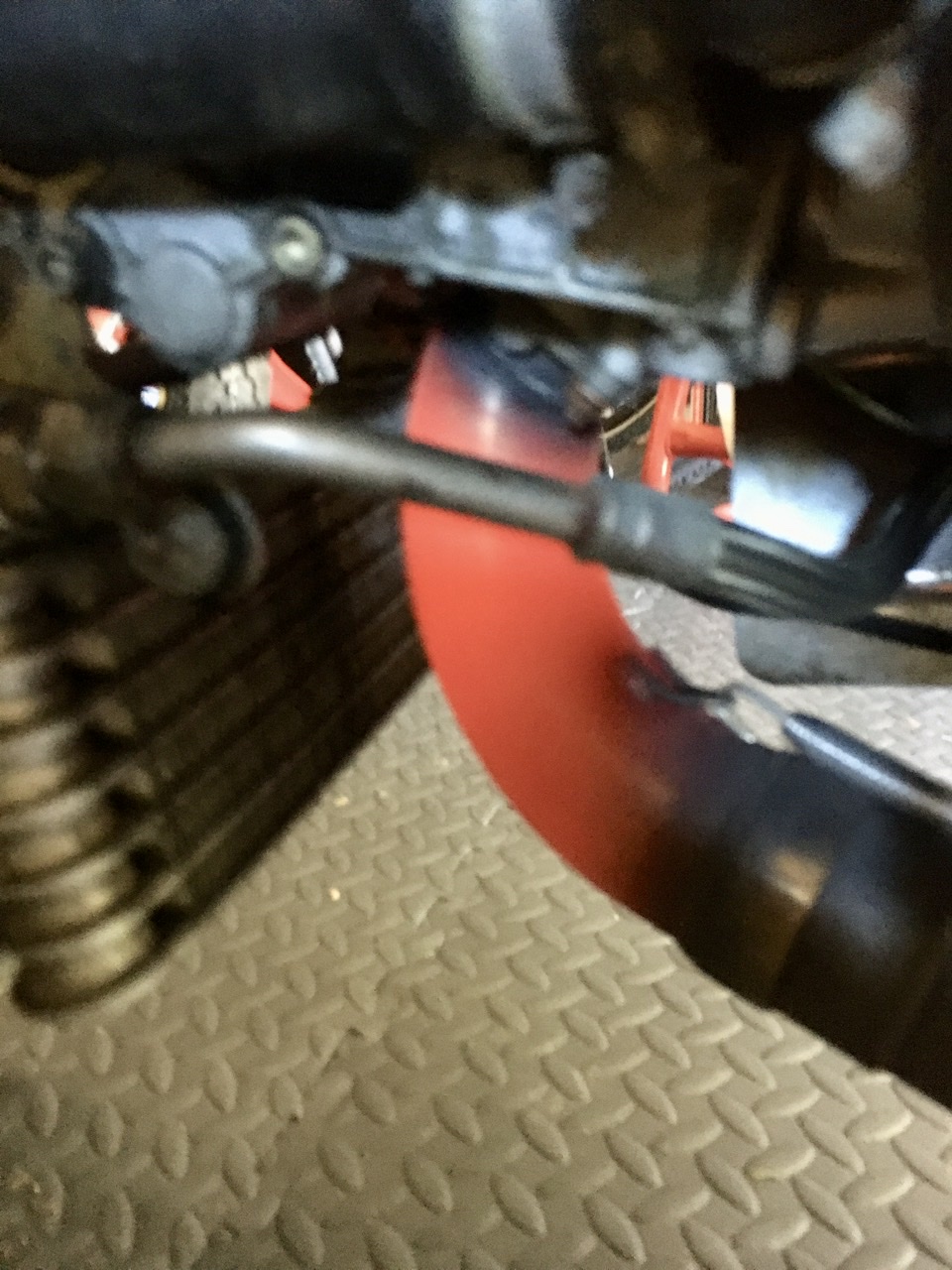

    Having got it running, it’s running on fast idle whilst it warms up, admittedly I’m blipping the throttle a bit :D but not above 5k. I happen to notice the exhausts are red hot, likely really really red hot. Never seen that before. It’s normal right - he says hopefully - or is it a sign she’s running far too rich?
    322A8928-593C-4B59-9F49-EEF30A9C7EA9.jpeg FC1AE414-A018-4405-8FAC-3DAA6CFD2561.jpeg
    • WTF WTF x 2
  11. Yeah, how can you tell :thinkingface:? Is it obvious? Should I stop applying hourly? The Don recommended it, made in the good old US of A so it’s gotta be good right?
  12. Umm, not looking 'quite' right....
  13. Nuclear grade :upyeah:
  14. Seen that before on a 250 Kawasaki twin I was given, turned out to be incorrect plugs in that case.
    ( I so wanted to say it turned out to be the HT leads, but that would have been cruel).
  15. I wanted to rate that both funny and useful .
    Anyway, it deffo has the right plugs Champion RG4HC.
  16. Probably front sprocket needs changing :p
  17. It's normally a sign of the timing out, running rich would make run cooler, a lean mix hotter, never seen that on a Ducati only older brit bikes with timing out.
