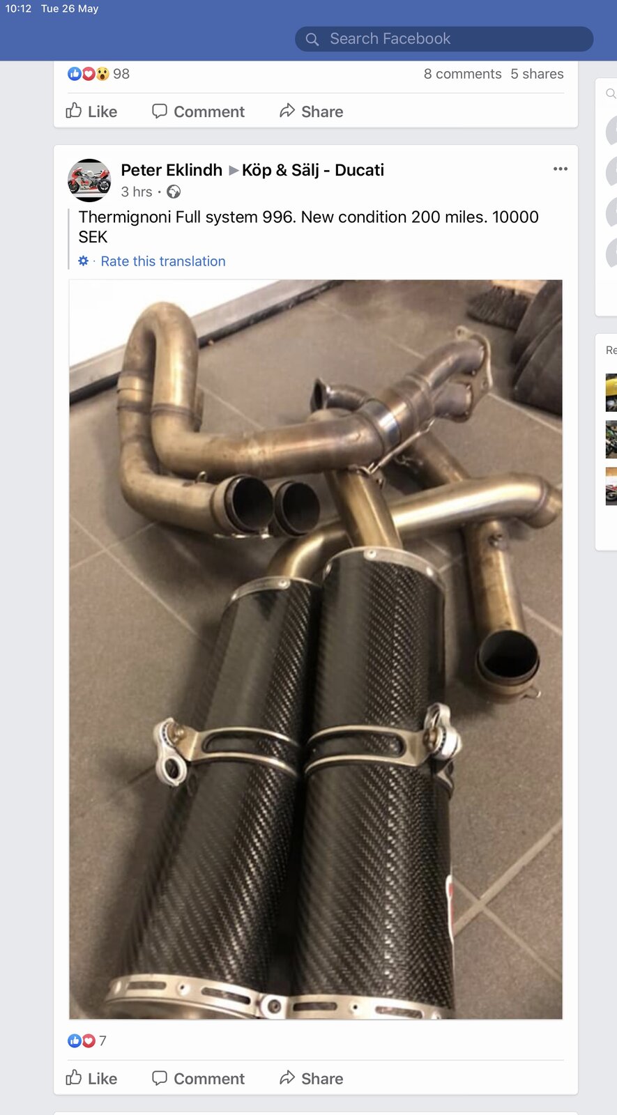

  2. Thanks for the heads up on that. The manifold/exhaust headers are different on a 998 to the 996 (it being the Testrastretta engine) but they can be changed, and I'm not sure of the diameter of those pipes in the FB post.
  3. If you are on FB and want to be added to the group so that you can talk to him, just let me know.

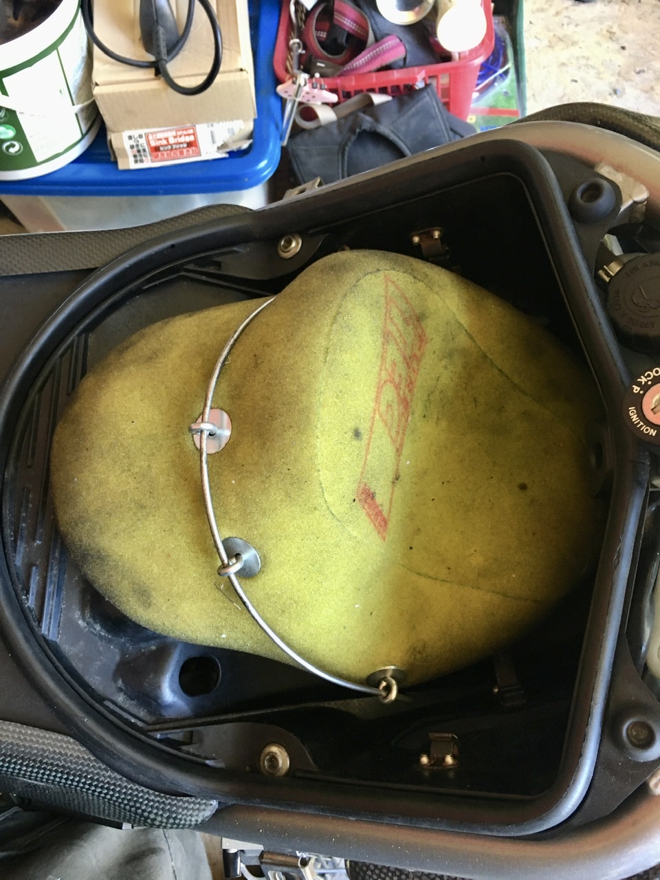

    I lift the tank, as I plan to remove it and drain the old fuel anyway, and discover the weirdest air filter I’ve ever seen. Anyway, the tank’s now propped up I haven’t disconnected the fuel lines so I think I might as well check there’s fuel coming out of the injectors (theyre shows type so easy to see).
    Sure enough no fuel spray. that’s the problem. Now the breather pipe was disconnected so I reconnect that and for some inexplicable reason decided to thumb the starter again. Fuel comes out the injectors and she starts. Hooray:):upyeah:. But......

  7. Is the sponge going into your shower cubicle? WTF is that??!!

  9. [​IMG]
  10. the air filter is just a cheap shit type that didn't work very well....but i dont believe thats part of the problem
    i would change for the BMC type.....far superior.

  11. A once common modification to delete the in-air tube standard filters in the hope of increasing the air flow into the air box. Most common problem was the break up of the foam filter to be ingested into the engine and not many came with a support mechanism to prevent the collapse of the dome shape onto the throttle bodies. You will have advocates of this style of air filter and you have people like me who think it’s a pile of shit and needs binning. Andy
  12. My SpongeBob Square Pants filter is held away from the throttle bodies by the injector cradles plus it also has a metal hoop frame. The bike has aftermarket CF AirTunes which don’t have the provision for the original in tube filters unfortunately. Needless to say SpongeBob is on his way out.
    @andyb I presume the BMC ones above sit at the junction of the air tube & air box?
  13. yep they screw to the inside of the air box.....then the filters can slide in and out to ease removal of air tubes if required..
  14. It requires a minor modification to the air box to attach the filter mounting block. Not complicated. Andy

  17. Far to oily to use in the shower, I think SWMBO would disapprove.
  18. Er yeah they screw to the inside of the air box..

  20. You need to remove the “sponge bob” filter and go for the bmc or standard solution. You don’t want to get your precious on fire during a back fire, which happens sometimes with these filters when they are submerged with oil and fuel.....
