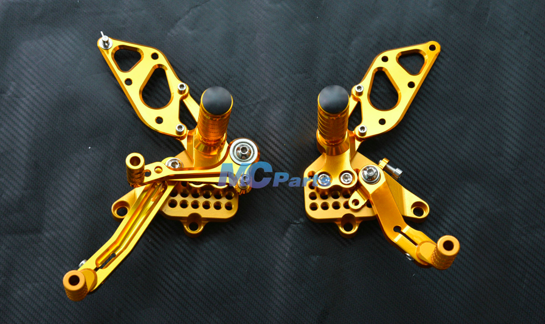

    What I have found out is I'm going to have to play around with the footpegs/controls a bit as the gear lever is too close to the footpeg for my size 10.5s and whilst changing down is easy it's bloody difficult for me to hook my toe under the lever for up-changes. Anyway, that's easy enough to sort out and if I really can't get on with the DP ones on there I've always got a blingy set of ultra adjustable Chinese ones to fall back on :D

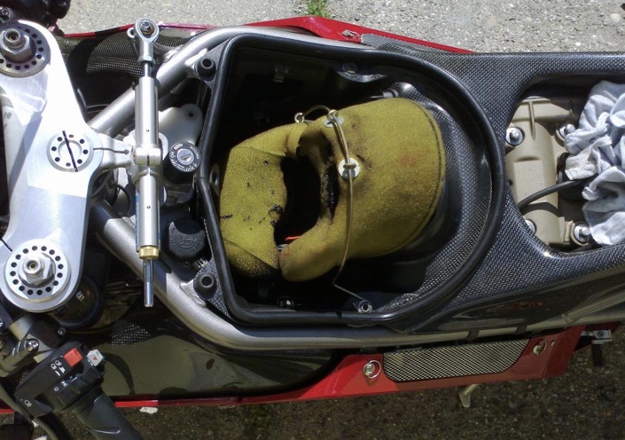

  2. :eek: Thanks for that advice Nick:upyeah:, looks like you caught that one just in time.

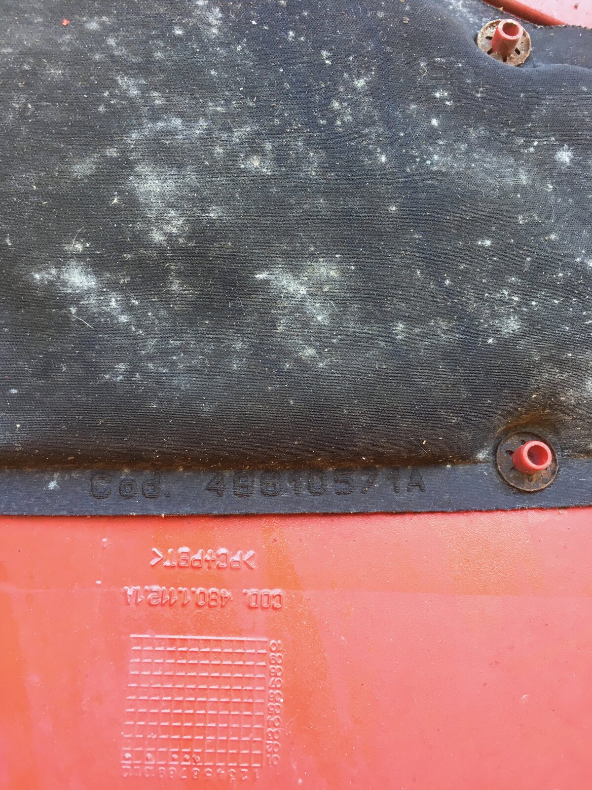

  4. The foam inside the internal pads in the fairings is shot, in as much as you push your finger in and it doesn't spring back, it is 18+ years old after all. Does anyone know how to remove, without damaging the plastic lug, the old quick fasteners pushed onto the plastic lugs that hold the internal panel in place?

  6. There should be ample adjustment for yer plates as the toe peg and footrest are both on cams iirc. Or, just throw the bling on. We all know you love a bit of gold. ;)

  8. Guys, it’s not my bike. Just google ducati and fire and these pics will pop up. That’s why the advice.
  9. Snip through the metal fasteners to remove them...
  10. as exi says, snip the fasters from the outside at the shortest points gently in two opposite places and they should come off hopefully without cracking those plastic mounts
  11. West Cork Paul, whatever you do, do not fit the gold gayboy (wack it up dry) rearsets. Now be a good boy and go and get some D.P ones. By the way what part of west Cork are you from, I have some very fond memories of West Cork.
  12. The bike has DP rear sets on at the moment but I have bigger feet than the previous owner so they need a bit of fiddling around with. Anyway, don't you like my blingy rear sets :D?

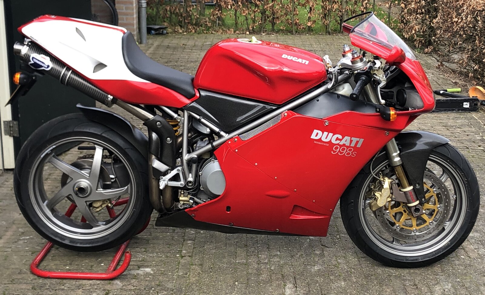

  14. Nice but then again I'm biased. Was it always a mono?
  15. West Cork Paul, am I correct in thinking that it is indeed a deep sump engine?
  16. Yes mate. Imported from the uk in 2014. I’m the third owner.
  17. It is indeed.
    FYI afaik only 405 998S deep sump were made by Ducati (excluding the 400 Bayliss Rep and 465 Boston Reps), of which only 295 were sold in Europe.
  18. And final editions
