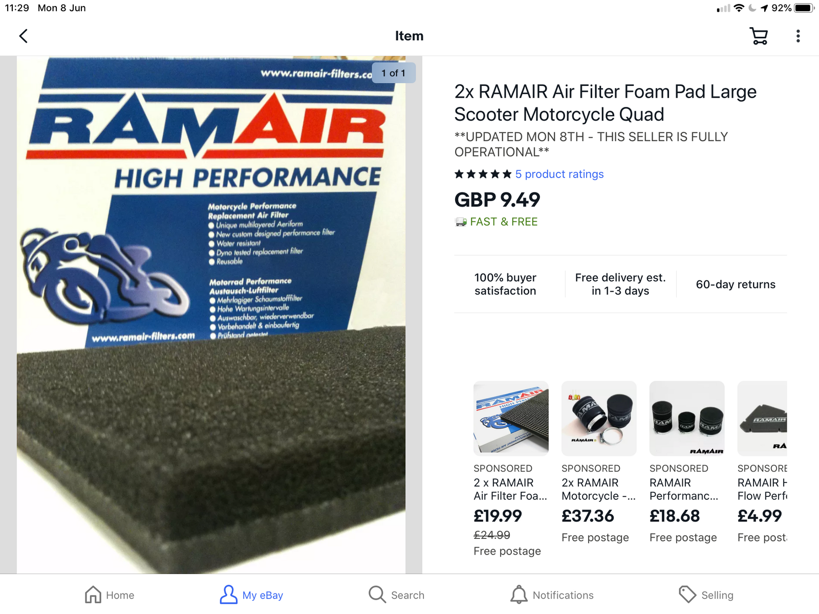

  10. I changed my airtubes the other week and they being the bigger race ones have no provision for filters.
    I bought some ramair air filters in sheet form for £10 off eBay. Made a mesh filter cover just bigger then the opening then screwed the mesh cover to the airbox sandwiching the filter between the two.
    I just couldn’t bring myself to spending £120 on air filters and they wouldn’t fit now either as the openings on my airbox are bigger to accommodate the larger air tubes.
    There’s enough filter included for 4 or 5 filter changes.

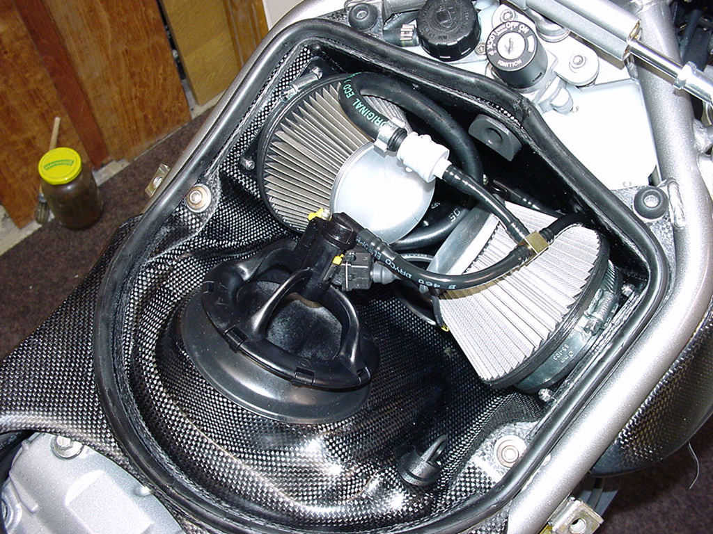

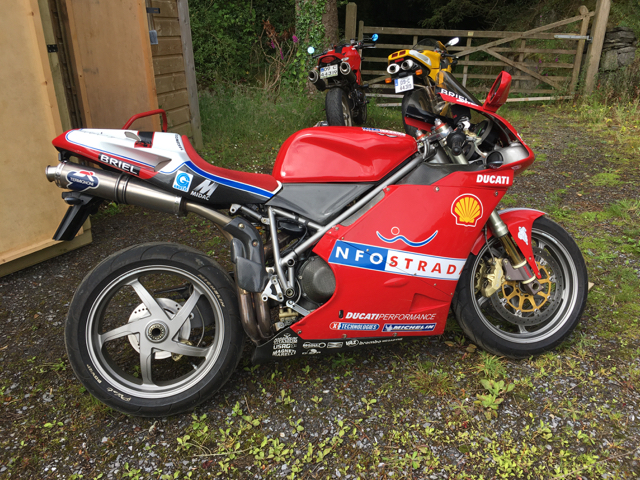

    Haven't had an opportunity to touch it for the past month due to a variety of other things (and bikes) but I thought I'd take a look at the misfire issue last week and see what it might be. Readers will recall it wouldn't start when I first tried, traced as no fuel coming out of the injectors. At that time movement of the bike off the rear axle stand and onto the side stand and opening closing the fuel tank got it started again. No it's not a blocked breather. I put a small amount of fuel in did a 50 mile trip to check it out and it started misfiring a couple of miles from home:(. Parked it up on the axle stand again.

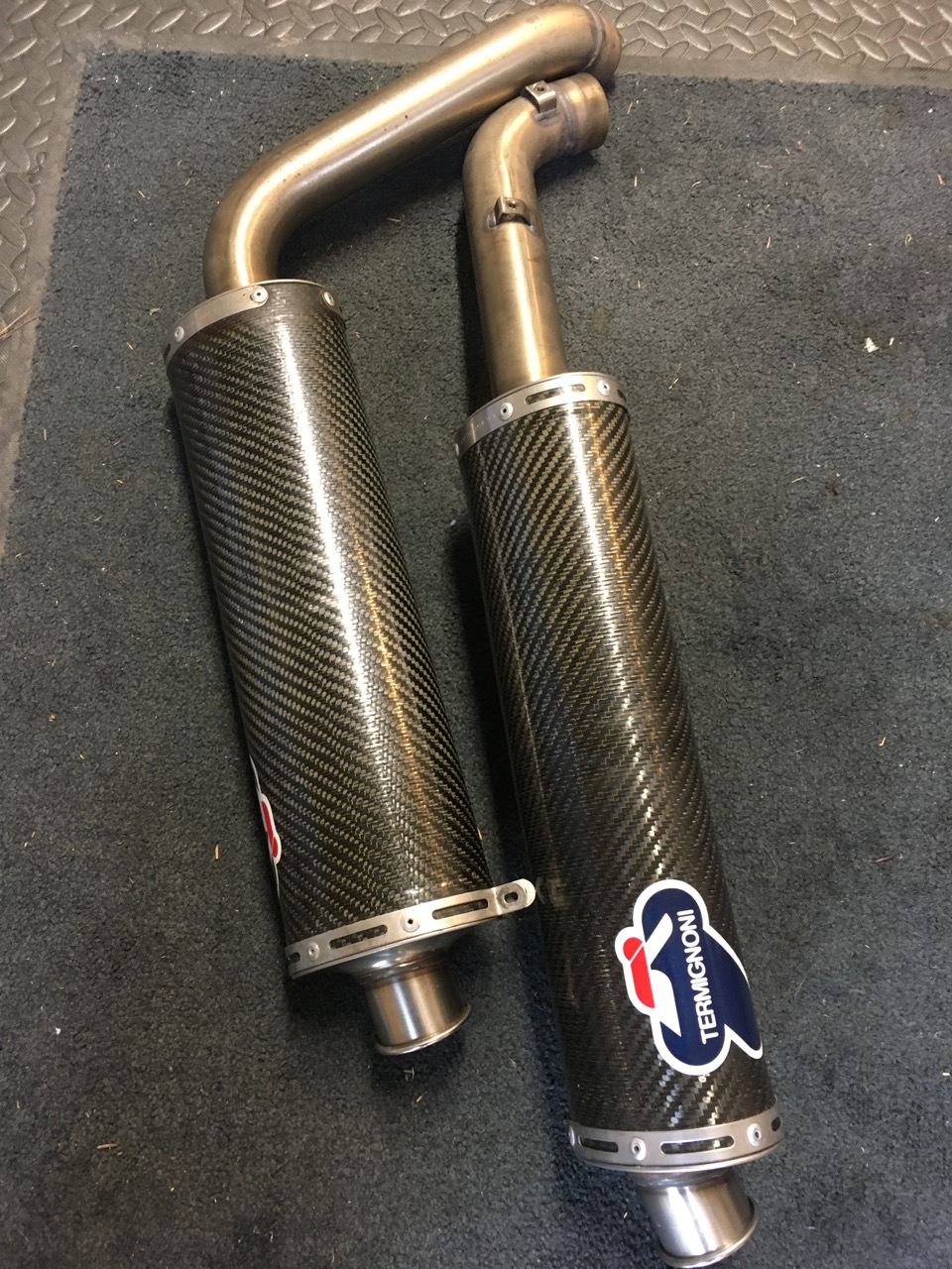

    I managed to find a set of 50mm CF Termis which arrived last week, readers will recall the bike has 45mm titanium Termis which had been pushed inside the 50mm exhaust pipes - by the supplying Ducati dealer I may add:astonished:. I couldn't find a titanium 50mm set so settled for the carbon fibre ones. They just need a bit of a polish that's all.

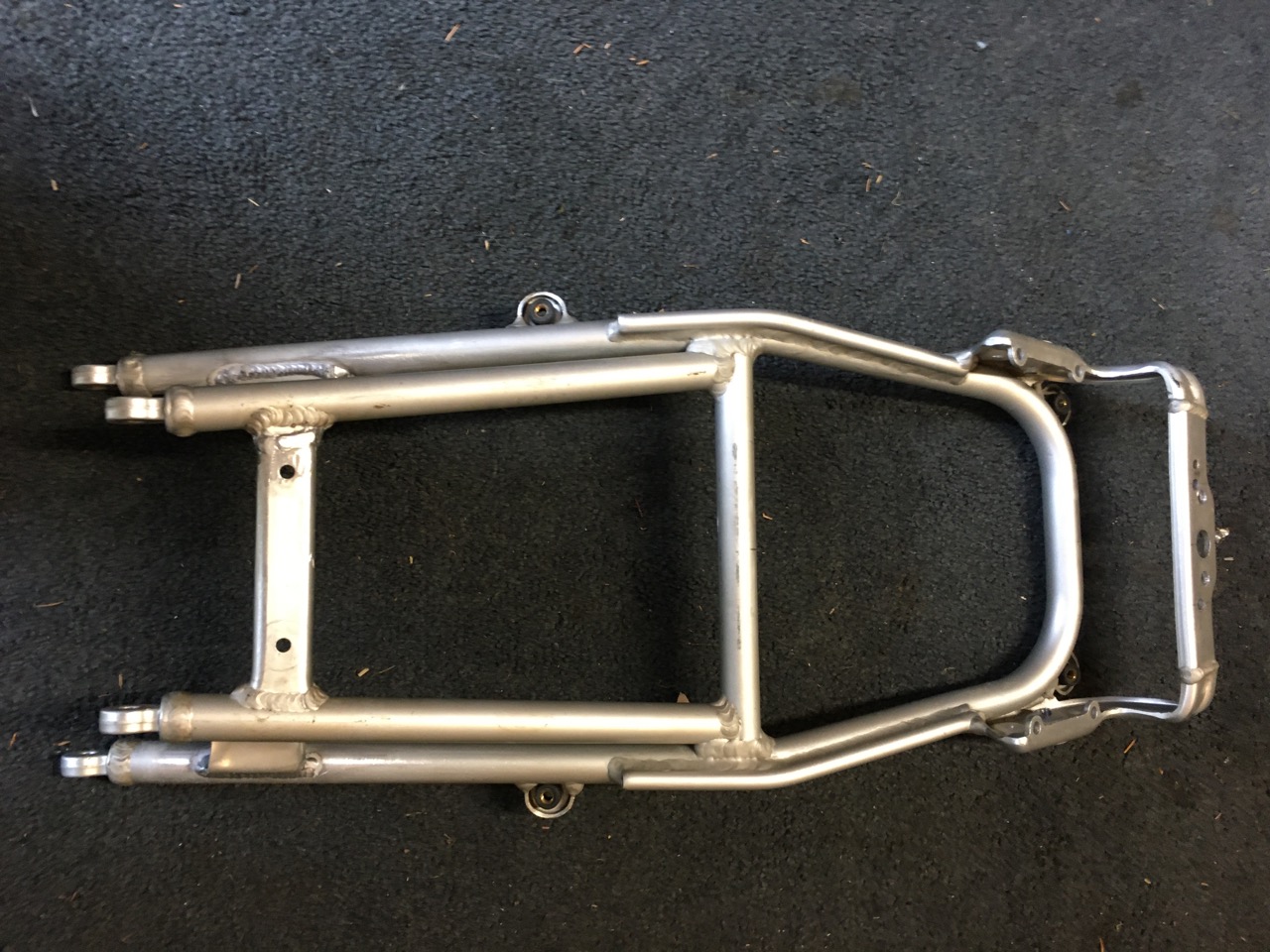

    I also bought a monoposto subframe so the plan was to fit that as well.

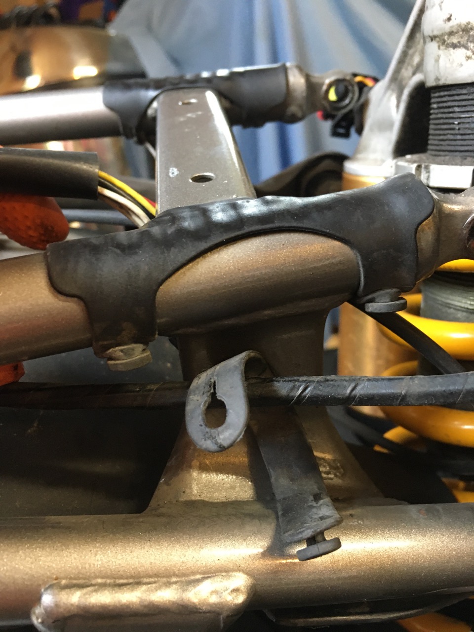

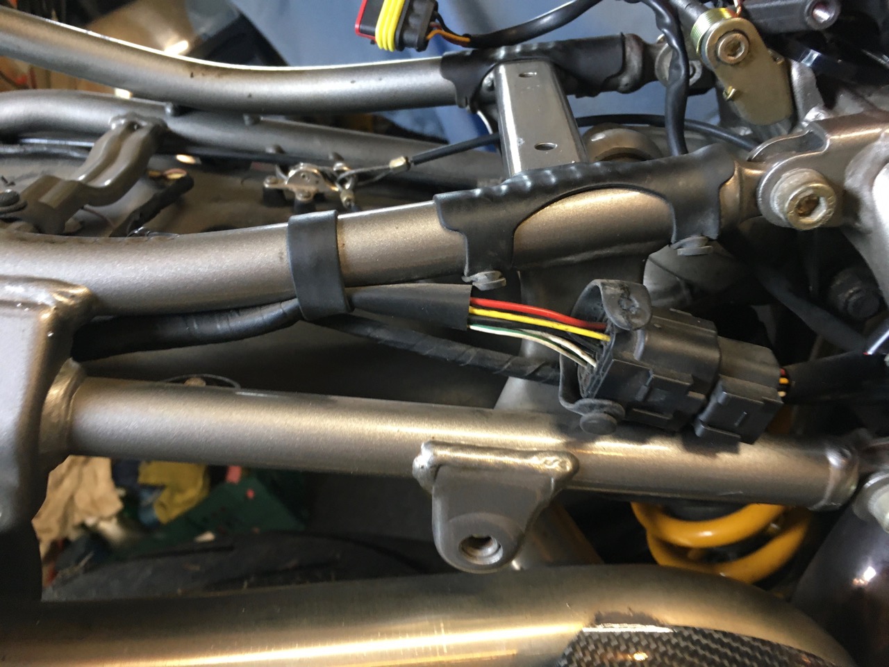

    However, the bike has an alarm and the fitter ran part of the alarm loom through the subframe and not behind it :(. It's the piece wrapped in black insulating tape. I can see why he did that as there's part of the bike's loom run through there as well plus there's a rubber band to hold it in place. The problem is Ducati thought about it and put a connector there which allows the loom to be broken and passed through the subframe; the alarm fitter didn't think about it :mad:. The only way to get that out of there so the subframe can be removed is to cut it:( and guess what? all the wires inside the tape are black. No monoposto subframe today then.

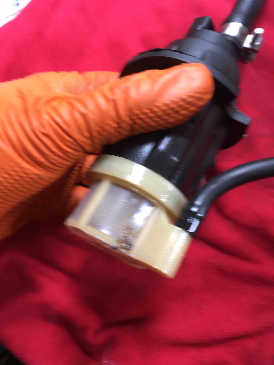

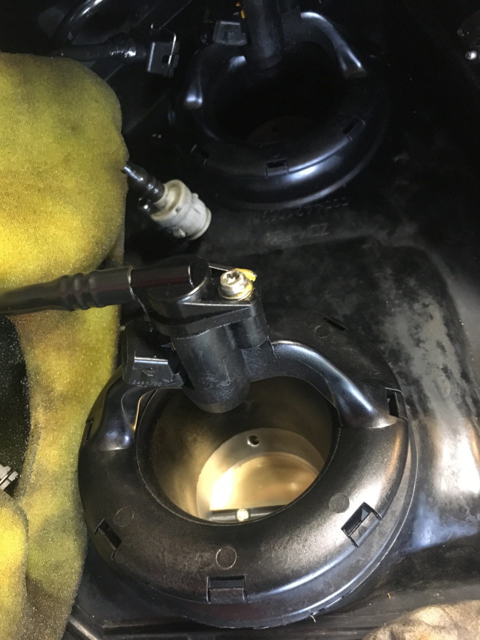

    Time to reassemble everything and move onto the original job which was to replace the fuel filter. Tank off, fuel drained, pump assembly out and check it over. With the exception the filter is dated 17.02.04 all is good in there, all the pipes are in good nick:upyeah:. Old filter out, fuel pump out as well and check the gauze filter underneath, not too bad (apologies for the blurry picture of that one) just a tiny bit of what looked like fluff, otherwise good. Clean the pump pick up filter, replace the fuel filter with a new one dated 10.01.20 and reassemble the assembly.

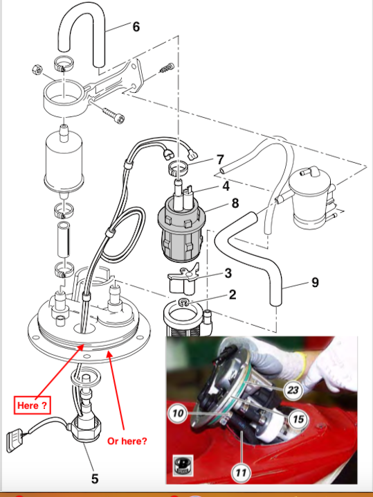

    Now for reassembly back in the tank tomorrow morning. A question though. Should the large green O-ring sit on the bottom of the fuel pump flange where the no.15 is in the colour photo below, or should it sit on the shoulder above that, where the no.23 is in the photo? I can't remember what I did when I replaced the fuel filter on the 748 last year but what I do know is that when I first reassembled the 748 tank and filled it with fuel it pissed out all over the engine:( as I'd nicked the o-ring putting it back together:astonished:. Just in case I ordered two this time round :).
