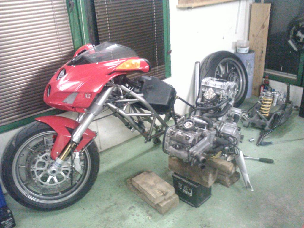

  4. I tried the bike today and the gerabox is working fine. The crack is from the bolt to the left and to right side as well. We will see how will be during the welding. I will inform you how it goes. Please wish me good luck as much as you can:upyeah: !

  7. I am not a welder but one friend of mine he is and he use weld egines so its not will be the first one and especcialy not the first Ducati :) Yes we will weld with TIG. I will se how it goes if i will see that no chance to weld it correctly then ai will purchase an engine block and done , but i hope it will be ok. We repairing motobikes but with the Ducati till we didnt had any experiance except oil change :)

  8. Hi Guys!
    the engine is out on friday or saturday we will weld it.I decided to rebuild for Biposto. Where i can buy subframe,rear seat,fairing,rear footpegs?PLease if anyone know these goods for sale let me know.

    Is anybody would like to see how the engine looks after welding? If i will meet again with seller of mine bike i will hit a shit out from him bacause this engine was really hardly destroyed and already welded in the past and he didnt tell me about this nothing.
    Fisikly we sou only 1 crack on engine and when we start with a welding we foun another 5 or 6 crack on a bottom :( Evening i will upload the picture
