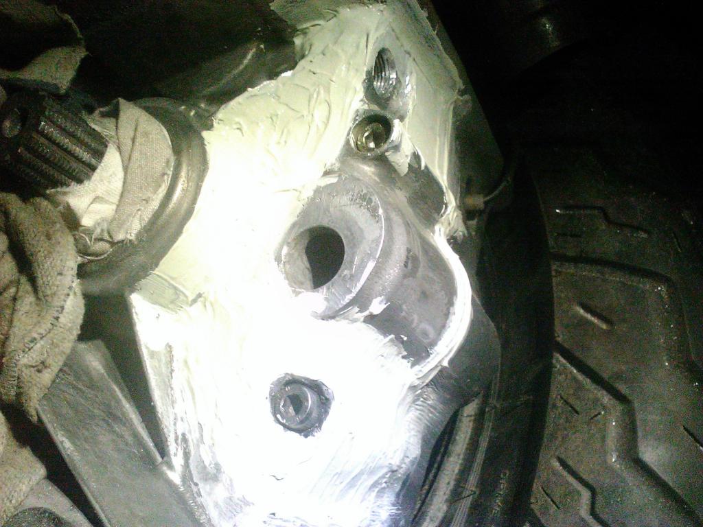

  4. GUYS COME ON !!! DOnt be hopeless :) we tried the negine under pressure yesterday and it looks ok.We put on welding some special glue as well.I will put it back in the frame and i will try it how its doing and after that i will sell it for PETER JAMES :) i just joking.Defenetly if its will be shit then i will change the engine and if its will be ok then i will use the bike only on trackdays.
  5. Fuck that, when it lets go and sprays the rear wheel with oil. If Peter James does not buy it then please find a new engine
  6. Pictures as i promised. WP_000239.jpg After welding and the special glue.Before grinding and painting :(
  7. you'd never notice that at all !
  8. Where did this Peter James is going to buy it shit come from ? :frown: I'd run a mile from that repair, and wouldn't give the time of day to some scroat trying to sell me that.
    I feel for you xb12r,you were caught by an odious twat selling that as a usable bike. I'd be looking for a replacement engine or at the very least sound crankcases , providing nothing else intenally is lunched.

  9. special glue you say - and what type would that be...
    it looks like car body repair filler.
    good luck
  10. My money is on wonderweld

  12. Loctite hysol 3479A&B especiali for a aluminium with big heat resistance till 190degrees.Thanks for wishing good luck i will inform you about results.
  13. Xbr12 , I feel you pain and frustration, and admire your tenacity and determination to put it right, however can't help feel your using a sticky plaster to sort something requiring major surgery?
    As I understand it the testastretta block is highly stressed bit of kit' couple this with the strain and vibration of the road use, and really you've got to bring in to question your own safety????
    5 or 6 addition fractures underneath the thing sounds as fragile as a faberge egg! I can't understand how cast engine cases have so many fatigue fractures perhaps a bad cast at the factory who knows but as said earlier if the arse drops out of it at speed I don't fancy your chances of staying upright once the chain and rear wheel have taken delivery of whatever comes out!
    Seriously dude bite the bullet and source a new engine, forget the previous owner you've now got the responsibility of putting it right and having a lovely machine to ride! Remember a repair' is just that. A repair!
    (Ps it's only coz we care)

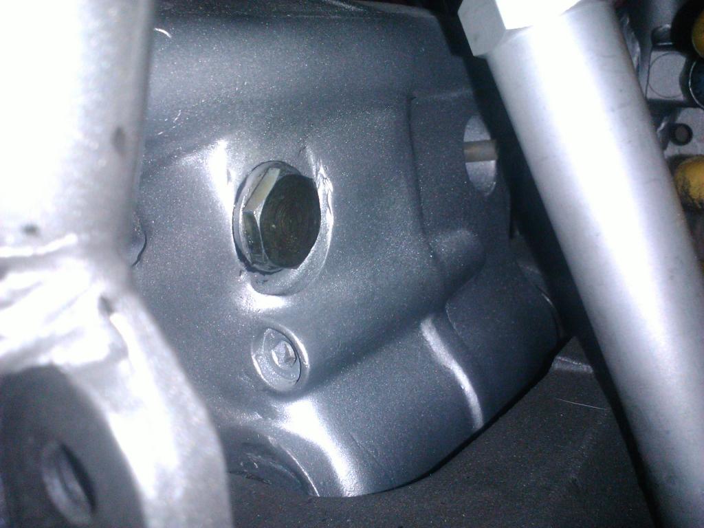

    the engine is back in the frame.today i will attach picture how it looks the place of the crack.Yesterday i insatall all connectors and wiring back.
  17. Hello everybody,
    so this is how it looks the engine where before was the crack.This weekend i hope i can finish all bike.Today i will get a biposto subframe i find in hungary for 400eur with fairings and pegs as well include the rear seat. WP_000251.jpg
