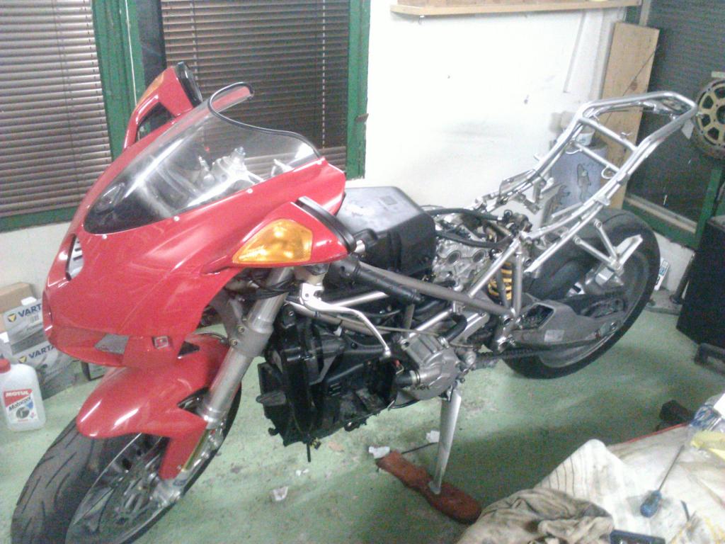

  11. Hi all,
    Yesterday was the first start up after assembly.everything is running ok except my left front turn light :) . I warm up the egnine and let it run aprox 30min. after i checked the placesis where it was welded and itt looks ok till now.But i saw little oil flow but not on the place where it was welded but on the bottom where the engine bloks are fitting.How they can done this fuckin solutions.If you want to change gasket you need to remove the engine and disassemble the engine :(.
    Guys please check your engines if they are totaly dry and no any drop of oil on it.Here are is picture how my bike looks at the moment. WP_000256.jpg
  12. ooh man. thats bad luck dude
    your having a shit time of it
    no oil here - your just not meant to see oil on the outside of a motorcycle or any other engine - especially a motorcycle engine

  14. Ok so you've fired up your repaired engine , I assume it's ticking over at about 11oo/1200 rpm and you've probably given it a few revs to 2500/3000 till the bike settled at tick over.
    And theres a weep of oil down by the engine mounts (below your repairs).
    Xb think about this , it's leaking oil sat still with the engine vibrating in the frame, and you seriously want to take it on road or track using revs anywhere from 3/8000 rpm plus the stresses from riding, cornering uneven surfaces and potholes etc.
    Throw that engine in the skip and stop trying to convince yourself you can save something from a seriously bad piece of luck.
    Pete.

  16. It looks that on next week i will buy other engine.I know guys who buying motorbikes from italy and i call one of them and he told me that he know 1 its around 600eur.I will buy it , i cant do anymore i tried everything it looks this engine its fuckin shit.I hope that with the other one i will not have any problems.
  17. Hopefully an engine change will sort you out and get you riding
  18. Don't forget you will be able to salvage some parts off your leaky engine and get some money back, so its not a total loss
