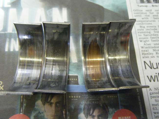

    In my case Ducati John actually took the engine apart while I waited just to give me a rough idea as to how much it would cost and I too was very lucky as it only needed main bearings and new big ends which were down to the shell.
    Here's what my big ends looked like after just 4,000 miles, some of this might be down to a negligent owner but it's certainly not good View attachment 19624
    See below!!!

  13. whit the job i cant see a problem because i also repairing motorcycles as i mentoined when i changed the engine before season but i have very poor experiance whit Ducati engines. But now i am sure that i will repleace the beearing on cranck as well. I cant open the attachment. It would be nice to see it how it looked.

  15. That link is failing for me (i'll have to look and see if I can find pics of the grooves of my cases) Mine was at 6k miles, but i reckon it had had some track time. The bike came with a 6k rebuild bill from Sigma....yeah whatever, when we opened it up it didn't look like it had !

  18. Hope this works now I have reduced the size etc.
