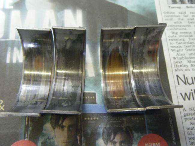

  2. Its looks like a shit :( after 4000mile ???? my god :mad:
  3. +1
    is that after a rebuild ??

  13. Sorry to hear about one more 999 with bearing failures - I trashed my 999S main bearings + cracked the casing on the track end of July and we are now rebuilding the engine with a pair of used casings. The parts are insanely expensive and I'm not convinced that this will not happen again which is why I bought a Suzuki GSXR750 K7 trackbike as 'spare'.
    I have the same frustrations that you do as I had just learned to ride the 999 and got it properly setup etc. etc. and then the thing exploded in my face! I have now used the Suzi for a couple of months and I am reluctant to switch back again as it takes some time to get used to a new bike and get the lap times down.
    good luck with it
    Jim

    so you are in a same situation like me thats a shit , i just hope that the bearings are not specified and i can use there other bearings fro example KOYO or some kind of german bearing because as you sad god knows how long it will runs whitout any problem. Thats funny that after 12000km can happen this kind of problem , some people doing at one season more than 15000km and with this bike after every season i should split the fuckin whole engine for a rebuild?
    You changing also the other bearings or just the main?

  18. We have tried to find replacement bearings and it is possible for the gearbox bearings but we could not find a cheaper replacements for the stupidly expensive main bearings. You even have to buy the bearing sleeves too as the main bearings are housed in sleeves inside the casings. In my (hopeless) case, bearings AND sleeves AND casings were toast!
    Pics:
    Ducati 999S Engine Restoration - a set on Flickr
    br
    Jim
  19. Jim , thanks for the nice pohotos i will do the same like you did i will make a pictures of each steps and i will upload as well. So you say that the bearing which near the front sprocket i can buy from other manufacturer. What do you think if the engine will be splitted then should i change the main bearings as well?
