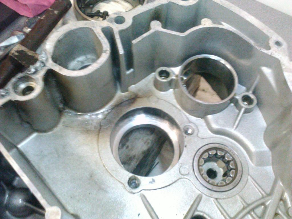

  6. Dear All,
    Sorry for a late update but i was "lost in space" :) lot of work behind me also my wedding:) but finaly saturday i disassembled my 999 engine and i found the biggest shit what i ever seen. Maybe you remember that i bought other engine because i dont wanted to weld the crack which was on a back side of the cranckase. After the dissasembly i found weldings on my engine and also the reason why my bearing damged if you will check the picture you will recognize the problem imadeatley. WP_000466.jpg
    To buy the bearings its no problem because all bearings in the engine are from SKF and i have cotract with a supplier of SKF bearings.This double row bearing its around 35eur. Biggiest headache i have because of this engineblock, lot of crancks are in and i dont want to by another engine or block. I will try to give for my friend who will try to weld it more professionaly like it was made and i will see what will happen.
    I will invest more money to this bike like to my previous japanese together. :(

  9. @xbr, don't weld those cases - they will just break again IMHO. Get a set of sandcast cases - they are stronger than cast and won't let you down.

    i cant trust any more for those bikes i will try to solve it but as i sad i am bit pissed of because i alreay invest a lot into this and i stil have a big piece of shit. By the way i already searched another engine block but how can i be sure that it not will be again some kind of cracked shit. What do you think under sandcast cases sorry maybe because of my english skills i dont understand. Where i could look for it?
  11. the sand cast cases are made in a mould from sand. To make the cases/block you make one mould, pour molten metal into it, then you break the mould to get the cases out. They are much stronger than standard cases and were used on all the race bikes, legally or not!

  19. yep, you're right. I am not sure it is good to weld these cases again though.
