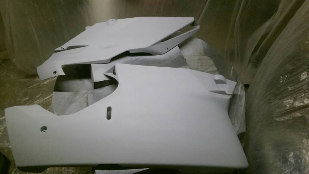

  5. Bad attempt at spraying this morning :-(. Think I need to do one part at a time not 4 as not enough room. Problem with bike parts is all the funny angles and shapes. Nothing is flat.
  6. Spraying improving, slowly. Still rubbing off 50% of what I put on :-/

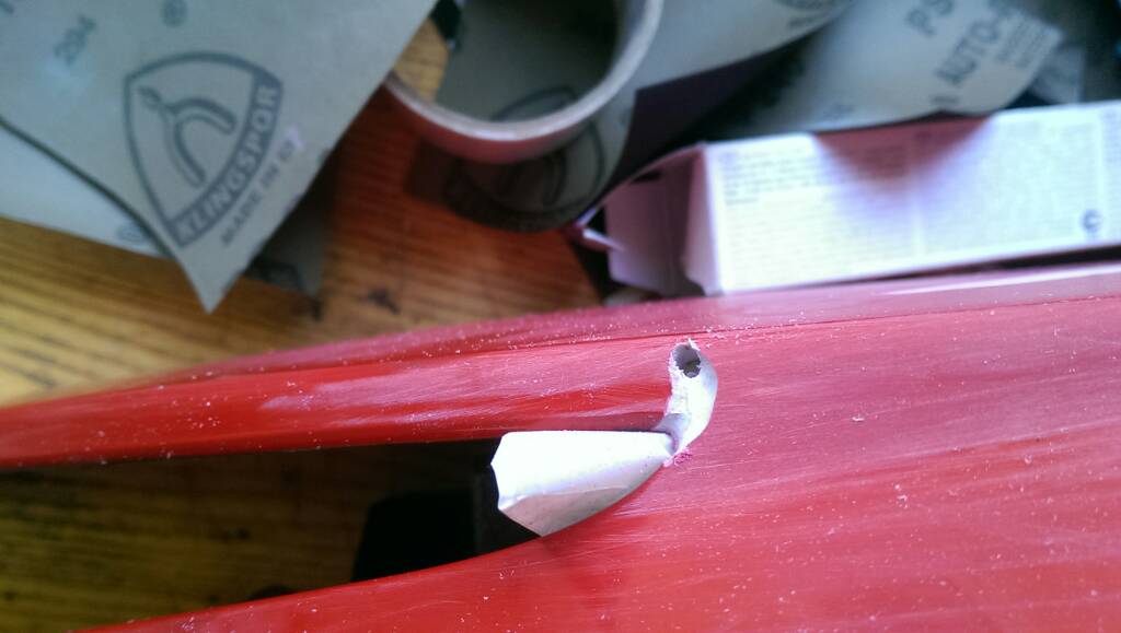

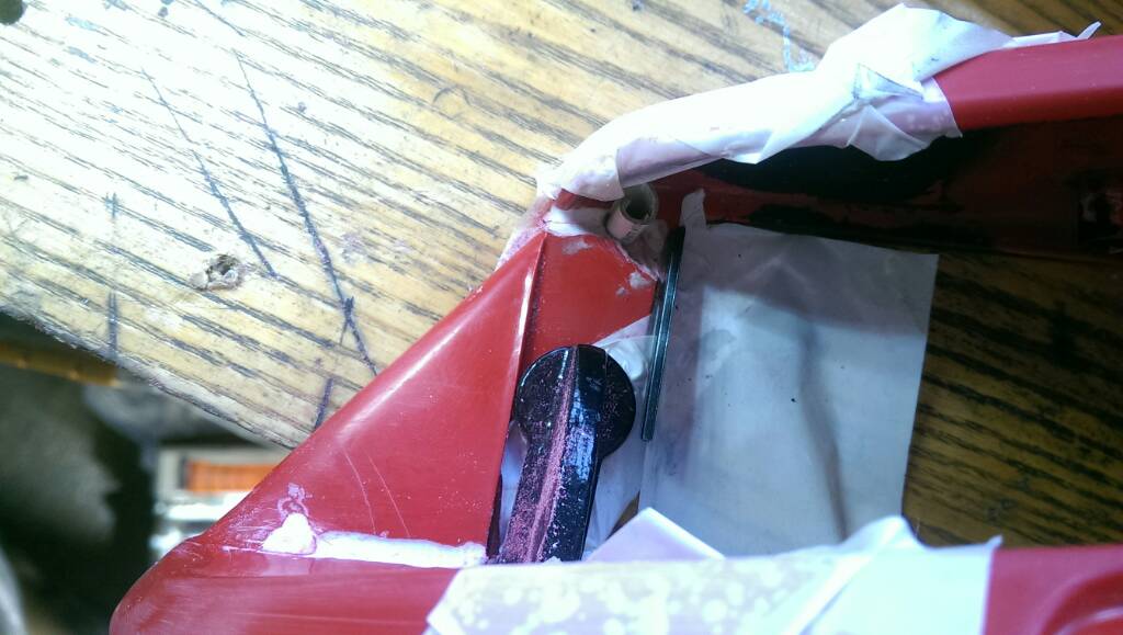

  9. Bit of fairing repair.
    [​IMG][​IMG]
    Went to clean up the air intake covers. Turns out one is OEM and the other is painted reproduction. So checked CF and £100 the pair. Nothing on eBay. Long shot, let's just see what Moto Rapido will charge......£18! Nice! Apparently if it's black plastic its not normally to bad. Who knew.

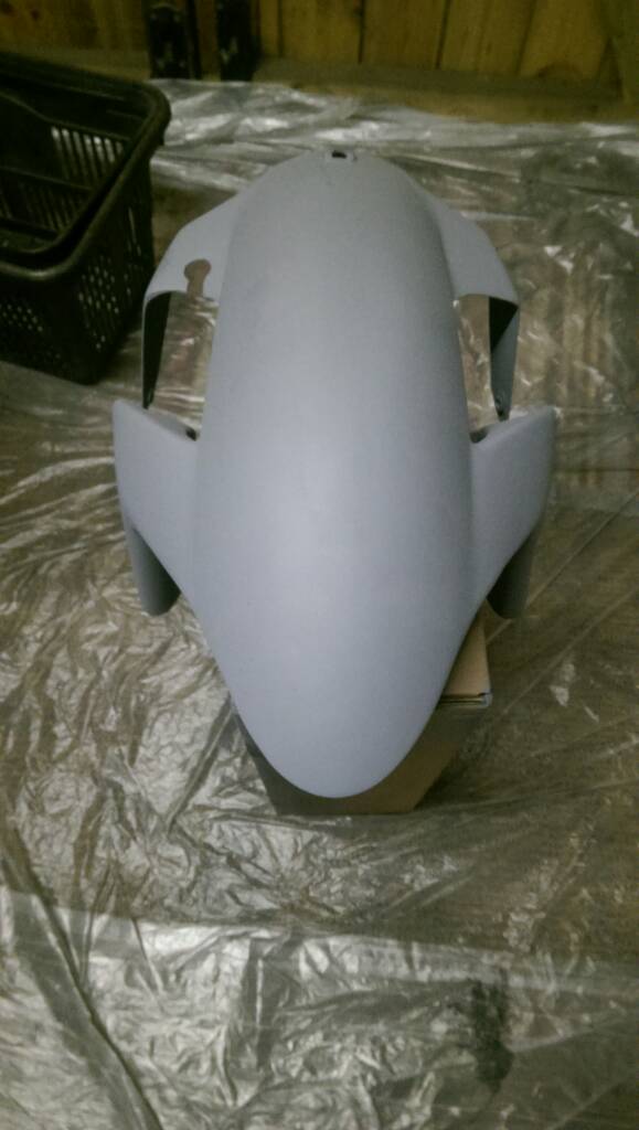

  12. Slowly. Trouble is I'm 50/50 with just chucking it on and my perfectionist tendencies. It's somewhere about poor road/high quality track at the moment. It's a massive improvement on what it was though. Thing is, to fix a small imperfection requires a lot more sanding back and re priming and painting. A lot of work for a little improvement. I have the tank & 1 panel left to do then everything needs the lacquer. I'm leaving that till last so I can set up a new clean murder room. It just takes so long to let the panels dry after washing, sanding, primer and painting.
    I have one part, the small front seat plastic, I can't get right and have painted about 12 times but the imperfections keep coming through. I've tried all sorts and its a right pain.
