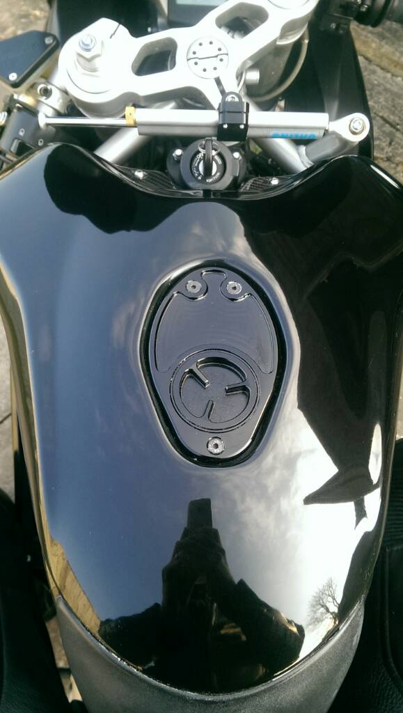

  3. Re ; fancy racing fuel cap, I had one of these and it did the same thing. ~after some trial and error I realised you need to lift the large round washer from the original cap where it seats into the tank and place it on the new one. After that its never been a problem. J

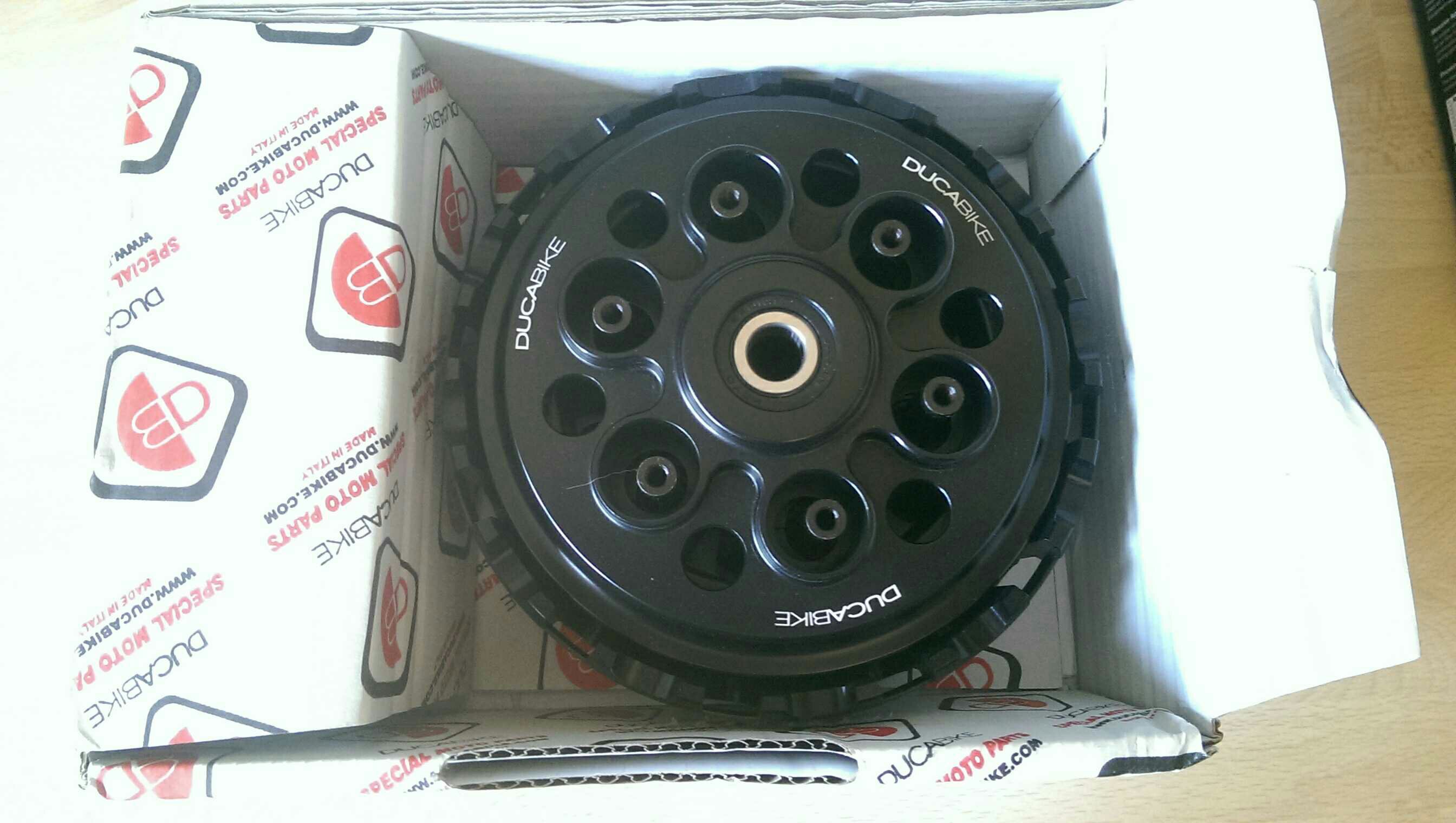

  9. More goodies.
    [​IMG][​IMG]
    Sent from my HTC One using Tapatalk

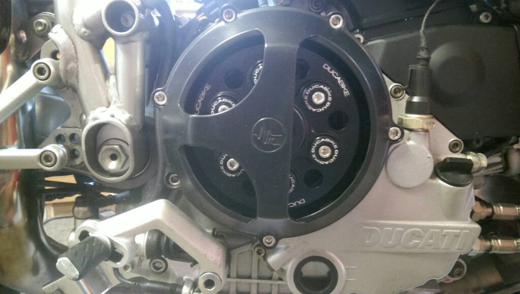

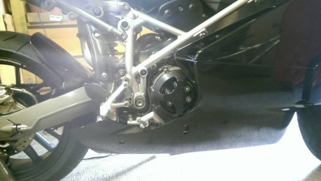

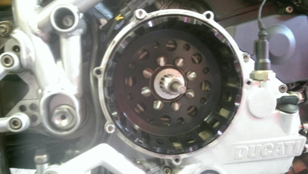

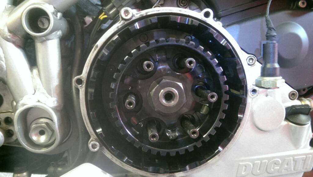

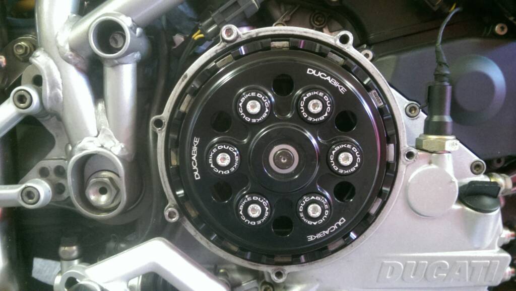

  16. Fitted the slipper at lunch.
    Crap camera and lighting doesn't do it justice.
    Fitted pipercross filters last weekend.
    All ready for a Sunday fun day :)[​IMG][​IMG][​IMG][​IMG][​IMG]
  17. Tested the slipper. She slippery alright. Went hard down box coming off dual carriageway. Normally would have smashed revs through roof and smashed me nuts but was so smooth! A little grabby and bite point a little to close to handle bars but I'll play with the stack heights. Quite a bit louder than old OEM clutch bit that had quiet clutch mod. I may but a new set of alloy clutch plates.....
