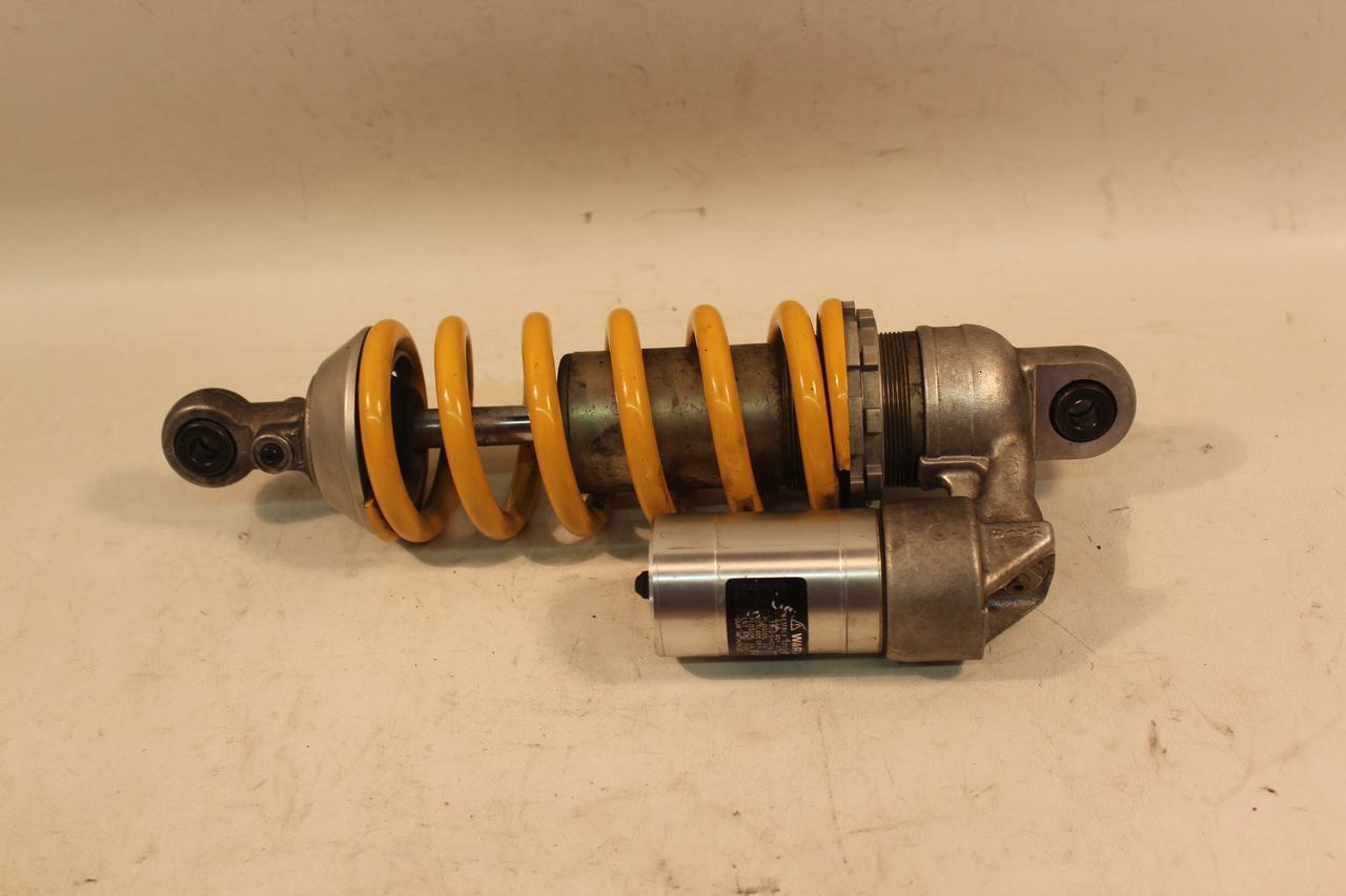

  3. Received my new starter leads (thanks Exige) and started stripping it today, does not look like it has ever been out in the wet. Has a Motobat fitted which shows a bit of love but not as good as a Yuasa AGM IMO. What is the standard rear shock for a base MY03 999?
  4. tip,, ( if required ) take a few good clear photo of the wiring box before you strip that any..
  5. Lovely Nero you've got there mate! :upyeah:
  6. Standard rear shock for that model is Showa.
  7. Loz, that's what I thought, will have to desticker the shock now.
  8. This is a standard 2003 Shock
