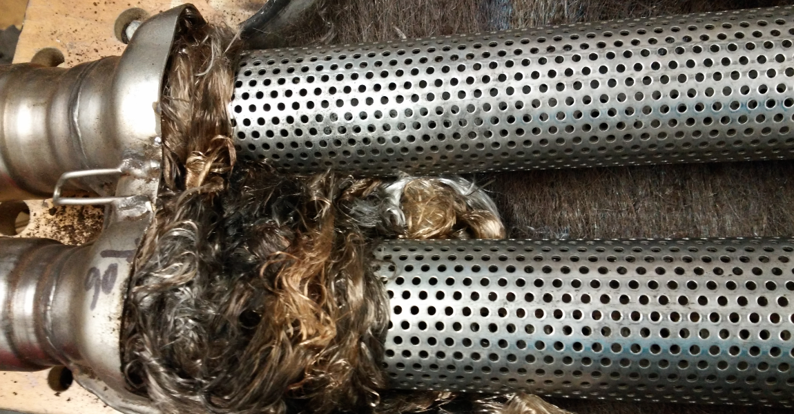

    Chopped the perforated tube to length, flattened and angled the outlet ends to match the Flat Oval tube outlets. They are a snug fit so I tried to keep them as tight as possible. The larger inlet side allows the pipe to slide inside about 25mm so I did this and then pulled it back out to meet the outlet.
    The smaller inlet side had to have the perf tube on the outside as it is about 5mm larger than the original pipe size. A little bit of filing to get it to fit nicely.
    Again the ARC is quite fierce but good enough to secure the already snug tubes in place.
    #23 Dorset Desmo, Feb 9, 2016

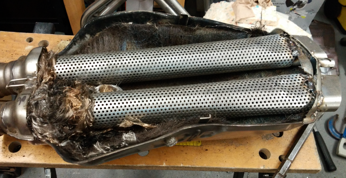

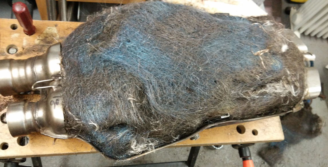

  4. Before I welded the pipes in place I laid in the original Wire Wool pad in the base of the silencer.
    Then the Yetti Hair went in around the pipes - shoved in with a Hilti Chisel and screwdriver.
    Finally I put in a top layer a Wire Wool which reminded me of Donald Trump for some reason.

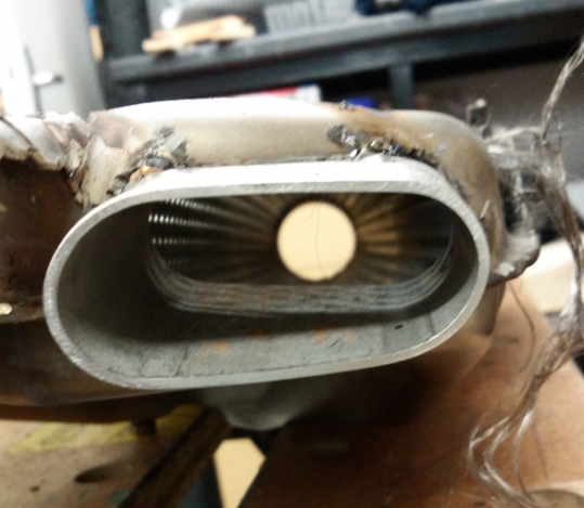

  5. Inlet Tube.png Outlet Tube.png Here is the view through the pipes...

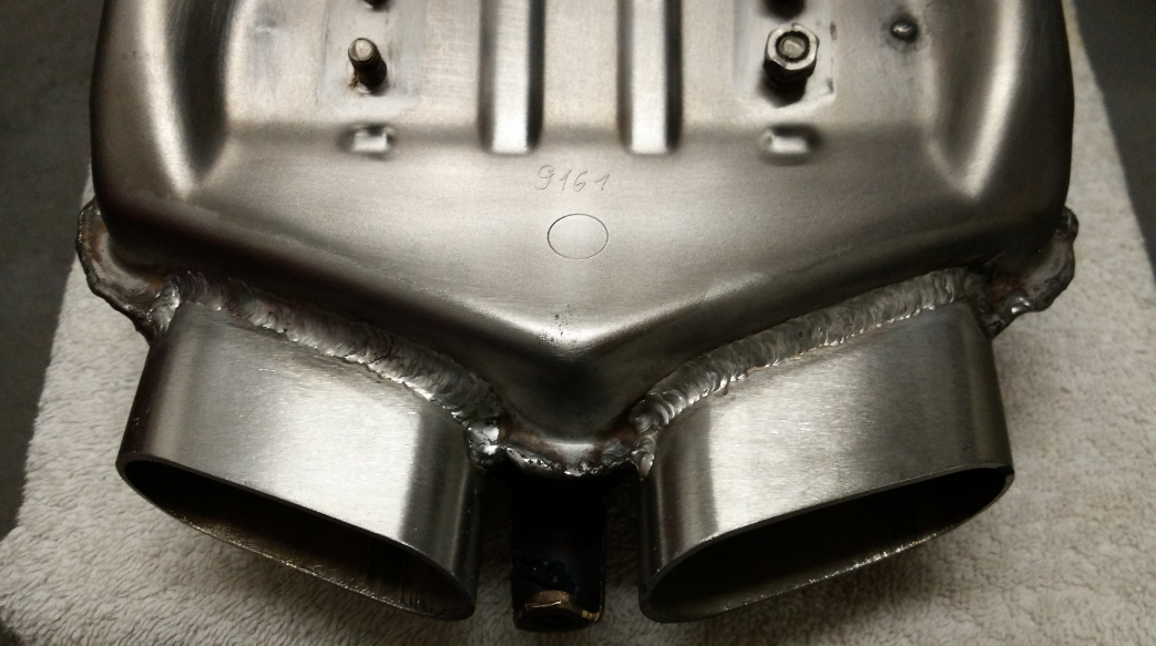

  11. Got the Zaust back from the Welders today... He did a nice job and the weld beads look funky even though you won't be able to see them!

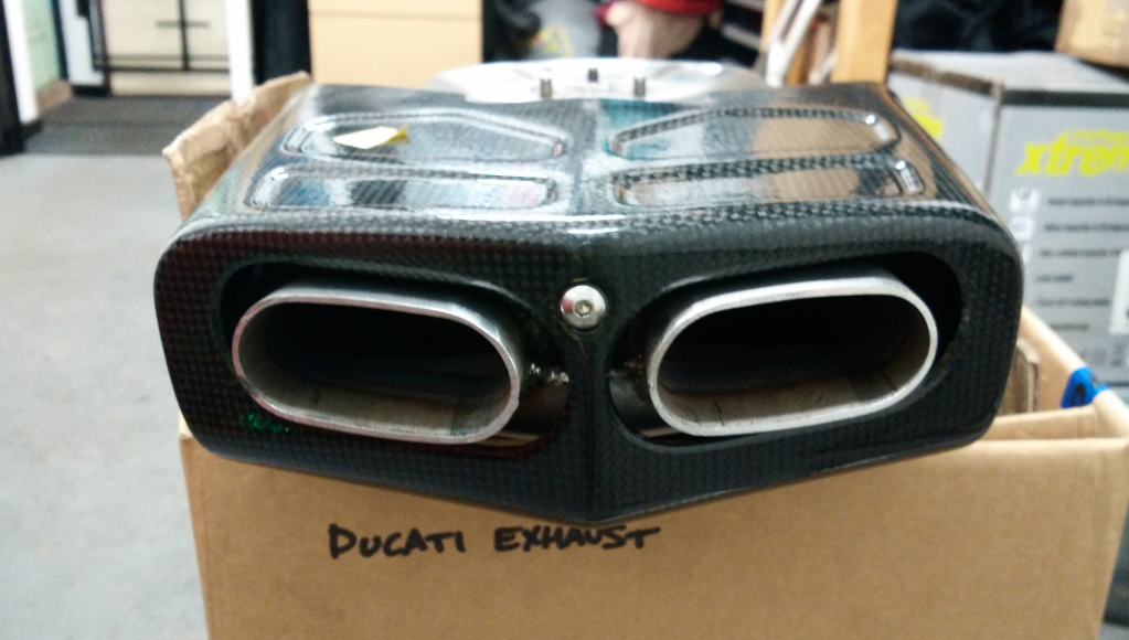

  12. Here are a couple with the cover on... (The "Ducati Exhaust" writing was already on the box!)

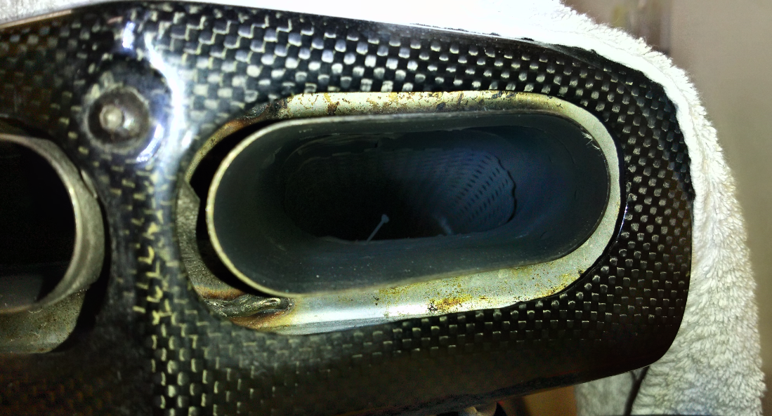

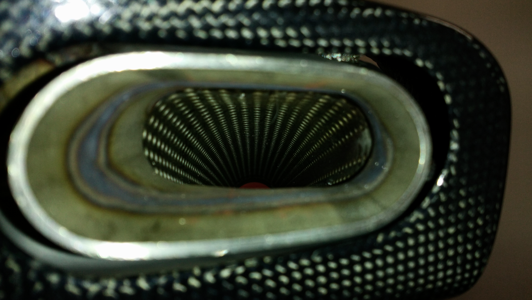

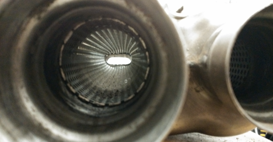

  13. and a view down the pipe of the Termi and then the cored one:
    When I get chance I will do some sound comparisons. Have to change to standard for the MoT anyway soon.
