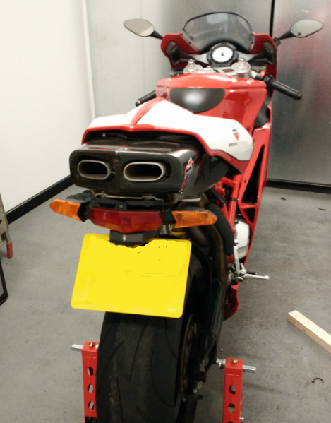

    For the cost it's safe to say that the welding far outweighed the materials cost....! I don't think I will be setting up a 999 silencer coring factory to make lots of money any time soon, but if you can't get hold of a decent Termi Silencer for reasonable money it is a good option - and it won't crack.
  13. Finally got around to fitting and trying out the cored standard silencer.
    Went for a days ride and it sounds identical and behaves just like the Termignoni. Makes sense really as the internals and the shape / volume of the silencer is pretty much the same. So happy with that.
    Haven't recorded the sound of a drive by or tick over comparison yet - but will do before I take it off again. I may even sell the Termi instead.
    I also have another Termi can that is badly cracked around the top mount presumably as it is a well used one and the type without the brace plate spot welded inside. With this one I am going to try to use the shell of the stainless standard one and modify it to accept the riveted Termi Inlet / Outlet and internal perforated pipes.
    Here is a pic of the cored one fitted on the bike....
    Cheers,
    DD
  14. Certainly looks the part.
    The cored standard can on my bike has had similar treatment and hasn't suffered any cracking etc at all. Combined with a PC3, it enables the base motor to dribble out a little under 130 rw bhp, so maybe selling the Termignoni is the way to go
