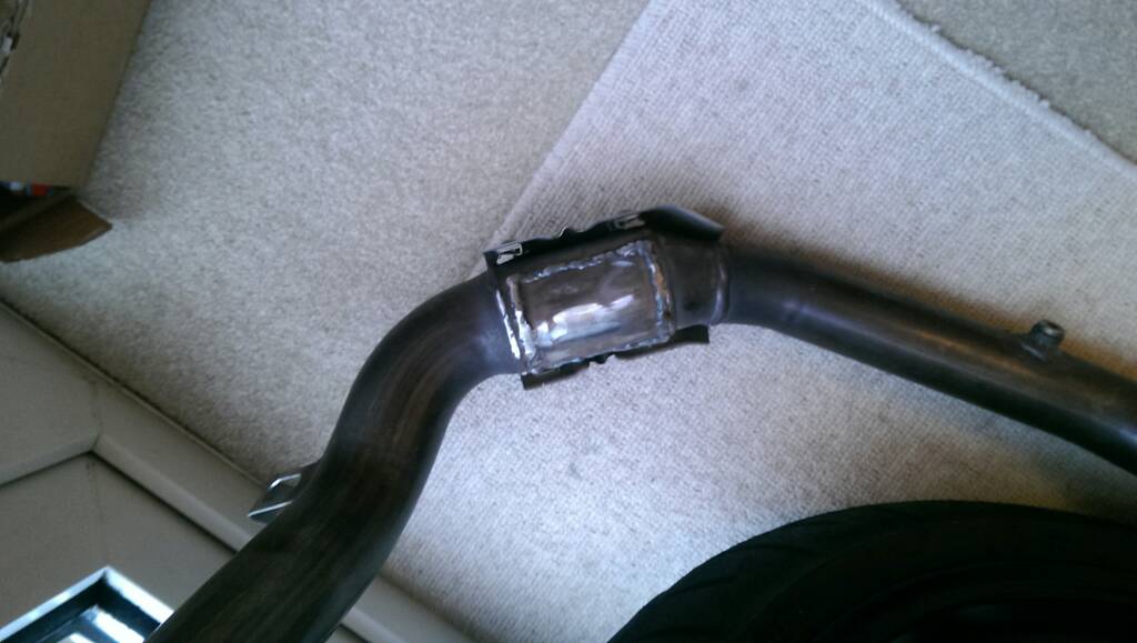

  5. I've had a crack, it's a bit of a nightmare. Also found a local guy that recons he can do it. He's currently decating the link pipe :)

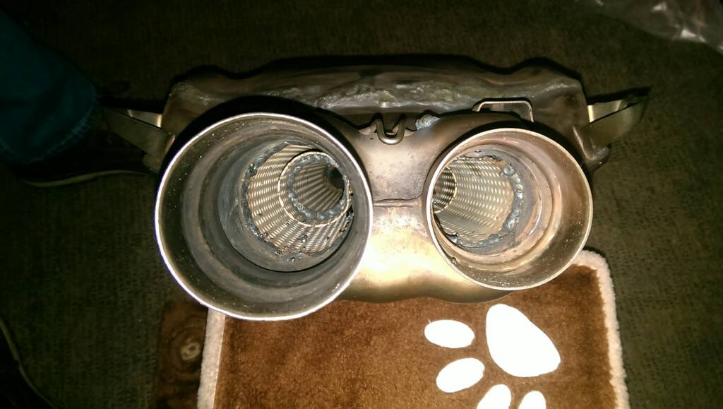

  7. I used Silent Sport Premium to fill my Termignoni canister. Did the job and since it is long strands of it,
    I don't think it's possible to blow out anyways.

  8. Ended up buying some of the mat style stuff to wrap round the perforated tube and some of the loose stuff to pack in the corners and odd shapes, seemed like the best solution.

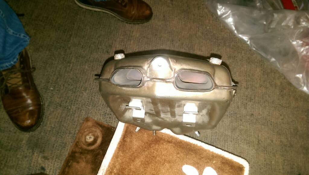

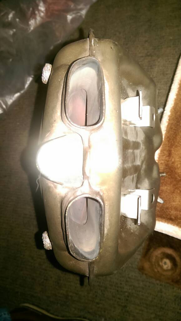

  10. So got my exhaust back from Simon at Schuband Autoworks :)
    I was put in contact with Simon by another company, as you can see in the Facebook link below, he doesn't normally do anything bike related, mainly performance manifolds, intercoolers and other car fabrication but he was up for the challenge!
    Schuband AutoWorks
    Looks like he did a great job on it, going to fit it on Thursday on my day off and let her rip!
    He said he would defo do others now he knows the process so I thought I'd help out a small local business (near Sheffield) and put the details on here (plus he's a throughly nice guy).
    If you want yours doing, he charges £150 (I supplied my own packing and perforated tube) and you can get in touch on 07872 333649.

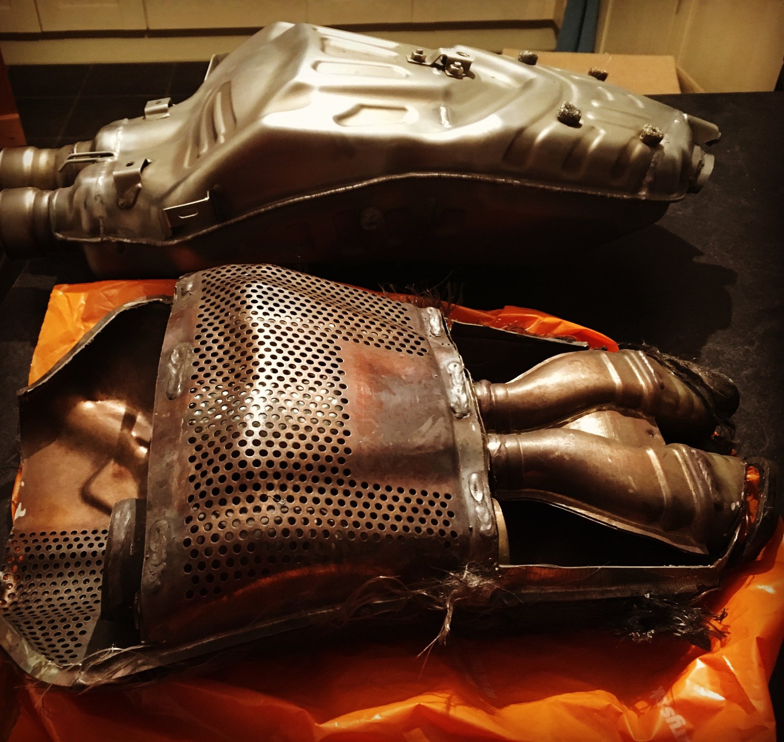

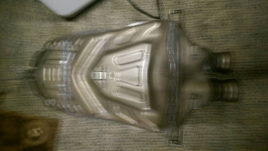

  12. So that part at the front was removed? I left the end part the same so it looks OEM and will hopefully keep the noise Track Day legal. Not plugged it all in yet. Mines not as neat as yours but you'll never see it when fitted. Got the mid section decat too.
  13. I got a 600g bag and a 1m roll and got the welder to whack it all in. Got .5 meter of perforated 35mm, 45mm and 57mm so it conicals down through the can.
    I'm hoping for exactly 101db......
  14. Yeah, the section in the front of the picture was taken out of the exhaust, just the shell left.

  17. It's fitted and sounds awesome (how it should!).
    Need to get a vid and host it somewhere as the file limit is small on here.
    I weighed it before putting it back on and it was 5.5kg. Not sure what the standard one weighs, I do have a spare but this was on the kitchen scales and it maxed them out (don't tell the mrs).
    The stuff that was taken out was 3.2kg but I obviously had other stuff put back in so don't know what the true weight saving is but even if it was 1kg, that's a decent saving!
