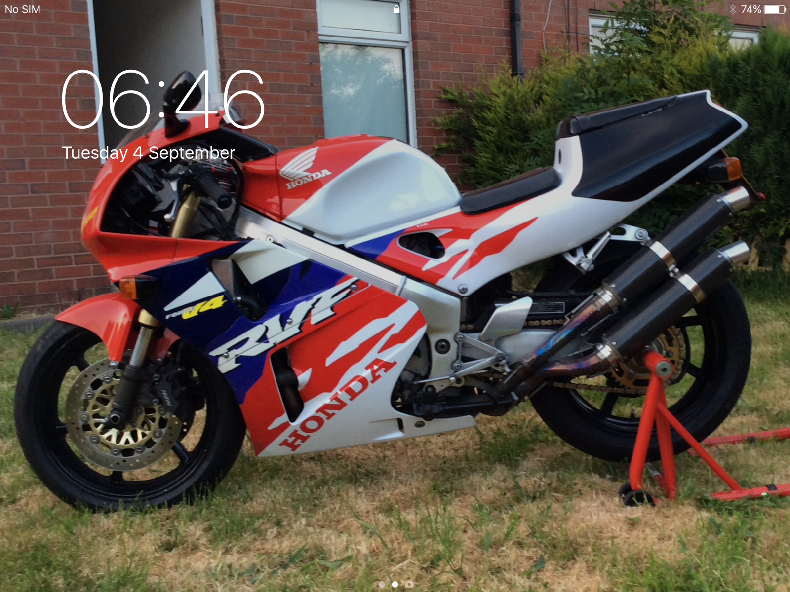

  18. Why don’t you buy my rc45 joe? £4995 ....all seriousness well done to the many who contributed on this, priceless help and info as mentioned by joe ....you make a good team you should all get on :upyeah:
