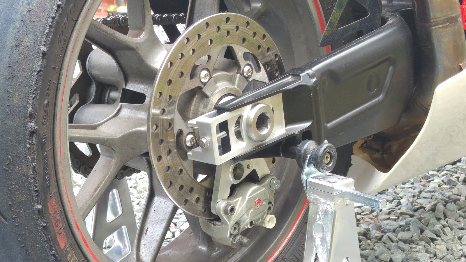

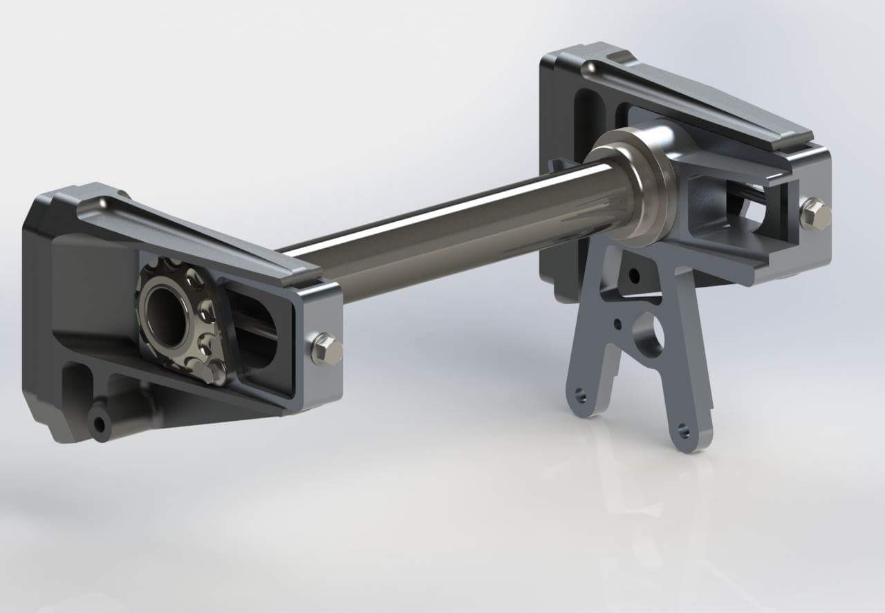

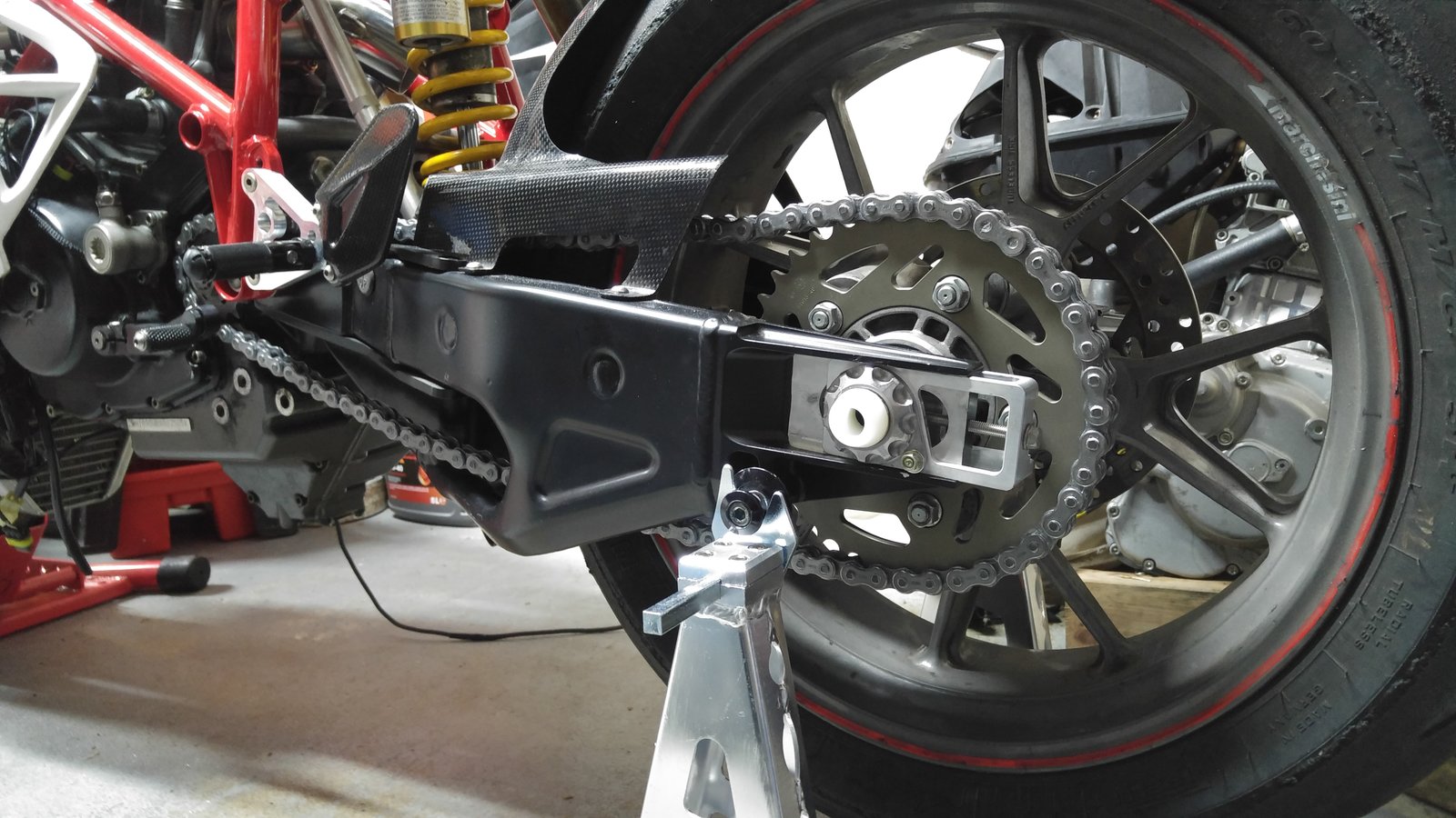

  3. What would have been cool would be a QR rear axle with a captive spacers and caliper. Done to a few race bikes like this. Makes rear tyre change a breeze.
  8. now he has got you there x racer..
  9. Clearly visible in pictures earlier in the thread. He should have gone to specsavers!:joy:
