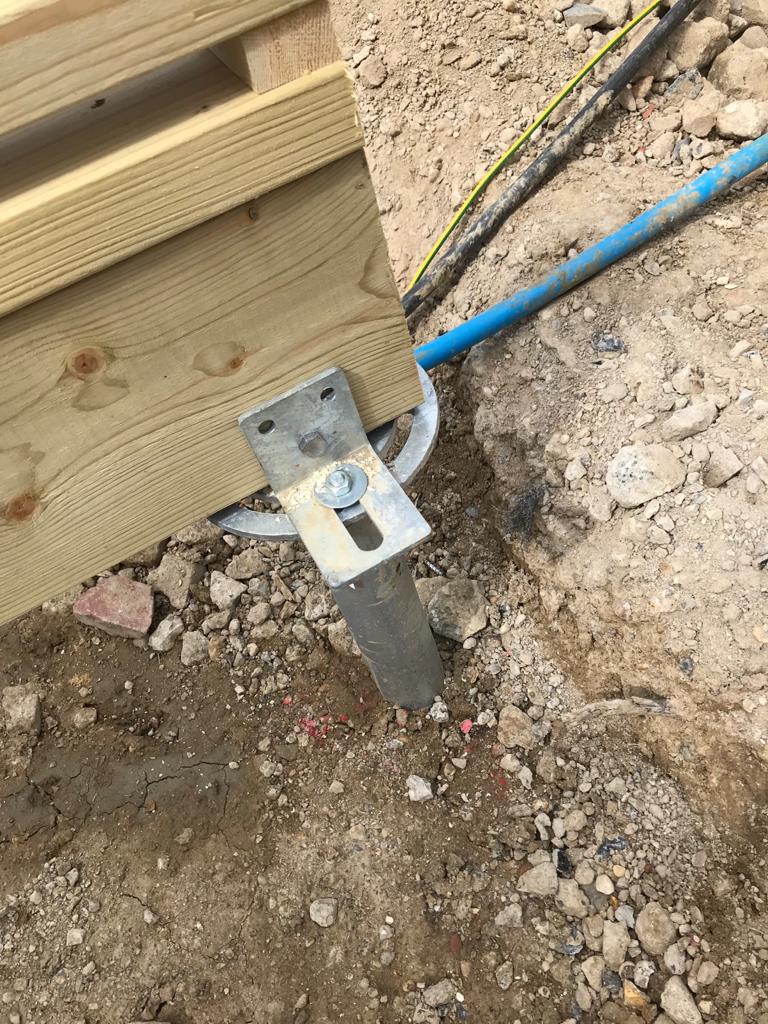

  1. Re the galv screw pilings.
    They were introduced to the building trade here but I have never seen or heard of them since.
    Part of the integrity of a concrete footing is just sheer downforce by mass. Hard to engineer that out maybe...
    I am a big fan of concrete, it is cheap, strong and available. You also have the opportunity to shape it, level it, colour it and use it as thermal mass depending on design. of course I have also seen some hideous examples of concrete buildings where one persons idea of raw industrial beauty just looks like an old pillar box. Opinions eh?

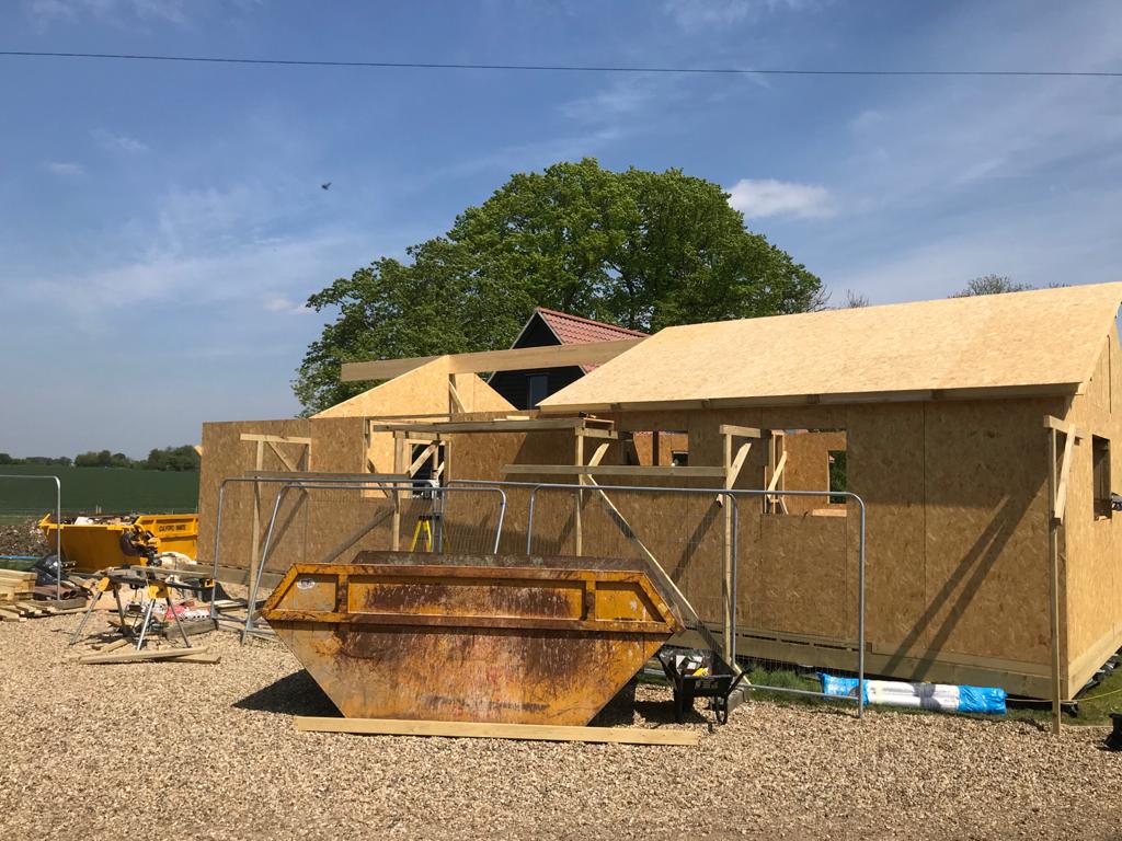

  10. another week in and im absolutely shattered again! we were to stay over the weekend and carry on but me workmate had to get back to get meds for his old man, the chemist short changed him.

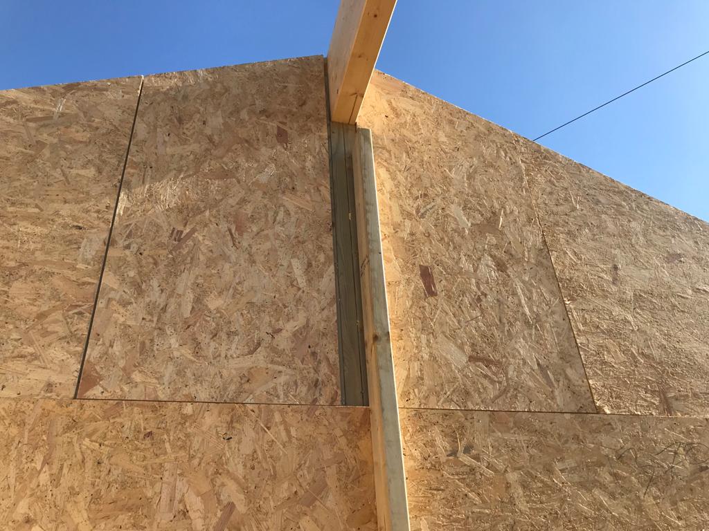

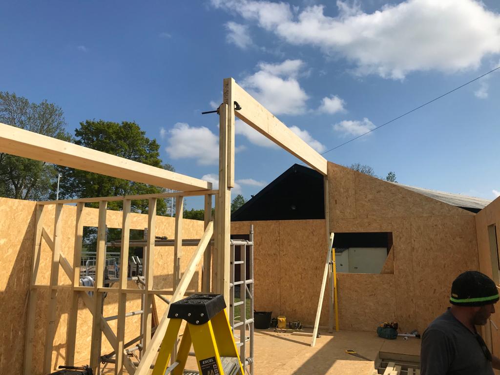

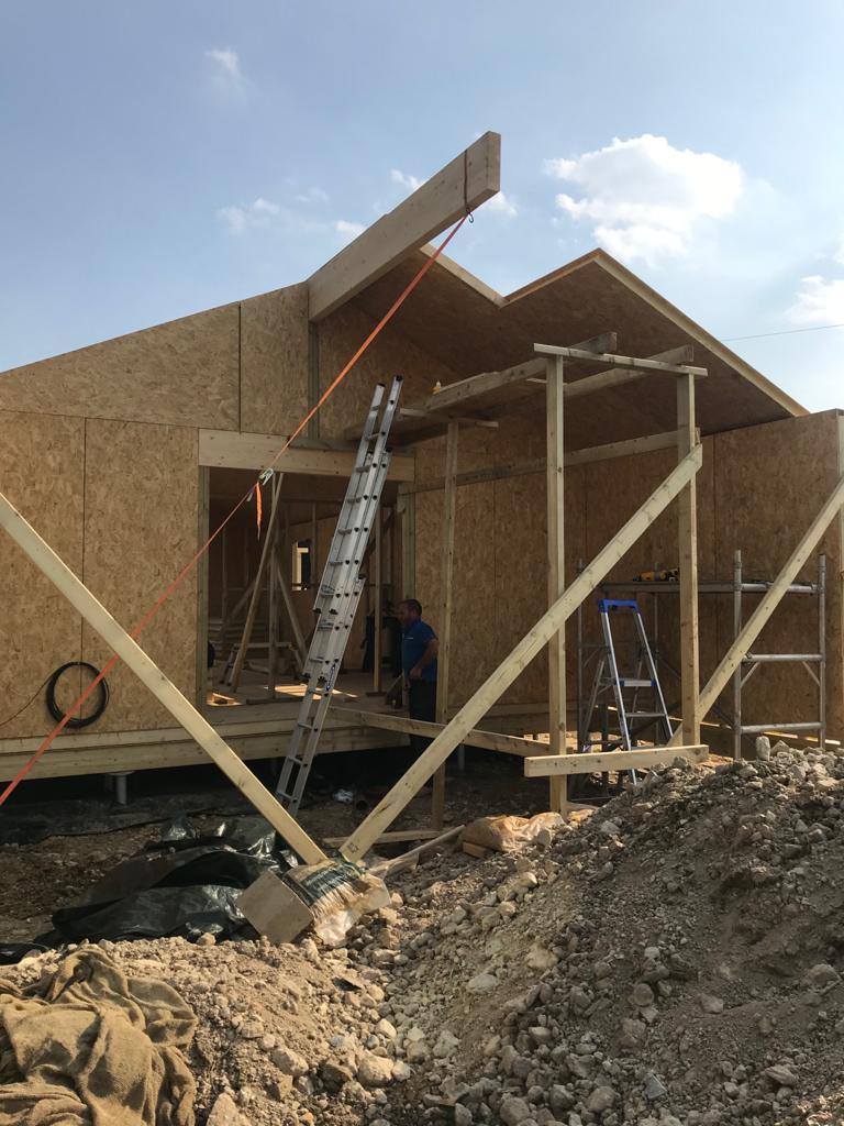

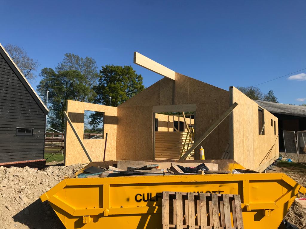

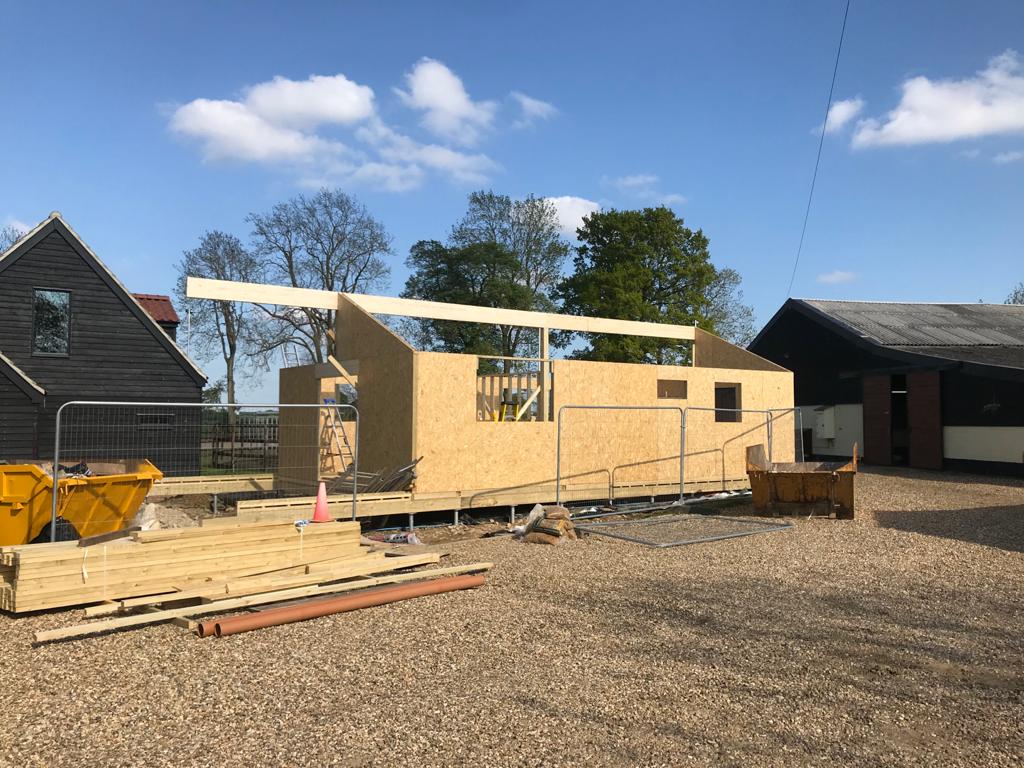

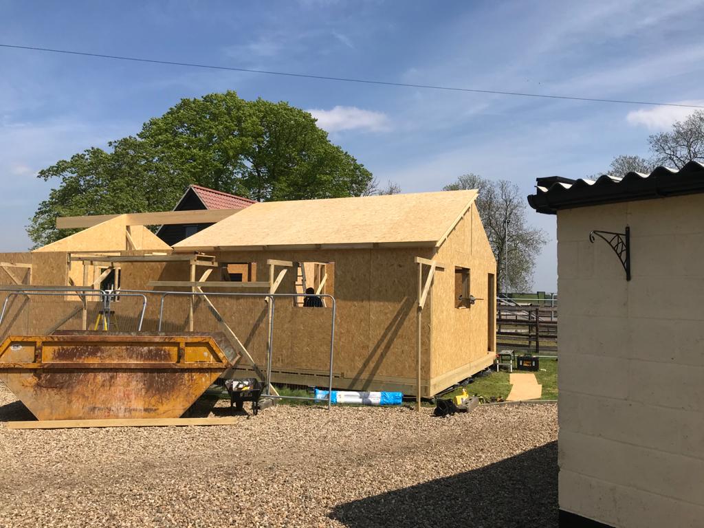

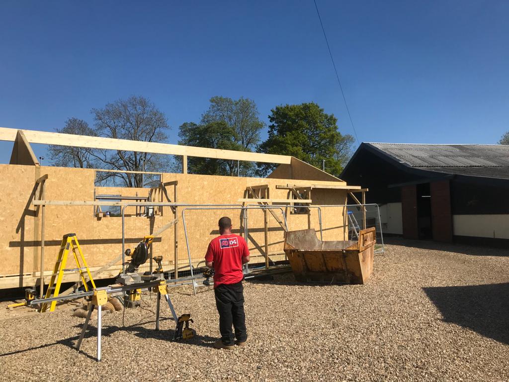

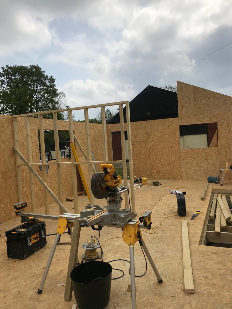

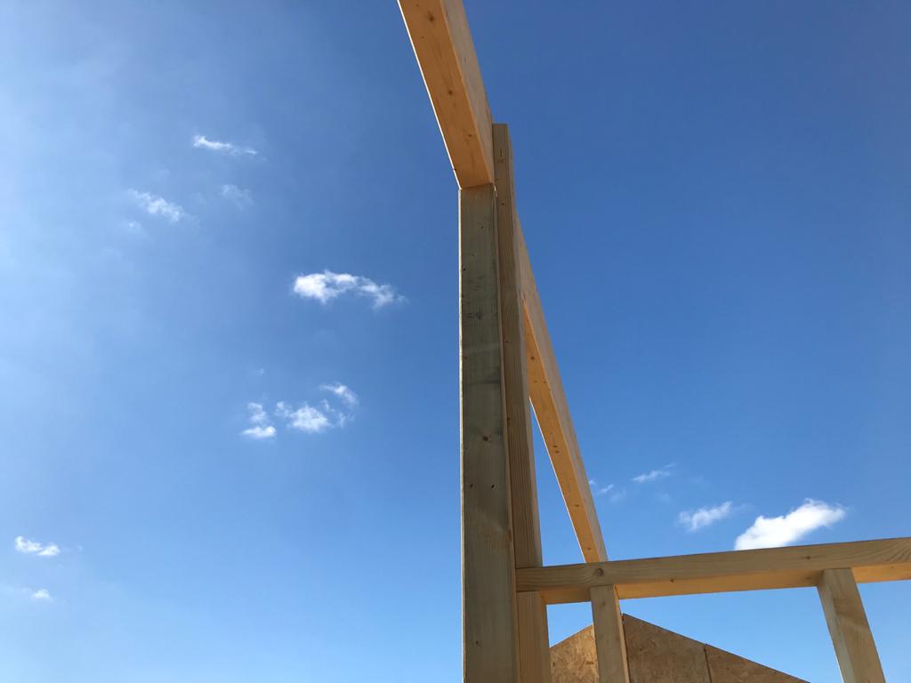

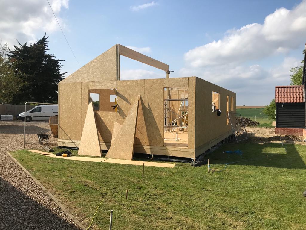

    anyhu, as you can see, we got the upper wall panels (gable ends) up, beams up and most of the roof.
    the beams were fun! one of em is just under 9 mtrs 400mm x 90mm and a lil bit heavy for 3 guys!
    i said earlier that the building was just over 10 mtrs long but that is just the living space, its actually 13.6 mtrs if you include the area that is to have decking. we should include that as the roof and walls extend that far!!!
    the roof panels were bloody hard work, initially made alot harder by the young chap who is supposed to be advising us on the build coming up with some crazy ideas that i had to veto.
    turns out that although he has built many of these, this is the first he has done whit a sip roof!!! we did better yesterday with 2 of us than we did thursday with 3!
    the company was supposed to supply scaffold but didnt so i had to make up platforms inside and out to get the job done. that wasted the best part of a day for me which i aint to happy about. we were lacking materials for this so on the interior i had to disassemble and move stuff in between throwing up the roof panels but it was that or grind to a halt.
    i didnt take any pics end of yesterday but the roof is nearly all up save the outdoor area which will require either a 3rd man or a way better platform set up.
    im not so keen on the sip roof, its really hard work and due to the nature of how the panels are made and go together its impossible to keep things running true so my soffit is 170mm at one end and 190 at the other.
    now i will have to ping a line and cut the panels back to make things right... no walk in the park!!!!
    roof tiles are to turn up monday but i doubt we will start on em till tuesday now....
