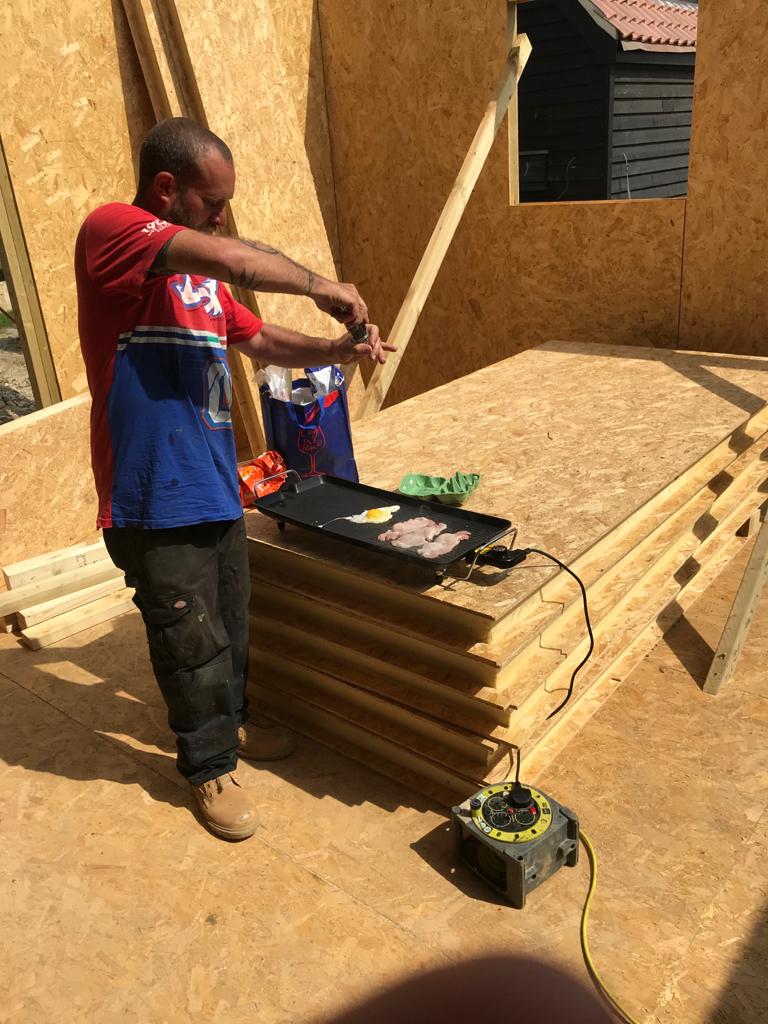

    30 quid electric hotplate. Loving lunch times at work.

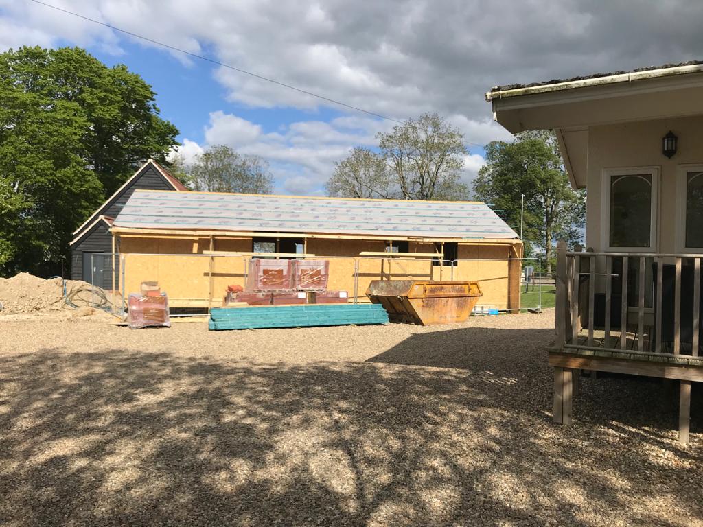

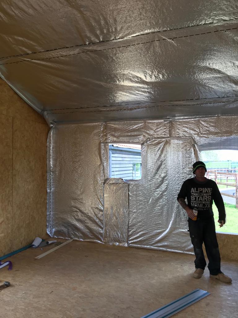

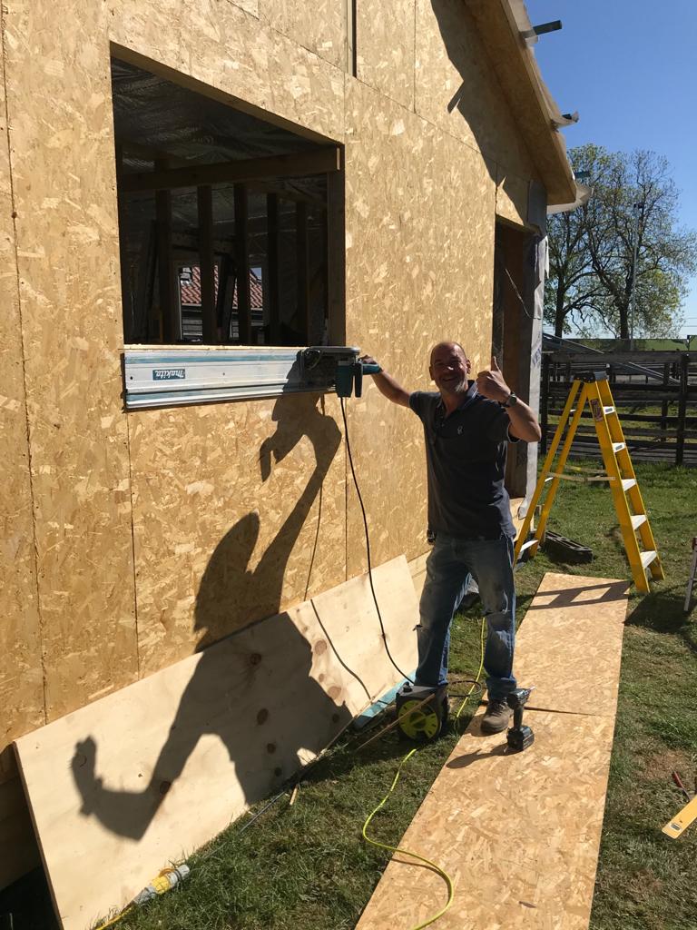

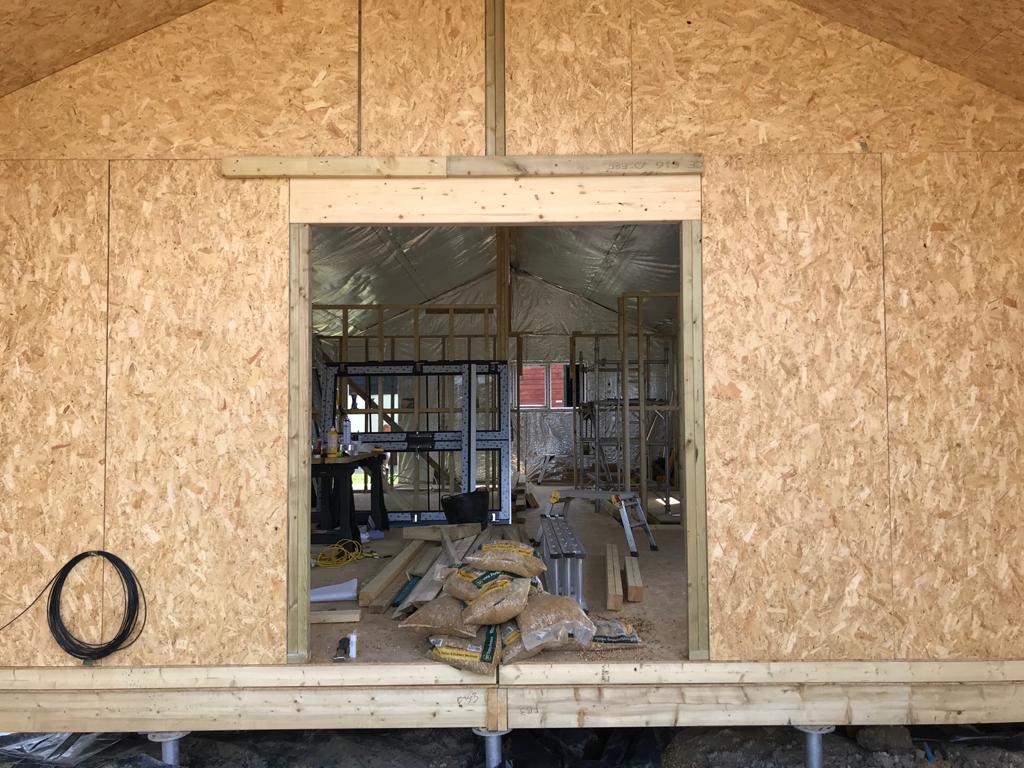

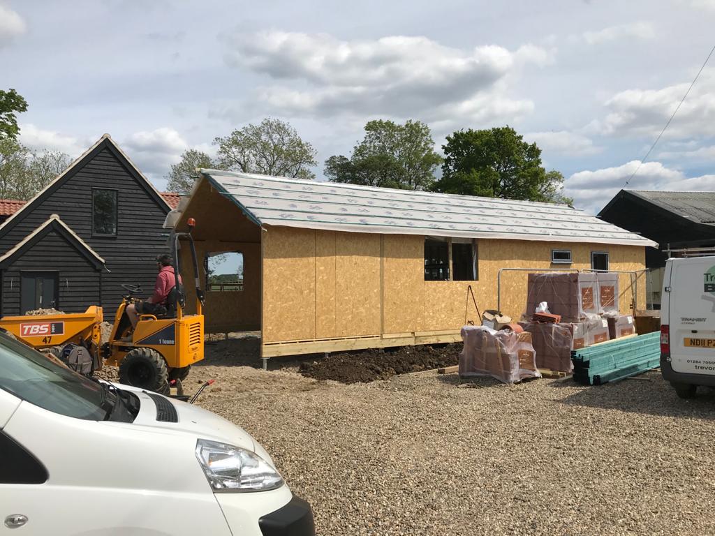

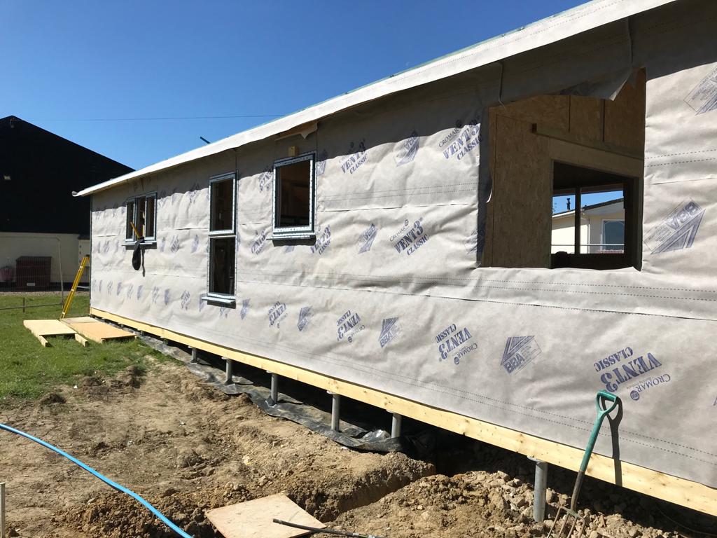

  10. IMG-20200515-WA0004.jpg IMG-20200515-WA0003.jpg IMG-20200515-WA0013.jpg IMG-20200515-WA0009.jpg IMG-20200515-WA0007.jpg IMG-20200515-WA0000.jpg
  11. Yep, agreed! It's coming on now!
  12. Looks the part now buddy !! And Looks like the weather played ball too !!
  13. Dunno how these relate on price point, but they look much less labour intensive. Its like lego for adults.
  14. looks cool. i used to have a contract painting similar back in NZ years ago except they were interlocking planks not short bricks.
    not sure what the insulation detail is on these but they do look alot easier to construct thats for sure!
  15. thats not me ya donut... thats colin re-cutting the window openings as the windows differed in size to the structural openings on the drawing.
  16. yep, we are ticking along ok ish!
    the roof sucked a lot more time than we thought it would as some of the panels aint perfect. the top layer of sterling board is slightly offset to the bottom on many so this has thrown the roof out of square a bit which will cause ups probs with the tiles but after a few hours of pulling string lines and head scratching we have it in the ball park now.
    bit pissed off at having to cut all the window openings 20mm bigger!
    but colin came up with a cunning plan, drill holes in the plunge saw track and screw it to the wall then saw it max depth from each side. time wasted but it worked well.
    the roof tiles got delivered but are the wrong color. other than that all is good and apparently they have our next job lined up for us already.
