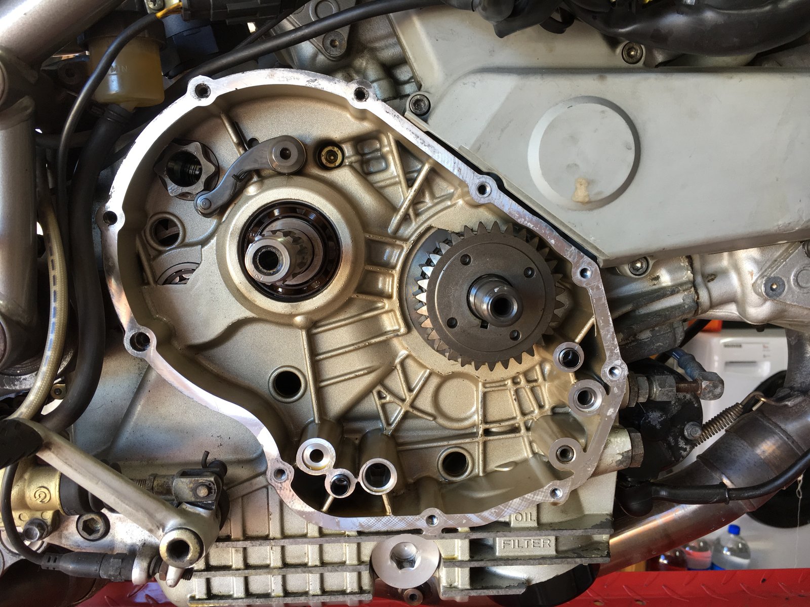

  7. All looks good on left side so far including the outer bearing and water pump...

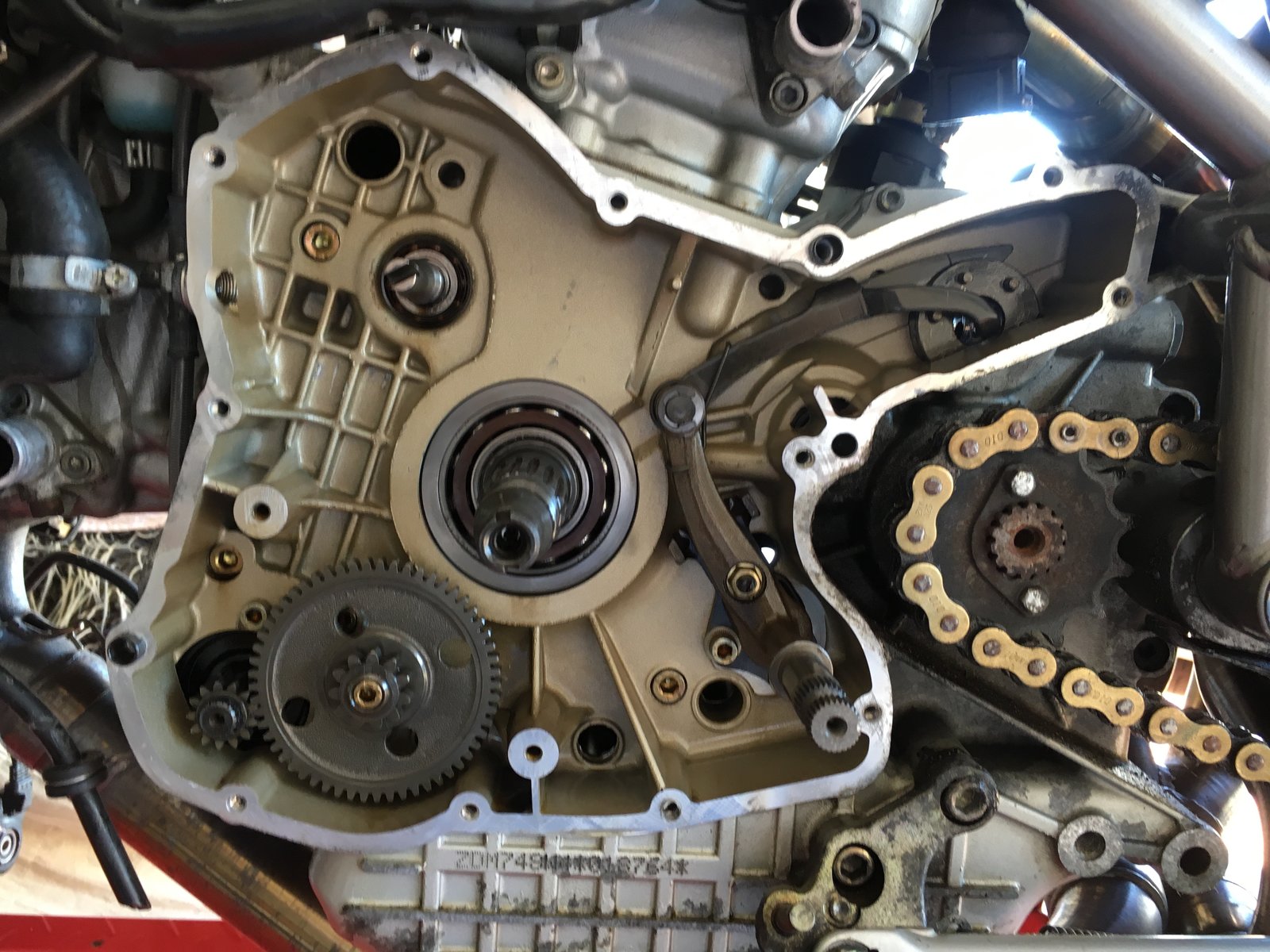

  9. So, both sides removed and nothing to see, no play or excessive end float on anything, sprag clutch is good as well, pretty sure the mains are ok, no debris, clean as a whistle, hmmmm what next I wonder........ image1.jpeg IMG_1519.JPG

  15. Yeh I did that in the beginning, most of the noise was at left side middle, but also trasmitted towards the horizontal cylinder head.
