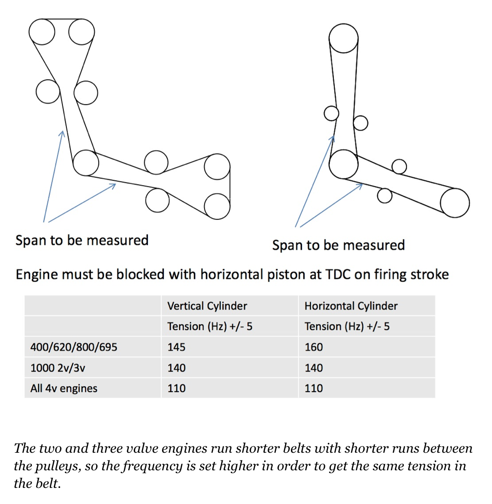

    Ducati Tension Levels from Gates
    The tension requirement with picture below was published by Gates in early 2011, about a year after the Bulletin from Ducati North America. It differs from the earlier DNA Bulletin that said that both Ducati 2-valve and 4-valve belts should be tensioned to 105-115 Hz.
    The reason to make this distinction is that the 2-valve motors belt tension is measured for a shorter span between pulleys, that according to physics 101, will vibrate at a higher 140 Hz frequency. This will give a tension in the belt that is the same as the 4v motors when set to 110 Hz.

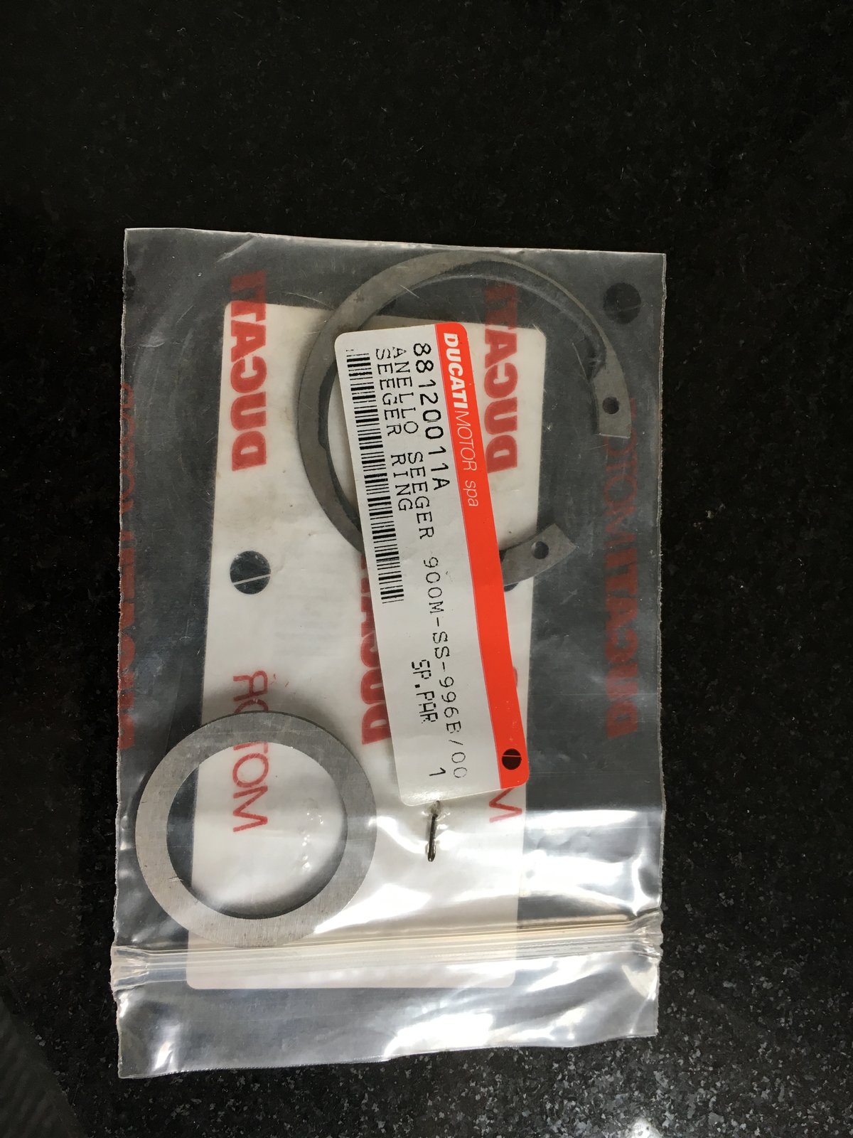

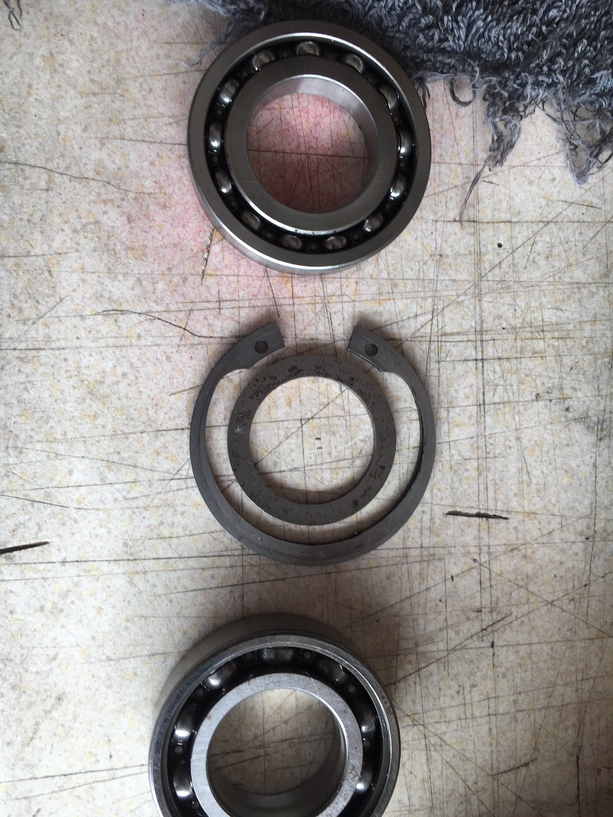

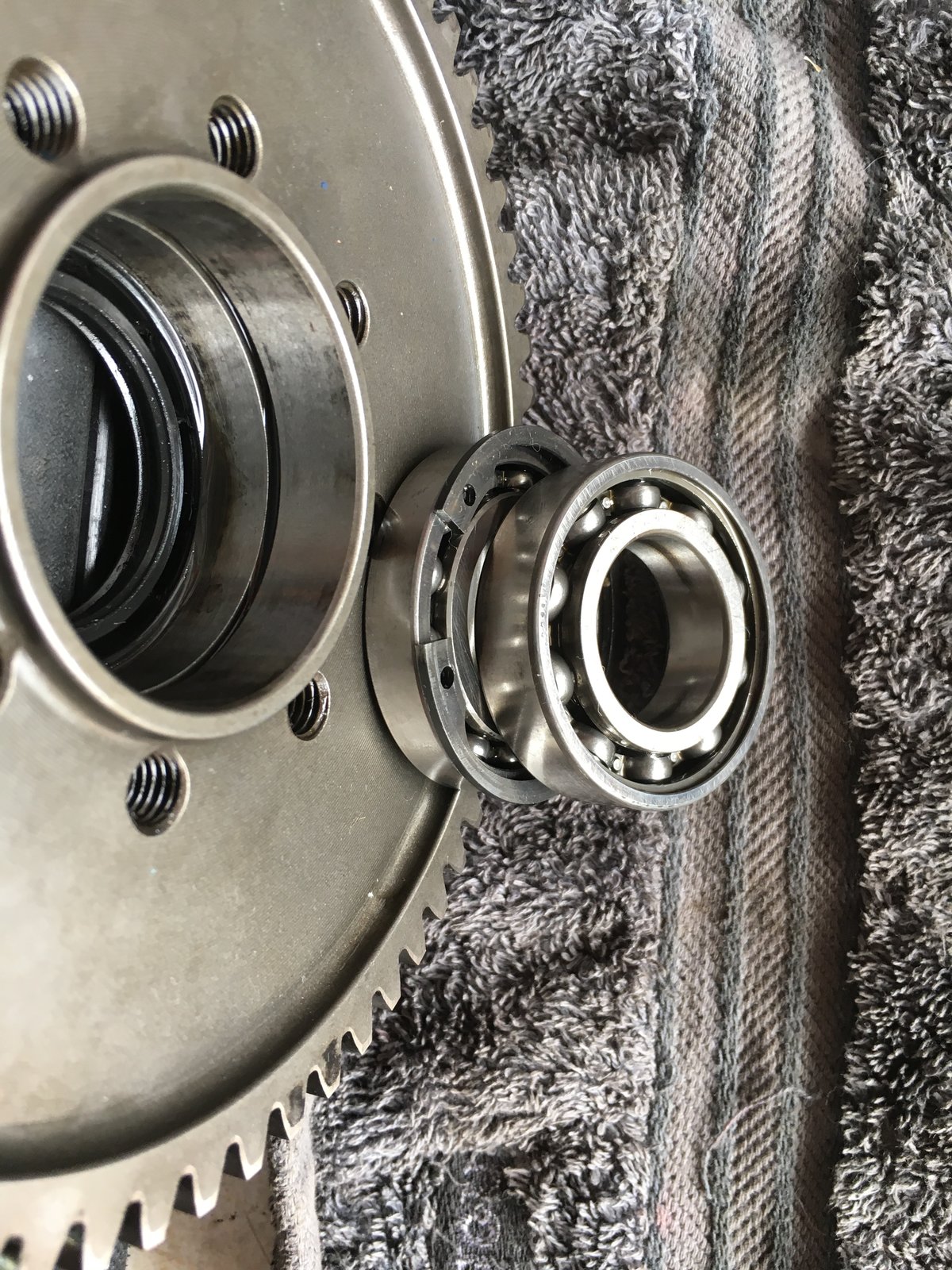

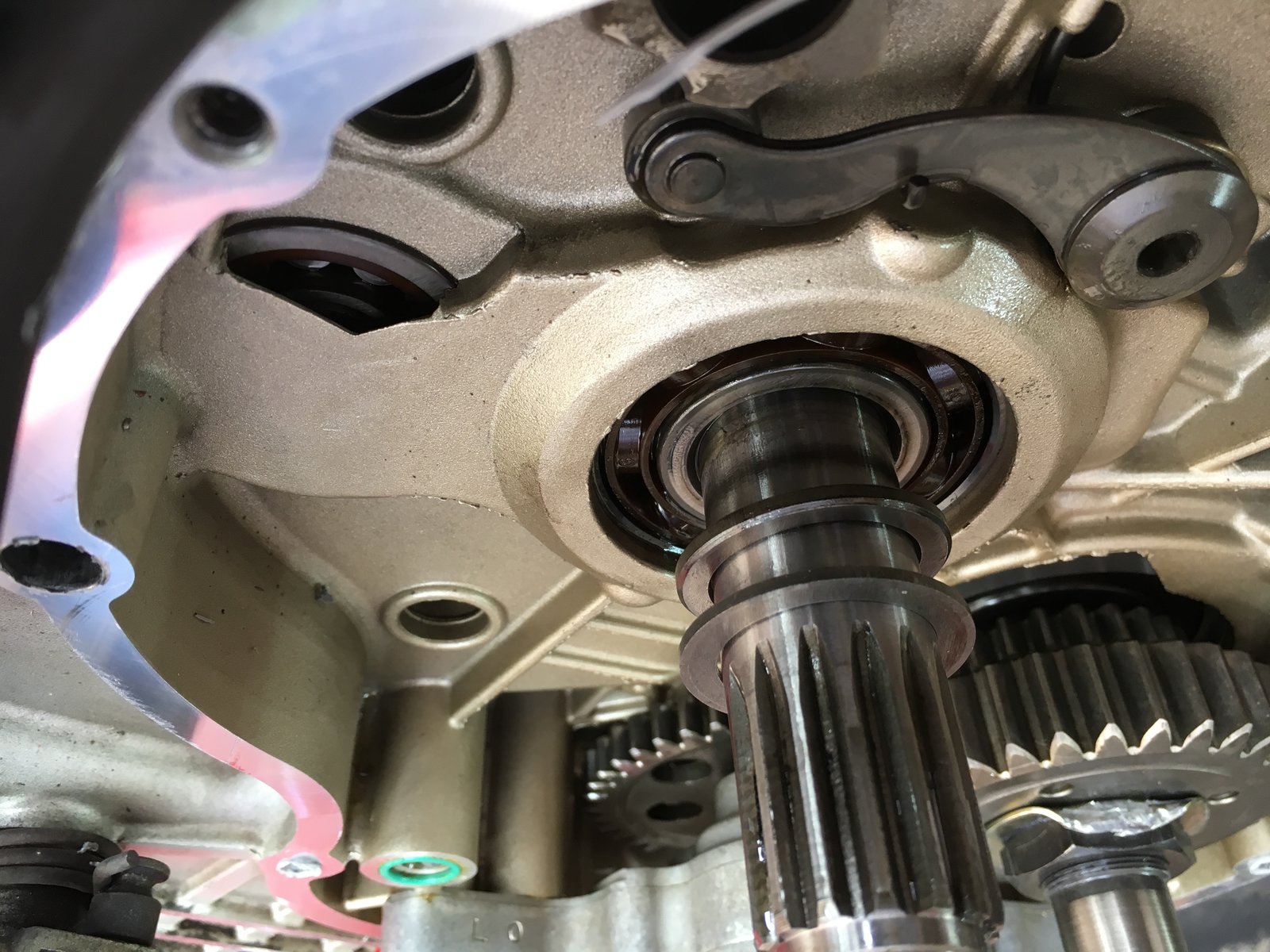

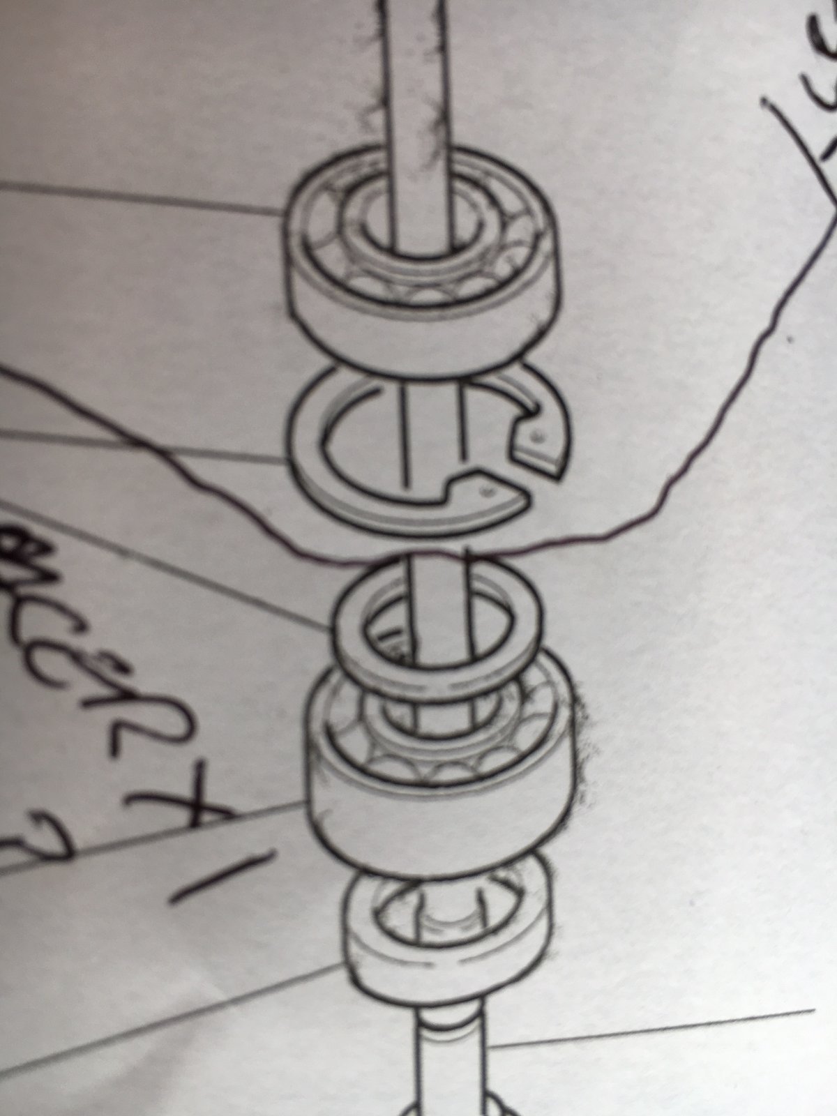

  11. Ok finally found something out about the noise hopefully.
    When I pulled off the clutch assy, behind the clutch driven gear there is a spacer between the gear and the bearing in the crankcase, only thing is I found 2 x spacers insated of the 1.
    So where did this come from, after studying the parts list the only other spacer similar in size is between the 2 bearings within the driven clutch gear, after pulling out the bearings It was not there!
    So a previous mechanic has installed the clutch assy incorrectly!
    The purpose of this middle spacer is to provide a thrust point on the inner races of the 2 bearings when torquing up the shaft nut, with this missing the smaller bearing was stressed with the inner race being pressed out of line towards the larger bearing.
    Now my problem is which spacer belongs where as they are 2 different thicknesses. I am pretty sure the thicker of the 2 goes on the shaft behind the cluth driven gear because it is an exact fit on that part of the shaft, the thinner one is a rattling fit in this position.
    Any help much appreciated with this positioning question.
    Pic 1. 2 spacers found here, thicker 1 to the inside and close fit
    Pic2. Bearings and snapring removed from the driven clutch gear, no spacer
    Pic3. Bearings, snapring and the extra spacer from the shaft Pic1
    Pic4. Original parts list extract
  12. No, not as I could see without splitting the crankcase :)
  13. After more checking, realized that the thin ring, is the same thickness as the snap ring, makes sense now as both the outer races against the snap ring, and inner races against the spacer gives even loading all over when torqued up :)

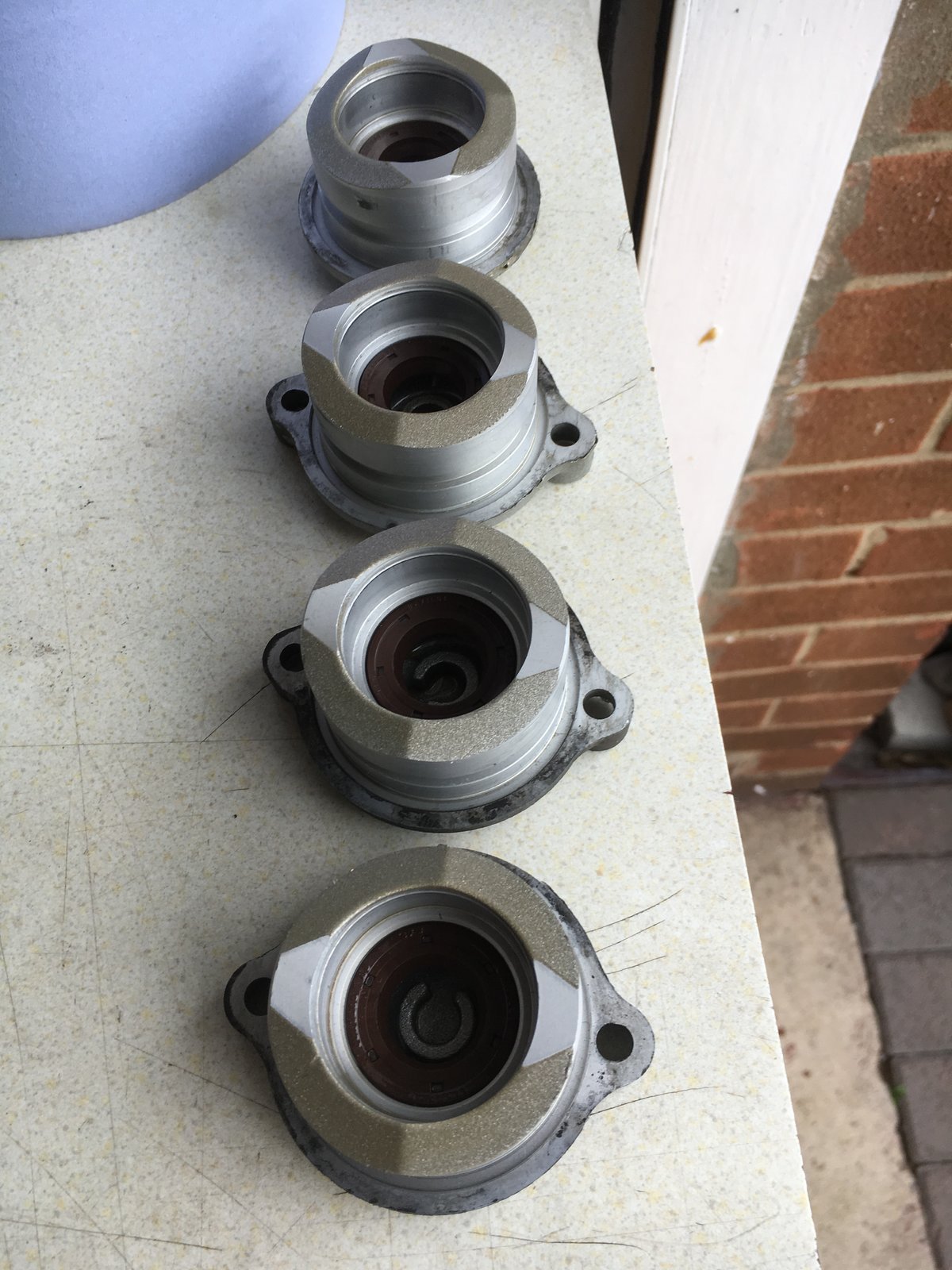

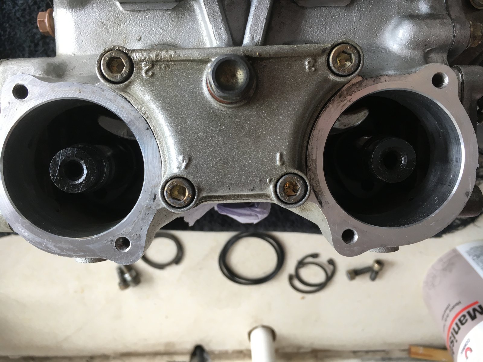

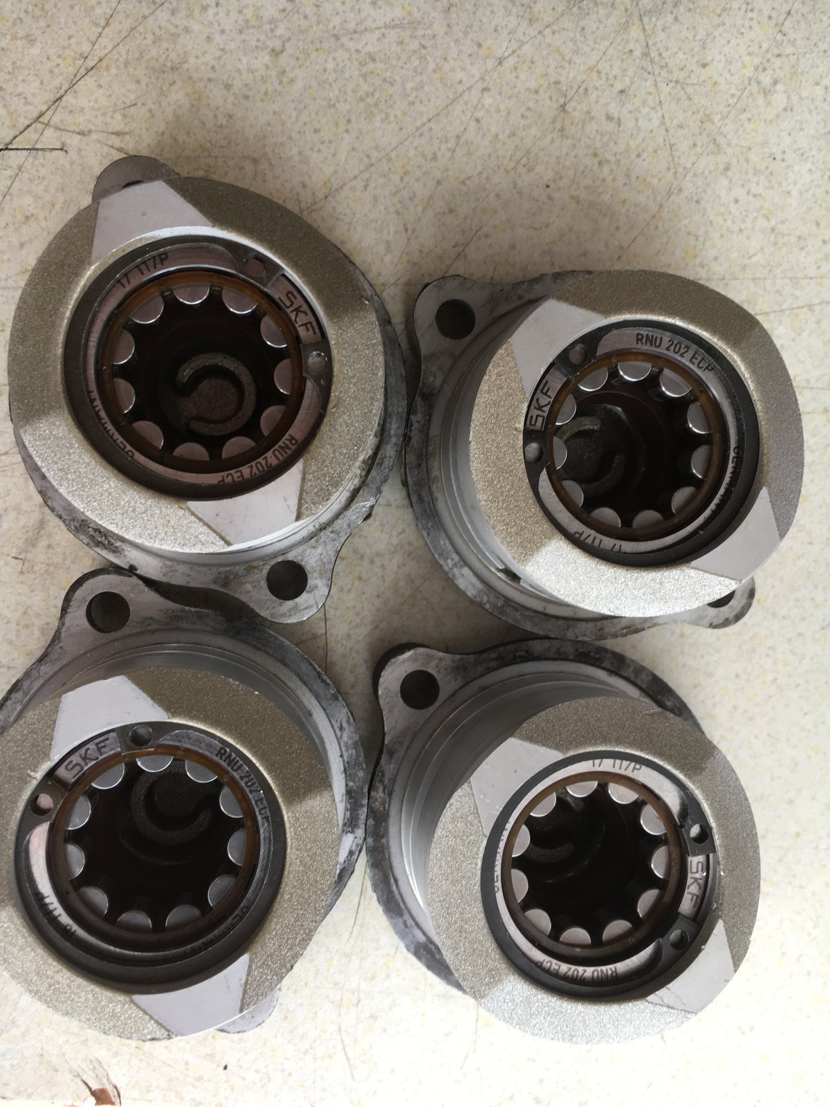

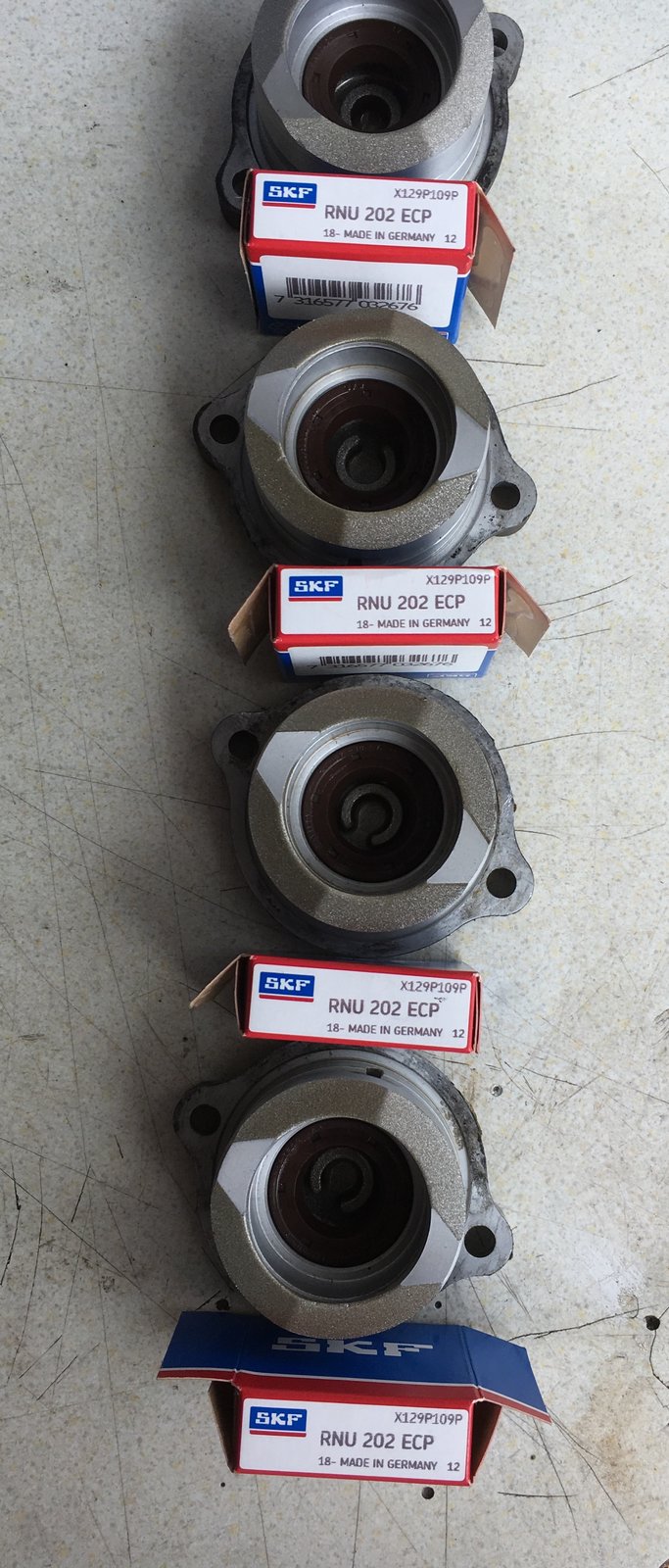

  16. While I was doing all of the above, I decided to renew the 8 camshaft bearings, seeing as I had already removed so much stuff from the engine, still waiting for the off belt side ones to come, but I changed the belt side ones.
    To-day, I was cleaning a few things up while waiting for the rest of the bearings to arrive.
    When spinning the old bearings a few times, 3 of them seemed ok, but 1 of them was suspect. I flushed the oil out of all 4 bearings with electroclean and gave them a few spins, low and behold, 1 of them is really bad, I mean rough as hell, 1 is much better almost good, and 2 are good, lesson learned, hard to tell if bad when bearing is lubricated. I also did this with the 2 clutch bearings I mentioned above, same result of course
