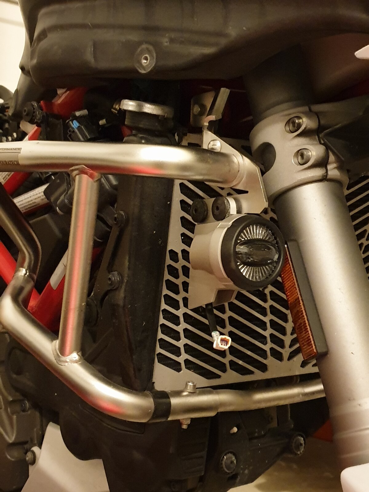

  1. I had Ducati spot lights fitted directly to my 1260S without crash bars.
    The brackets use the same bolt as the top stay for the radiator.
    I have since fitted some Heed Crash bars and have had to make my own mounting brackets for the spot lights as the original brackets fouled the crash bars.

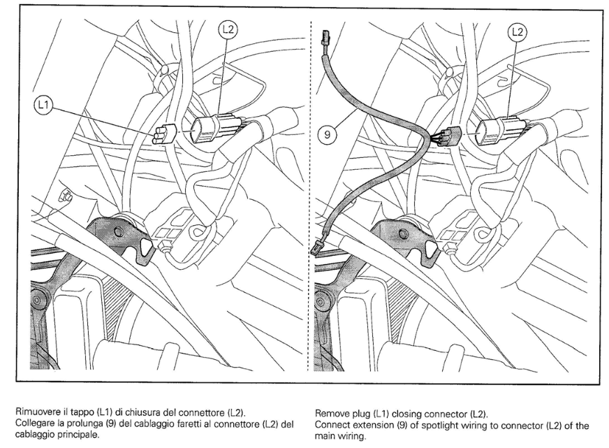

  3. The fitting instructions say that the tank should be removed however you can install the lights without removing the tank. It may be that the Aux light connector is tucked up under the front of the tank. The figures below are from the fitting instructions which may help with finding the socket.

  14. Could you be kind enough to show me how you got your lights to mount...I am facing the wane problem.
  15. I assume you're the one that's posted this problem on Facebook? Couldn't you just cut half an inch off the end of the crash bars?
  16. Yes I am. Sorry can't cut the crashbars its has no ends to cut...its all connected to either sides. Valid ides but doesnt work with the design of this crash bars.

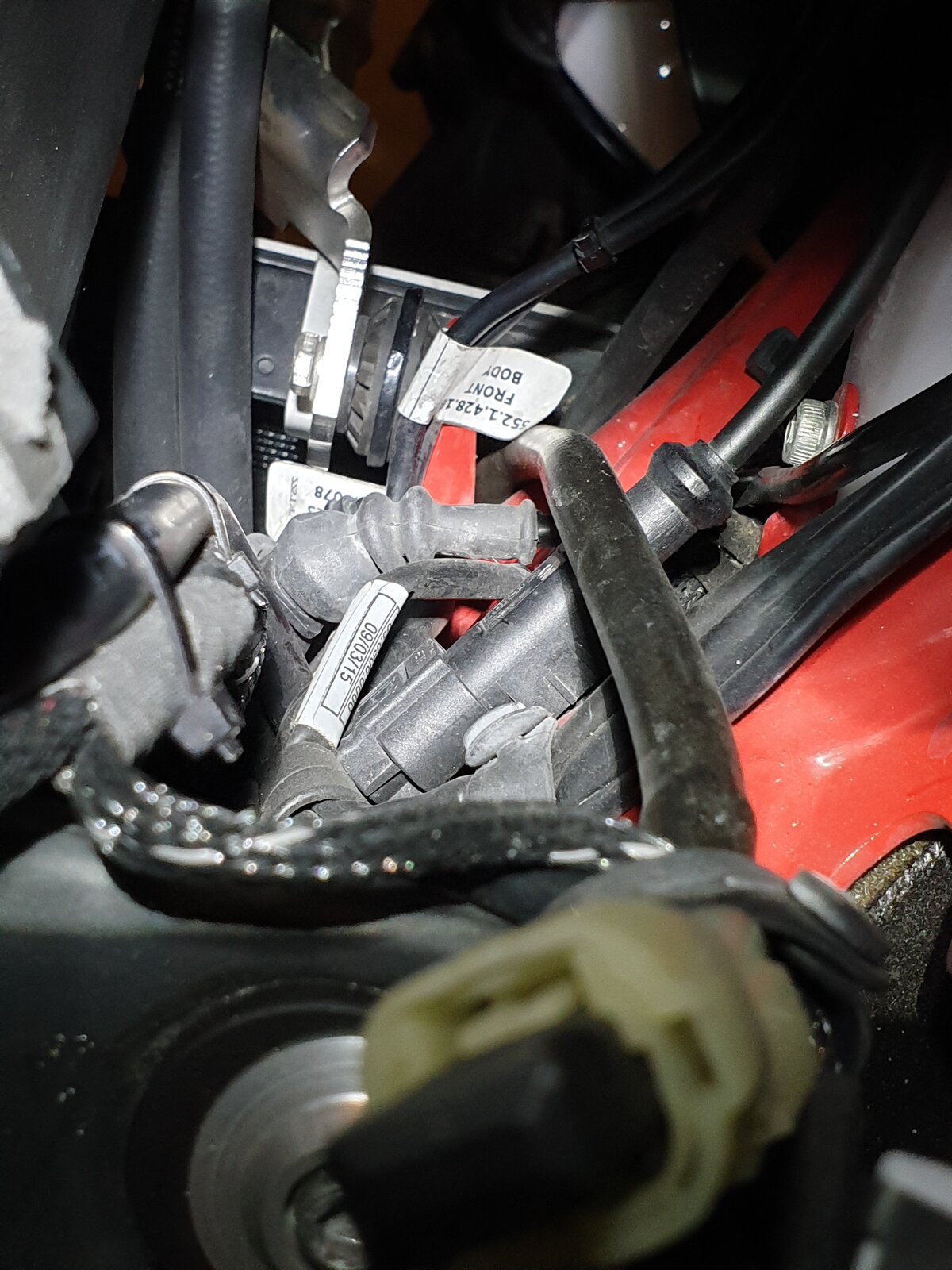

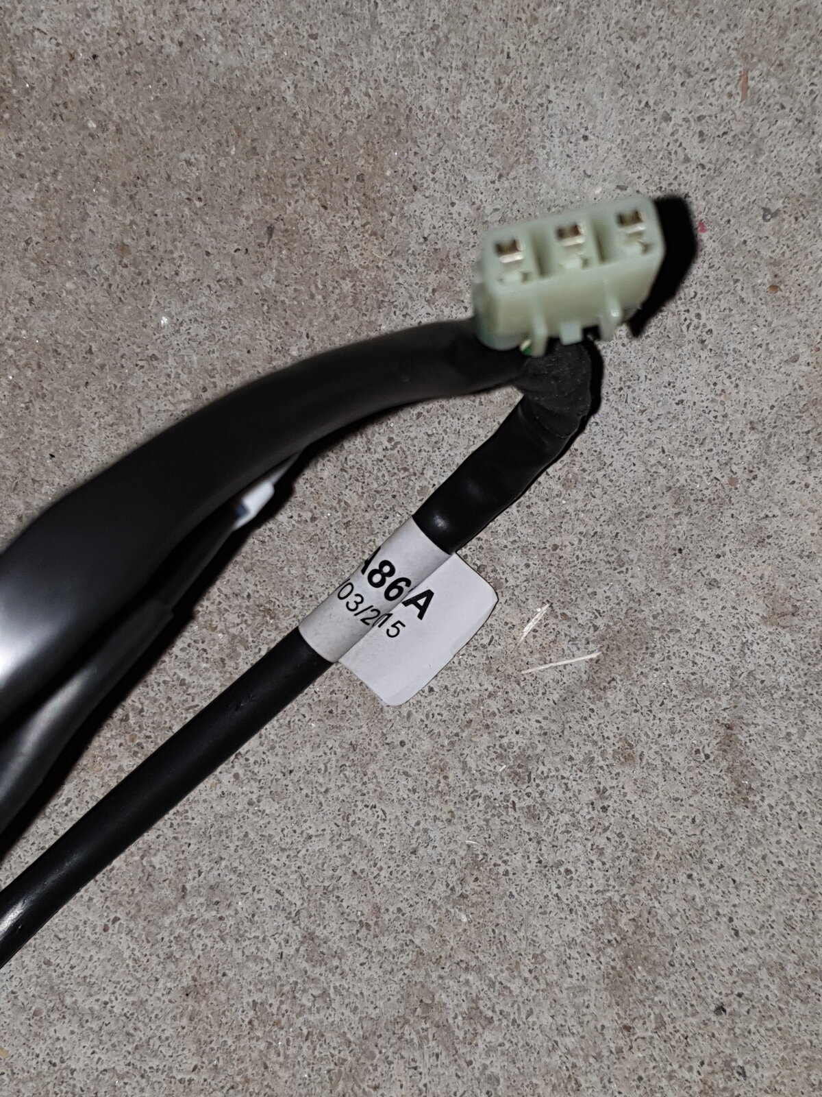

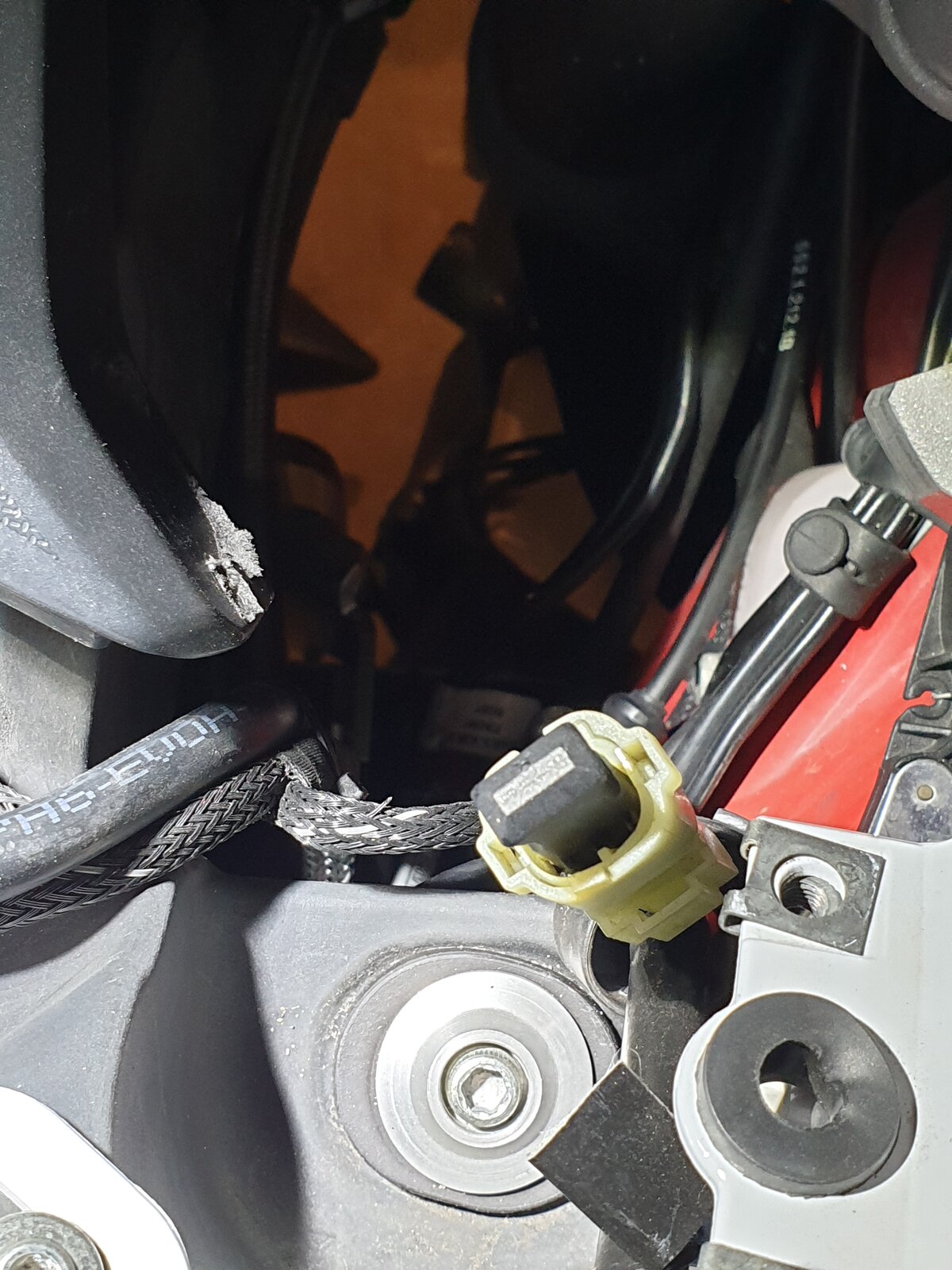

  17. its been about 10 months since your question here, so I hope you found the connection meanwhile...
    But I had the same issue, couldnt find mine.
    It was located on the left side yes, but somewhere in between the framework, I assume from the same main wiring as where the connection for the wireless fuel cap sits.
    I accidentally bumped into it when looking at the bike from the front.
    The second picture is actually taken from through my windshield lol!
    So now you have an idea, its in the framework, bellow the beginning/front of the tank area, so you cant see it when standing next to the bike, only when standing in front of it and you have to duck and shine with a light on it or its impossible to see.
    It sits in place with a rubber band, thats very tightly secured around it so its very hard to pull it forward.
    You will have to work it by touch as you cannot see it.
    Once the rubber band is removed, you can pull it forward and you have work to connect it to the cable....
