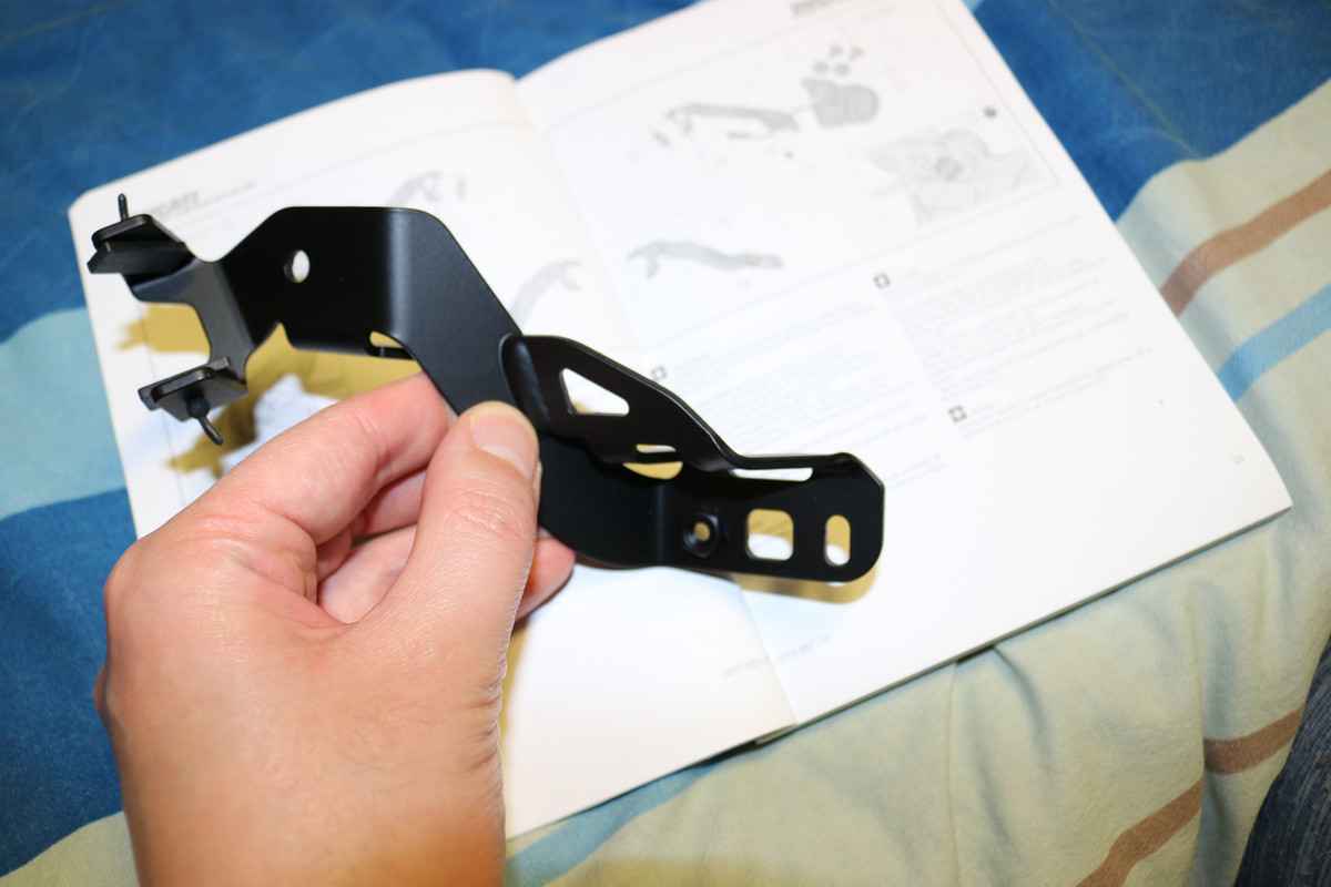

    Meanwhile I know wich ones are for the Enduro.
    This is the manual with the description:
    This is for the normal version
    This one is for an enduro:
    So you will need this pair

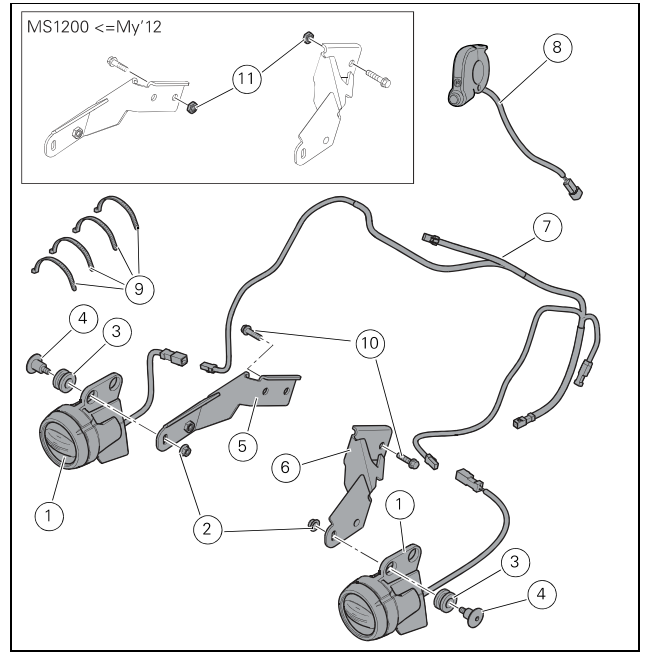

  9. The 12V feed for the Sat Nav (GPS) is a switched live, so could be used to trigger a relay for auxiliary lamps. It could be used directly for low power LED lamps as this was how the Ducati LED auxiliary lamps were connected on the pre-DVT (2010-2014) models; the loom supplied with the lamps plugged into the Sat Nav socket and as well as connecting the to the lamps the loom had another socket so you could still connect a Sat Nav - item 7 below. The loom also had a dedicated handlebar switch to switch the lamps on/off - item 8 below.
    The part number for the this loom is:
    The part number for the swich is:
    Let us know how you get on.

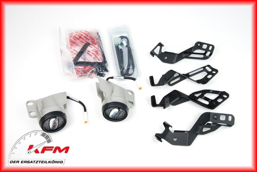

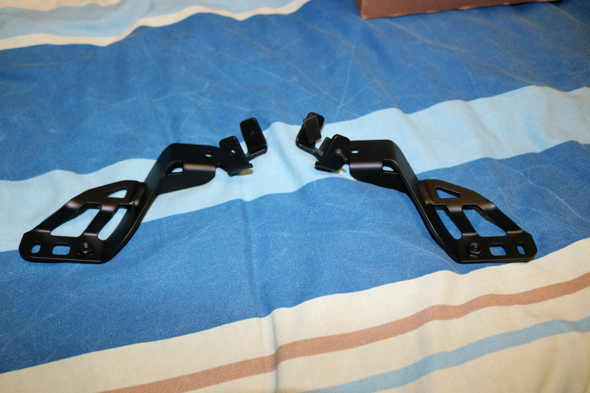

  11. No. There are brackets that fit on the radiator mounts
  12. The OP from 2015 appreciates this timely response... :)

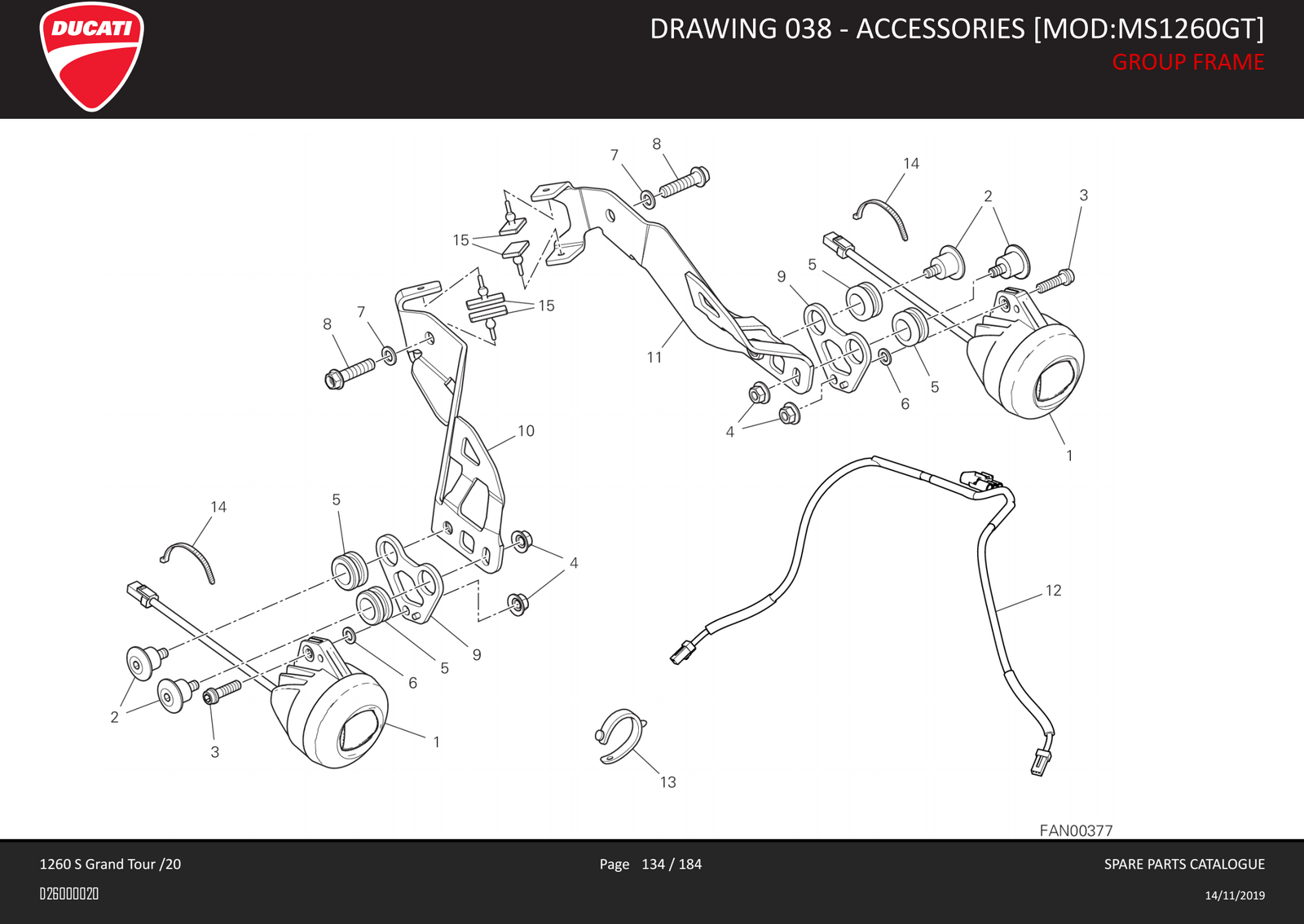

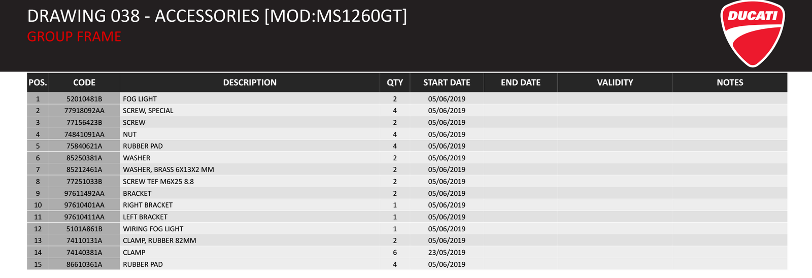

  15. You might be able to buy the brackets and fixings from a Ducati dealer as the same aux lamps and brackets were fitted as standard to the 1260 GT
    You can get indicative prices or order online from https://www.bike-parts-ducati.com/
    See the online parts list for Aux Lamp Accessories page for the 1260 GY MY2020:
    The price might be a bit of shock as the right and left brackets are £33.61 each
    Hope this helps.

  18. Hopefully the brackets for later 1260 version of the spotlights are the same as those for the older 1200DVT aux lights (the former being black in colour, whilst the latter were silver). The light unit mounting points are different, though in the case of the black finish 1260GT ones there appears to be a two point to one point, and a 'peg', adapter plate (2x part #9) for each light. Whereas the earlier silver finish units have the two point mount built into the light body itself which mounts directly to the bracket without the plate.
    Hopefully they use the same base mounting bracket if you're looking to mount the old silver finish lights.
