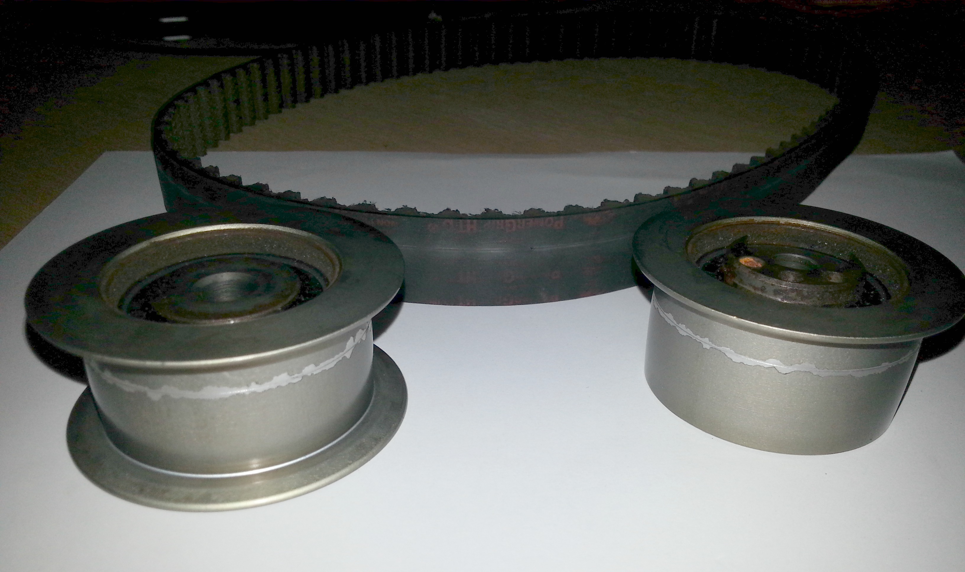

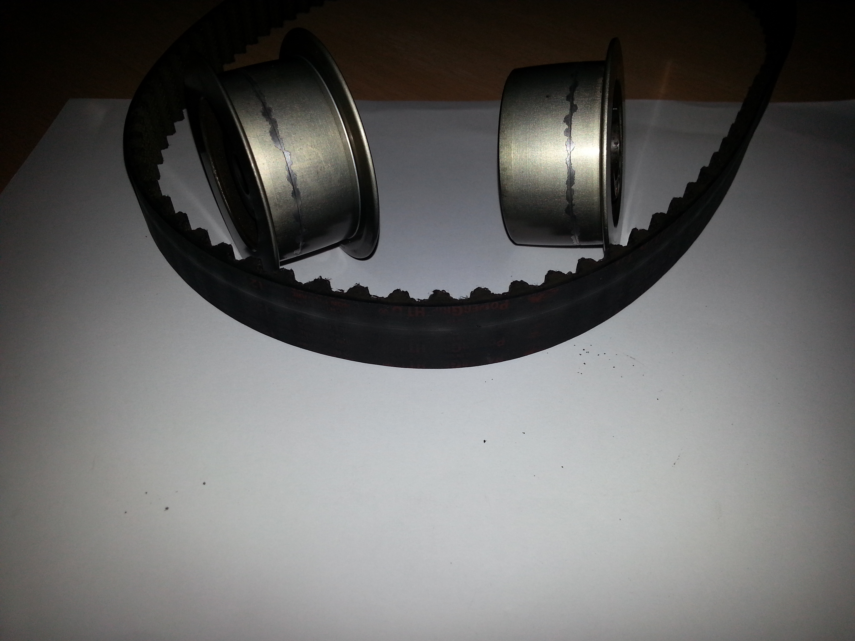

  6. OK. I now have my bike back and have seen the damage.
    Only the rear of the belt touches these pullies.
    One of the belts has a very sharp piece of the pulley embedded into it.
    Examination under magnification clearly shows its the same material as the pulley coating/anodise.
    Either something has chiped the pulley causing a metal flake to embed into the belt or it's just failed.
    I actually believe something chipped the pulley.
    This metal flake has cut the surface of the pullies in a parallel line, in turn thus has scored the belt.
    I don't think it would have caused a failure soon, but you would want it changed.
    My verdict: accidental damage to pulley, by object unknown.
    May be something forced into the casing while passing through a flood or similar.

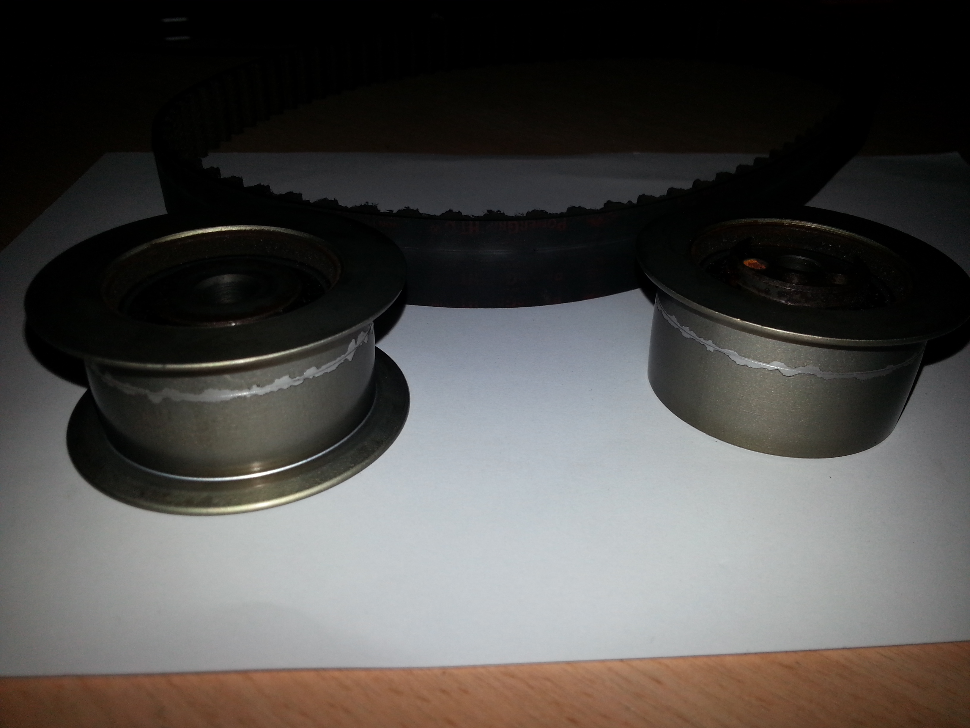

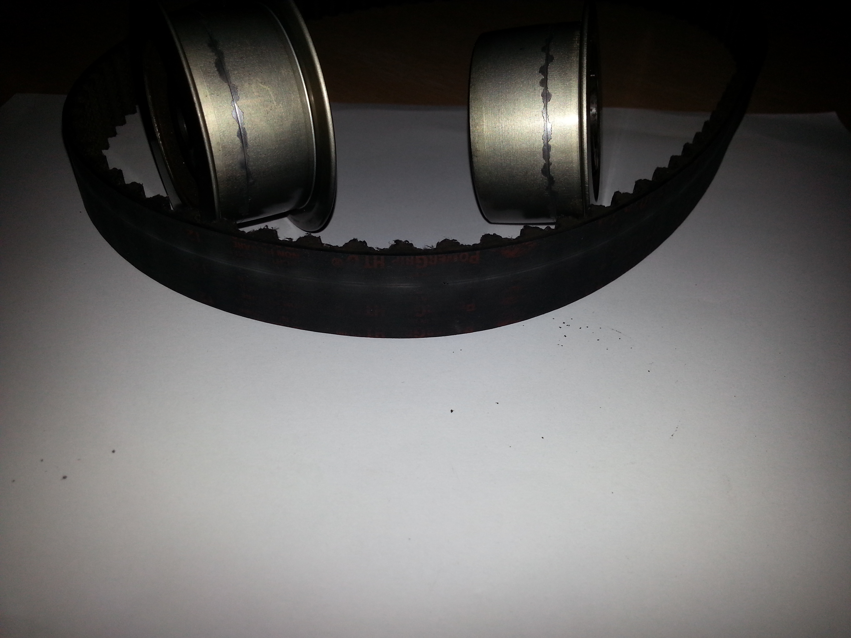

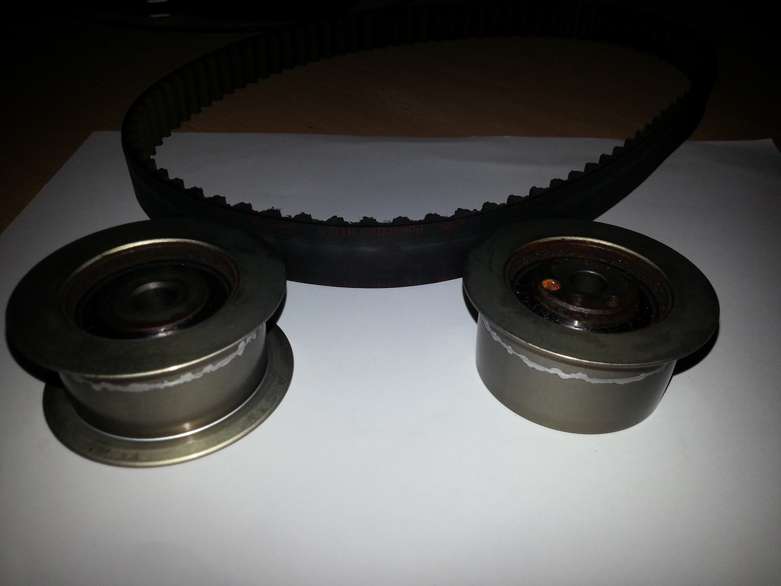

  16. I really need to play around with lenses on my digital SLR and lighting.
    Sorry for the quick pics.
  17. Actually Andy your pullies are really pitted. My are dead smooth apart from the scratch/track. Yours look very rough. Also note you've got completely different numbers to mine.
  18. No missing that sort of defect/damage......no sign of anything embedded in the belt?
    Not so smooth faces of my tension rollers.....hmmmm, not sure that would be any issue as the rollers rotate i.e. the belt is not 'dragged' across the surface - input from an 'expert' would be good here. Why are they different to yours and the different ID numbers....?? Have you looked at the new rollers fitted to your bike now.
    I'll get my magnifying glass out (lol) later and make a note of the numbering.
    Photos - Picmonkey.com ;-)
    ......improved one for you :D
  19. Next time I get it apart I'll make note.
    I think a rough surface may heat the belt a little.
    As you say input from an expert.
    In your improved photo you can just make our the little hole that held the pulley particle.
  20. Just flash photography effect........pulley/roller surfaces actually smooth as can be to the touch.
