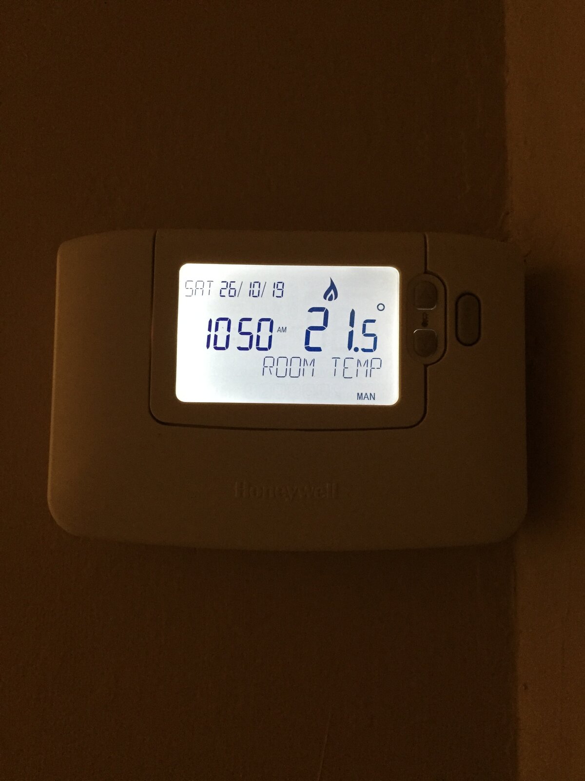

  16. I have recalibrated the existing unit by pulling the dial off and replacing it so the dial reflects a similar temperature to that displayed by thermometers places right next it.
    The hysteresis of this relatively new unit is actually much less extreme than that of the old Satchwell unit that it replaced back in the Spring, when the plumber upgraded our old tank.
    So, fingers crossed, SWMBO seems to be placated - for now...
  17. Best to re-calibrate it a couple of degrees high - worked in my daughter's bedroom a few years ago, stopped being a sauna even when set to 25 degrees :D

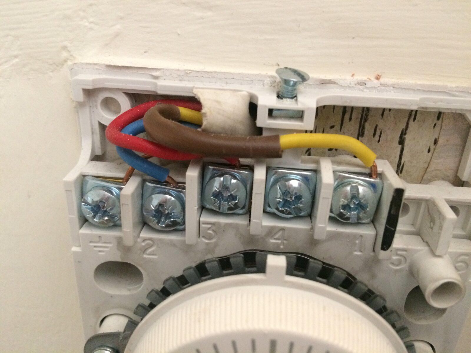

    The old Honeywell thermostat had a 3 wire connection.
    1. A live supply
    2. A Neutral
    3. A switched live to trigger the boiler to fire.
    The unit will still work with the neutral not connected/disconnected, but will give the symptoms you describe.
    I have often seen the thermostat connected up with #1. &#3. only- this makes it slow to react to temp changes!
    Typical thermostat connections
    [​IMG]In all cases, the thermostats is a simple switch, connecting a switched output to live when heat is required.
    Where the thermostat contains an accelerator heater or electronics, a neutral connection is also required.
    Three types are shown here. The first is a simple 2 wire thermostat. When heat is required, the two terminals are connected together. This could either be a mechanical device, or a battery powered electronic one.
    The second is a mains powered mechanical thermostat with accelerator heater. The heater is switched with the thermostat and improves the thermostat response time. It is important to ensure the L and SL terminals are connected correctly - if reversed, the heater will be powered continuously.
    The third is an electronic mains powered thermostat. The electronics require continuous power, and connect the L and SL terminals together when heat is required. On some types it is necessary to install a link between the two L terminals.

  19. Interesting.
    I’ll take a pic of the terminals and post them tomorrow.
