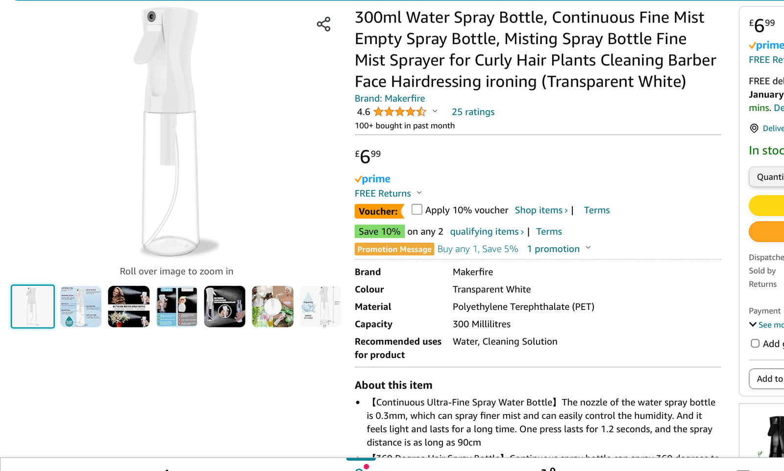

  1. Finally found a spray bottle that will mist ACF50 as long as the loaded spray bottle is heated in hot water.
    When you need to use the spray bottle again you'll need to warm the spray end in the hot water as well.
    https://amzn.eu/d/5Ar8xc5

  2. Nice, I just ordered a 2-pack! I almost considered buying an airbrush kit. There are so many places you need that fine myst and in just small specific areas at a time. Sure the aerosol can or a large sprayer is great, but sometimes you just need to be a little more surgical and less spray and pray lol.

  4. I use a hobby air brush kit. Works perfectly and doesn’t take too long.
    I did try the mist bottle but didn’t get on with it too well unfortunately.

  5. Have used a plastic hand held misting spray and place it in warm water for years... always done the job.
  6. I've used the same bottle myself and it was useless. Maybe the one I got was faulty, I'll be interested to know how long yours lasts.
  7. I bought 5 bottles for about £5.00 off Amazon years ago... still have a couple :)
