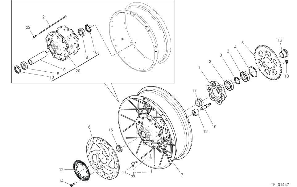

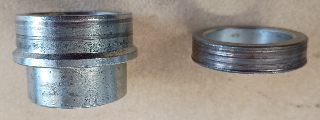

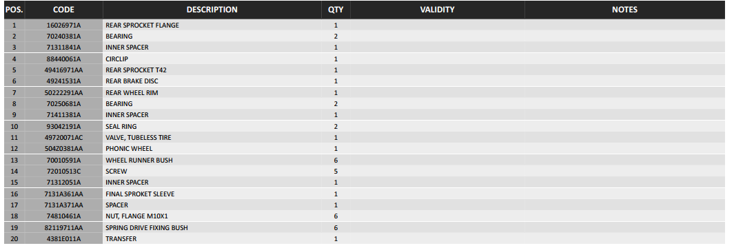

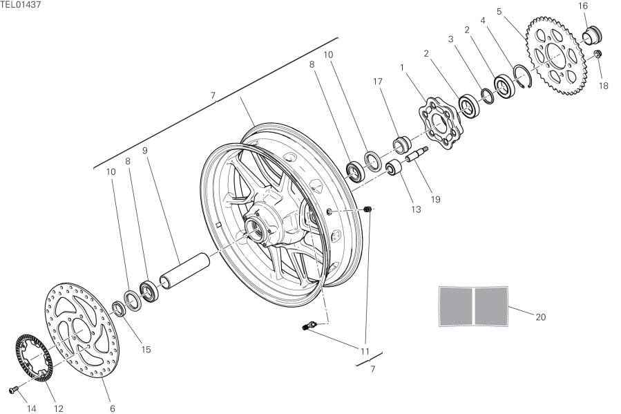

  6. When on the European Multistrada Meeting in Spain, I experienced a transmission speed whine from the rear end which I put down to a worn chain. Once home, I checked the chain which seemed OK but decided a new chain and sprocket set was a good idea anyway as the bike had done nearly 14,000 miles . Once the replacement chain and sprocket set had arrived, I removed the rear wheel and then the cush drive (sprocket flange, item 1 in the diagram below] ready to change the rear sprocket. I noticed that the spacer into the wheel bearing seal on the disk drive [15] was discoloured and grooved, the spacer on the other side [17] was in better condition but there were slight marks from the seal rubbing. Both wheel bearings [8] were stiff to turn and were notchy but with no discernible play. Both bearings [2] in the cush drive were good.

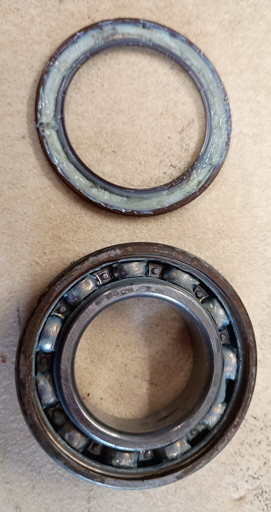

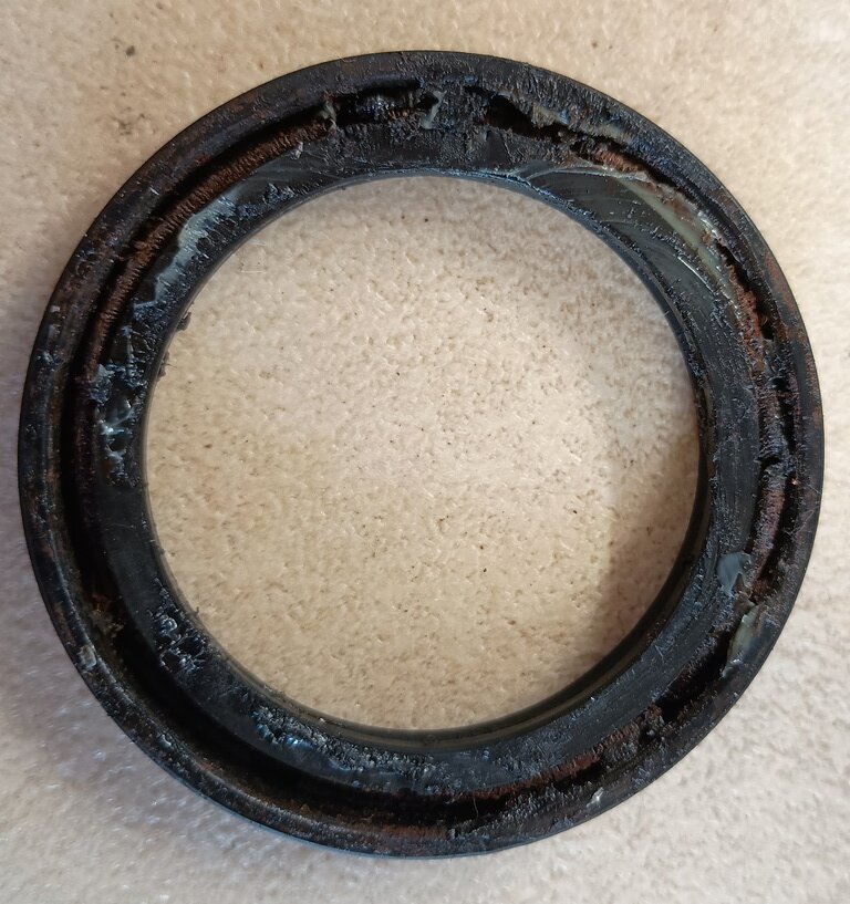

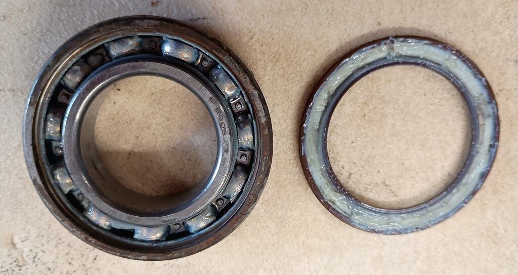

    As the bearings and seals weren't too expensive, about £43, I decided to order up a set and fit them myself - bit mistake as removing the bearings proved to be very difficult. The seal ring on the sprocket side had corrosion on the inside. The cush drive side seal ring was fine. Both bearings were corroded but there was some grease present under their internal seals. When removing the bearings I damaged the inner spacer [9] which is inside the wheel between the bearings.
    I wasn't in hurry for the replacement bearings and seals as I was going on holiday, so ordered them from www.bike-parts-ducati.com. When I got back from holiday in early August I started chasing delivery. I was expecting a bit of delay, after 5 weeks I phoned Ducati Aylesbury where I had an annual service booked for the end of August, they had bearings [8] and seal rings [10] in stock but would have to order the inner spacer tube [9]. They received it the next day! I obviously cancelled the order with www.bike-parts-ducati.com (actually In Moto Limited, in Croydon).

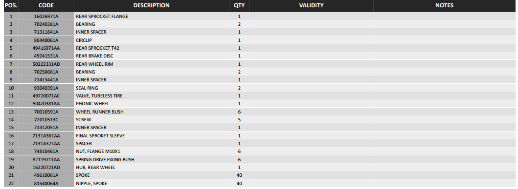

    I asked Ducati Aylesbury for the cost of replacement spacers. The spacer on the disk side [15] had a new part number [7131F751A] and would cost £25.58, which was a shock given the original part was £5.45. This new spacer part number was introduced on the on the V4S 2025 model but was shown as the replacement for my 2022 bike on their system. The spacer that goes into to seal on the cush drive side [17] also has a new part number [7131F741A] for 2025 and the price has jumped from £9.67 to £47.28. The service guys at Ducati Aylesbury checked with one of their technicians and he said he would just clean up the spacers and not replace them but ensure to use grease on reassembly.
    The part numbers for the bearings [8] and seals [10] are the same parts numbers from the introduction of the Multistrada V4S in 2021 to the latest 2025 version. These bearings and seals are used on numerous Ducati models with double sided singing arms, as are the original spacers [15 & 17]. As far as I can tell, only the 2025 versions of the Multistrada V4, V4S and V4 Rally use the new, more expensive spacers however I was unable to check the parts catalogues on the Ducati website as they have not been released for the 2025 Multistrada models.

    Exploded parts diagram of the rear wheel assembly:
    The spoked wheels use a similar bearings and spacer arrangement:
    One of the bearings, this one is from the sprocket side. The disk side was a bit worse.
    Seal ring (disk side). The sprocket side was not corroded.
    Spacers which fit inside the seal rings (smaller one is on the disk side, the larger one is between the wheel and the cush drive.
