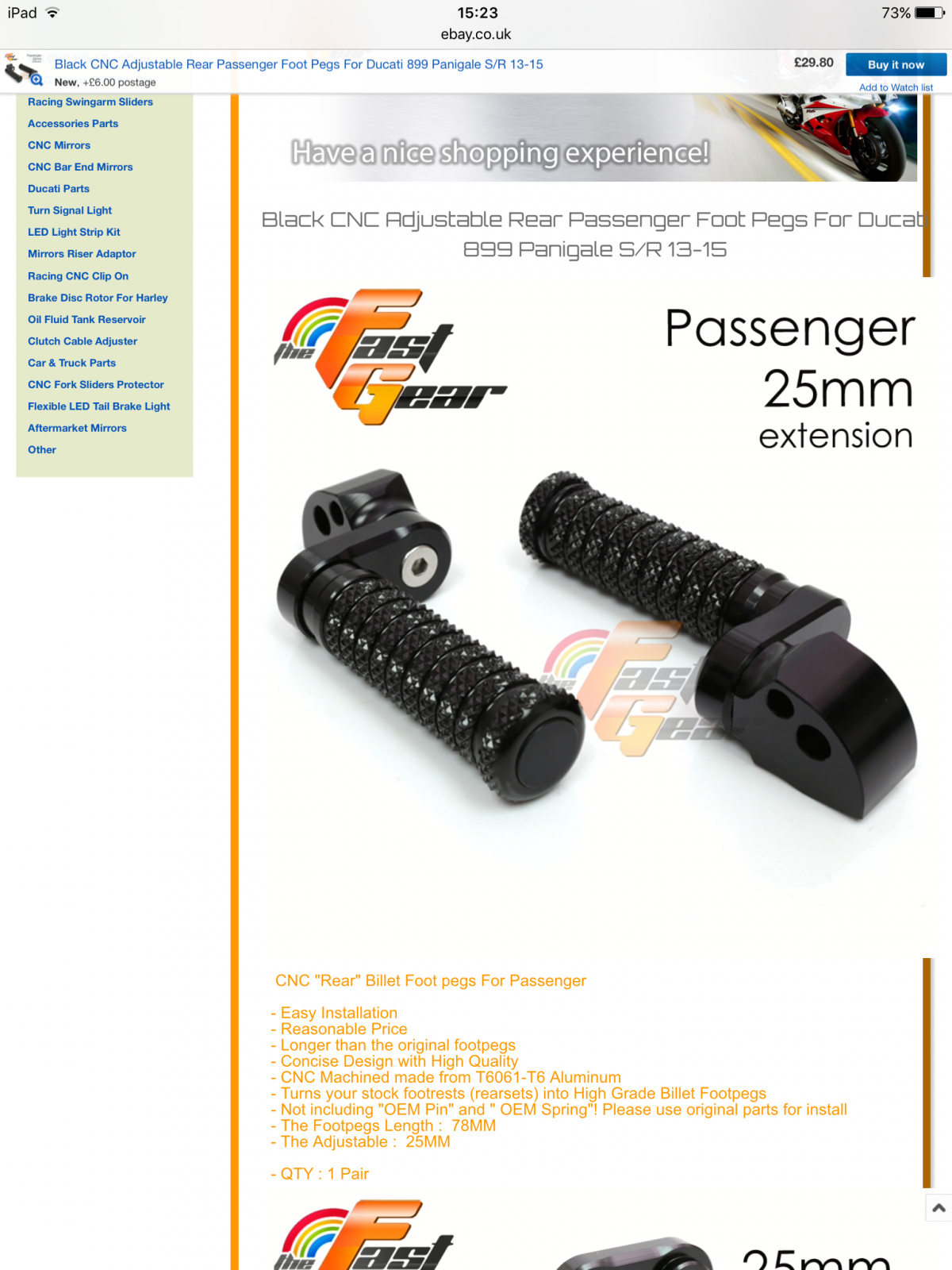

  1. Sounds like your having the same problem I had with my 1199. Brake pedal too high and having to lift your foot up to get to the brakes. I tried adjusting the OEM brake lever and to be honest it didnt make a great deal of difference and I still had to lift my foot my which isn't ideal when something jumps out at you and you have to anchor up. I bought some adjustable rotating foot pegs. They helped a lot and meant I was able to move the pegs up and back enough for my foot to be at the right angle to the brake pedal. They're on eBay and are cheap at around £30 a pair. Don't be put off by the fact they come from China, they are very good quality and quick and easy to fit using the existing mounting pins and springs. Make sure you get the rider pegs and not the pillion passenger pegs like in the picture.

  3. @BIG M thanks I think something like this will be a much better solution as opposed to full rearsets which all only slide forward to extend the depth and may not even be enough and much cheaper!

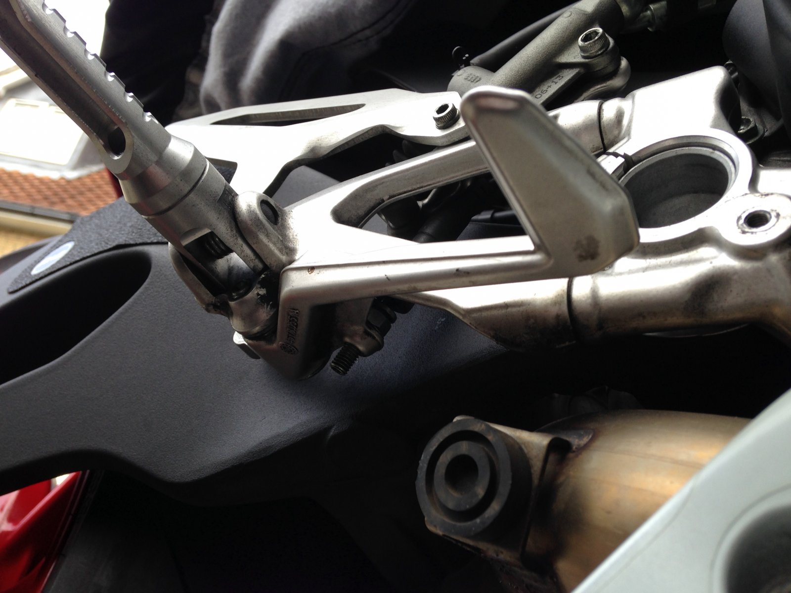

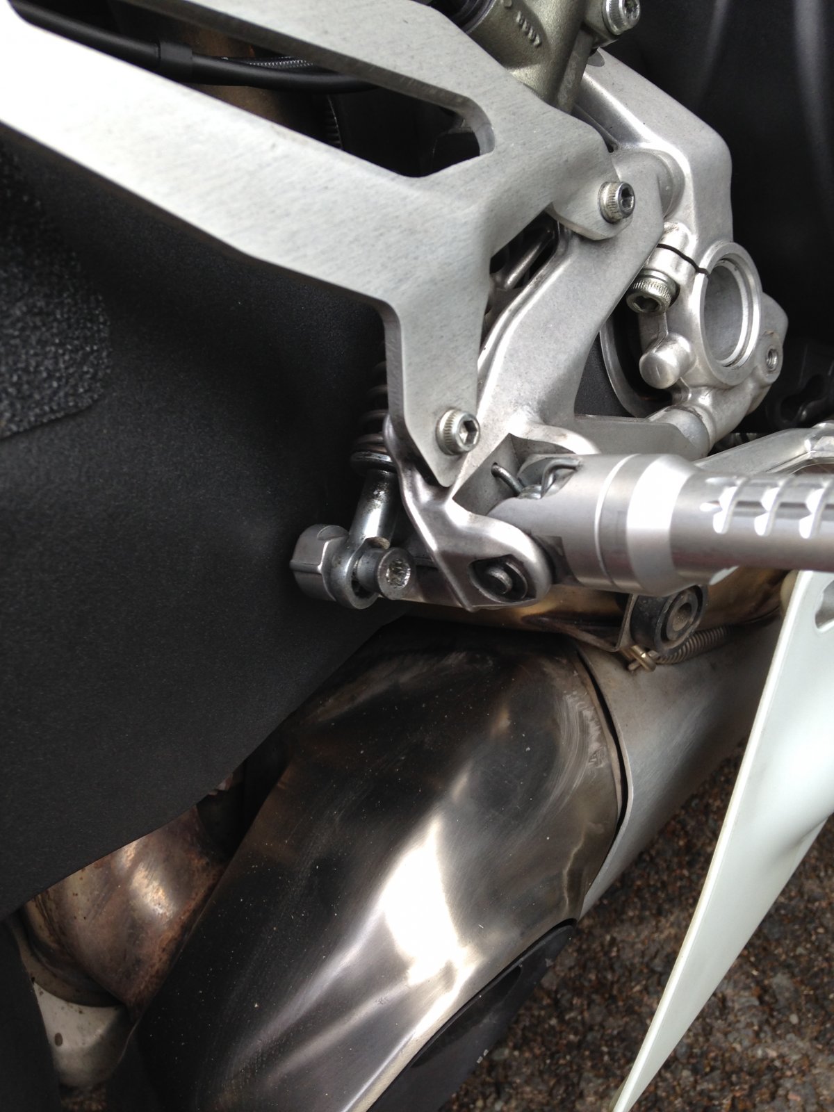

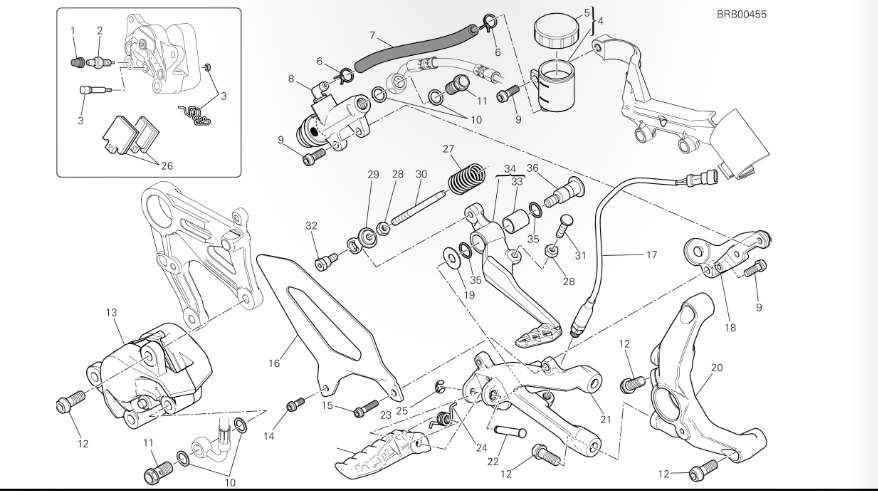

  6. So finally got round to this today and I found for me that I can get it to 90% what I need with it having play and being safe.
    Thanks to everyone for the info and making the back brake usable :)

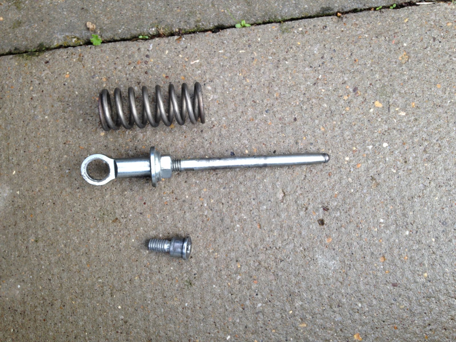

    For anyone wanting to know exactly what's what, see below -

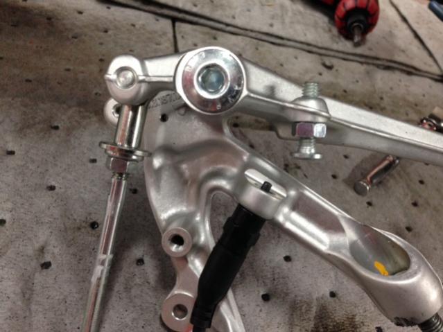

    Push the brake pedal down hard and loosen the bump stop / real light switch nut and bolt, loosen it above the pedal and wind then it to the top and the bolt down so it can go right up (it makes sense when you are there) -
    That allows the pedal to come up and expose (just about) he rear bolt that holds the plunger / pin for the rear brake -
    Remove that to get the pin out -
    Undo the locking nut on the pin, screw it into itself and tighten the lock nut it again.
    Put it all back to together and adjust the bump stop /rear light nut and bolt to drop the pedal and leave a little free play.
    Mine is fully in and bump stop fully up to give the below which as almost perfect, I could finish it off with less free play but then becomes potentially dangerous and not worth the risk. I can slide my foot forward but slightly up to catch it and can use it happily while Corning if needed to scrub speed off now.
    I have a pin on order and due next week that I can chop off the extra MM's but they are not straight, ans have sections and smoothed off etc so think I will keep it as a spare (cost £1.45 in total) and see how I get on.
