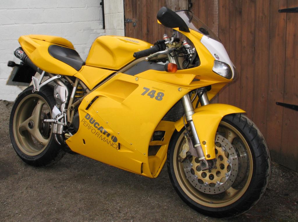

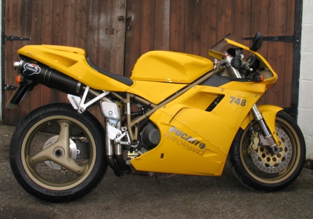

  7. I have just bought a good 748 bip for £2K.
    Extensive service less than 300 miles and 6 weeks ago. It was dirty as the last owner had lost interest but it scrubbed up well.
  8. Red, my sources tell me that 30 Titanium Grey MY02 748's were imported to the UK, 200 to the States and another 50 distributed across the rest of Europe.
    Where does the figure 116 originate from?
  9. Was that the scruffy one advertised on eBay?
  10. Sure was.
    The only real issue was a rear wheel spoiled by salt. One (e-bay) rear wheel later and some intensive cleaning it now looks awesome.
    There will soon be a refurbished rear wheel on e-bay.

  16. Looks like you did well, the next 12 months And a couple of thousand miles of thrashing will tell if it was a bargain, fingers crossed nothing breaks! You need to peel off those nasty aftermarket Corse stickers off the lower fairings, they look a bit cheap.
    #57 Carlos Fandango, Dec 9, 2013
  17. Someone did well for under £2400 wouldn't take much effort to turn that around, it was nice and unmolested. Just a bit neglected. Right up my street.
  18. The sticker were cheap £8 a pair.
    I put them on the hide some unsightly scuffing to the nearside lower panel. Currently I am looking for a lower panel and then the stickers will go.
    The real looser was the Ducati specialist that looked after the bike for the previous owner. He lost a mug. In 400 miles he fitted 2 fuel filters, 2 oil changes with filters and in 950 miles 2 sets of belts.
    The guy simply put in for a major sevice every year.
    #59 Stanforth, Dec 10, 2013
