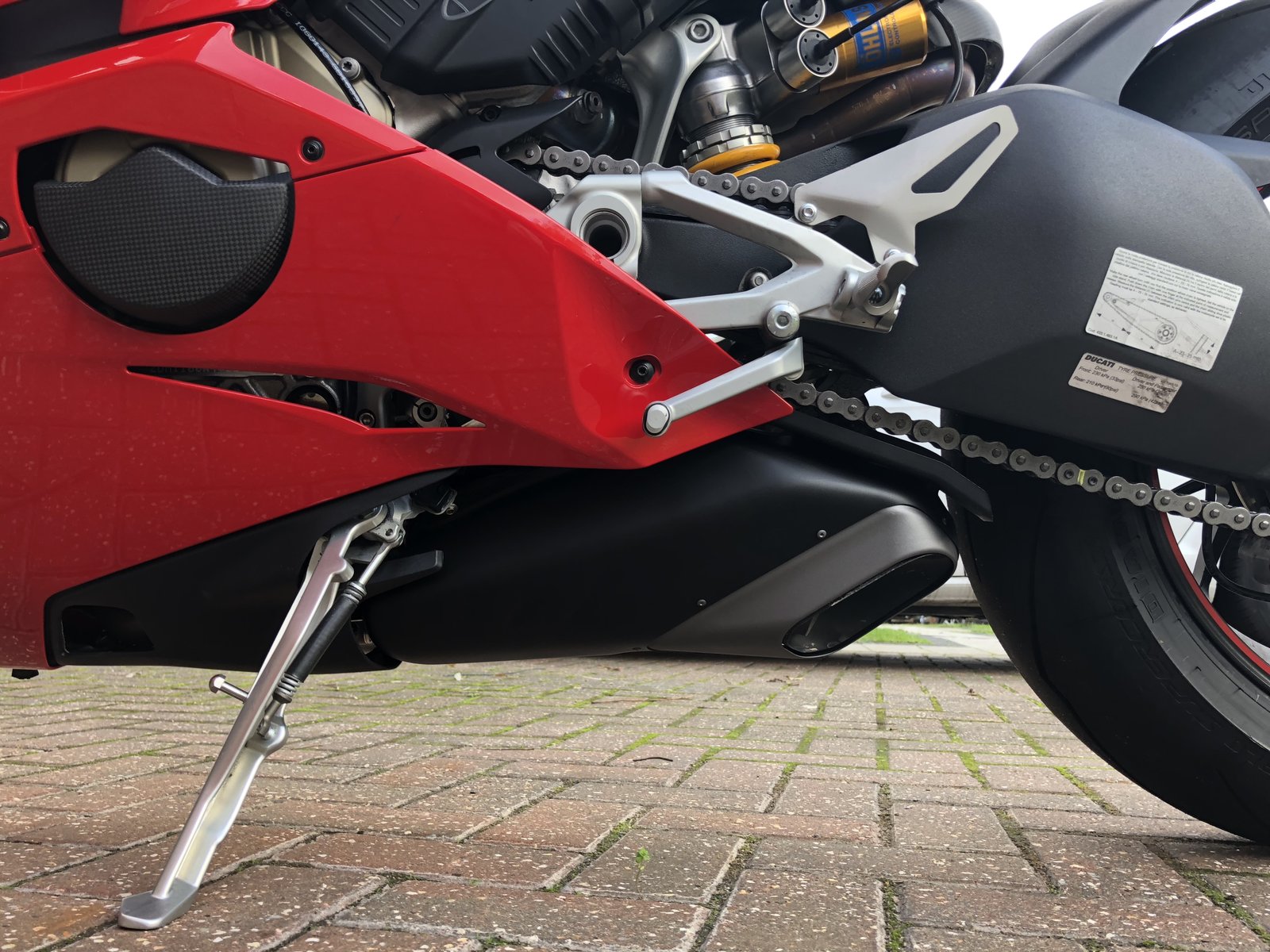

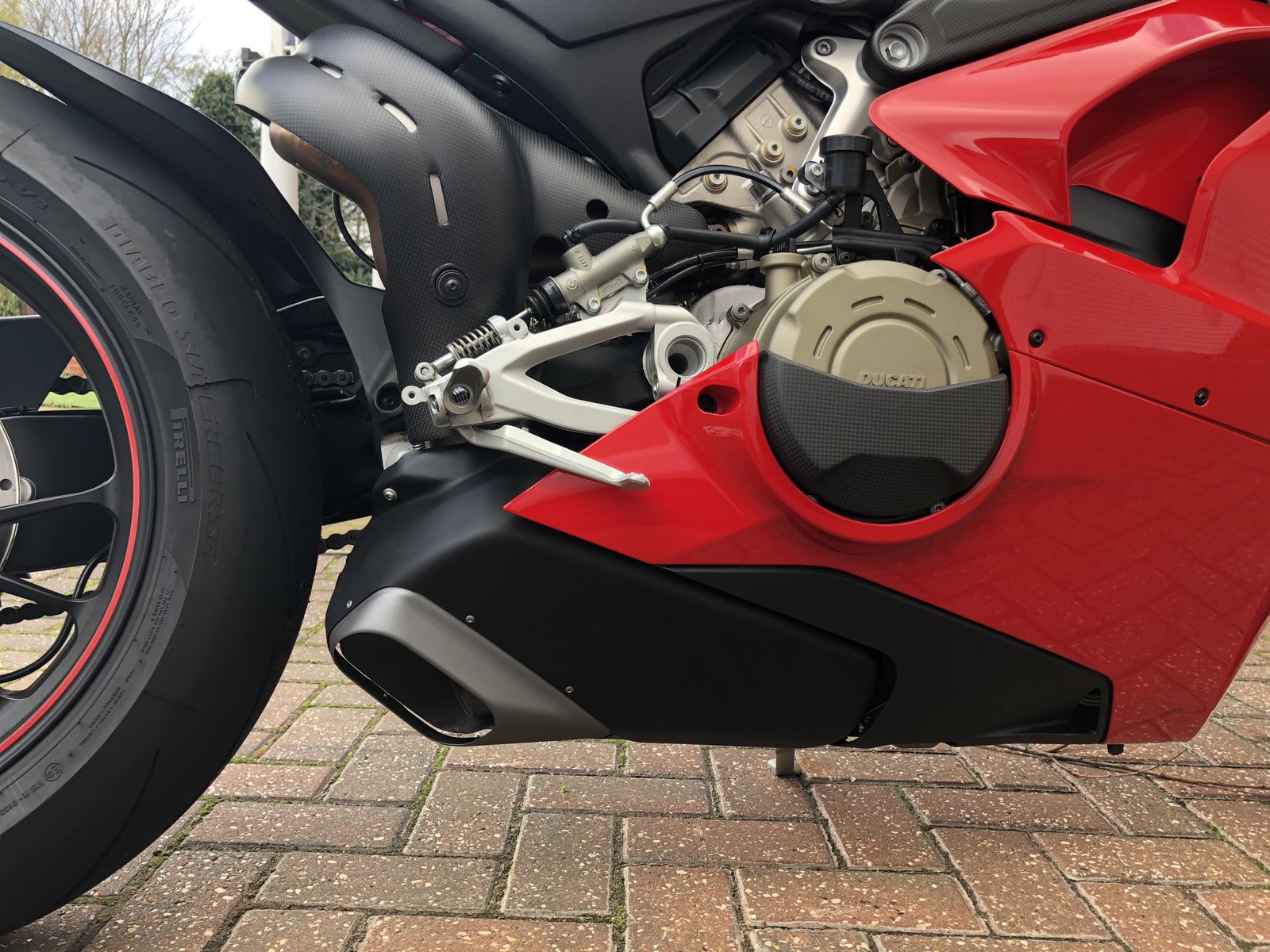

    Removing the shroud is fairly simple. Comes apart in two halves after the belly pan in a similar way however, just watch the lower chain guard as it is attached to the left side with one fastener. Drilled out the rivets with a 3mm bit to separate the shroud from the tips. Be careful as it is only aluminium and will mark/drill out easily if you stray from the rivet.
    As for painting it was all about proper prep. All parts cleaned, washed and dirt free. Then a fine wet and dry in the sink with warm soapy water. As it was aluminium for the majority of it I used 1200 grit so as not to mark anything. It took a while but it was worth it, just make sure that the surface has a light key to it and is contaminant free, same for the tips. All dried off I then hung the components using garden wire through one of the less inconspicuous rivet holes toward the back/bottom so you won't see any possible marks left from painting.
    Paint used was an XHT paint in an aerosol from Ebay. Black was applied to the aluminium as per the directions, warm dust free environment, can upright and 15-30cm away. Light coats with a short break in between until covered fully. Once the first coat was complete it was then baked in the oven at 160 degrees C for an hour. The stainless tips, including the new rivets were painted a graphite grey and completed as per above.
    After the first coat and cooling I then repeated the process again for all parts.
    Once cured and cooled fully I was then able to re-assemble. The rivets are 3mm 'short' rivets, 6mm in length. I protected the paint on the rivets with a couple layers of masking tape over the end of the rivet gun before use and replacing it as I went round/required.
    That was pretty much it, paint as below.

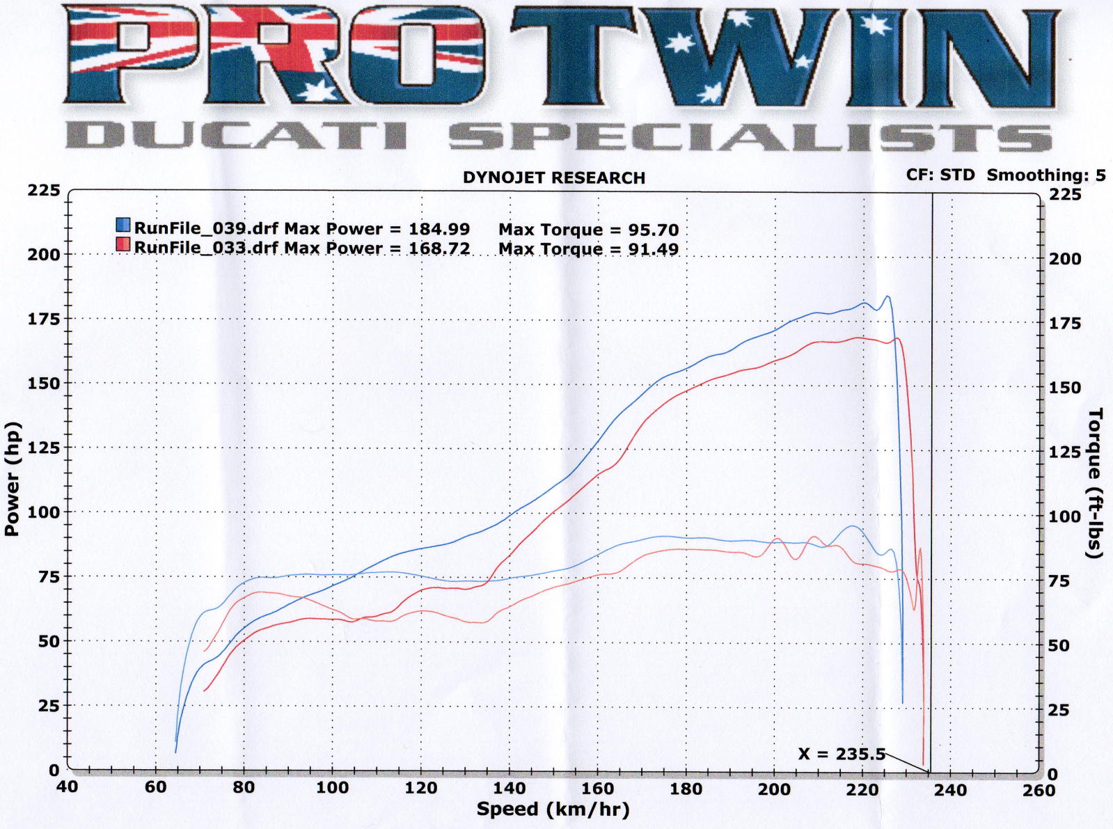

  6. Came across this on a local Forum. Owner of an 1199 unhappy with the the power/torque dip on the stock bike opted for a tuneboy ecu and full Akro system. After work with the tuneboy software this was the result (no I don't sell it/have an interest etc.)

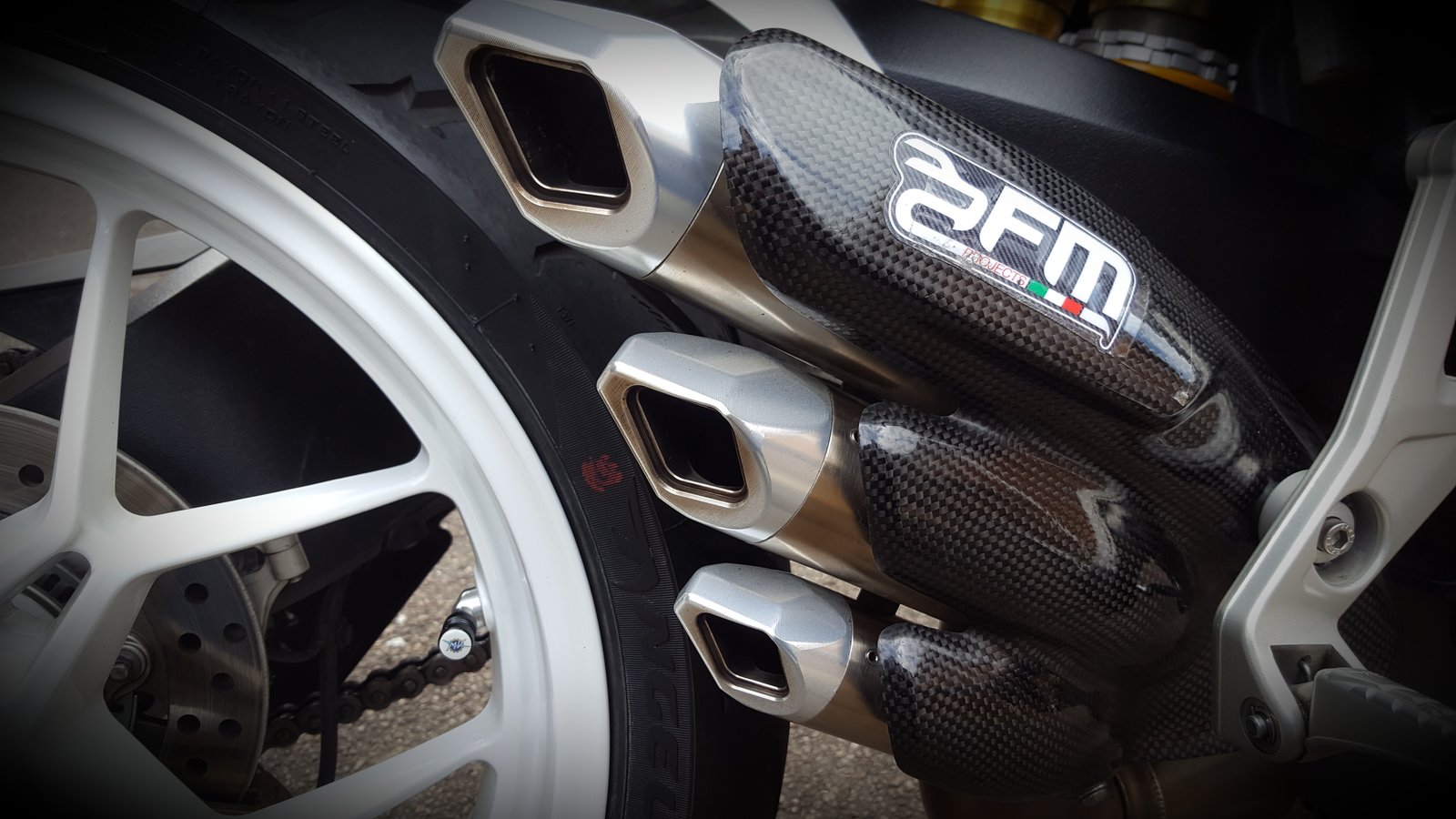

  7. I've opted to ceramic coat my stock exhaust as the bike is fast and loud enough for me already. But if I were to look at an aftermarket the least ugly (IMHO) so far is the FM. No idea about what mapping it needs, nor its quality or longevity. I don't like the 'pissed plumber' aesthetic of most of the alternatives. Now if someone could do a shotgun style system for the V4....
  8. Had a FM projects exhaust on my last MV, beautifully made .

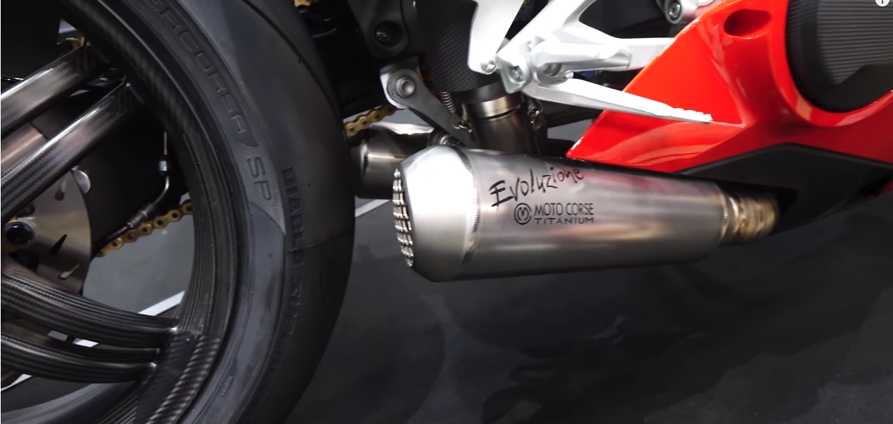

  13. Moto Corse Japan have just released this fugly system.
