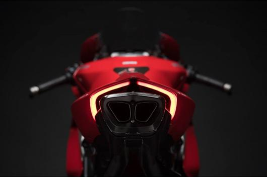

  16. Can you post up a picture of the rear silencer from directly behind the bike as so far all the images of customer bikes have the silencer skewed off to the right, ie not aligned with the central longitudinal axis of the bike. Also when you apply the brakes, how much of the inner brake light section of the tail light is obscured by the silencer (video maybe?) as this might not impress plod on the road or be particularly visible to other road users behind you.
  17. I will do when I get home later this week. I'm fairly certain the brake light won't be obscured. The only angle it would be obscured from is if your eye level were below the number plate approaching from behind. Not that it's going to bother me as all the lights are coming off next week.
    And I think you're right regarding alignment. It does sit a cock hair off central. I hadn't noticed but it was pointed out to me by another chap that knew about it. Not sure if it's adjustable for the OCD among us. It doesn't bother me to be honest and I'd probably never had noticed unless he'd shown me. I've also ordered a monocoque seat unit (including tail section) from FullSix so when I fit that I'll have a crack at the alignment. Might need a couple of washers when I fit the monocoque :laughing:
    Looks possible to align from this....
